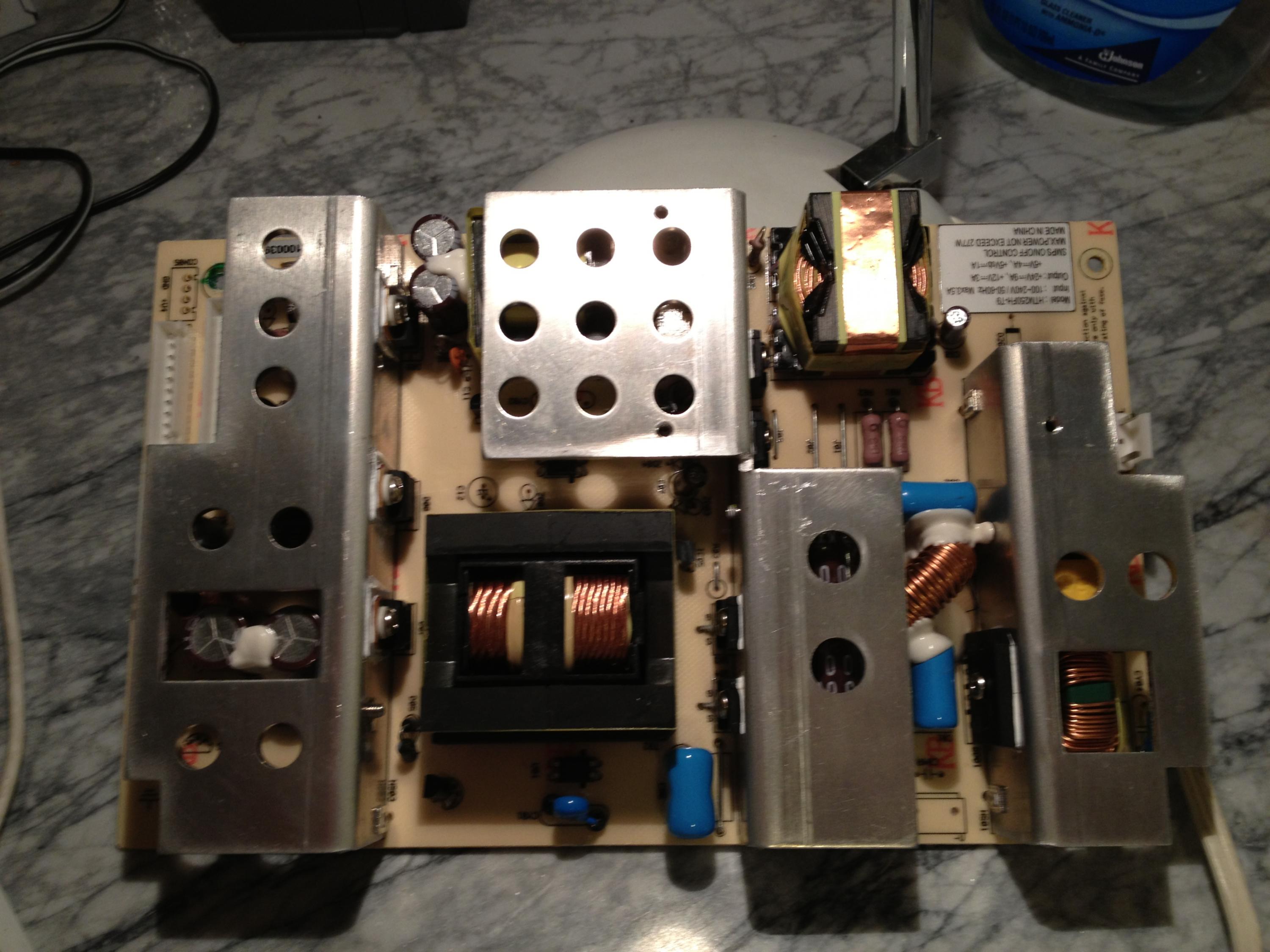

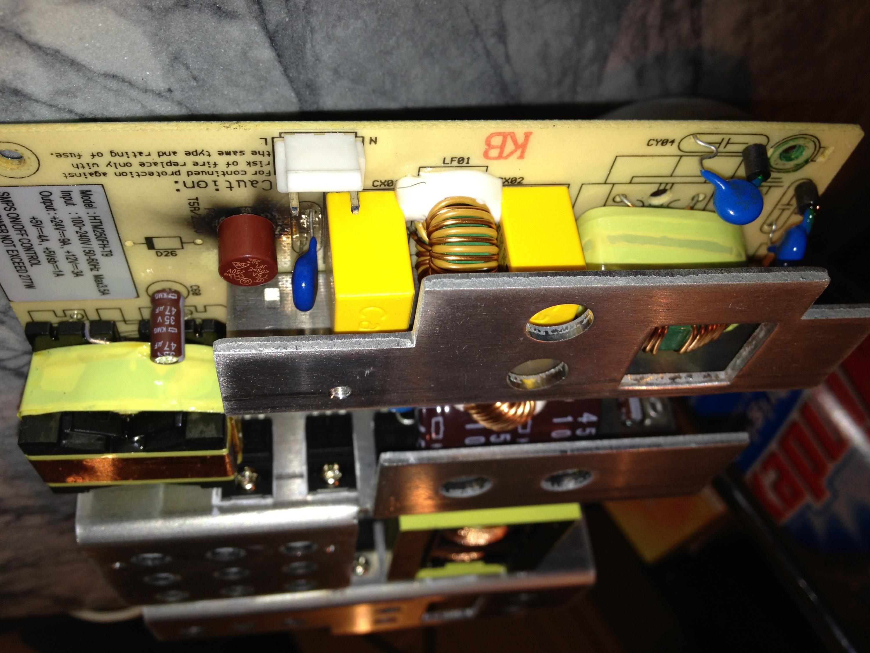

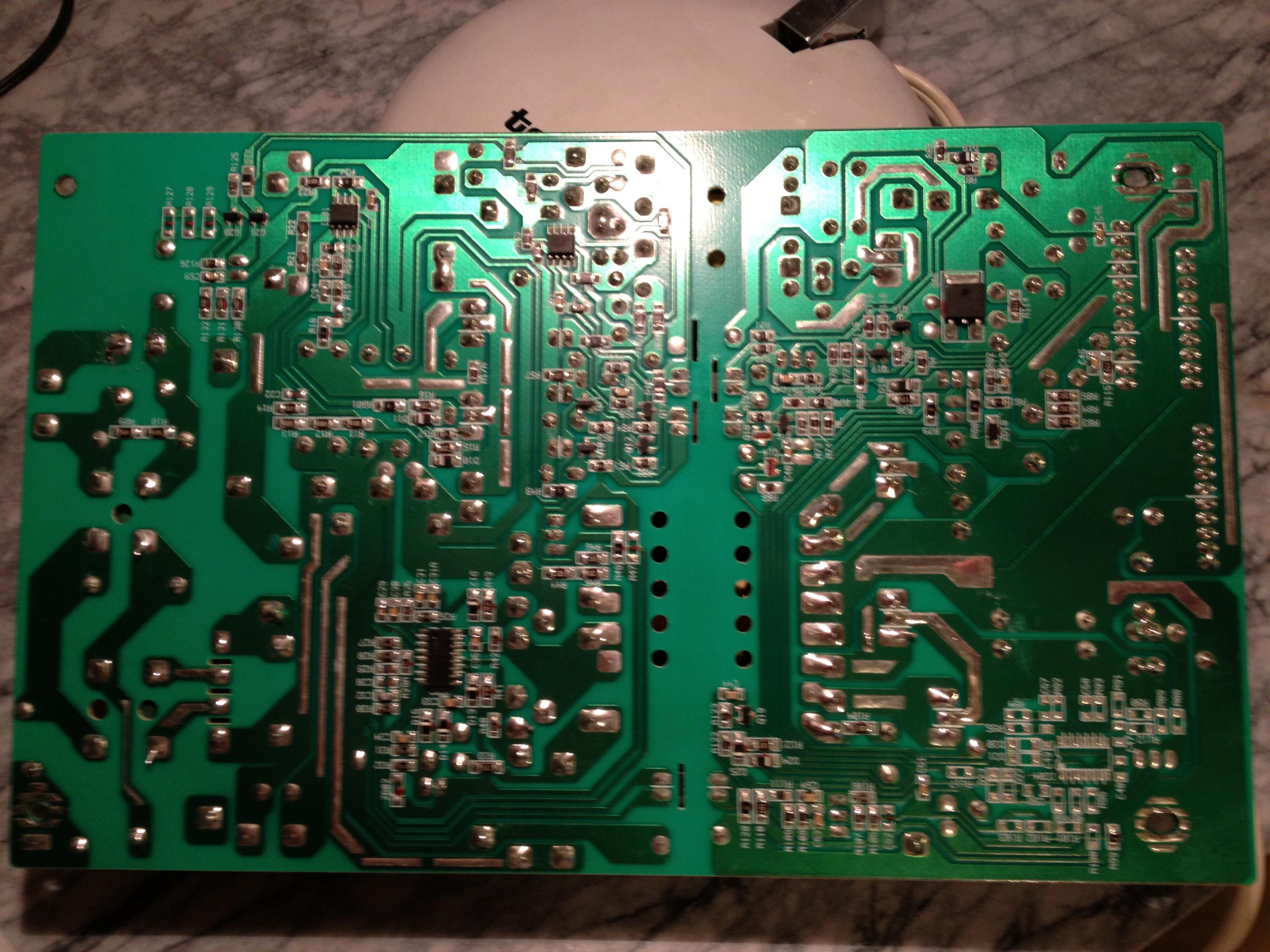

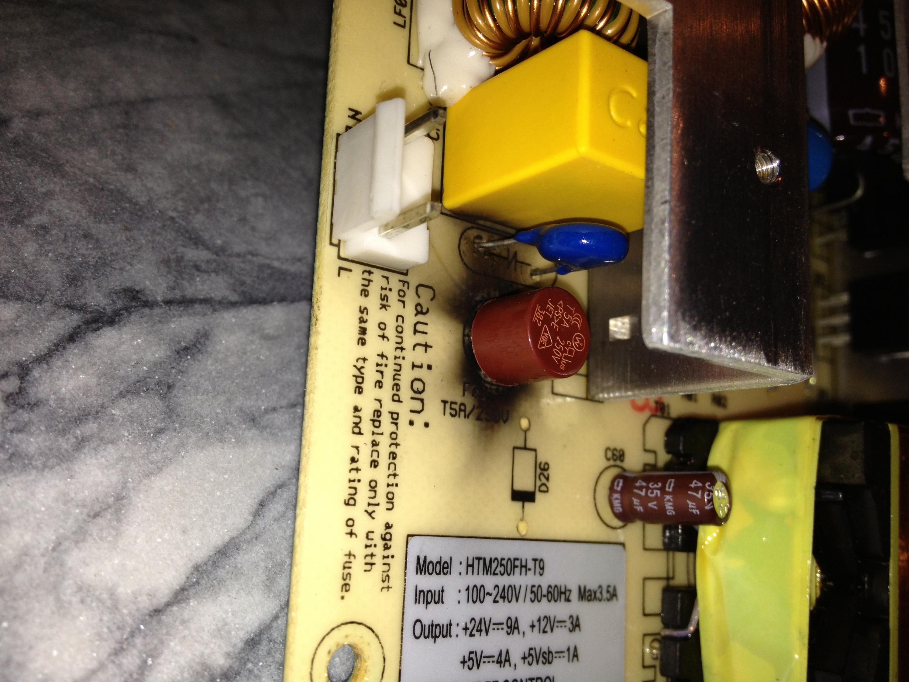

    Hello- I have a 32" Winsonic monitor where I accidently grounded the power supply to the case while troubleshooting the touchscreen.
    Now the fuse keeps blowing whenever I replace it. I guess I'd like to know whether I should try to fix, or just (somehow) source a replacement PS board.
    I've taken some pictures of the board and will add these below. Any help is appreciated. I really don't want to toss it, as it's a pretty industrial looking monitor.
    Thanks-
    Chris
  • ohmmy
    • Jan 2013
    • 182
    Re: Winsonic 32" monitor fuse keeps blowing
    You probably accidentally shorted something on the primary side of the power supply. Check bridge rectifier, fets, and any other diodes for shorts.
