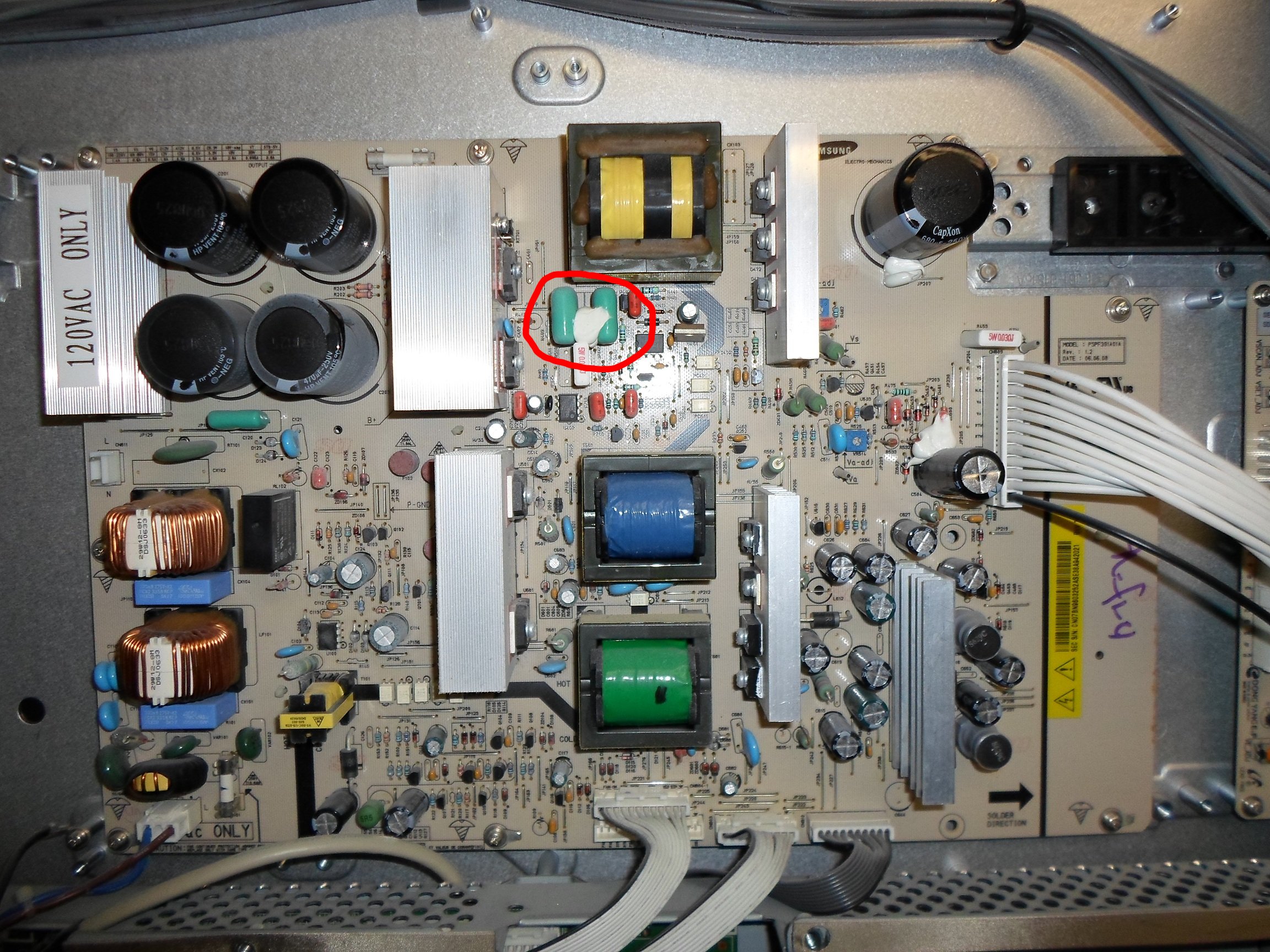

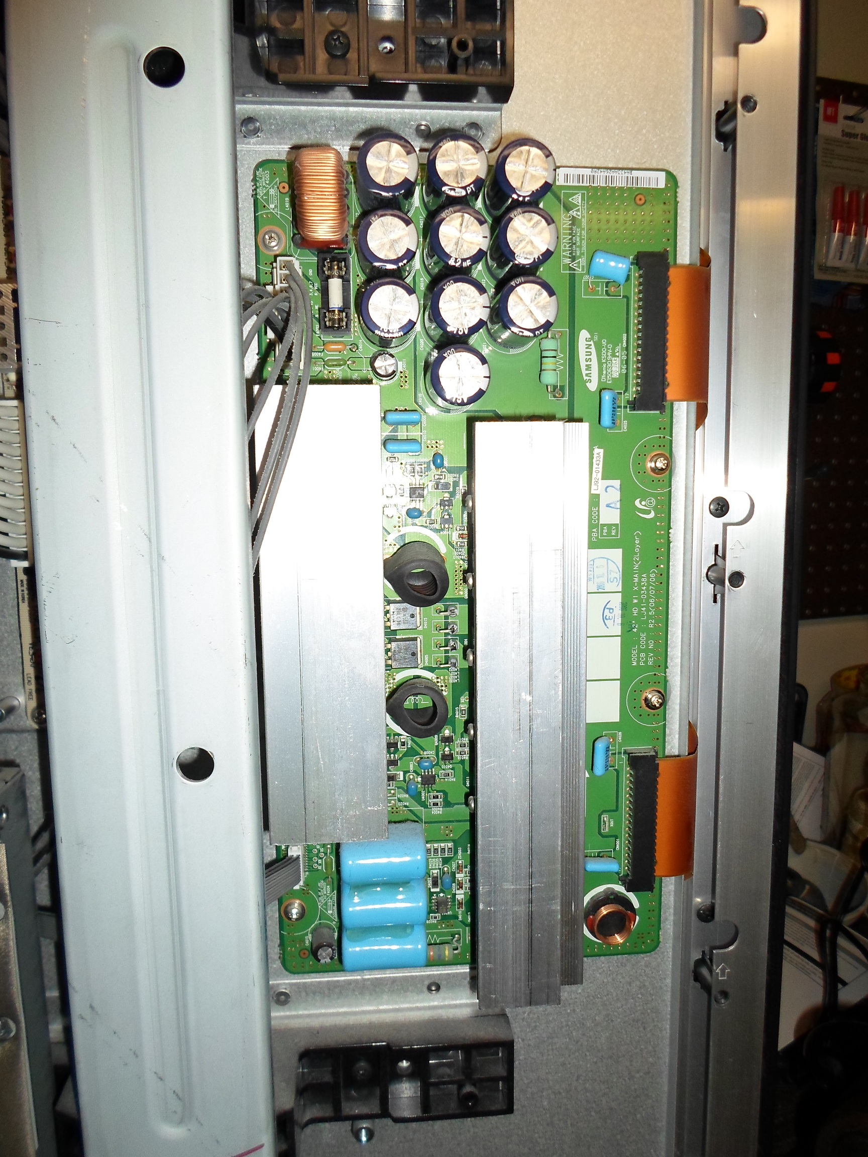

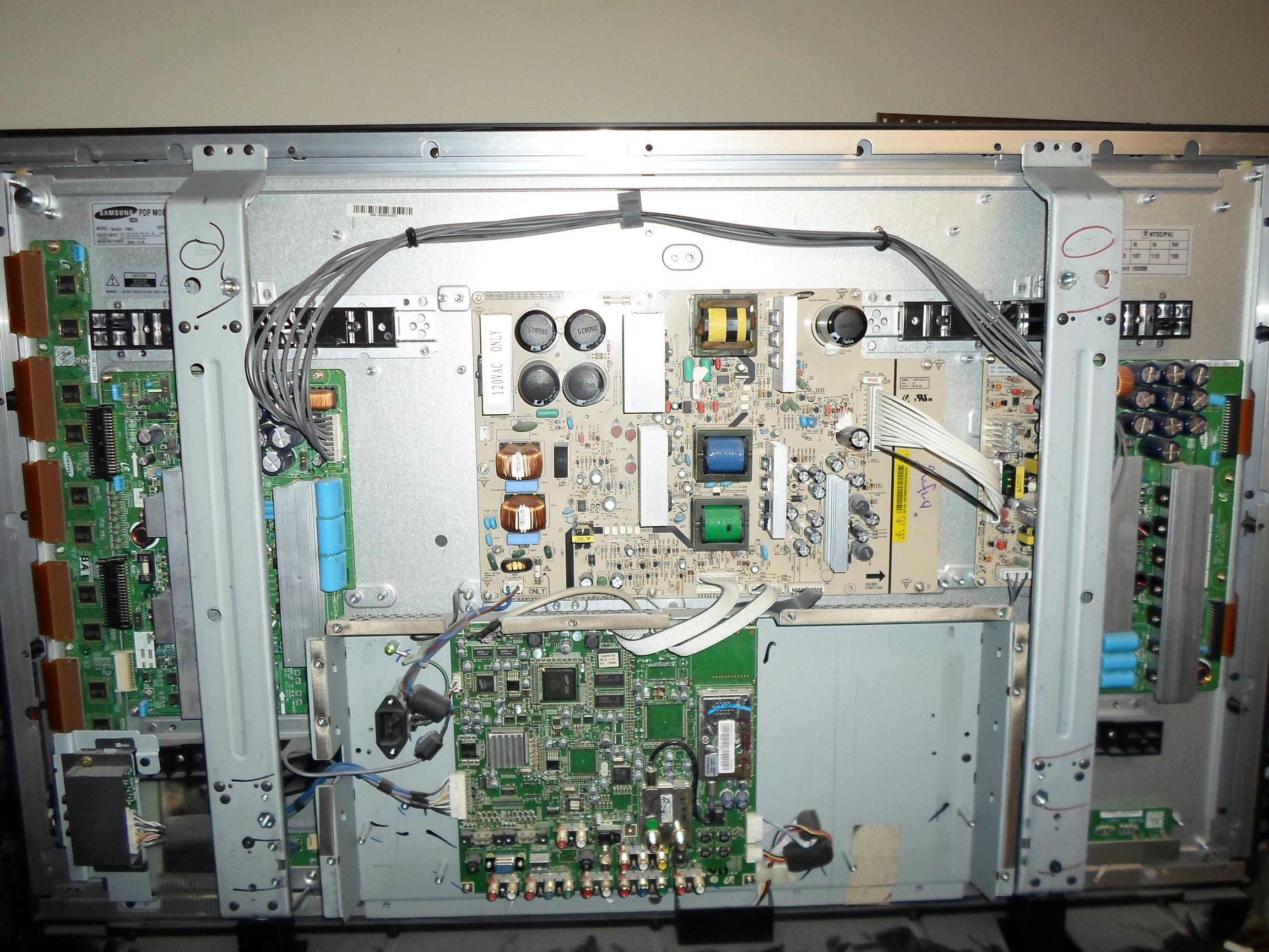

    Tv turns on fine but the picture will go out( black screen) in a few seconds. sometime longer. when picture is out sound works fine. seems everything works fine except loosing the picture.

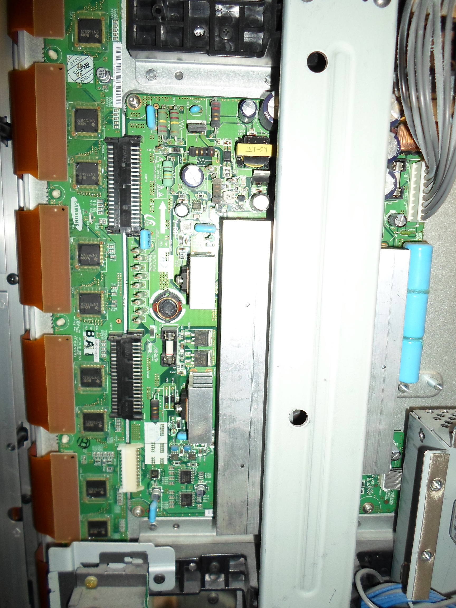

    if I remove the fuse from the x-main the Tv stays on. put that fuse back in and pull the fuse from Y main " fuse closest to power board " it also stays on. I notice some pink color near center of screen.
    and theres a slight humm from transformer located at top center of power board.

    You notice pink colour when the X-main is removed or when it is functioning?

    This is an interesting plasma display which doesn't use a power factor correction circuit; if those big caps on top left are failed it could cause this issue.

      there are two Vs on the power board. the top one was 177.1v then when the picture went out it droped to 2.237v then I tried the second vs the TV ran for about 20 minutes and then it powered off and then power back on. it's done this a few times tonight. first time that it has done it. so the second Vs is at 178.5v I got the TV going right now waiting for the screen to go out with the volume still working to take another reading.

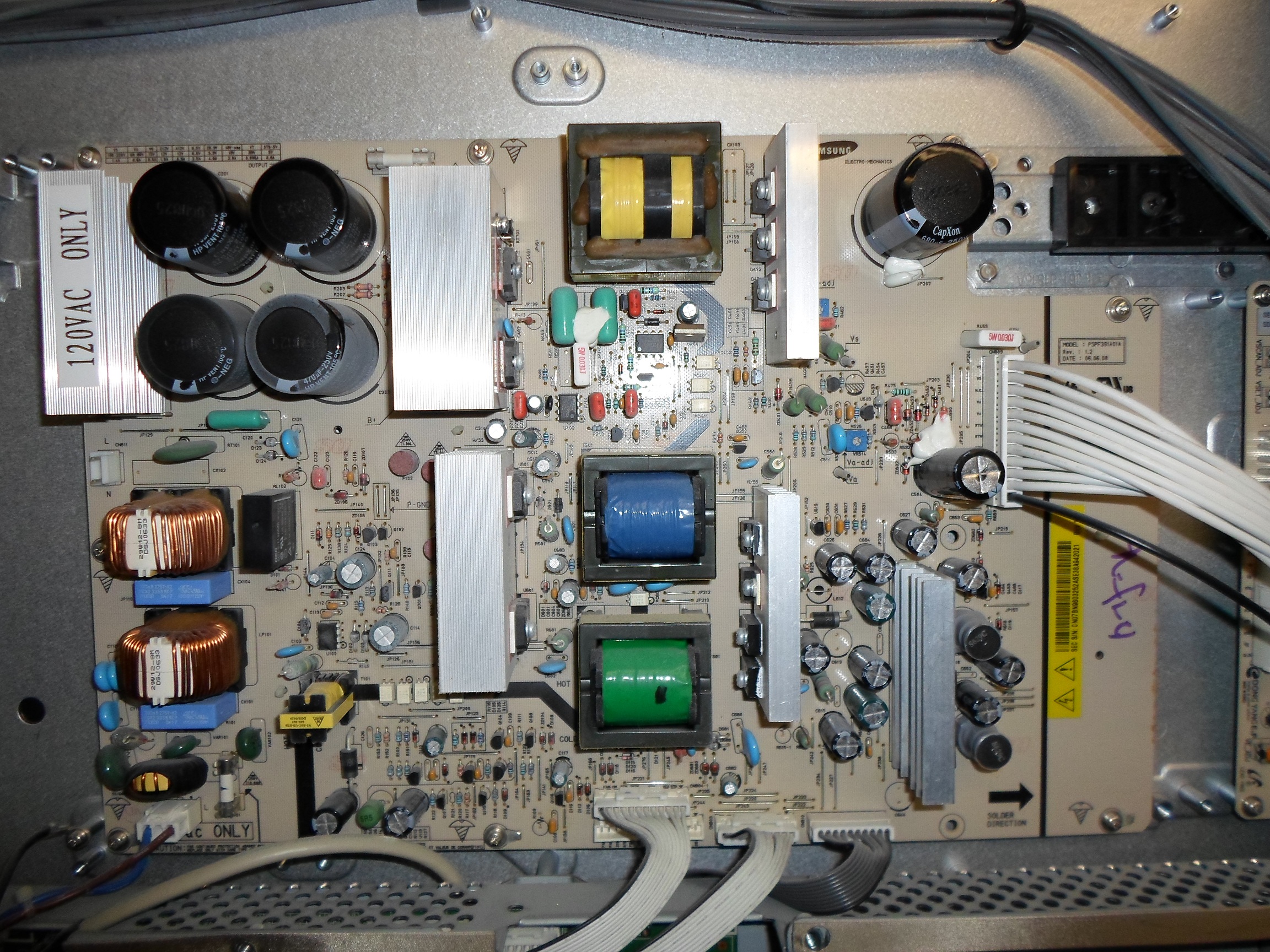

          I got the Vs set. i noticed it's at 197v when first powered on then when the picture is on screen it drops to around 177v and it does fluctuate. today it's just running for a few seconds then picture drops out. I also noticed two of the large caps on power board has a slight bulge

            Yeah, I have seen this before. Try using a bit of contact cleaner on the adjustment potentiometer and turn it back a few times. If that doesn't fix it, remove the power supply and inspect the solder joints on the large power transistors -- common fault with this model is the solder joints crack.

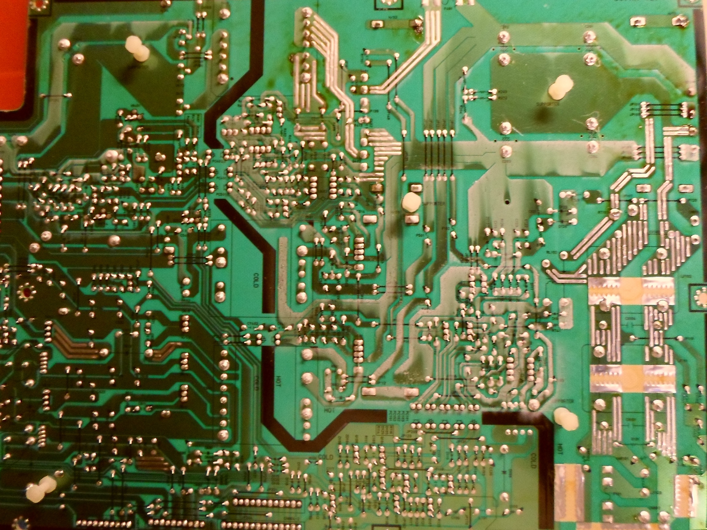

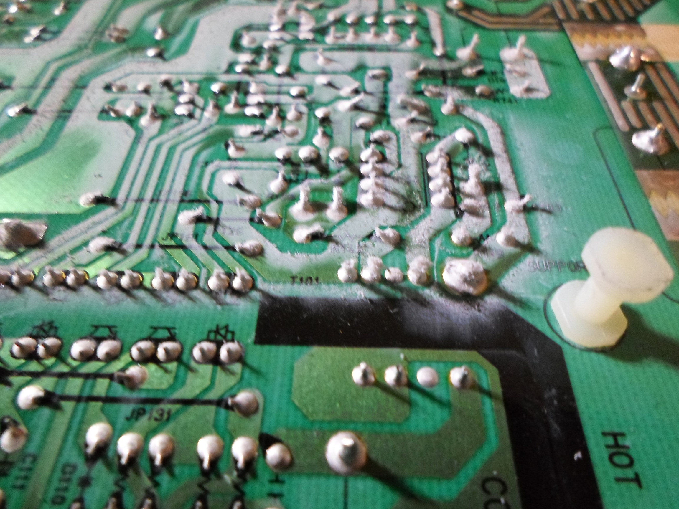

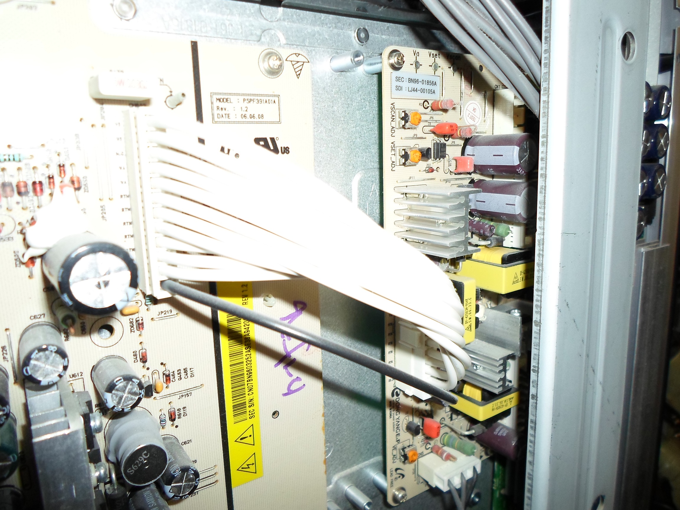

                  did not see any cracks but there was a " gray powder " see picture. I cleaned this off and heated up the joints. checked the voltage " remaining " in large caps. cluster of 4 at top left. if i remember correct 2 were at 300v and the bottom 2 were at 5v. put board back and it would run at 197v " fluctuate " even with picture on, but would drop back down near 180v then picture would go out but sound still working.
                    Re: Samsung HP-S4233 Picture going out
                    For all devices on the heatsinks on the primary side retouch the solder.
