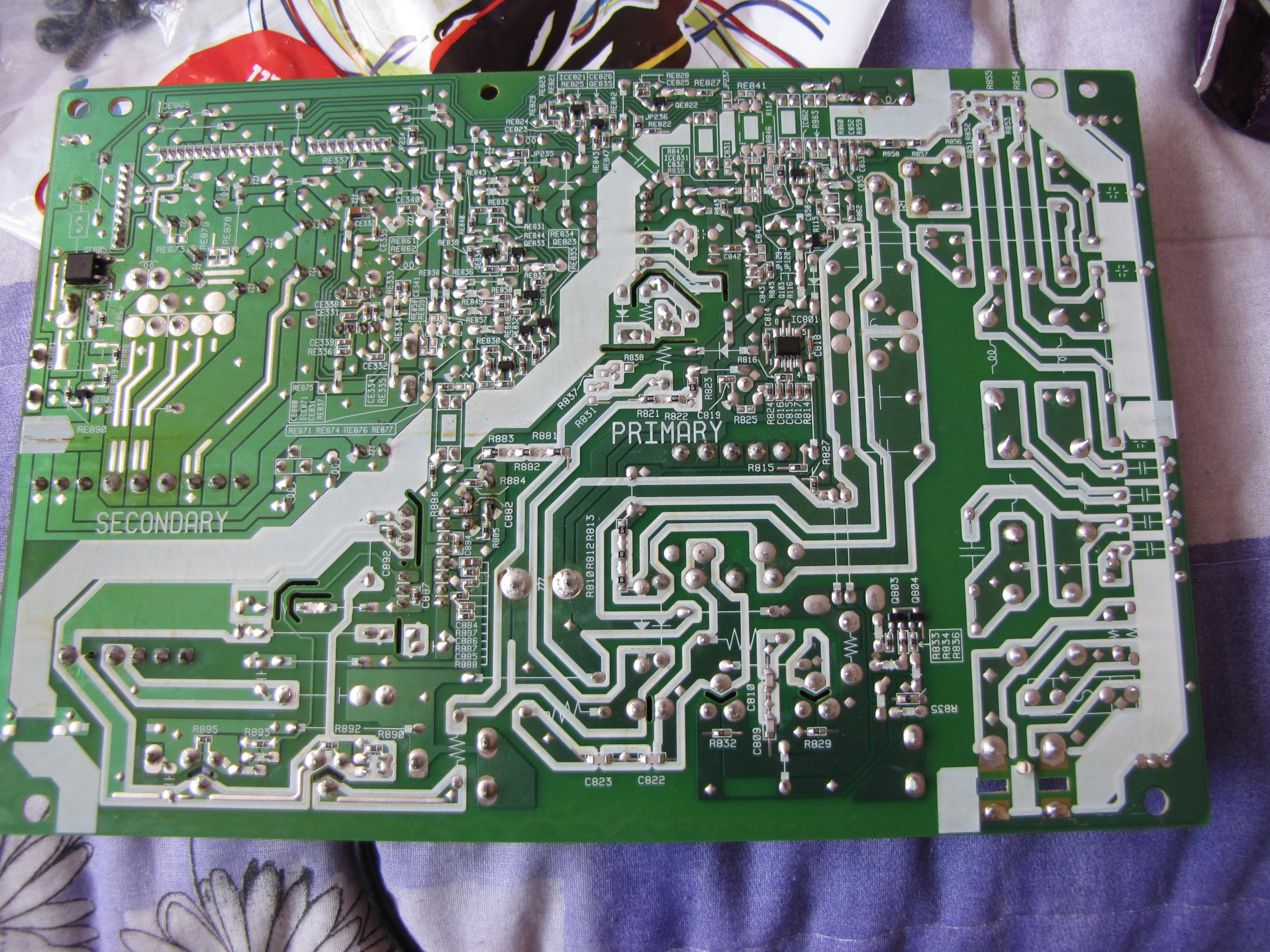

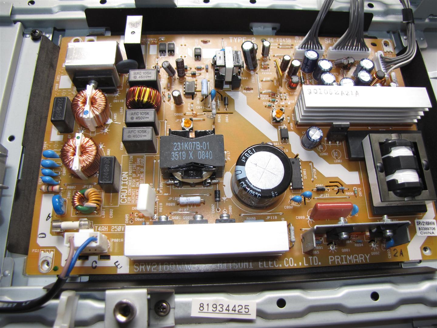

    hope someone can guide me to find what is going on,
    PS model : SRV2169WW
    Main Board : PE0736
    Got the TV in that state: the tv won't power on, RED led indicator lights when plugged into main. when power button pressed i hear some high pitch noises from PS and main, after a few second RED led turn off and after another couple of seconds lights RED again. There is no picture nor backlight nor nothing.
    reading i've done so far on pins that go from PS to main:
    12v - present on standby and power on.
    5v - present on standby and power on.
    PWRDB - dead.
    PWRTV - 0v on stdby, 3v when power button pressed.
    PWR_PROTECT - 2.9v constant.
    PWR_SIG - dead.
    AC_DET - 0v on stdby, 3.9v when power button pressed.
    PWR_LCD - dead.
    two 12VLCD pins - dead.
    24v to inverter (?) - dead.
    18V - present on power on.
    tried to short 5v to pwr_sig - same thing only this time speakers make weird noise and 24v appears temporarily on outputs to inverter .
    would appreciate any ideas ( or schematics ), Thanks!

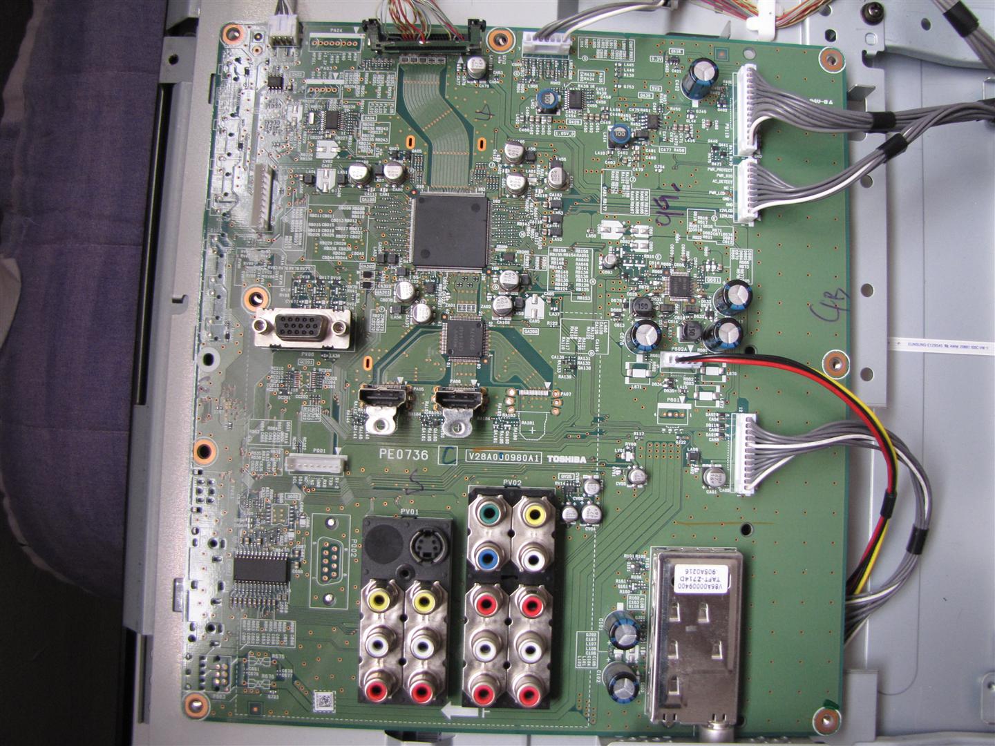

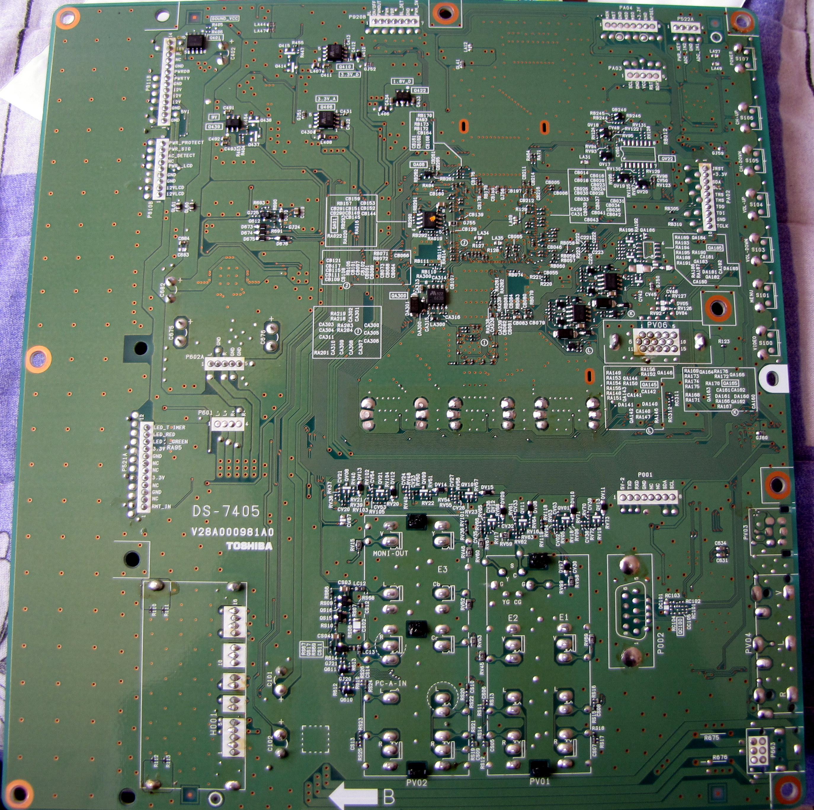

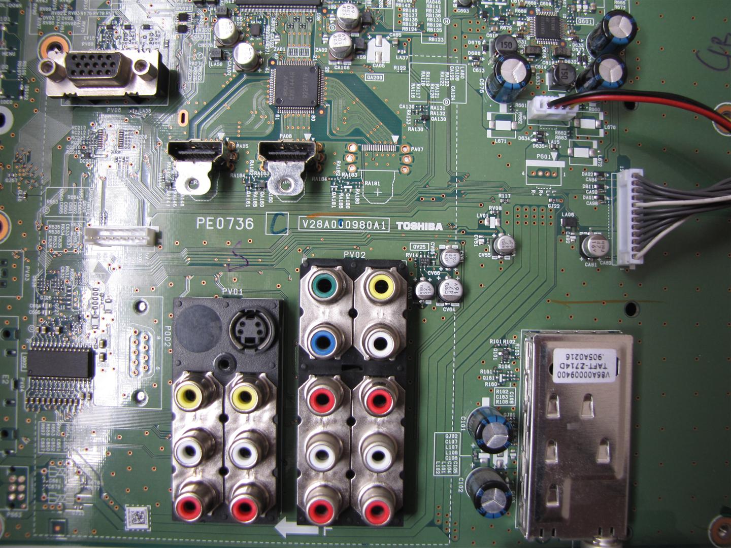

          I have worked on the 32WLT66S which had a similar "not powering on" fault, but that is a UK model, I am not sure if it is similar to this model.

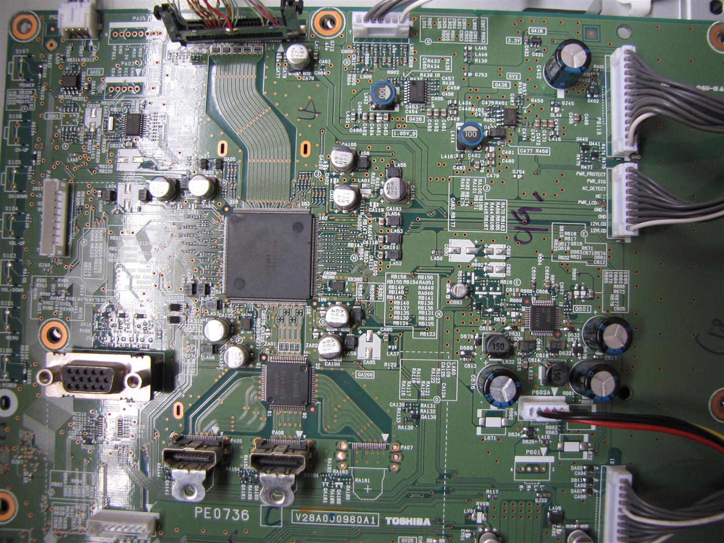

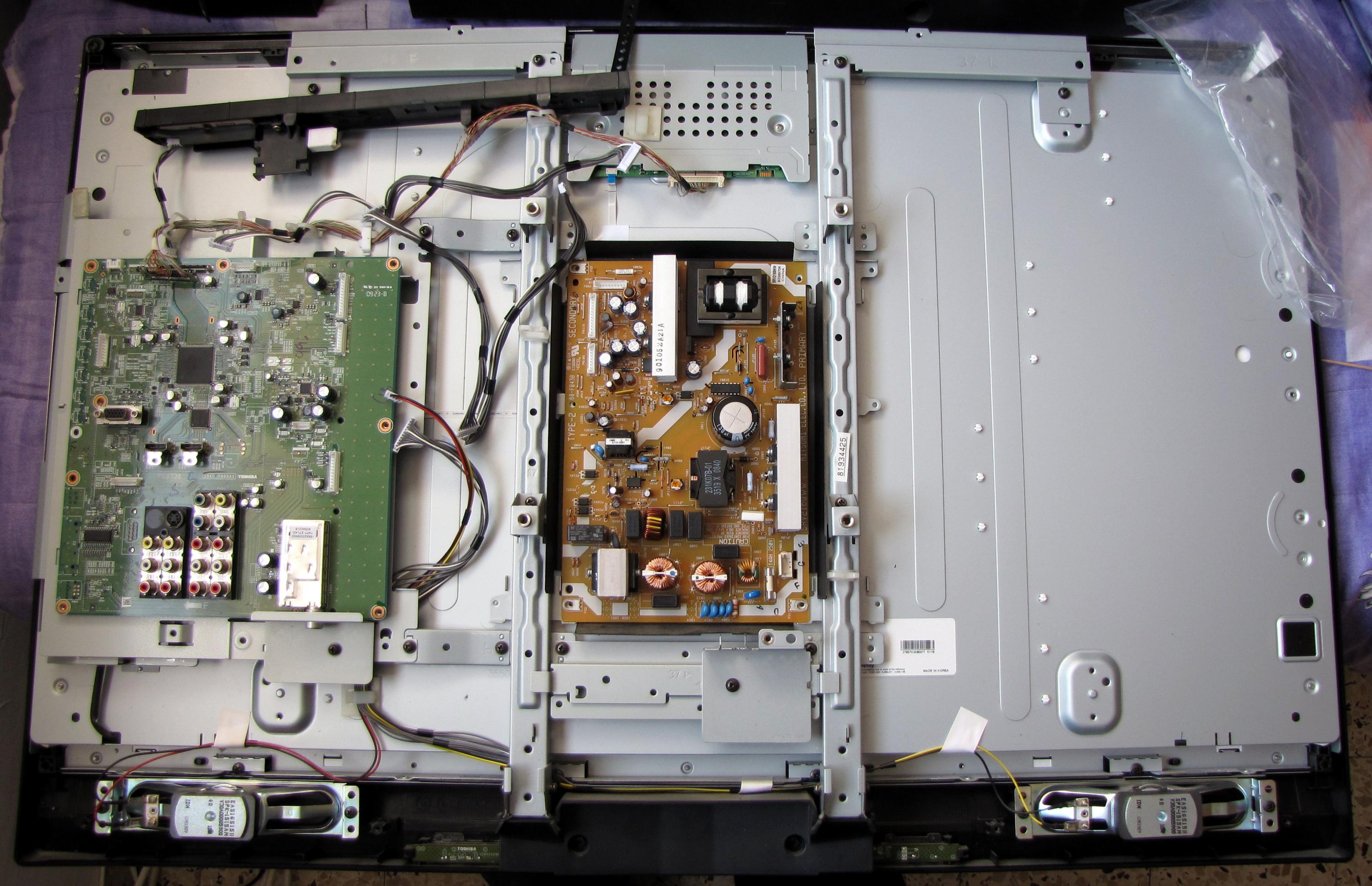

          Can you post some pictures of the TV's boards, and one of the overall layout? Please use the manage attachments function.

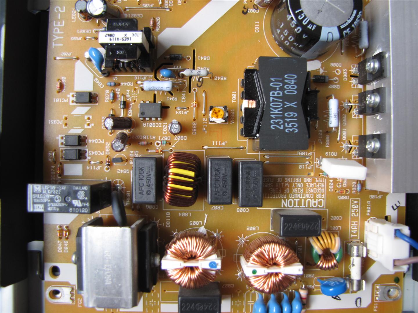

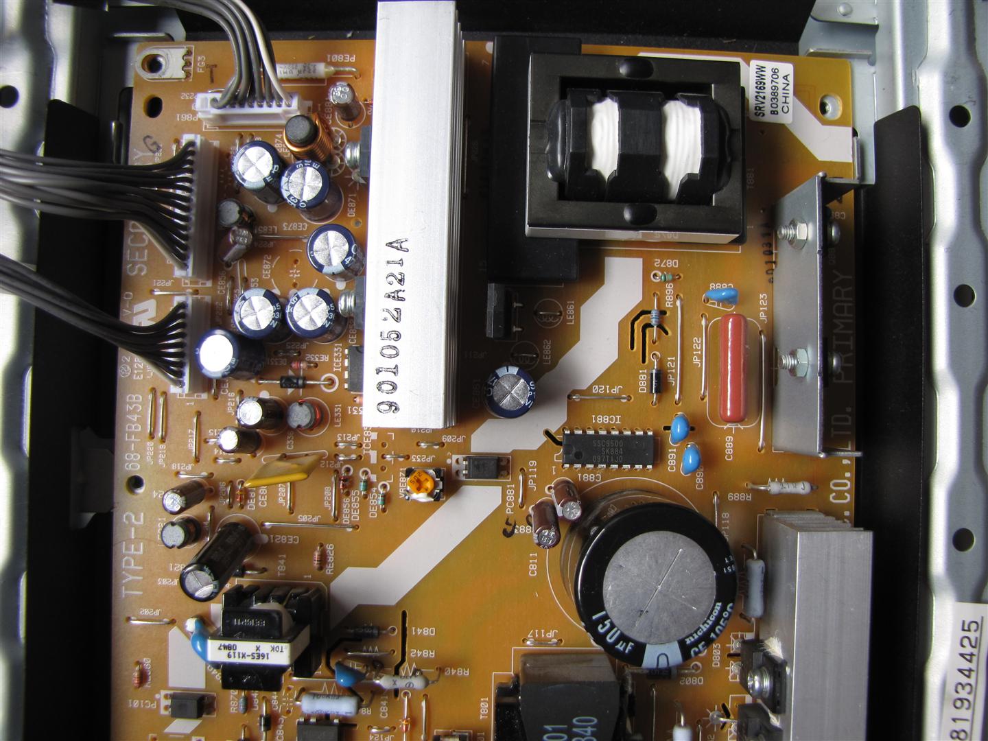

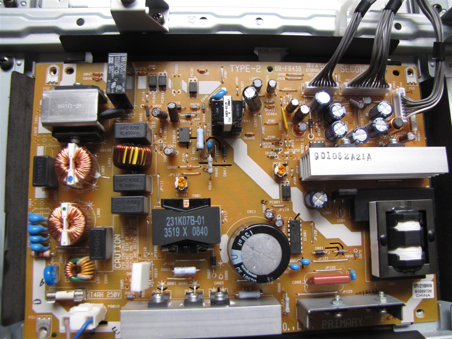

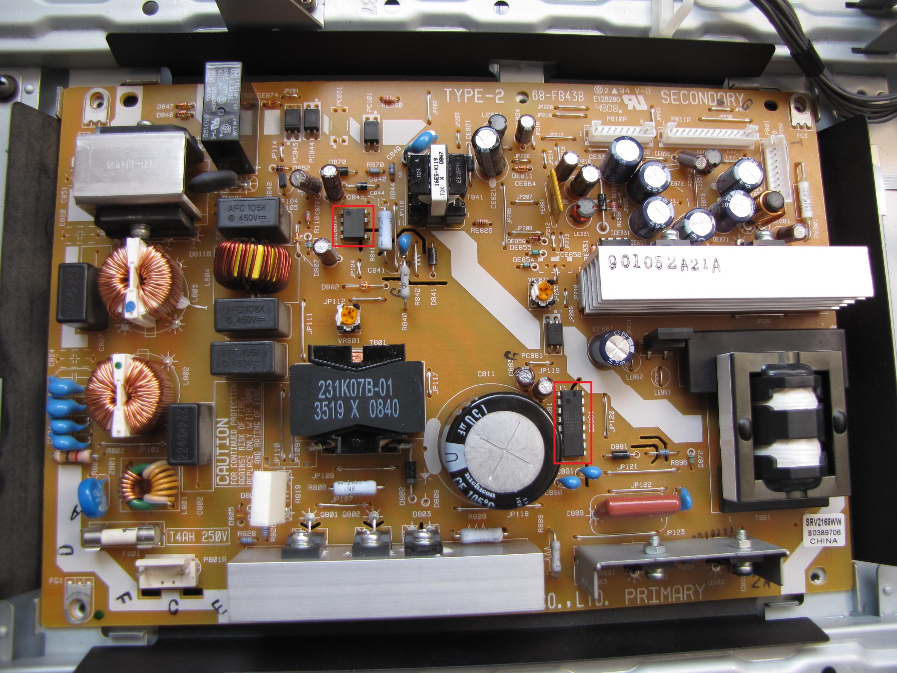

            i took some photos as you suggested.
            I would like to investigate the following IC's on the PS (marked them in red square) :
            ssc9500-16 pin IC
            mip2f2 - 7 pin IC
            do you know how to check those for correct functioning? Any other tests i can do?
            Thank you and Happy new year all
              Re: Toshiba 37AV600T - not powering on
              Unfortunately the 32WLT66S is completely different! Mine had about 8 individual boards, but yours has only an AV, PSU, T-con and probably an inverter.
              While you may not know what AC detect should be you could cut the wire going to the main board and feed your own voltage in.
                Just did that, cut the AC_DETECT wire. normally (with AC_DETECT connected to PS = 3.94v) the TV would make two attempts of starting (red led turns off, no greed light) and then return to STDBY mode (red led turn back on).
                if i jumper AC_DETECT to PWRTV which is 3v- same behavior..
                tried to ground AC_DETECT , the result: TV makes attempt to start (red led turn off) but doesnt return to STDBY (red led stays off). of course no picture or sound and no PWR_SIG. (relay doesn't click)
                i am starting to suspect main board because PWR_SIG is coming straight from the Controller and for some reason it is not supplied.
                could the IC's ssc9500 or mip2f2 couse such symptom somehow?
                Thanks.

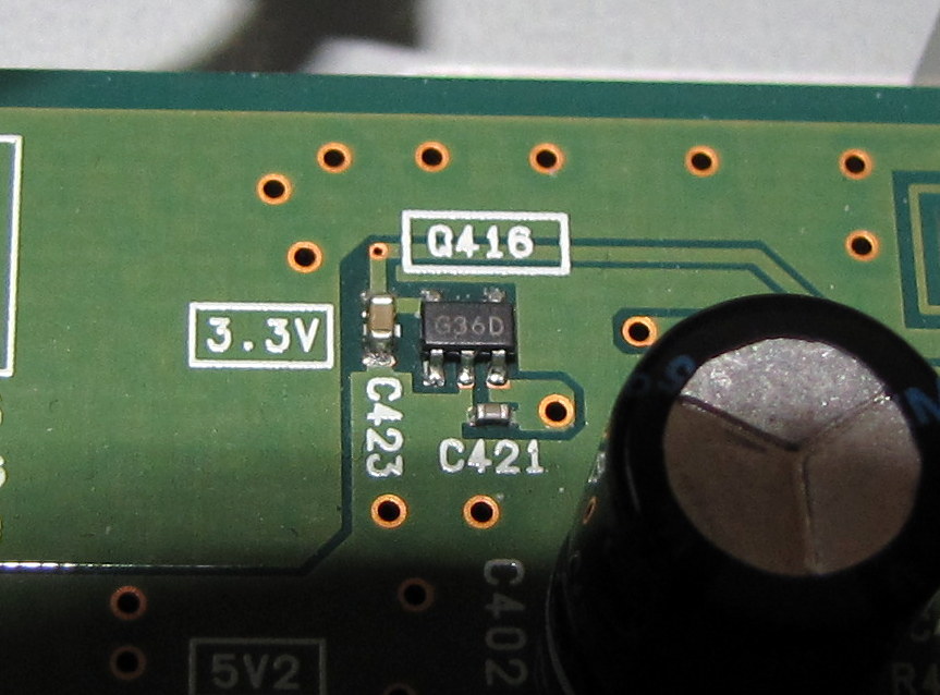

                    is the 5 pins IC the buck converter ? if it is then there is 3.3v output from it.
                    if not- how does it look like?
                    by the way i think that the processor is getting supply voltage because the signal named PWRTV which also comes directly from processor does come up to 3v while TV attepts to start. (though didn't really tested it because i don't have schematics of r8j66614fp processor )
                    thanks..
                      On mine it was a 5 pin SOT23-5 package (looks like this: http://media.digikey.com/photos/Micr...6-SOT-23-5.jpg)
                      You could tell it was a buck converter because it had an inductor and capacitor nearby. Since it was a synchronous type, it had no buck diode.
                                  I see CapXon's on the secondary, almost always a source of failure. Not bulged but they may be dried up.
                                    Wow, um, I didn't notice those -- Toshiba normally use decent caps. Shame Toshiba, shame...!
                                    • carbonfiber
                                      • Dec 2012
                                      • 49
                                      • Israel
                                      not so fast blaming toshiba! it's actualy me who changed the caps while trying
                                      to eliminate bad caps problem - without luck.
                                      if i manage to get the tv running i'll change those to something decent.
