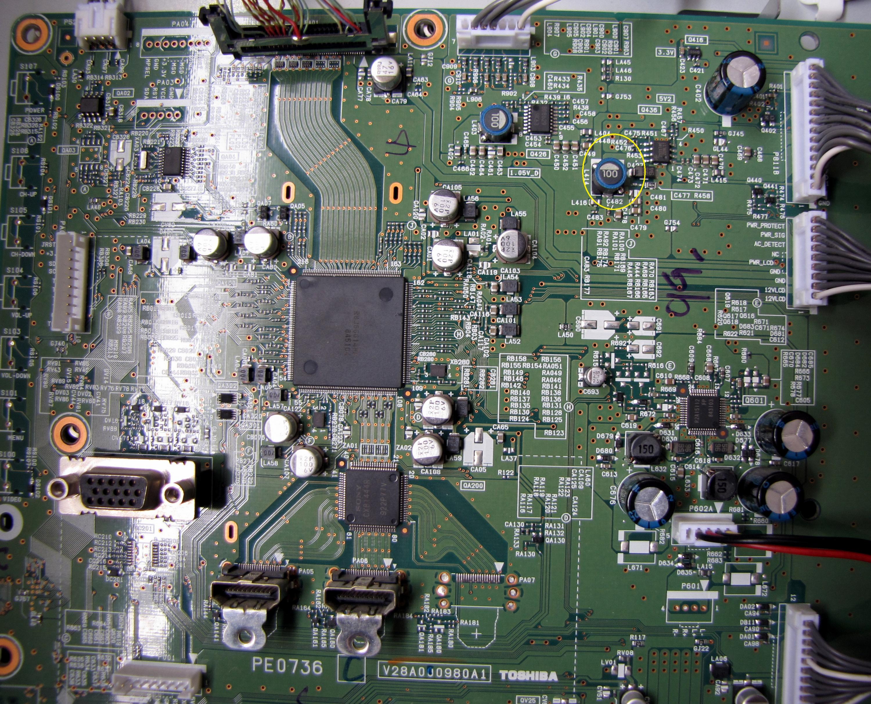

      This TV might use a buck converter to generate the 12V from the 24V or 18V line. As it only uses one transformer it's very unlikely one output could fail with the others good. I see at least one buck converter on there. The 18V is likely for the audio amplifier.
      Also, what is with the LVDS connector on the main board? Looks like it is lifted up a little?

        Re: Toshiba 37AV600T - not powering on
        the LVDS connector is lifted because i took some of the photos after taking apart the connectors..

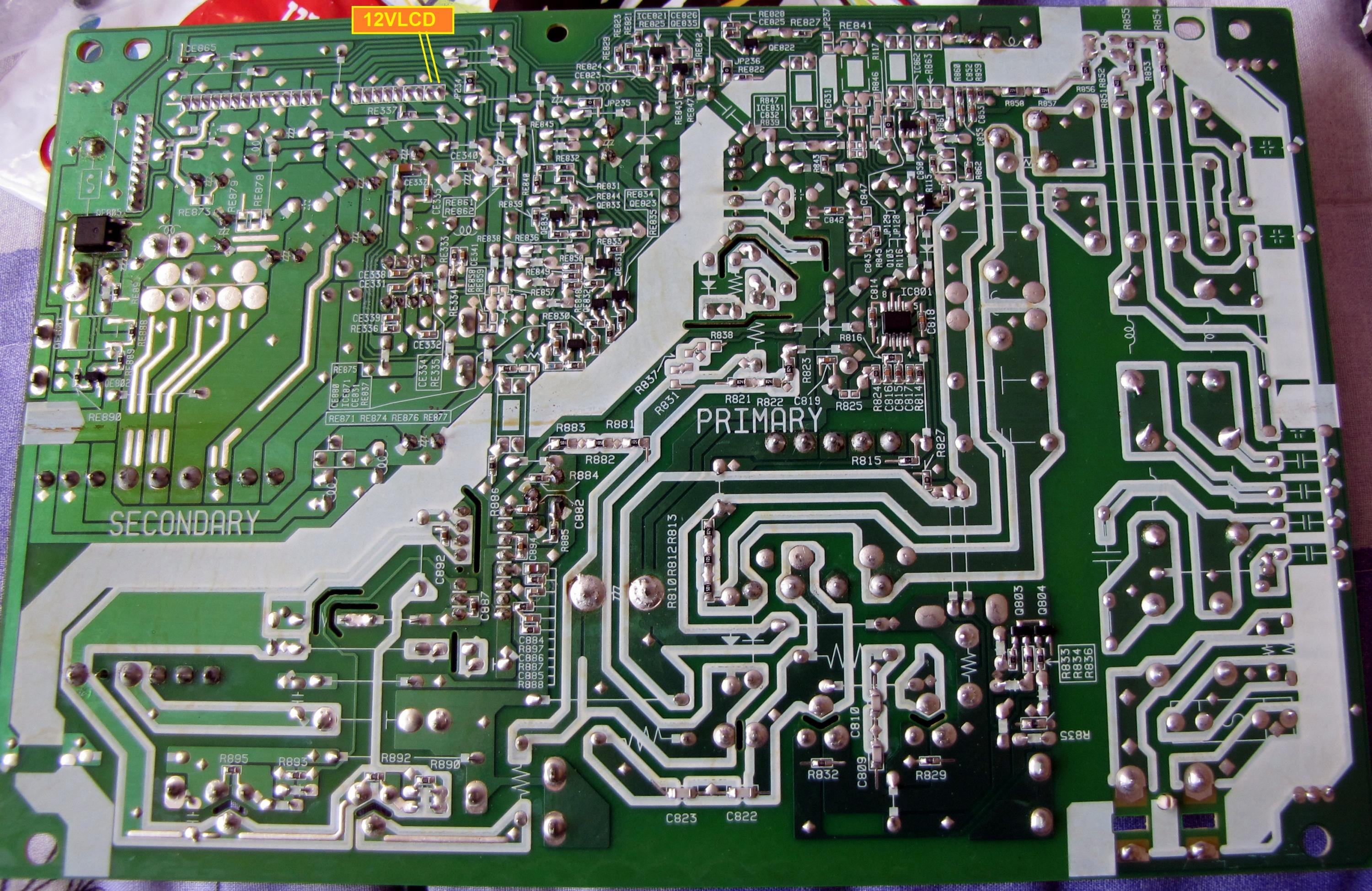

        about the 12v, there are 3 12v lines that supply constant voltage from PS to the main board. on the other hand the 12VLCD lines are always 0v.
          The 12VLCD may be the fault then. Can you get a picture of the reverse (green side) of the power supply?

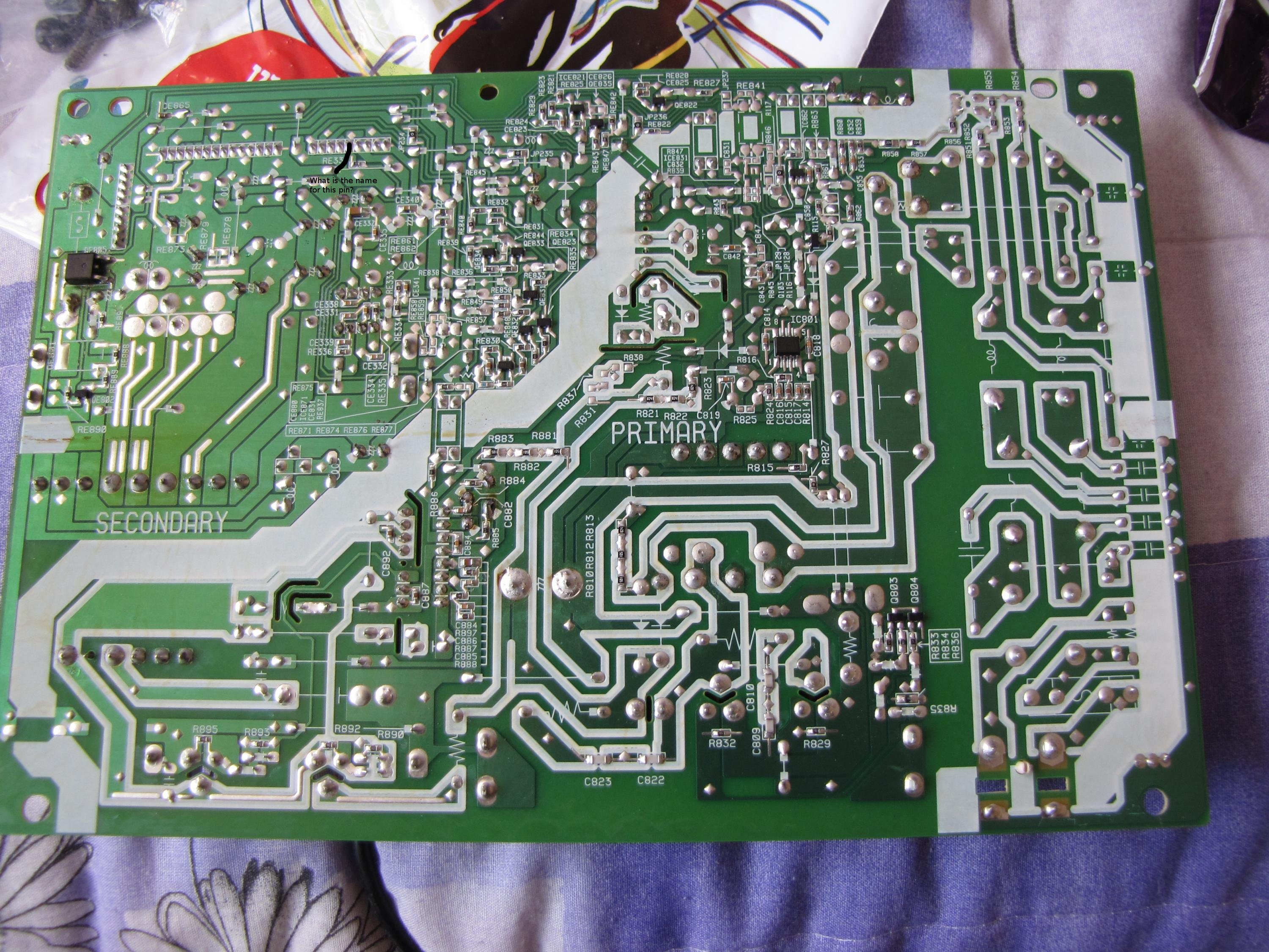

            there is a pic of it on the previous page.. if you need to zoom on some area please let me know.
              OK, didn't notice that, thanks.
              Can you highlight the 12VLCD pin(s) on here so I can trace it through:
              https://www.badcaps.net/forum/attach...6&d=1357033909

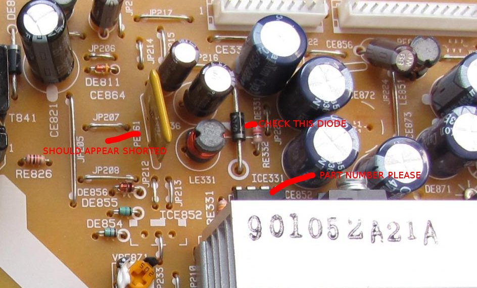

                  OK, see the attached image.

                    hey,
                    diode- seems OK, using multimeter in diode test mode, in circuit - 0.174v forward voltage and closed under reverse voltage.
                    yellow thing - indeed appears shorted.
                    IC - 8105QL , this one i think:
                    http://pdf1.alldatasheet.com/datashe...SI-8105QL.html
                      #30
                      OK, regarding the IC, is it possible to check the voltage on pin #2 (VIN.) It should be the same as pin #10 of P811A. Which voltage should that be (I understand you have a legend somewhere for the pins?)

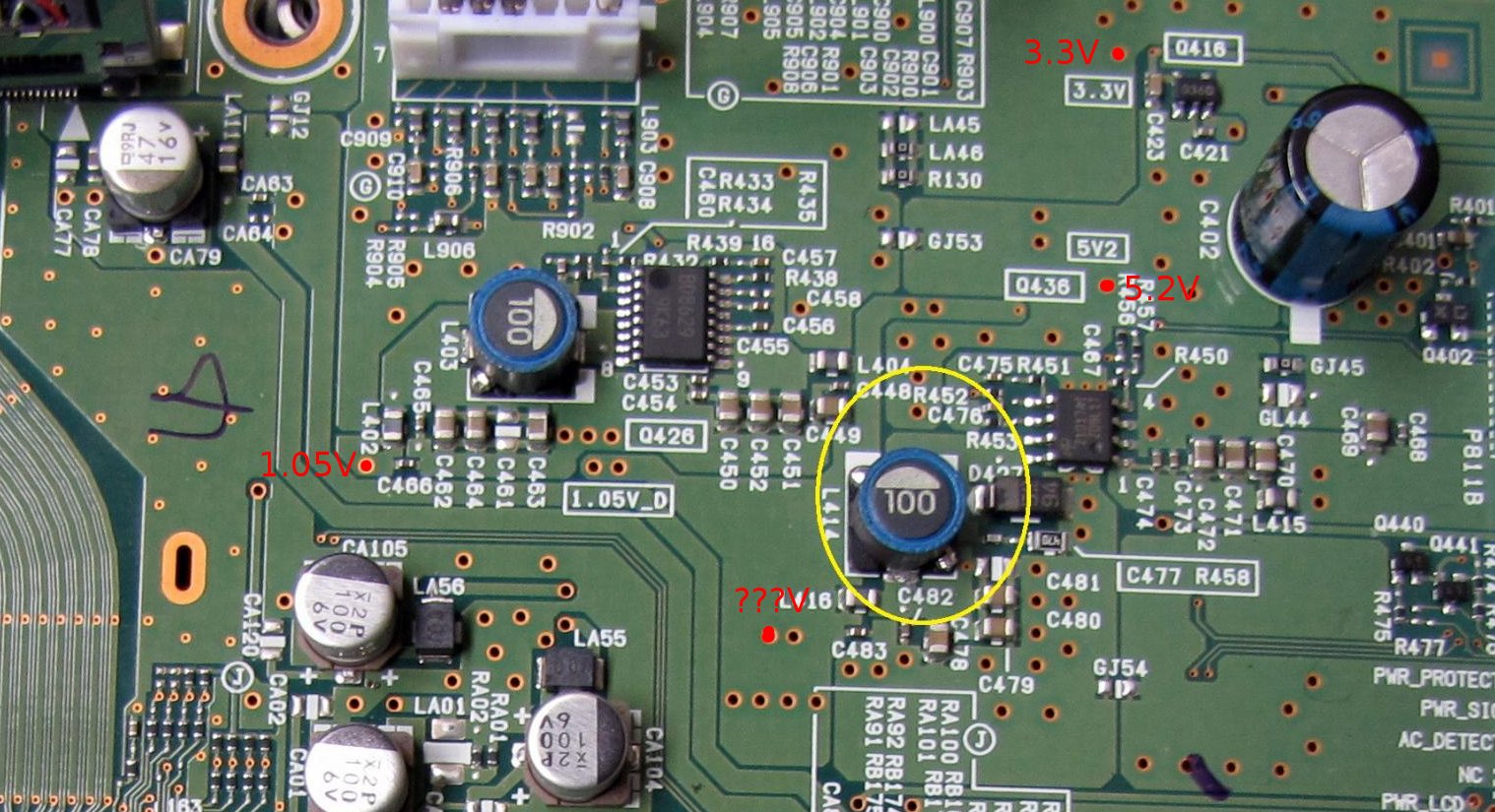

                                    when the tv tries to start, i hear high pitch noise from the coil (the one with blue circle and 100 written on it) i marked in the image.. when i press down on it with my finger it fades. can it be something meaningful ?
                                    again.. great appreciation for you trying to help me
                                      #38
                                      Someone has the board for $49 + $24 shipping; maybe you can negotiate it down.
                                      http://www.ebay.com/itm/BRAND-NEW-TO...-/170908118555
                                      Some test points in the image below to check.
                                        3.3v is availible on the smd cap right next to the 3.3v text point.
                                        can't find voltages on any other test points or anywhere near them. actualy they all seem to be in continuity with GND when the board is unplugged.
                                        another thing - those inductors with 100 printed on them, the one that i circled does get 1.8v when tv tries to power up, but his twin on the left doesn't show any voltage at all. this 1.8v sound like power to the processor.. no?
                                        BTW the board on ebay looks very refurbished.. caps are changed (original are blue) and what is that jumper going along all the board ?!
                                          #40
                                          The brown caps are likely originals before Toshiba started using cheaper caps on the main board. They are under less stress so it's usually OK. The wire might be a factory mod to fix a fault.
                                          The other voltages might not be present in standby.
                                          The CPU runs off +1.05V_D, I think...
