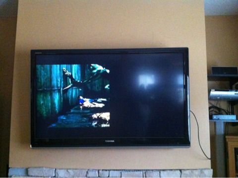

    Greetings All!
    I have a chance of getting a 'cheap' aka $20 LCD. But it's experiencing half panel issues.
    Recently it has had these vertical lines on the left side of the screen. Comes in and out
    In general, Is it a panel that's bad, or is it a board going bad? There's a few more on craigslist like this, but have been staying away from them in fear that it's the panel.
    Re: 52" Toshiba Regza - 52Rv53u - Half Side Issue
    Hmm. It is possible it is the panel. Then again, the t-con drive connections are always split in two halves for a 1080p screen. A loose connector could cause this. If it's coming in and out, it could indicate either...
    For $20, it's EASILY worth the parts cost, even if the panel is dead... I'd personally take a risk on it.
