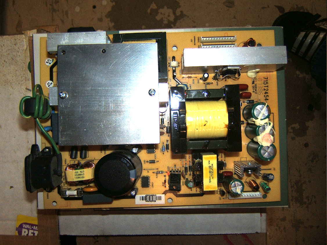

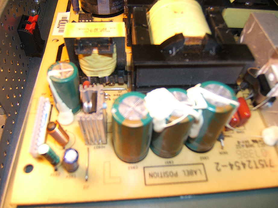

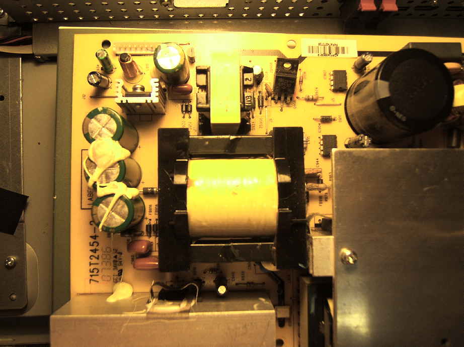

    NO Picture or sound. Checked all capacitors they all look good.
    I was watching tv and heard a firecracker sound and tv screen went
    blue in color. Need help. Model # 47MF437B LCD TV
    TV power comes on but screen stays blueish color.

    can you take pictures of some of the other parts of the set?
    also whats the model number of the set so people know what tv you have and can help easier.

      Re: Magnavox 47"
      Magnavox 47MF437B LCD TV
        Re: Magnavox 47"
        you should take more pictures thats just the power supply maybe the issue is else where.

          So the screen does stay lit up? Can you bring up the setup menu or it just have blue screen?
          And Yes, we need to see the rest of the boards and how they are connected together.
            Re: Magnavox 47"
            TV turns on but I only get a blue screen. I took off everything on back and checked out all three boards and all caps look perfect, no burn marks on boards, no melt downs.
            I will take some more pictures and get back. thanks for your time.
              Re: Magnavox 47"
              Check the fuse on the tcon.
              Do NOT touch heatsinks when testing for voltages as they may be LIVE!
                Re: Magnavox 47"
                That little fuse looks ok...it's all white inside and not broken.
                  Re: Magnavox 47"
                  What DC voltage do you get at bothe ends of the fuse? Can you post the pictures of the T-CON board?
