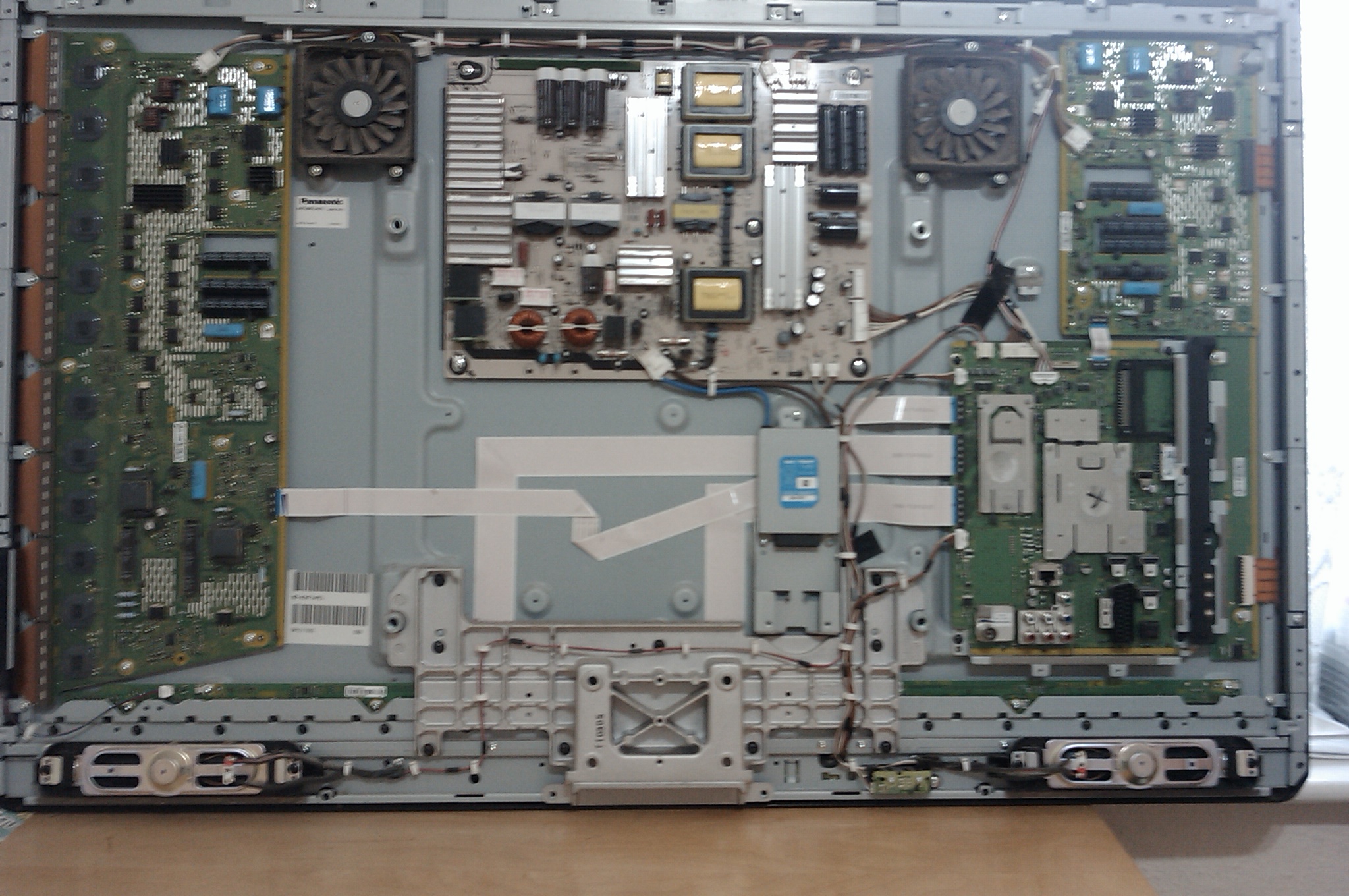

    Hi guys
    I am new to Plasma & LCD TVs concept.
    I know quite basics of electronics repairing, might not be called genius but to quite a good level.
    My friend has got a Plasma TV model no TX-P42ST31B. The screen is broken and asked me if it can be fixed, advised its no good idea as its gonna cost nearly same or more than a new TV. So another option was if he could sell any possible good parts from it.
    I have opened it and tried checking it but as I m new to this Plasma TV concept so have no much clue from where to begin. My general sense tells me to check it from Power supply. There are 2 fans on the back as well.
    All the boards and connections are properly connected, when TV is switched on, 2 relays try to switch on, fan does not spin, the front LED light flashes red for 7 times and just for quick 2 seconds there is high pitch noise somewhere from the bottom, then nothing happens and the LED flashing cycle continues.
    What do I do now, where should I begin.

      If the screen is broken, is there any way to check which boards are working, like by disconnecting any connectors and checking voltages at any test points?
        Re: Panasonic Plasma TX-P42ST31B - broken screen
        You can check for good Vsus (200V or so); this will indicate if PSU is good and output is not shorted.
        Sometimes the SN and SS have LEDs on them.
        Note this TV uses a combined SC and SU/SD, to make one board, SN.

          There is no printed mark or sign for "Vsus" (or "Va" or "Vs" like other plasma power supplies) anywhere on this power board?
          As you can see from above pic there is only 1 cable with 2pins going from Power supply to "sc+su+sd = SN board (left board), should I check the voltage there?
            Yes, that is the Vsus power connector. Be ware with 7 blinks it will shut off quickly.
            I am going by some Panasonic PSUs that have these test points. This is a very new generation 2011 plasma, I haven't seen inside one of these. I have only seen inside a 2005 (I think) and 2010 generation.
            Another thing -- if panel is cracked it should buzz loudly until it shuts down.

                I have now connected all the boards and cables, kept note of all voltages at various test points, here are those..
                The details are of 2 conditions, once power on and then the voltage levels in next 15-20 sec...
                SN Board:
                # VSUS 207v in 15-20 sec it goes down to nearly 9,8,7 etc to 0
                # TPVAD 74.... 0
                # TPSOS6 4.28... 0
                # TPSOS7 0.66 ... 0
                SS Board:
                # TPSOS8 5.. 0
                # TPVe 155... 0
                # TPSS1 (H.V. Dnager point) 40... 0
                # VeRef1 2.5 .... 0
                # VeRef2 2.5 ... 0
                # P15v 15 ... 0
                # P5v 5 ... 0
                # TPSUS 207 ... 0
                it seems all voltages are coming and then dropping, do u think is there any short in any boards or is it just the Protection mode kicking in due to broken screen.
                  I would guess protection mode. Nothing seems obviously abnormal.

                      In the worst case, any defect will be limited to the SN (scan board) == Y-sustain. Offer a return policy on the parts in case they are failed.
