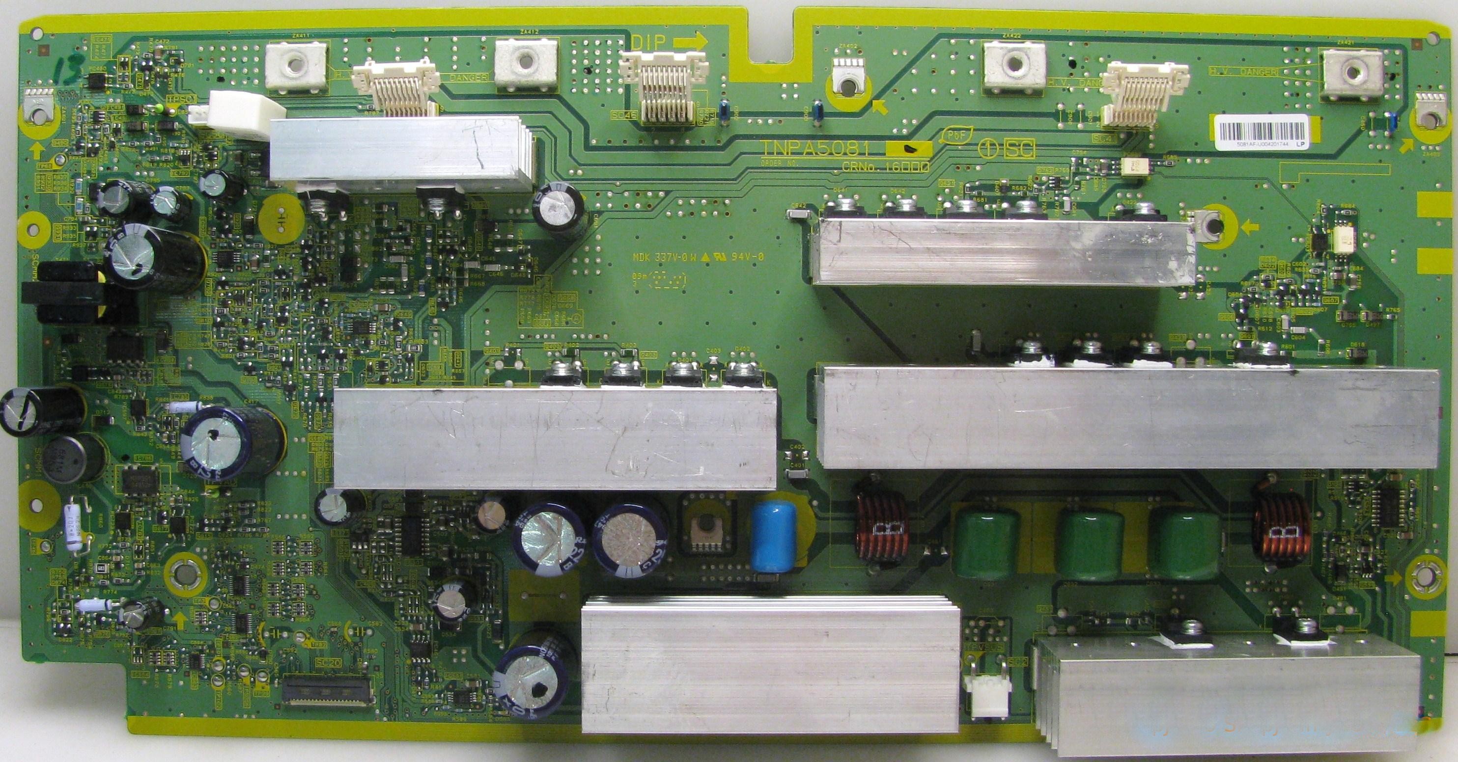

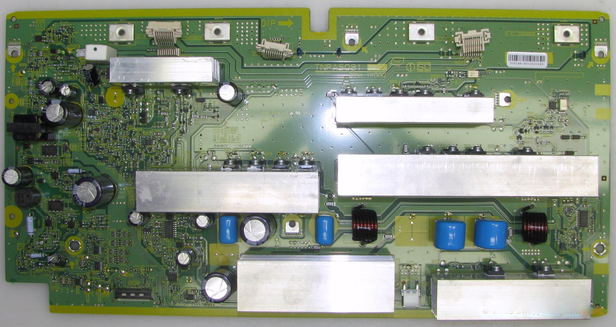

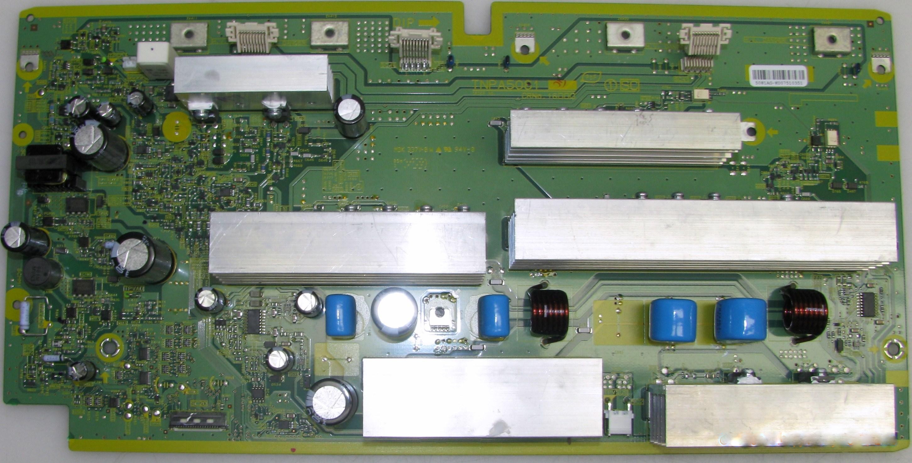

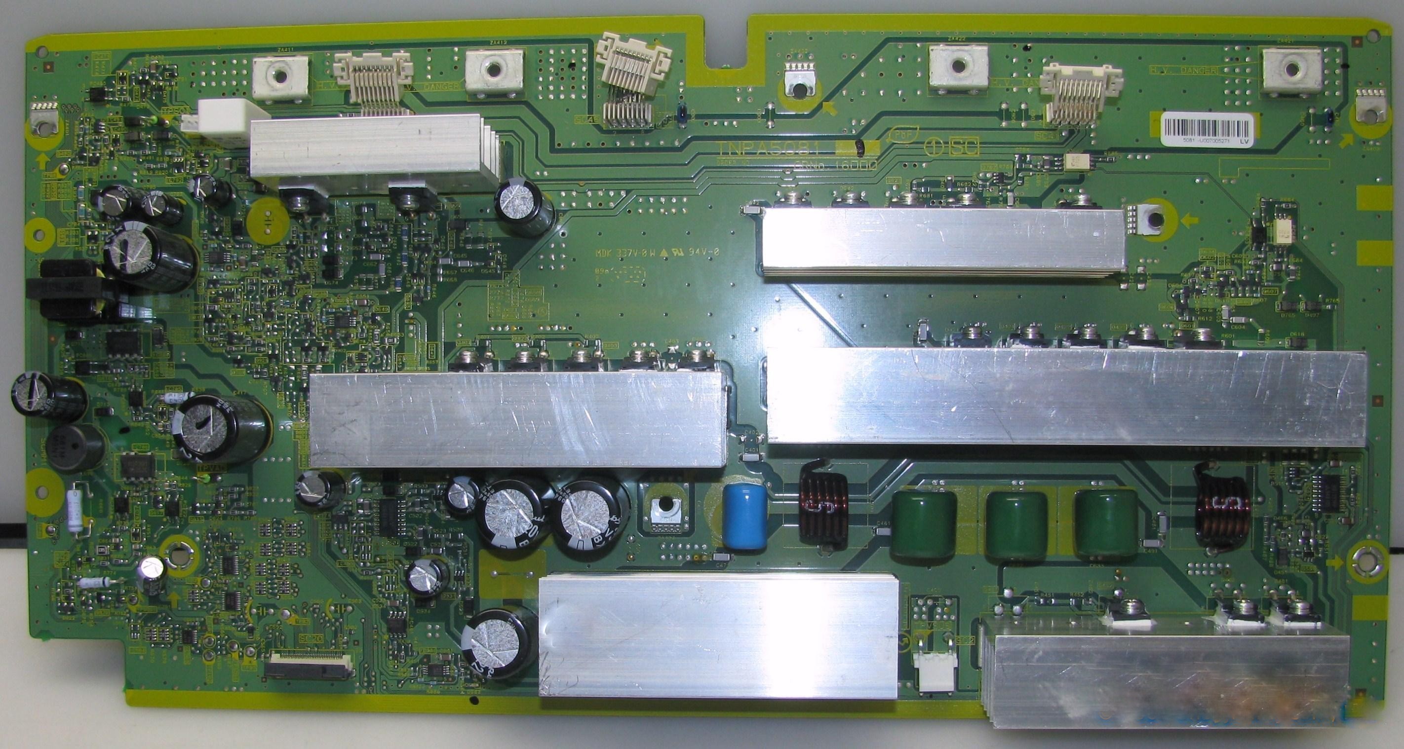

          Re: Panasonic TC-P42G25: No Power with 4 LED Blinks
          Here's some examples, 42,46,50,54 left to right
            The lower screen size versions are just cut down because they don't have to drive such a large plasma panel. In theory, you should be able to get away with a larger screen size board in a smaller model -- don't quote me on this though, there may be other differences.
