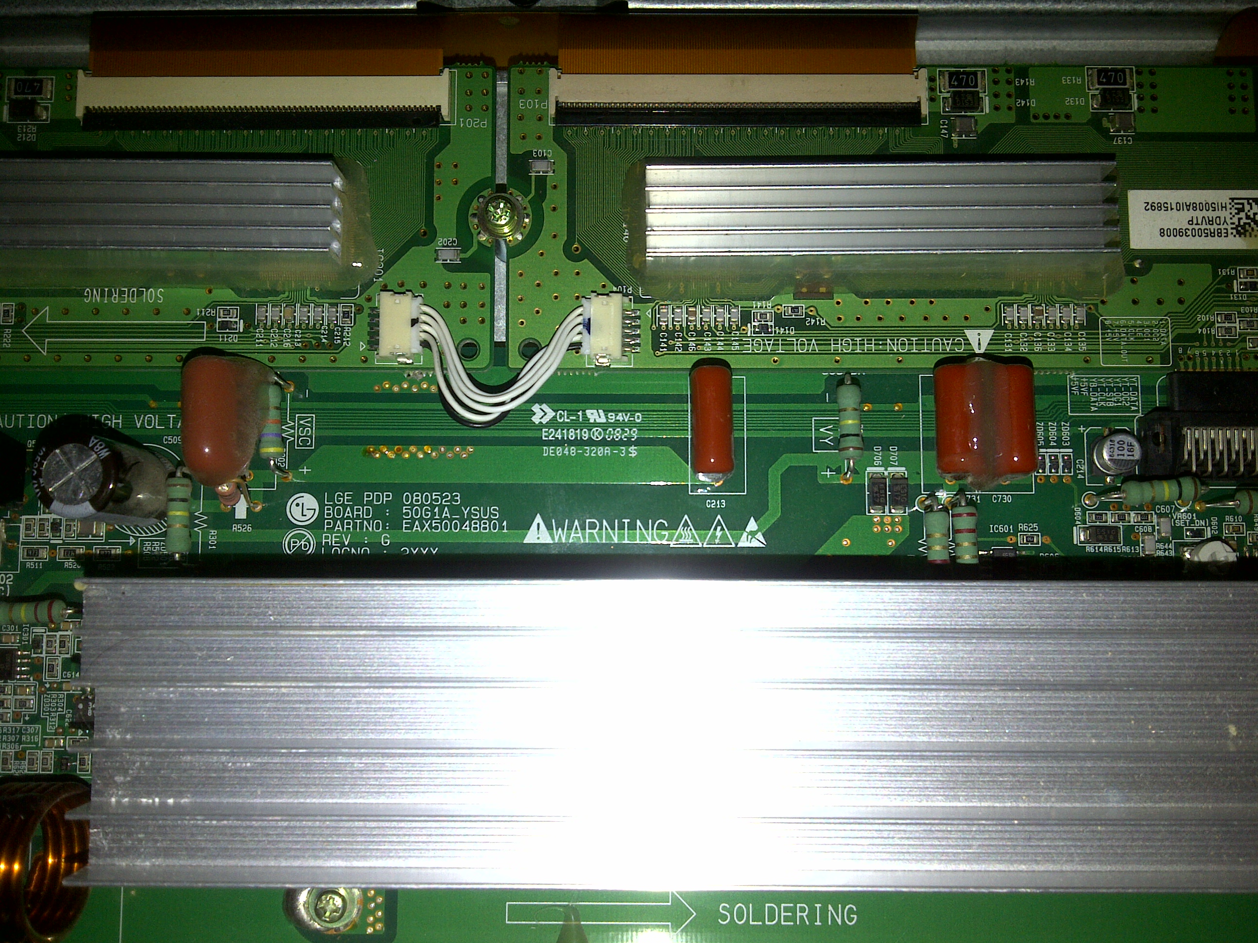

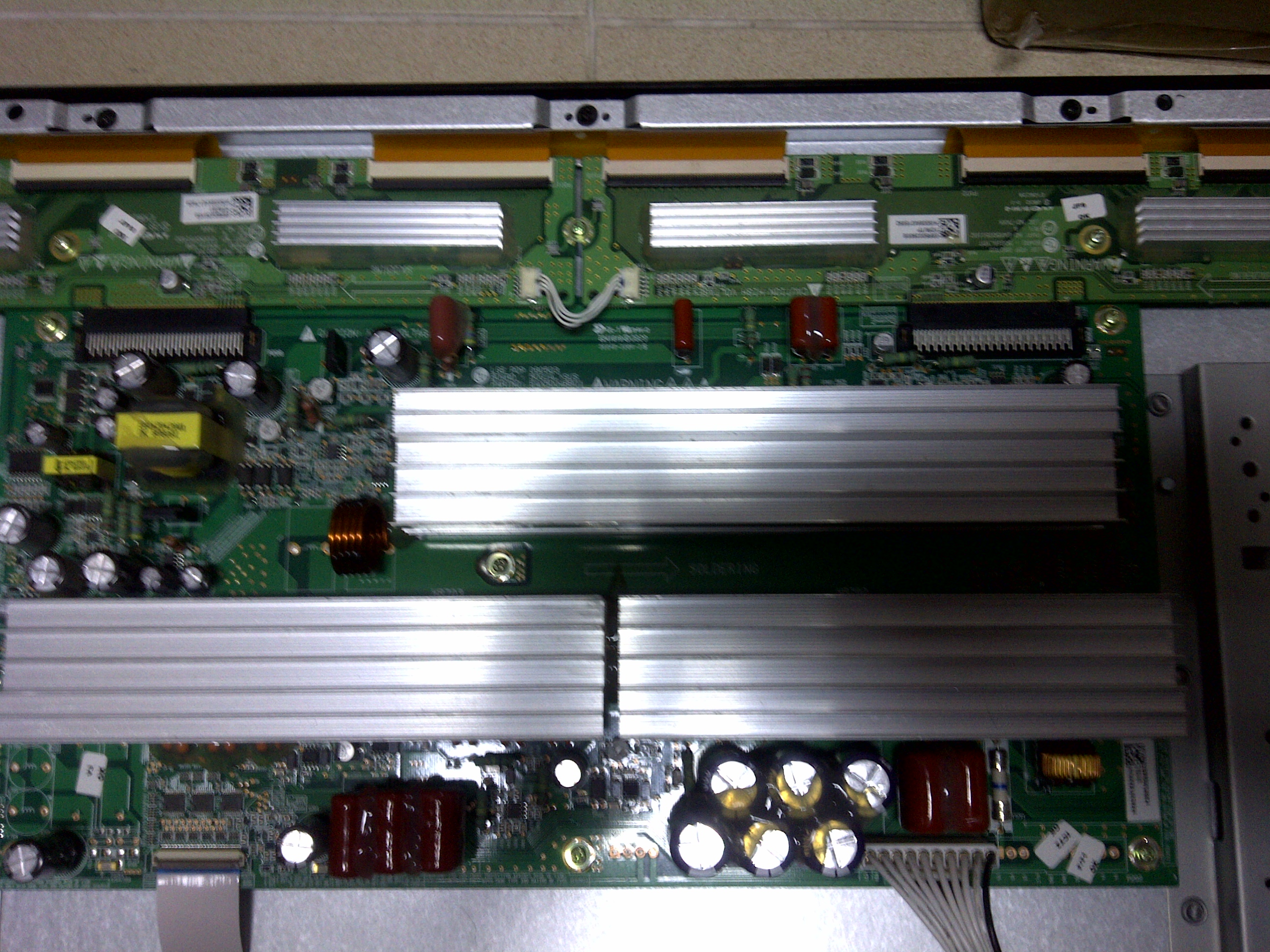

        Re: LG Plasma 50PG100R Problem
        OK, your supply voltages are good, and well matched with the sticker.
        Can you post a picture of your Y-sustain - some other checks can be done.
          Sure thing, sry about the quality
            Tiny gold plated fuse by the ribbon cable - is this OK?
            Check for Vs on both ends of fuse - should be the same.

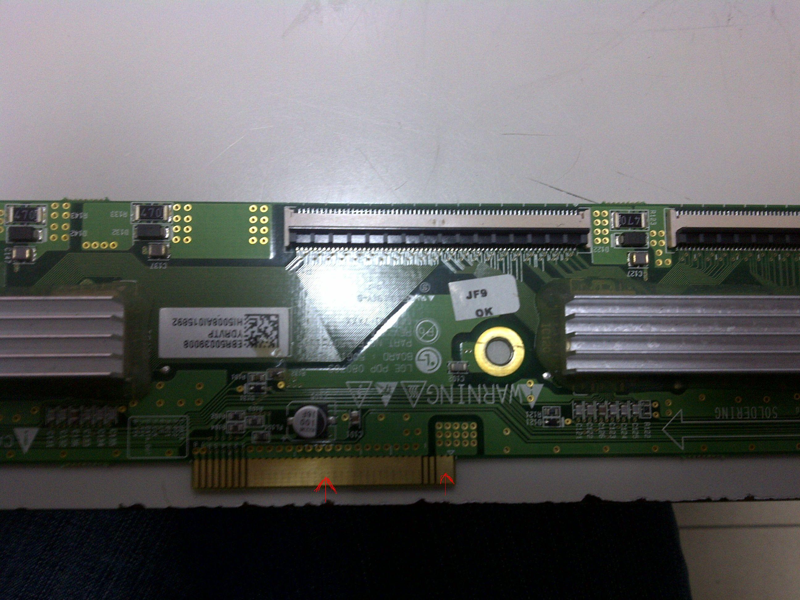

                      Just a bit of help as my Y-buffers are a bit different from those in the site, are these the correct spots to test with the DMM?
                        Those look like the right places.
                          Doing the diode test shows 0.068V on both positions, the bottom ones show 0.531V on one position and OL in the other, so i guess the top ones are busted.
                          Do you know any reliable place that ships to europe?
                            I have used flattvparts.co.uk before. Their prices are generally low, but they are often out of stock, possibly because their prices are low...!
                            Both the buffer outputs are shared on most plasmas. So if one is killed by the Y-sustain, the other should be too. It is possible (though very rare) that the plasma panel has an internal short circuit between some lines on the screen which has damaged the buffer.
                            If you are brave you can attempt to find which buffer chip is failed but you will need a high current DC power supply. If you apply DC to the test points in the direction reading OL on the good buffer (tested on the bad one of course) you will find the failed chip will get hot and maybe even smoke a little. Don't do it for too long of course. If it is failed in the same place for both of them, I would suspect the panel.
