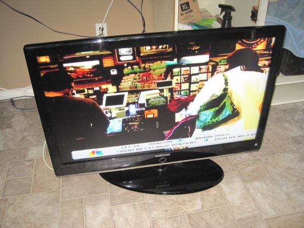

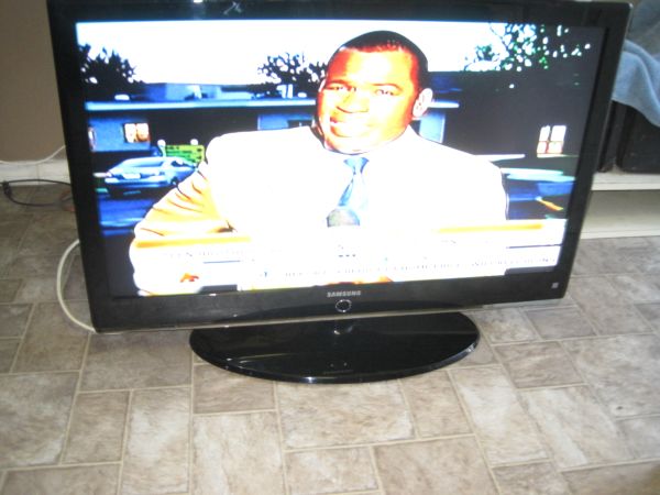

    Found on CL this TV and this is the issue(check pictures).
    What could be the problem, main board?
    Re: Samsung LN-T4061F possible purchase
    I can't see a fault? Looks a little over-saturated maybe?
      That's what I see too, but what that can be? Maybe they replaced the mainboard and did not set the parameters right?
        this may sound stupid but have you tried going into menu/settings and playing with picture settings? im sure theres something wrong but maybe you can get it looking better.
                Please tell me kids don't have 40" LCD TVs in their bedrooms.
                Other than that, it might be panel config or contrast/brightness set wrong.
                          Looks like the T-con to me. I fixed the 46 inch version of this set. Over saturated on the reds in my case and reseting the picture to factory defaults did not improve it. Replacing the T-can fixed it.
