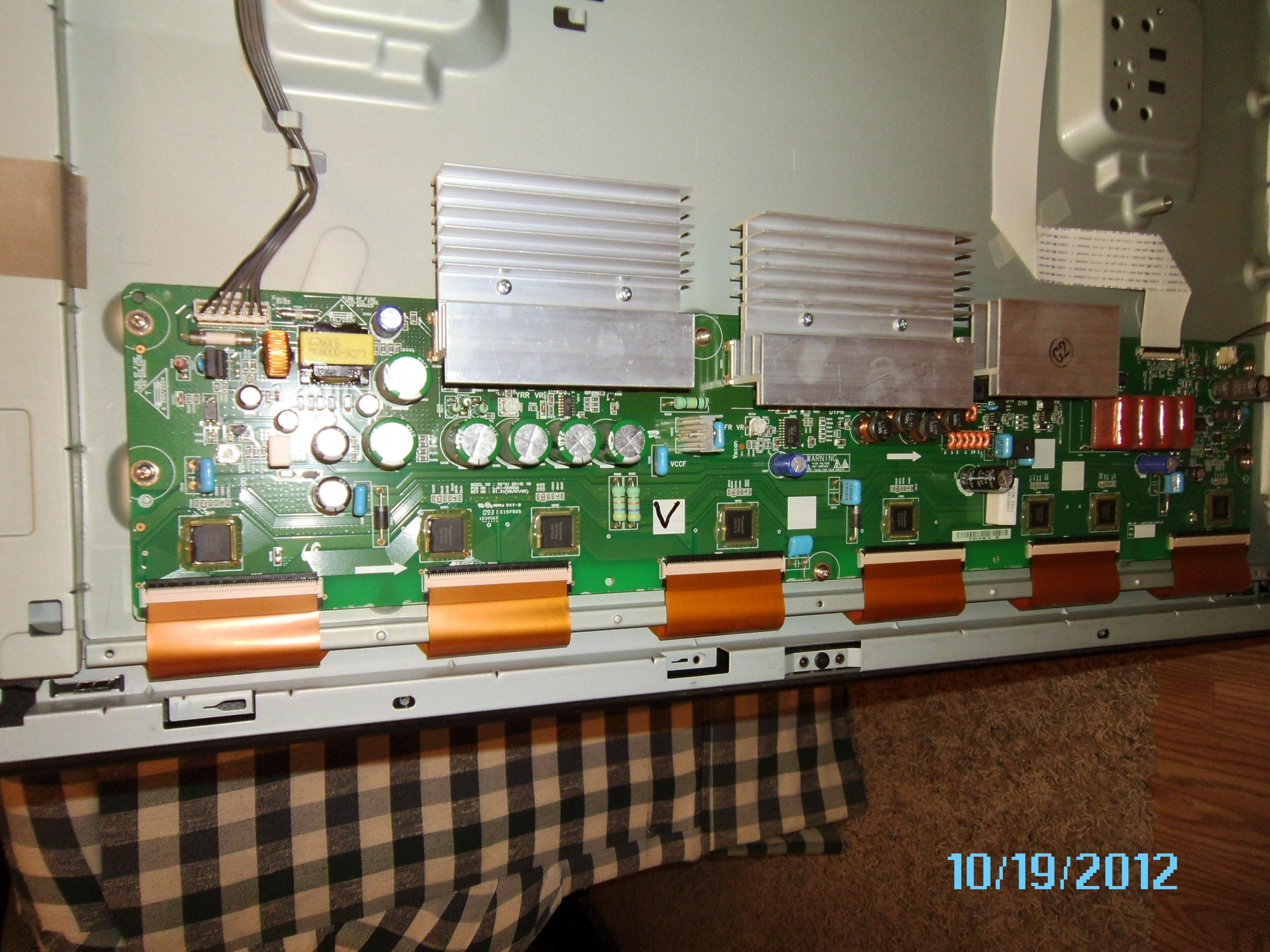

    Hello ALL,
    Im am new to the forum and I am hoping you can help me out, picked up a insignia p501q-10a. When power applied tv tries turning on then shuts off quickly with a clicking sound. Measured VA,VS all normal and holding steady, have it narrowed down to bad Y board. Y board # Lj41-05905a, I found a mosfet location Q5007 that is shorted. The problem is the part number reads "20Z" thats all! Im having a heck of a time finding a replacement, digikey is clueless. Where should I look?

                  I just tried with my camera, and phone. Zoom is horrible, just fuzzy picture of it. I was wrong the number on the part is"Z02" not "20Z". Its a surface mount 2 legs on one side, 3 on other.
                    Re: insignia p501q-10a MOSFET IDENTIFICATION
                    Not a FET, then... how are you testing it as shorted?
                    Possibly SOT23-5?
                            I dont think I can remove the buffers they are built into the y board. This is a very odd unit.
                              Can you post a picture? Not seen that before on a Samsung.
                                  Ah, I was wrong - Indeed, I have seen this before, but it is a rare board.
                                  Someone else had a similar issue - this may help in diagnosing your problem. It was on a Samsung plasma, but using the same parts as yours I think:
                                  https://www.badcaps.net/forum/showthread.php?t=18434
                                    Okay I have found some shorted components on the bottom heat sink. Also tried to unplug y board and just use x sustain, Im not getting any sound, but power does stay on.
