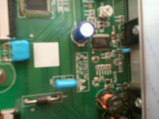

                  Toilet paper roll Idea was spot on!! I found a 20 leg #IRS219565 is what I think is clicking. What is it, what does it do?

                    Re: insignia p501q-10a MOSFET IDENTIFICATION
                    Please post a clear picture of the area of the board where you think the clicking is coming from.
                      This is the best picture I can get, the little black IC right of the blue cap is what I beleive is clicking.
                        #31
                        That is a gate driver IC. That could be clicking if the FET near it is shorted.
