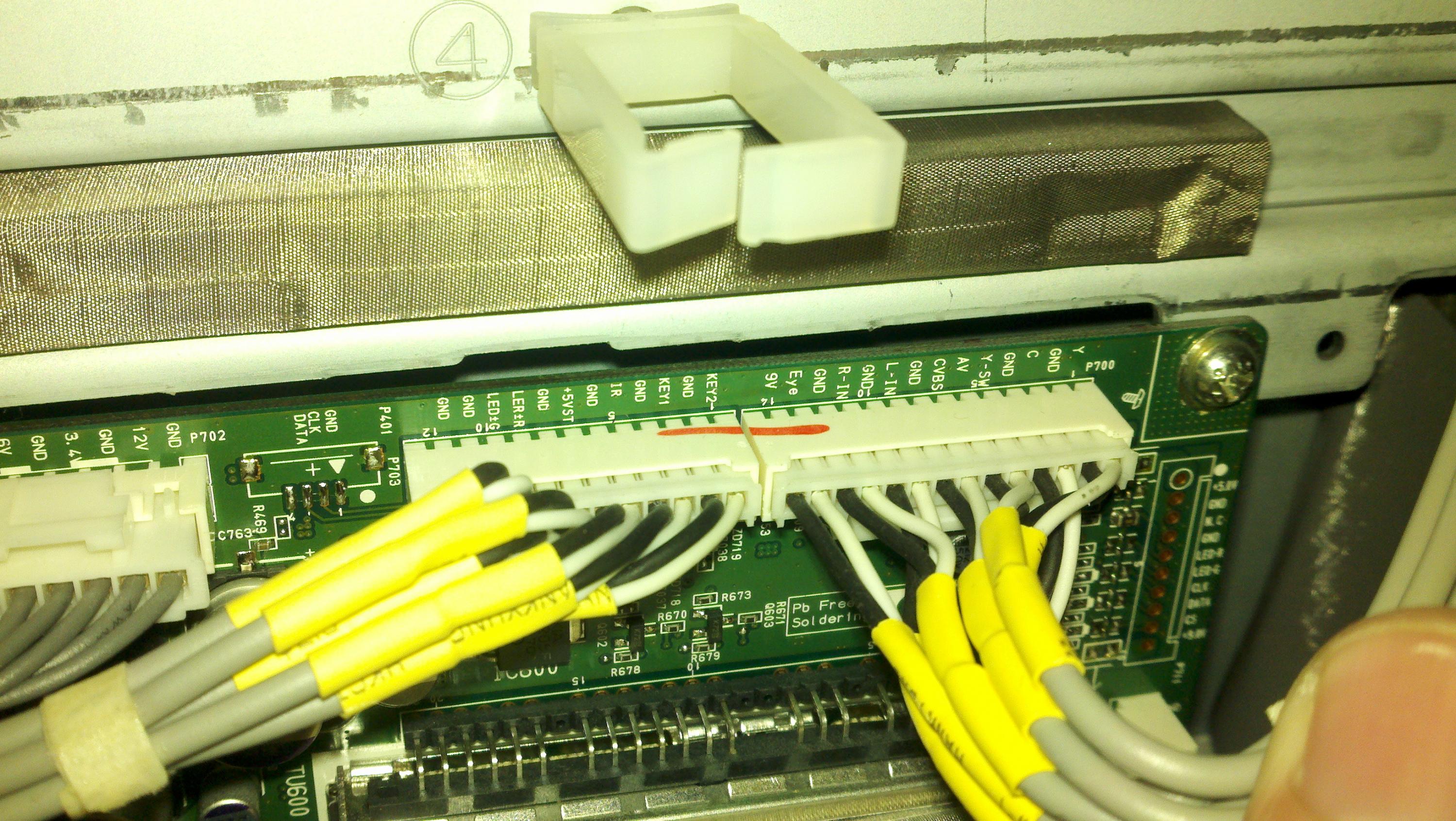

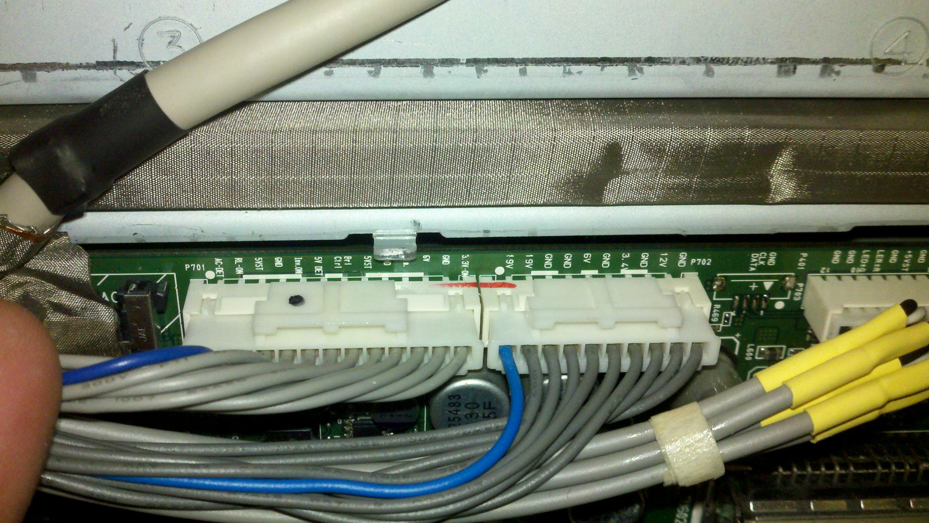

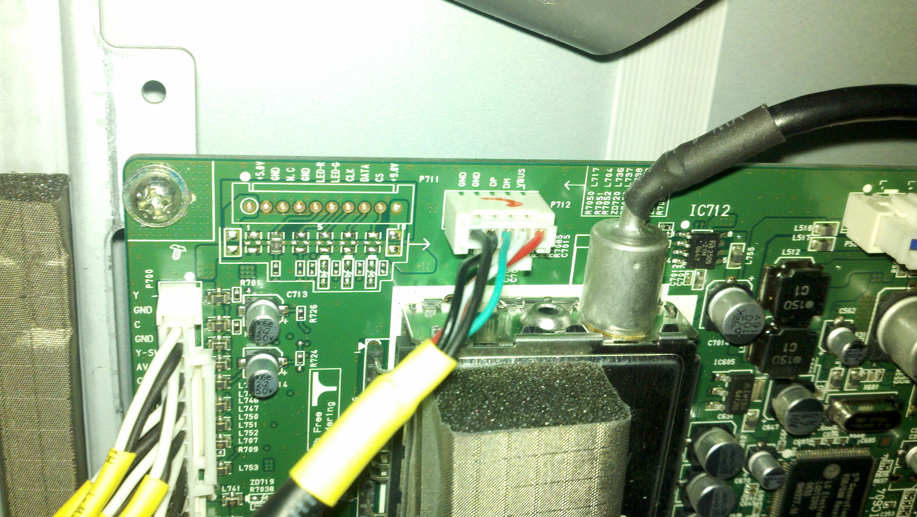

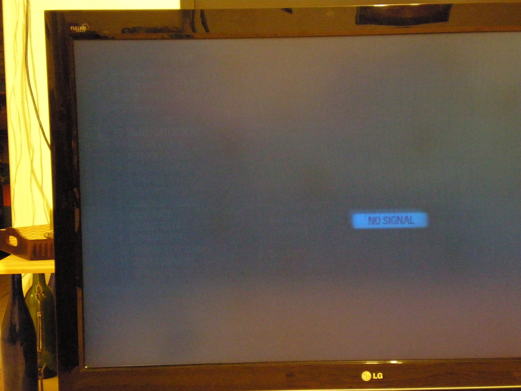

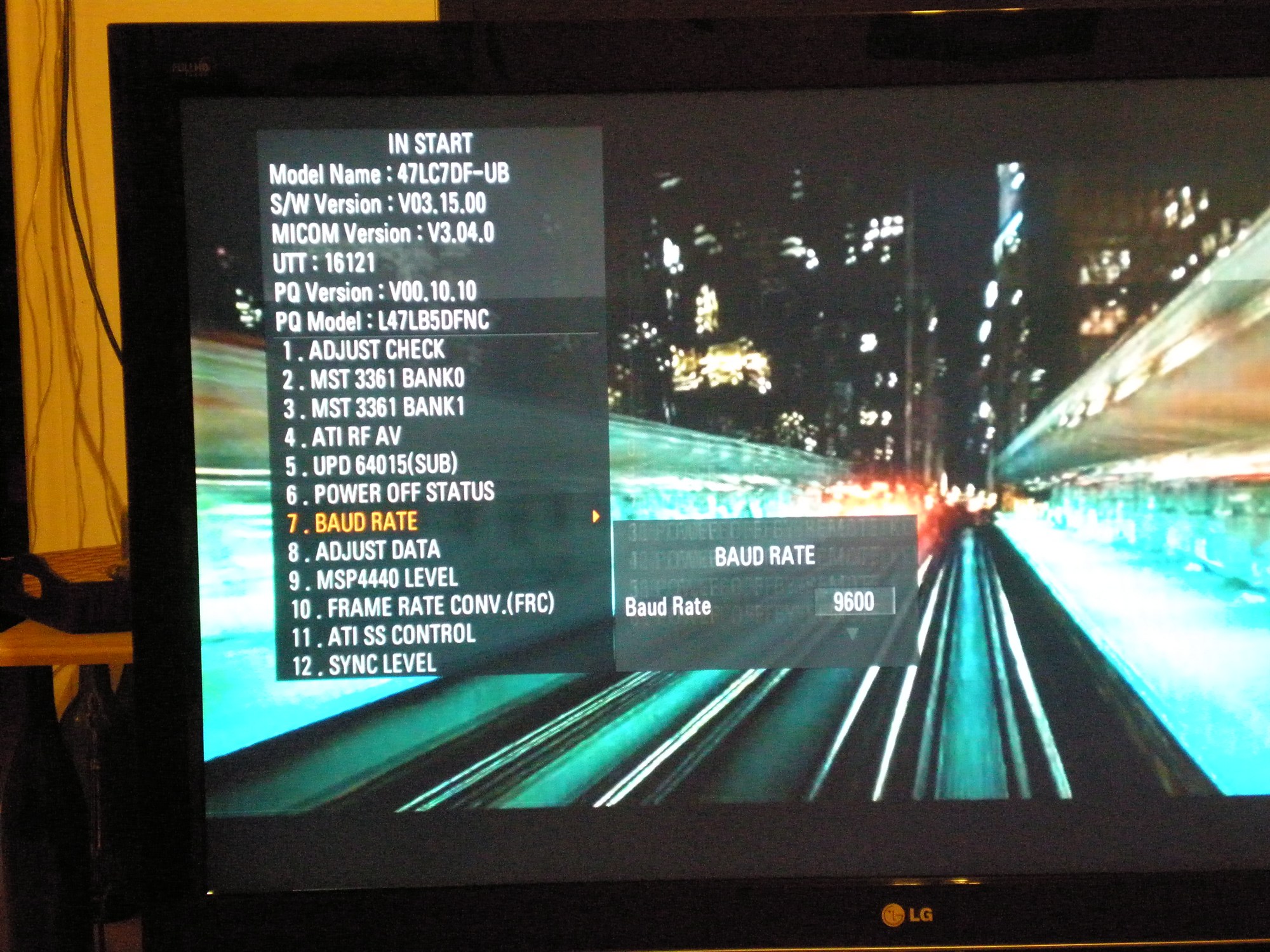

    Hi, I have been lurking around the site for a while reading posts and searching to try and avoid members having to repeat themselves but I've finally decided to register and begin participating. I am hoping that you all might have some insight into isolating the source of the issue I'm having with my tv. I believe I have narrowed it down to the power supply or main board but would like some ideas on how to confirm it. To start I apologize for the long post. I am hoping to get as much of the meat and potatoes out on the table to minimize the back and forth with little stuff.
    The TV is a LG 47LC7DF-UB.AUSLLJM which, when turned on with no devices plugged in would display a “no signal” image which scrolled around the screen. I then turned the tv off and plugged my PS3 through the component jacks. Upon startup, the red led turns to a green flashing led for approximately 5-10 seconds then to a solid green indicating "normal" operation. The green led blinks when a command is issued from the remote. The backlight does illuminate at power on and stays on but the on–screen menu/ images do not display. I repeated this test with various inputs, all with similar results. Next I unplugged everything and the “no signal” image returned. Although not usually advisable, I plugged in my PS3 with the tv still powered and the attached image is what I observed. It's the menu screen for a Blu-ray movie in my PS3. There are three horizontal bands with different shading and a small single horizontal row of lighter gray (same as the next higher band) pixels just below the half-way point on the screen.

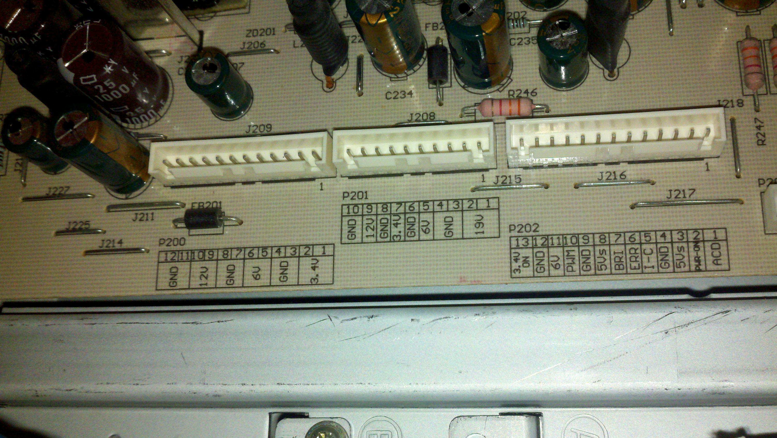

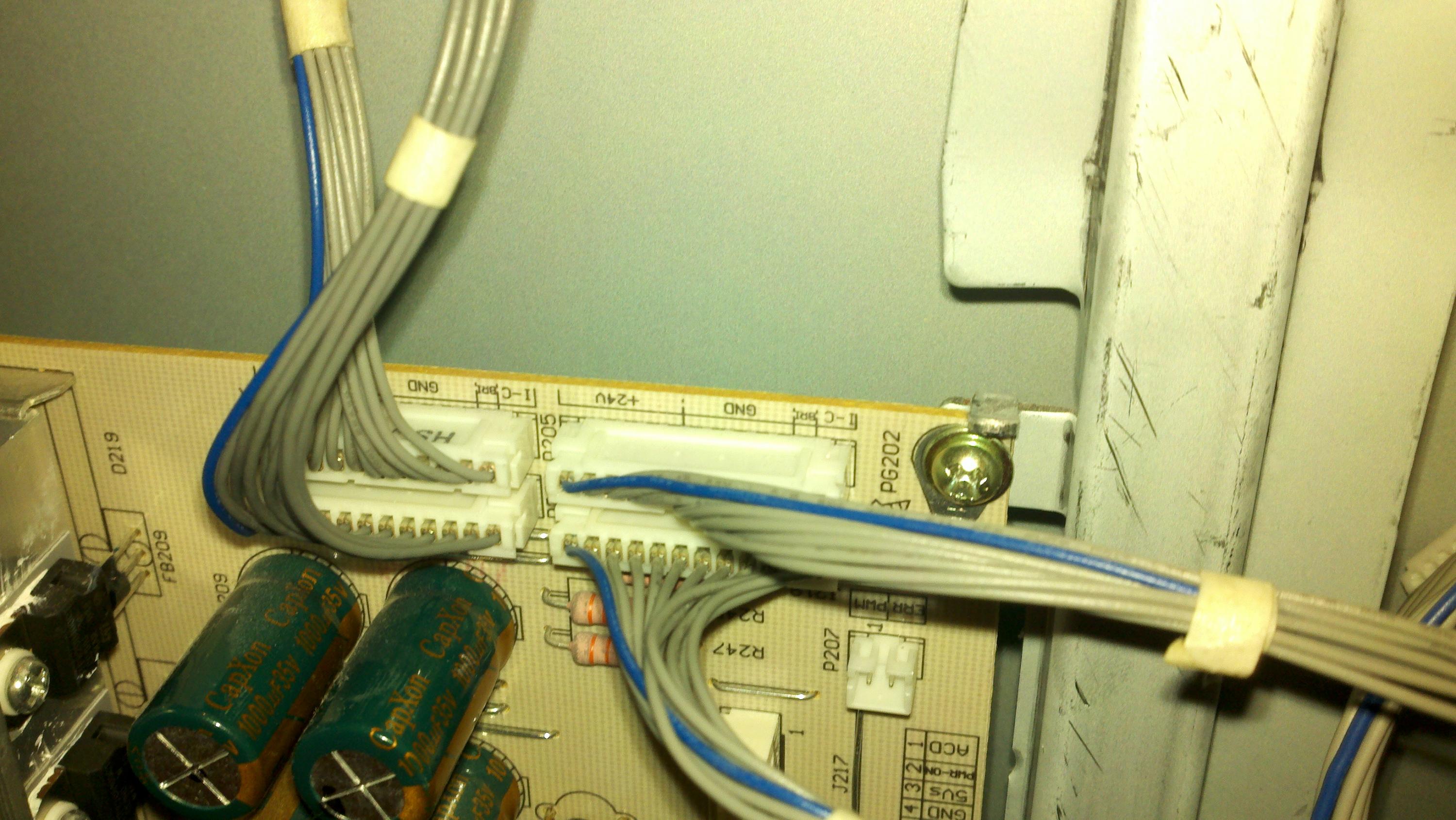

    At that point, like many others, I opened up the back of the tv expecting to see bulged/leaking capacitors but all the caps in the power supply appear good visually. After reading on here that some caps will test badly even though they look good I started measuring the power supply voltages.
    Main board number: EAX32740501
    Power board number: EAY3281690
    The following are the voltages measured (in Volts) at the corresponding connectors

    I will post up some hi-res board images shortly. Thanks for the help,
    Brian

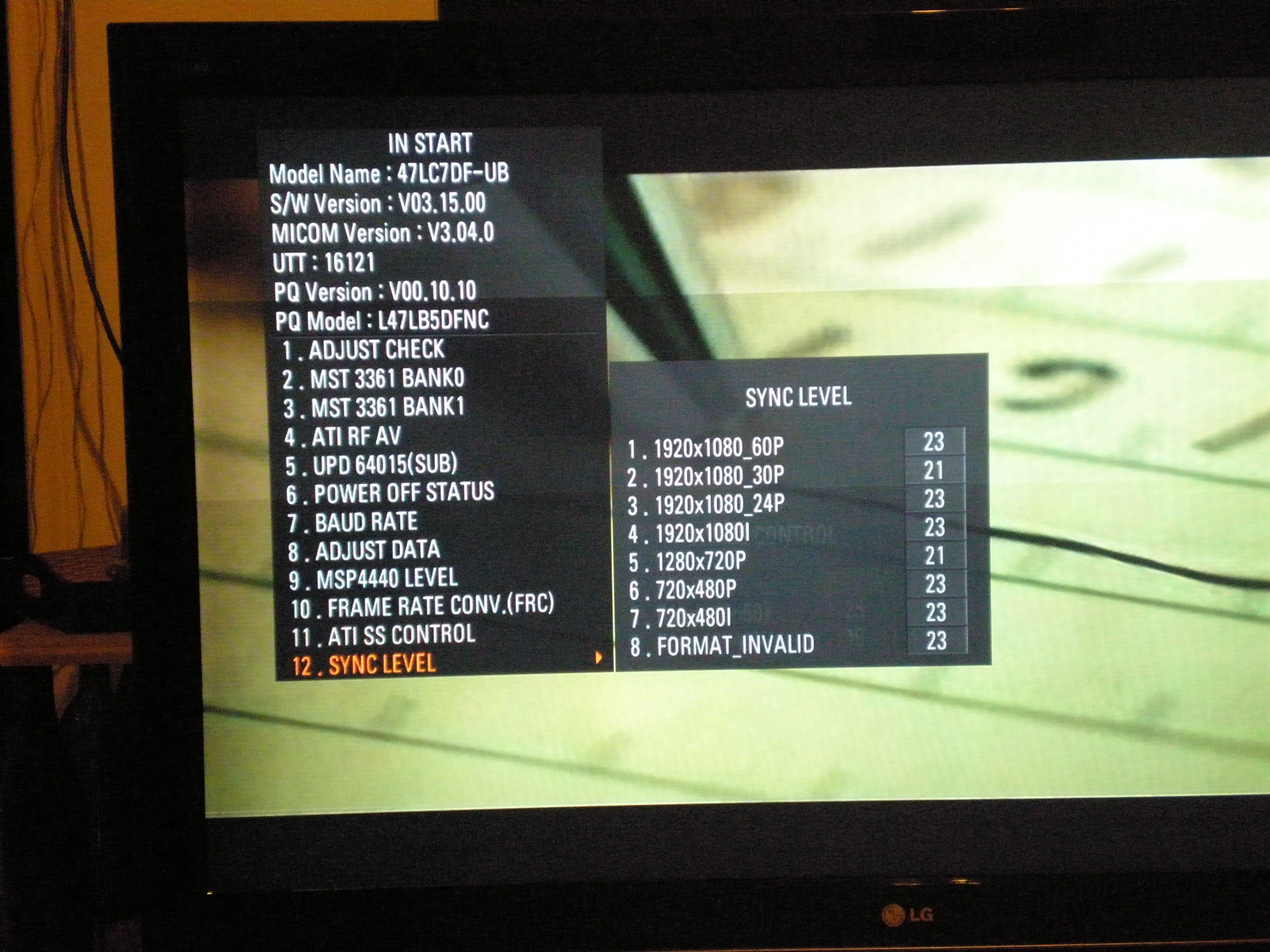

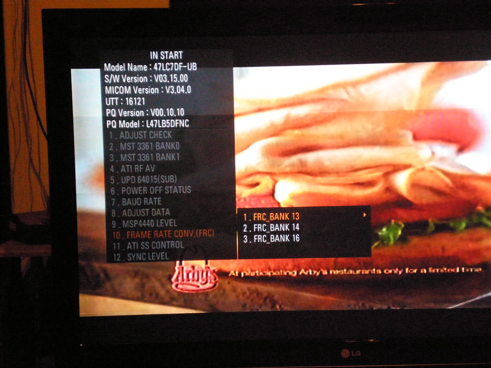

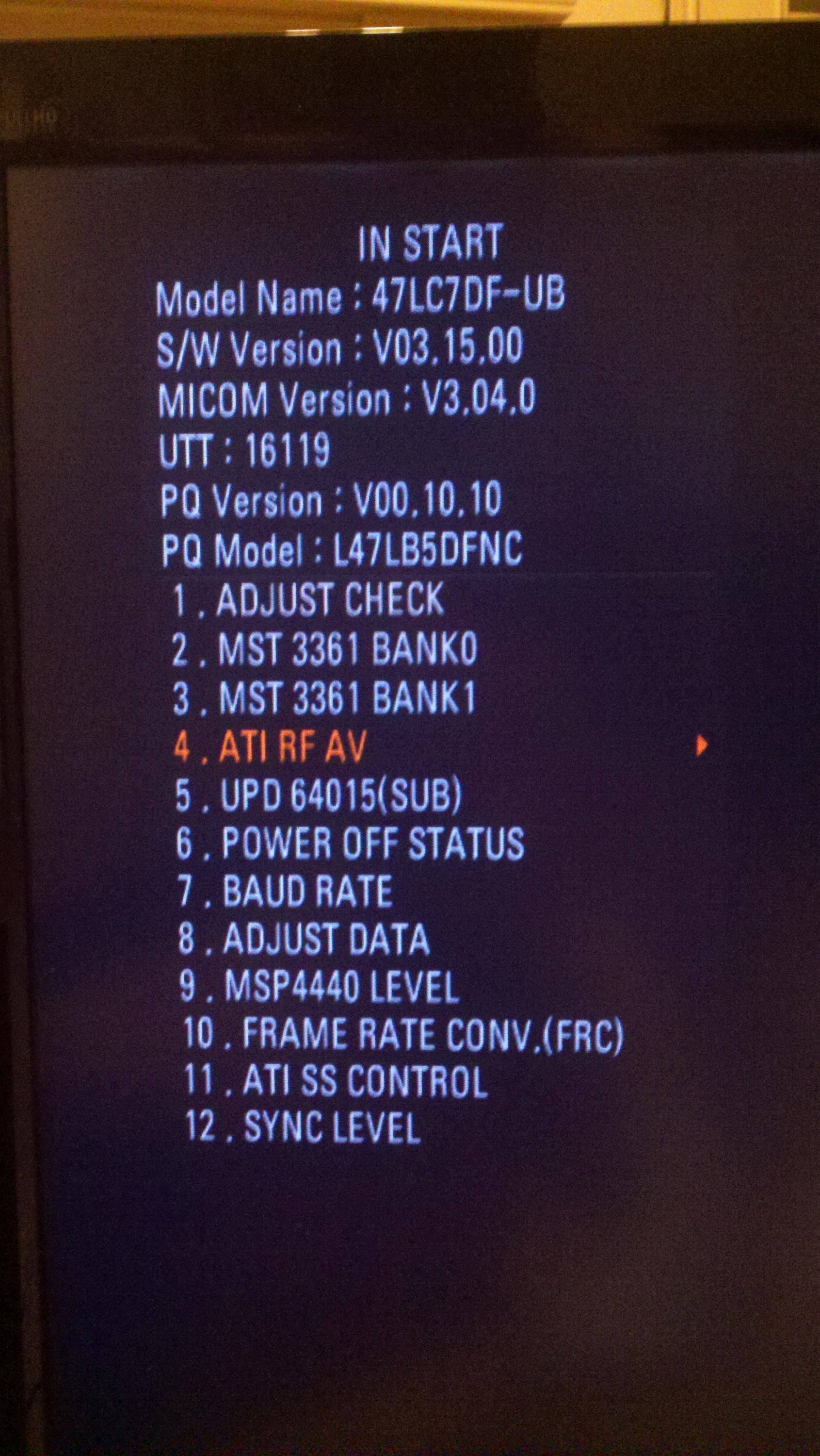

          Since you get the NO SIGNAL display have you tried getting the service menu up and seeing if that appears OK? Hold MENU on TV and MENU on remote at the same time.
          • UsAndThem
            • Sep 2012
            • 18
            • US

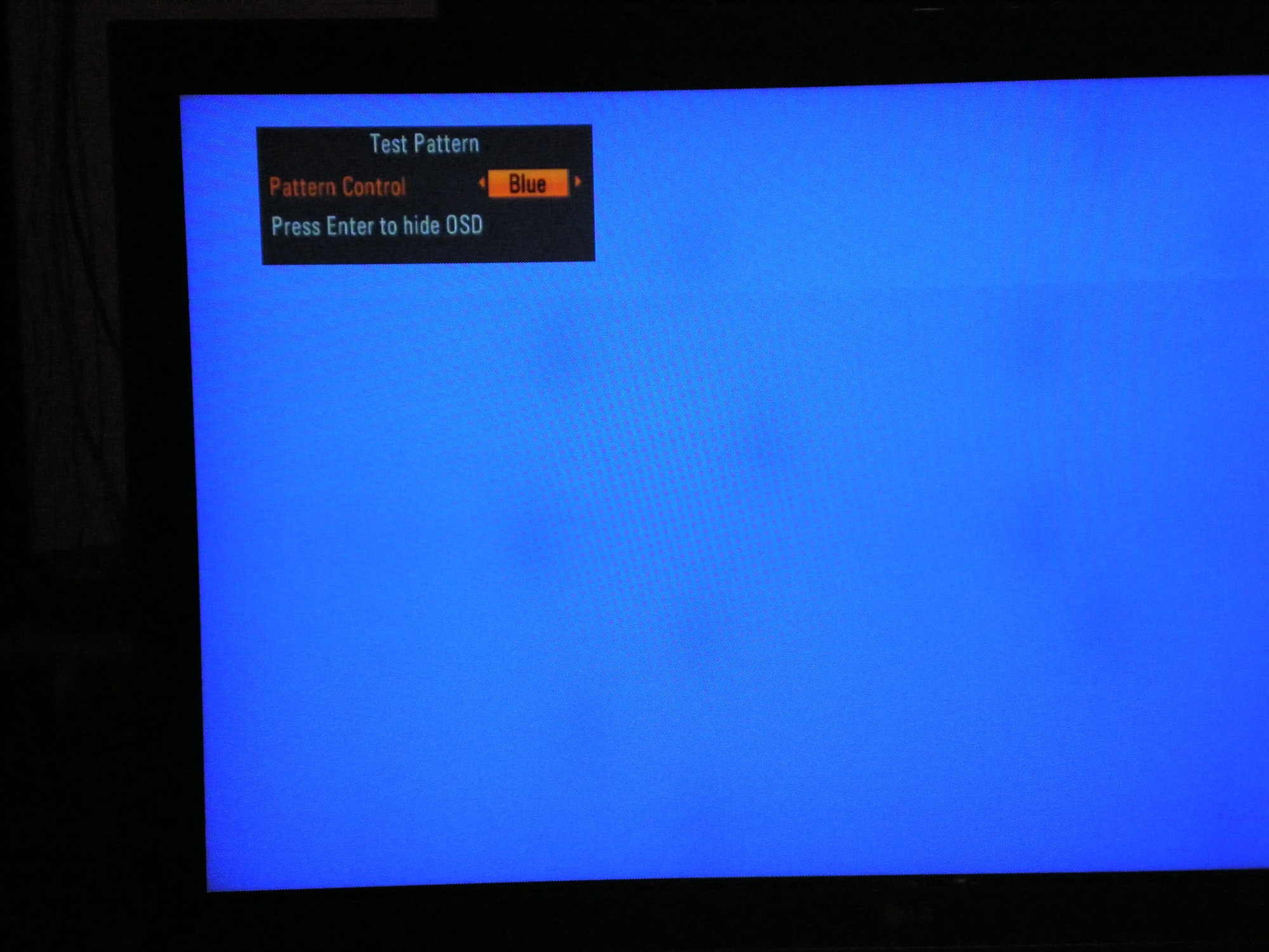

            Re: LG 47LC7DF-UB No video issue

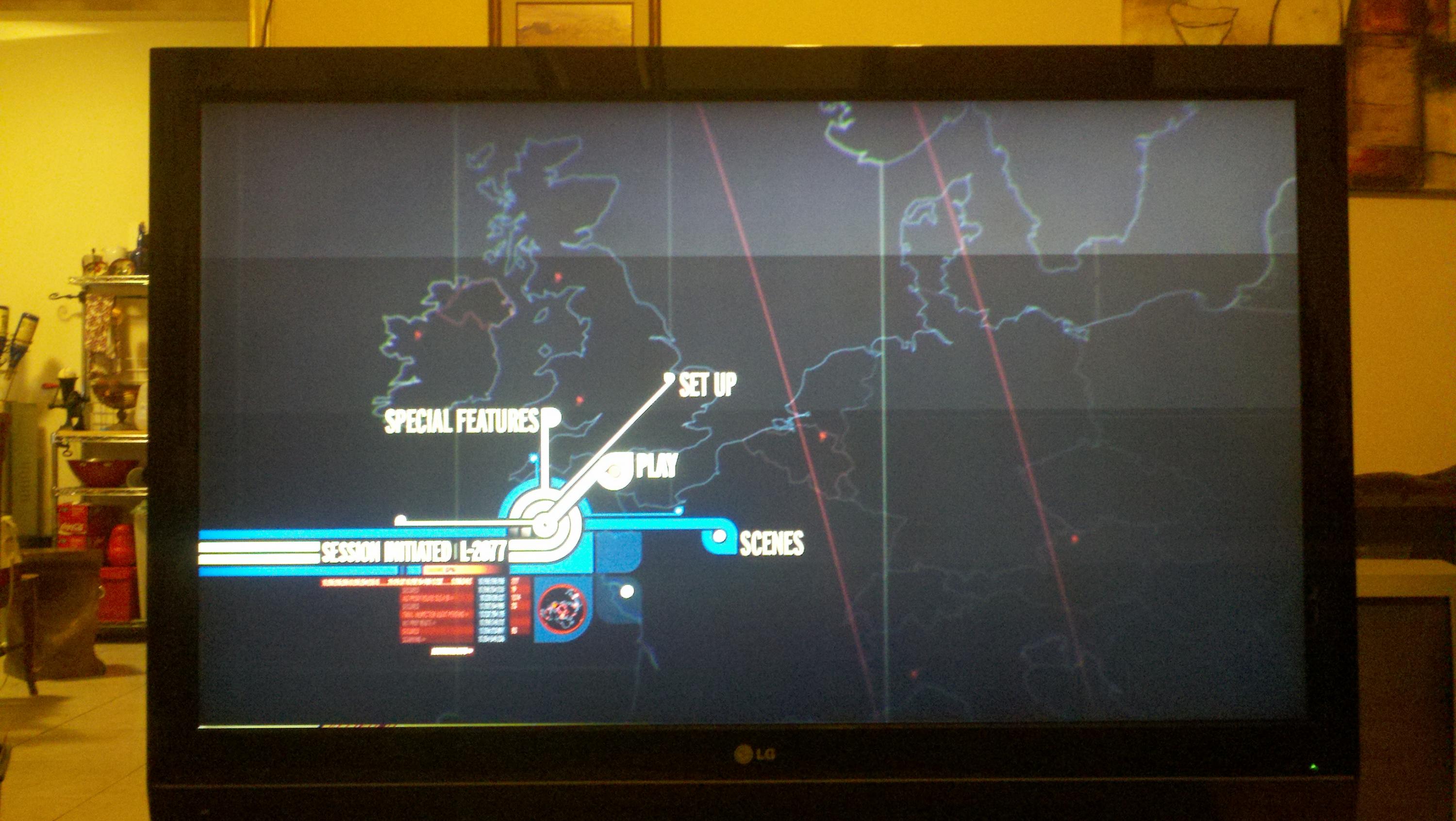

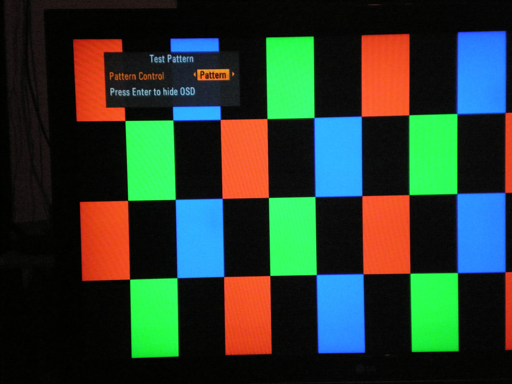

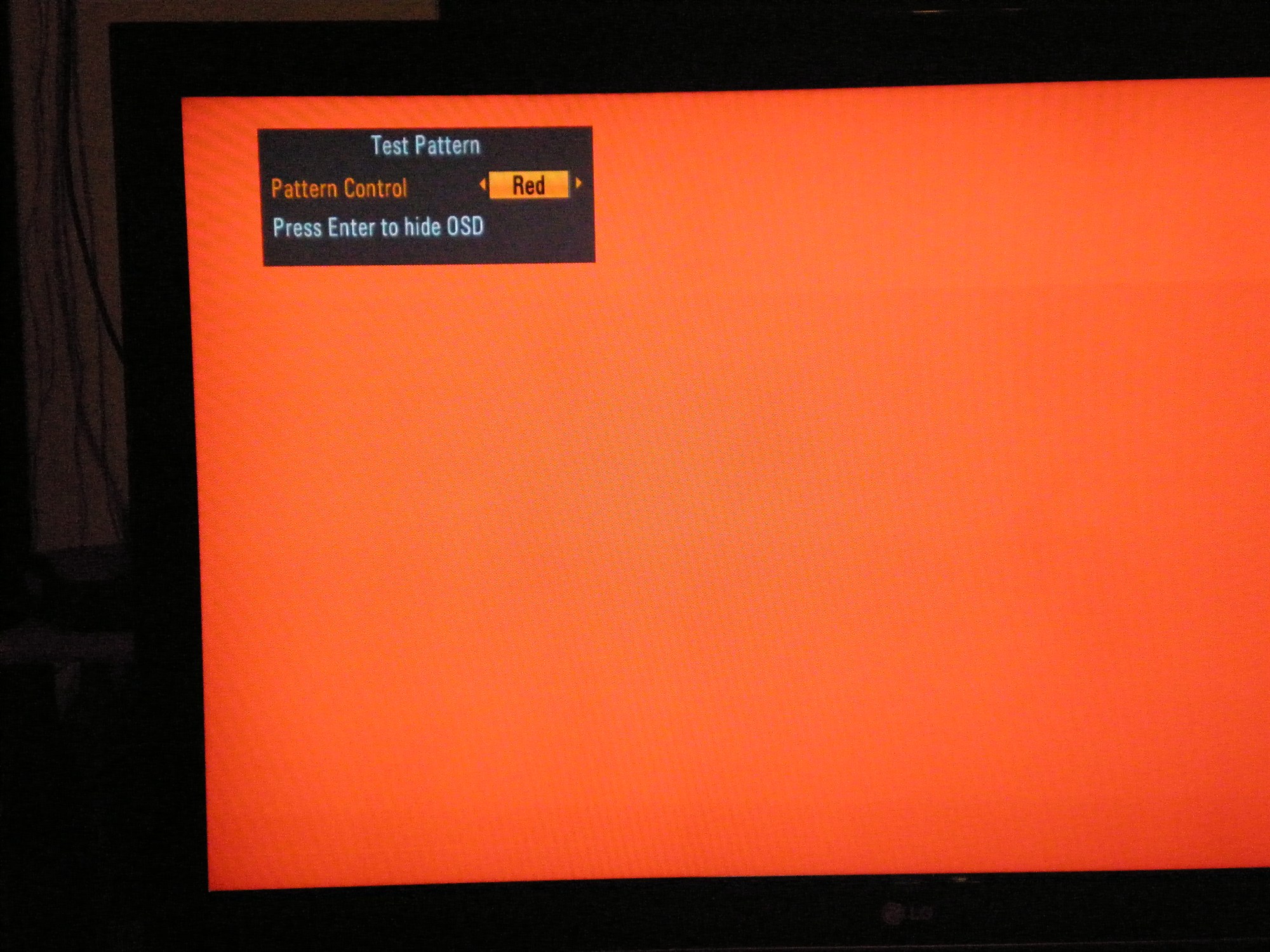

            I was able to get the service menu up and the menu itself looks fine although the horizontal banding is still there. I also noticed that a ghost of the previous menu will remain. I have only been successful at getting the "NO SIGNAL" condition after I leave the TV unplugged for an extended period of time. If I have the "NS" condition and cycle the TV, all I get is a blank screen.
            • UsAndThem
              • Sep 2012
              • 18
              • US
              I also tried flexing around the edges of the bezel and observed no changes in the image behavior.
                And the problem - no picture - occurred at the same time as getting horizontal banding? The main board is most likely the issue, but the horizontal banding is very weird...
                • UsAndThem
                  • Sep 2012
                  • 18
                  • US

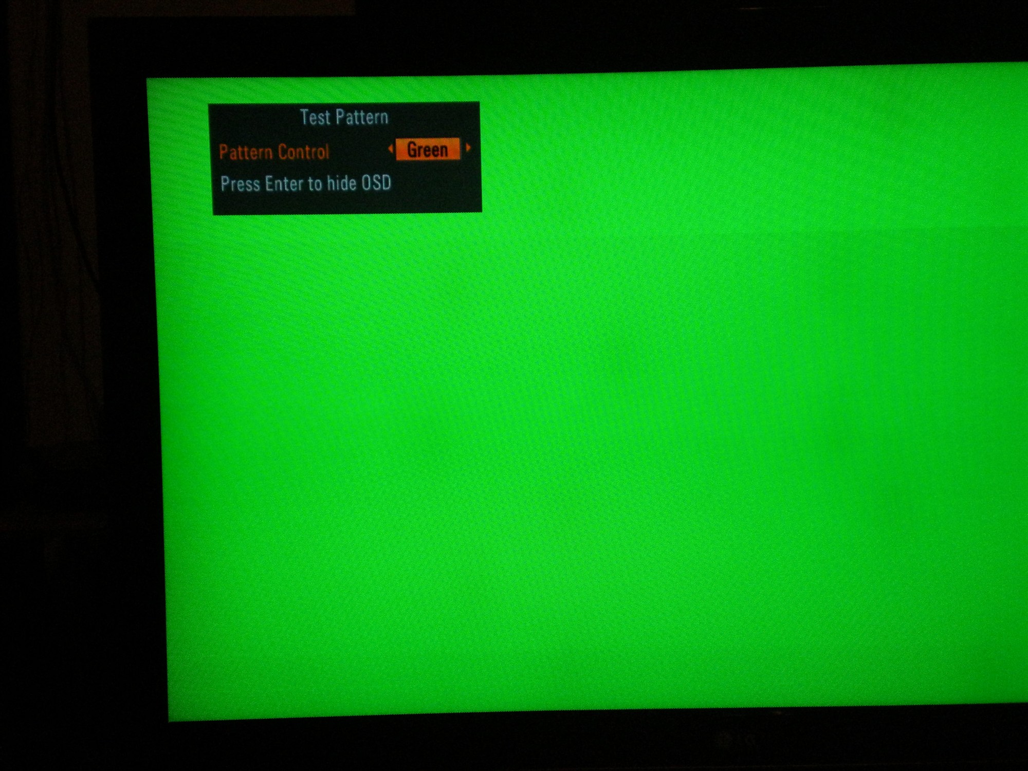

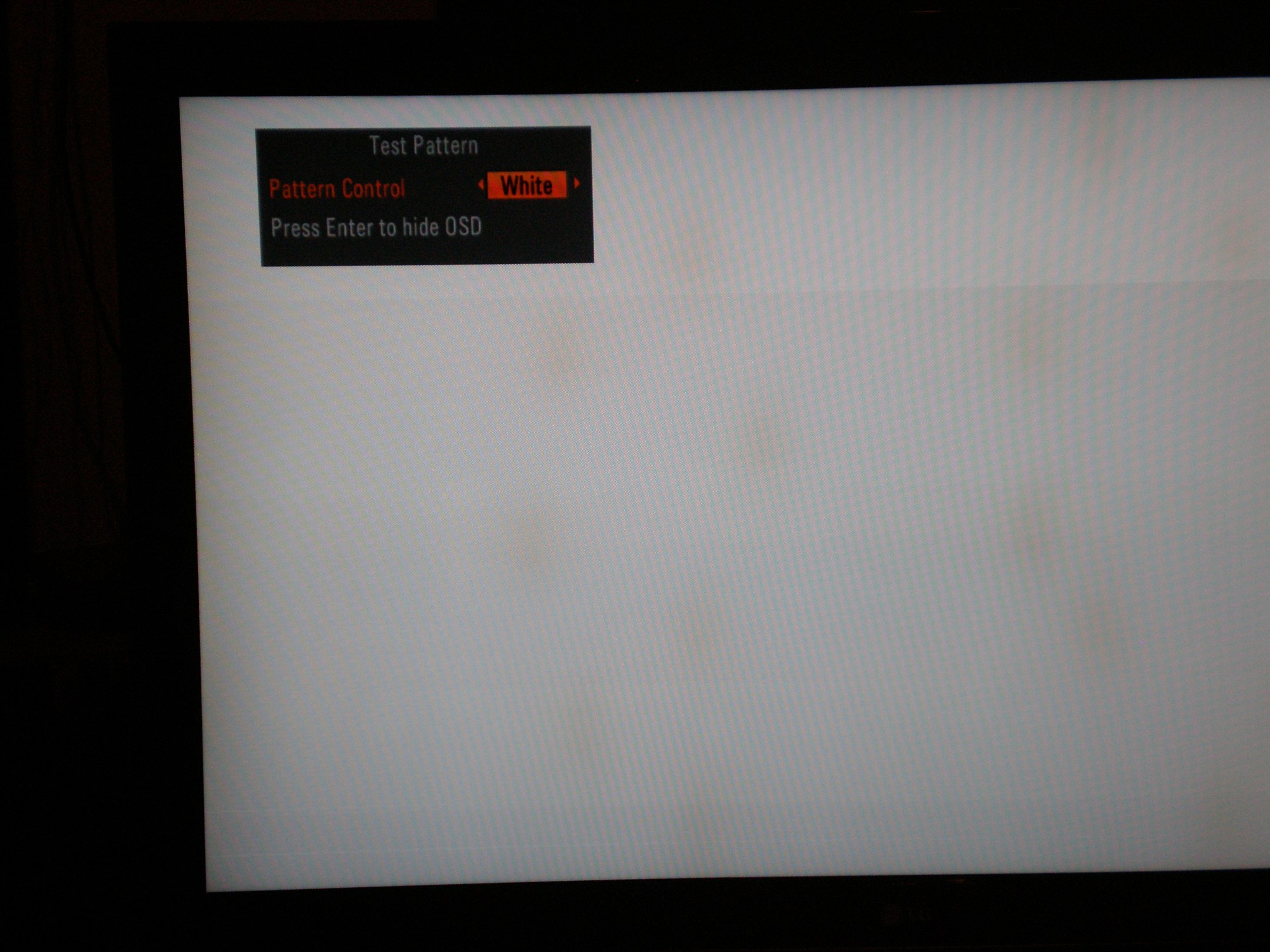

                  The banding does not occur when the screen is blank. There appear to be two states. One, An image is visible with the horizontal banding and two, when there is no image and the screen is solid black(one even shade), but illuminated.
                    It might simply be that the banding doesn't appear against a black background but is really always there. Do you want to troubleshoot the main board, or just replace it? It could be something like the EEPROM being corrupted, which removed some "region brightness" settings.

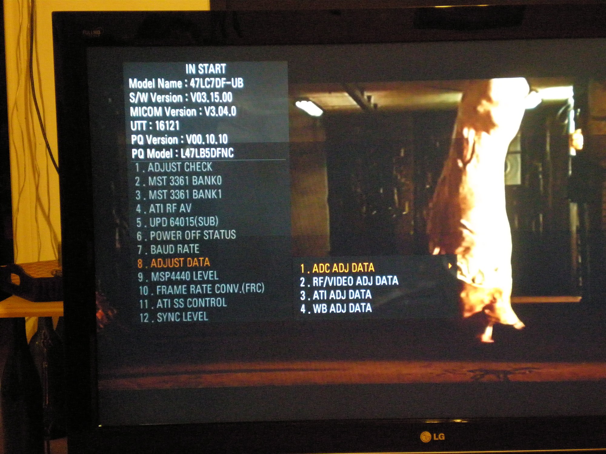

                    In the service menu can you select ADJUST DATA and see if there is anything on there, such as RESET?

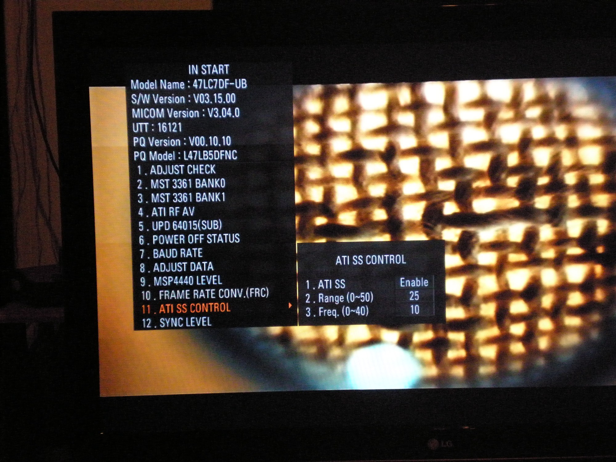

                        I was able to get into the ADJUST DATA menu but there didn't appear to be a reset option. After looking through the menu and sub-menu options I cycled the TV and the blank screen conditioned returned. With the blank screen, I held the menu button on both the tv and remote. I did observe the screen brightness increase after holding the buttons for 10 seconds or so. It appears that the tv can still be controlled, volume up/down, channel change, etc. even when the tv is in the blank screen condition
                          Under the other options there could be a RESET or CLEAR option - can you check under them too?

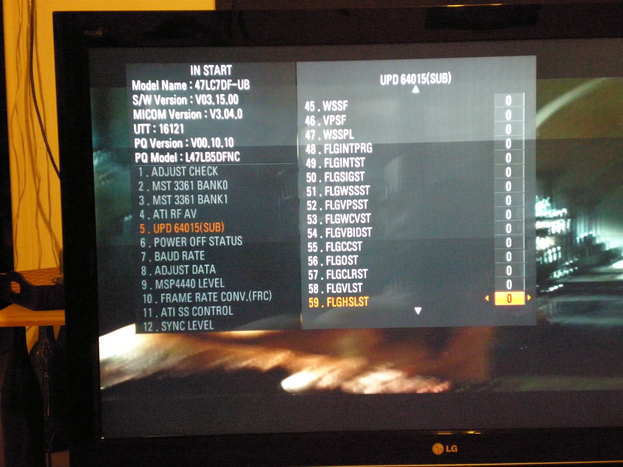

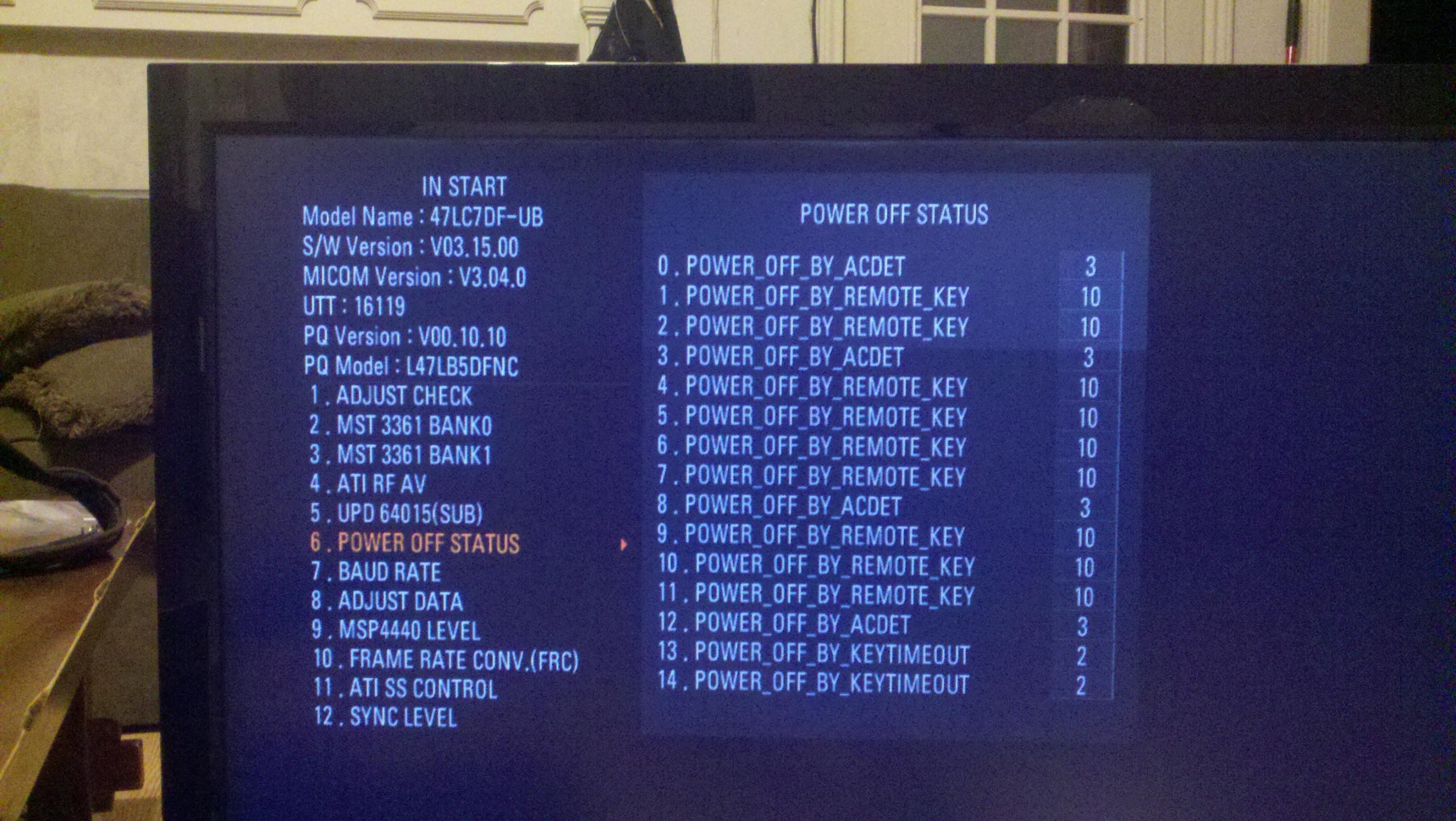

                            I checked under all available menu's and sub-menus. I can take pictures of each if that will help determine if there are any useful menu options
                              If you can that would be helpful.
                              • UsAndThem
                                • Sep 2012
                                • 18
                                • US

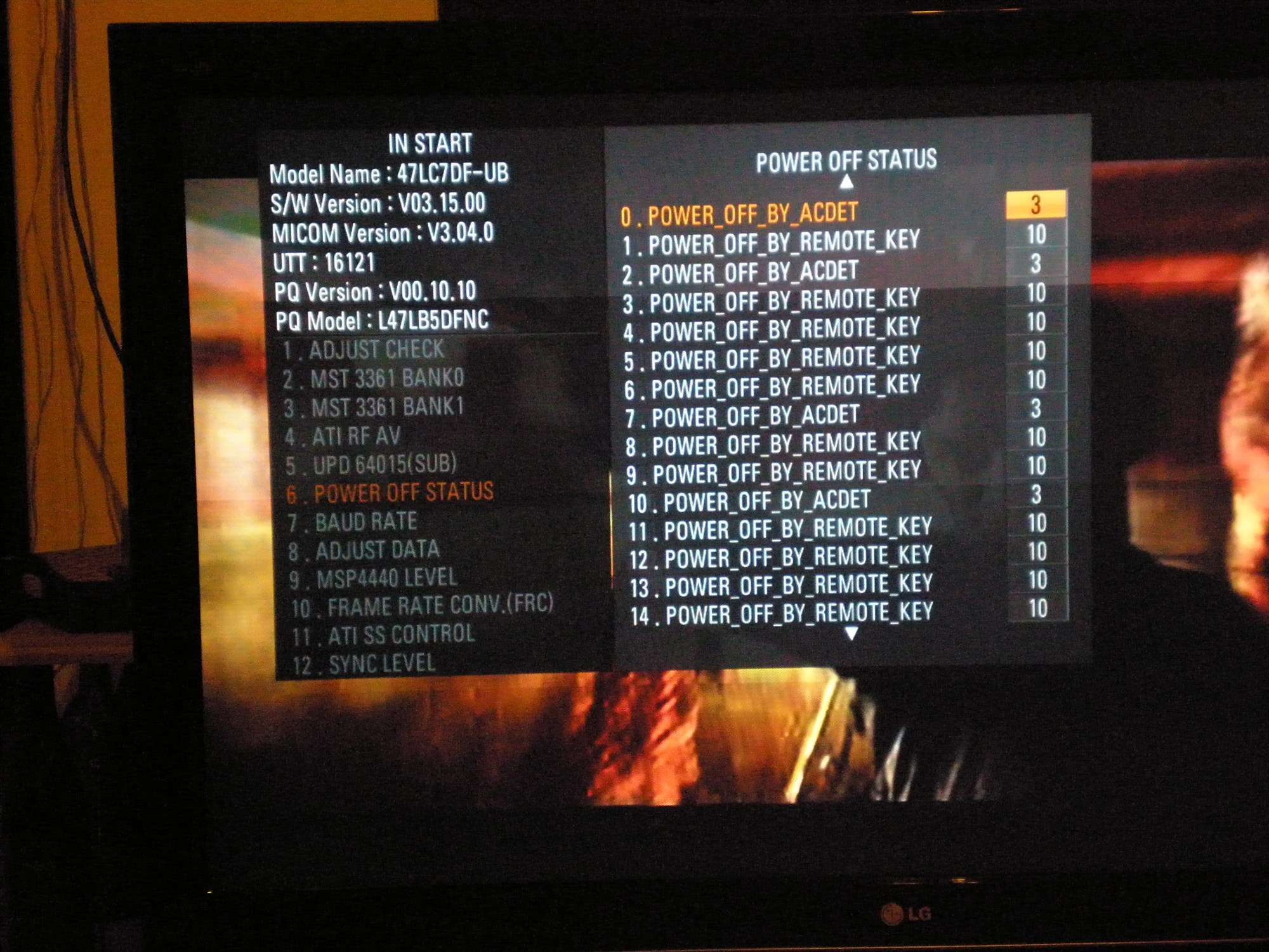

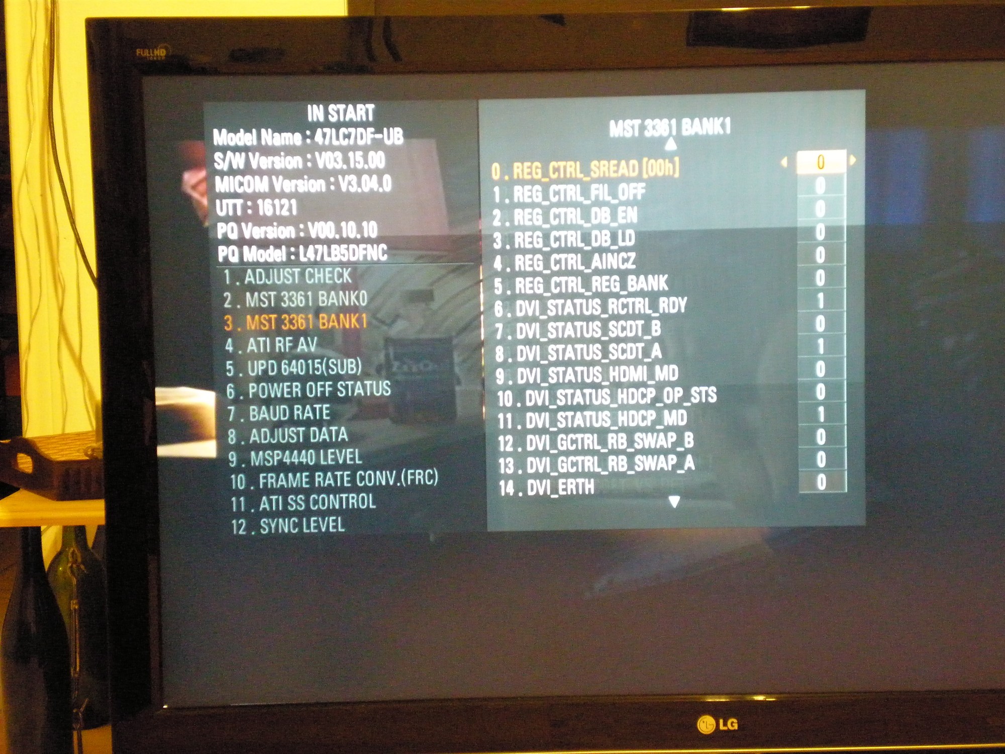

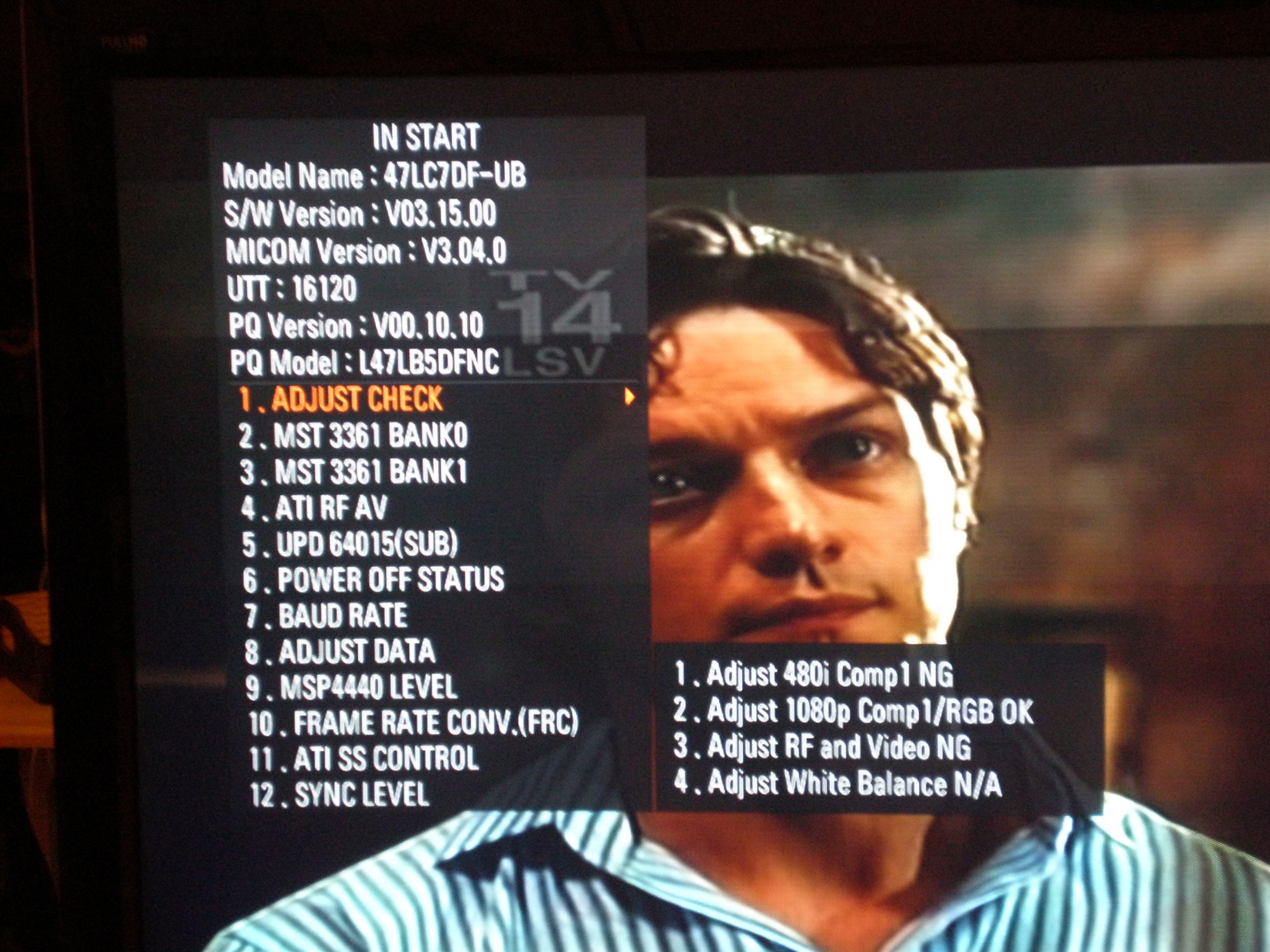

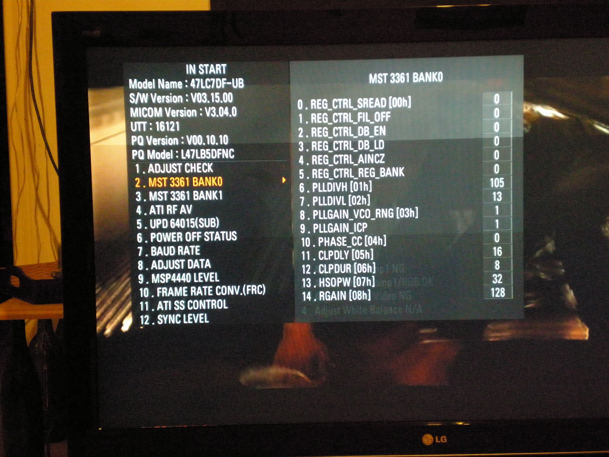

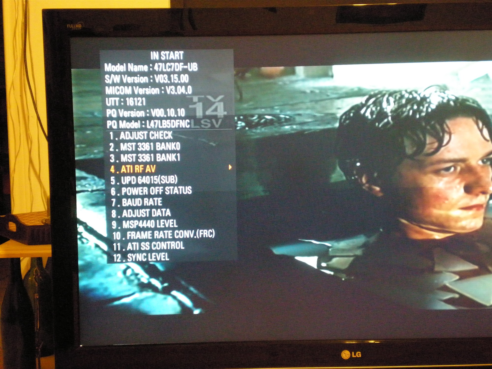

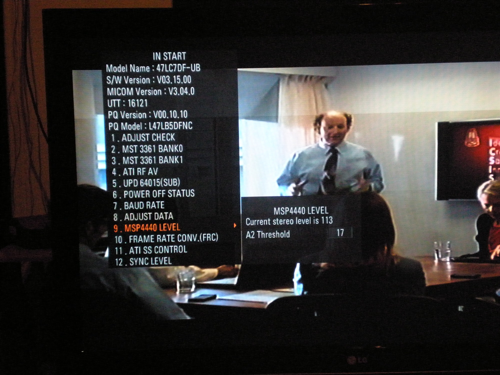

                                I have attached some images of the 1st level of the service menu. I have sub levels photographed and can upload as necessary. Let me know if you see anything you want me to try. I also included some test screens.
                                Brian
                                  Darn - I was hoping to see a RESET option, but no dice. I suppose there might be one in the normal user menu - have you tried that? I also don't think it's a coincidence that the banding on the top stops exactly where the checkerboard pattern changes.

                                      The voltages look good to me. It might be possible to update the firmware, does this TV have a USB port? If so maybe it will work with some firmware from LG's website.
