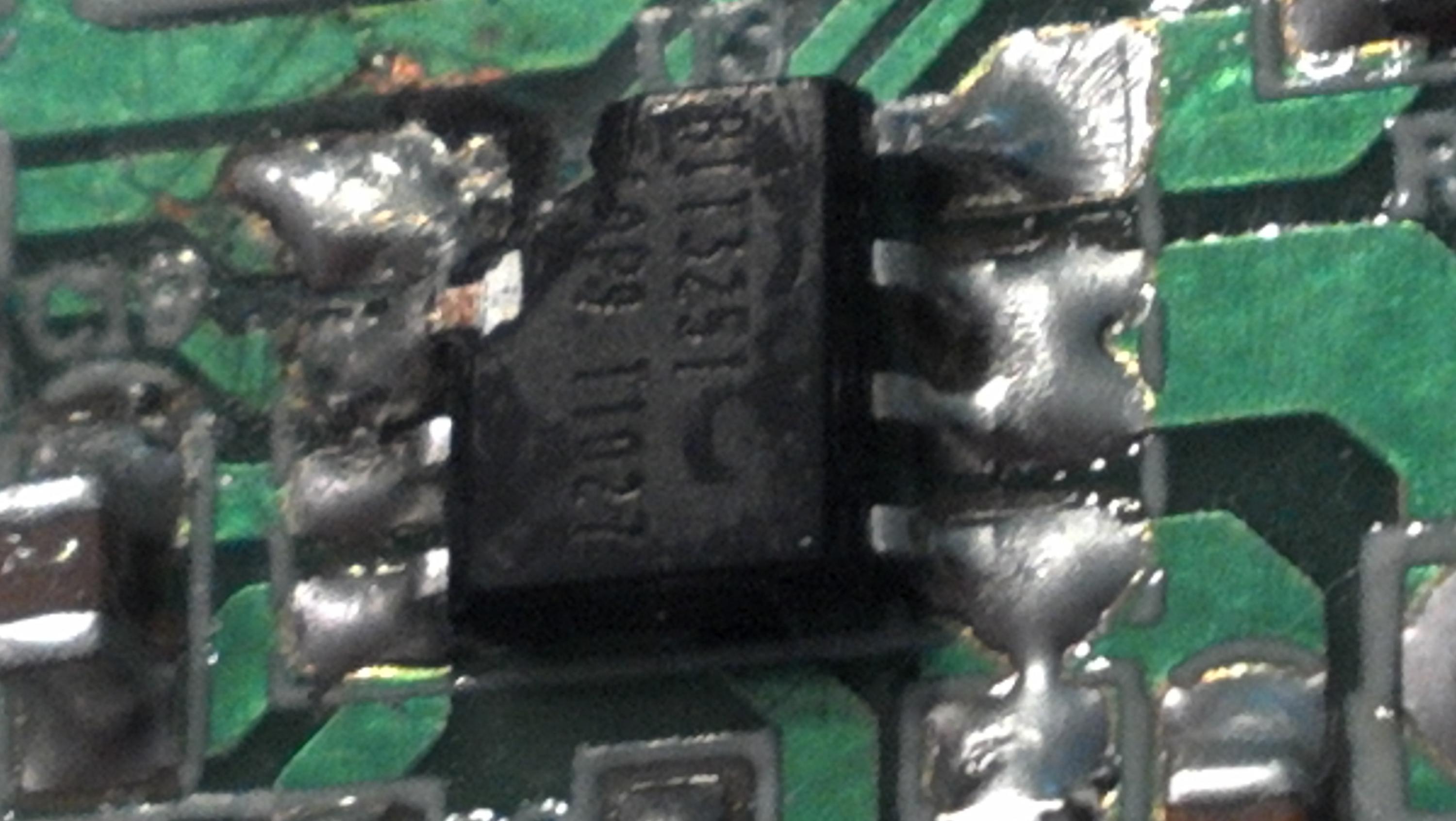

    I have this TV it is a 23" LED backlite Coby. when I turn it on I press the button and the on led gets brighter then I hear the tv try to start and then it shuts off. I have checked the capacitors and they test good. I have noticed under the power board there is a 8 pin chip that looks like it is missing a large portion of it. I wanted to see if anyone has a service manual to this tv so I can see what part it needs.

    here is a picture of the part it is U3. I would hate to throw away a good tv for such a small part.
      Re: Coby LEDTV 2326
      That's definitely a problem. Looks like a switching controller, if you can find it only a few bucks to replace. Can you get a picture of the area of the power supply it's in?
      I can't get any hits for the part # (possibly BL13251, but hard to say.)

        Re: Coby LEDTV 2326
        Bit3251
          Re: Coby LEDTV 2326
          Very nice Selldoor. Couldn't see that myself...
          http://www.ebay.co.uk/itm/2PCS-BIT32...#ht_1888wt_892
          Approx $12, maybe cheaper elsewhere...

            I replaced the chip and the tv still does the same thing. the power led is a dim blue then I press the power button and it goes to a bright blue. then I hear the tv try to start and a faint pop sound and then blue light goes out. the power supply on this tv is very compact and has alot of smd parts. I have looked on ebay to see if someone has a power supply for sale. I think this might just be a item for the dump.
