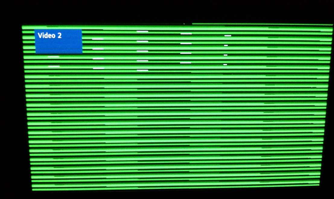

Friend just texted me a pic of this panasonic plasma thats at a garage sale.. Any thoughts on what MIGHT be the problem ? Owner said only thing that comes in clear is the words/numbers and the pictures from the sd card reader
Thoughts needed on this plasma
Re: Thoughts needed on this plasma
Tom.. Maybe the D board http://www.shopjimmy.com/panasonic-t...tu-d-board.htmComment
Nah since the OSD's good, it's gotta be on the board with the video inputs on it. I'd pay at most £50 for that TV.Please do not PM me with questions! Questions via PM will not be answered. Post on the forums instead!
