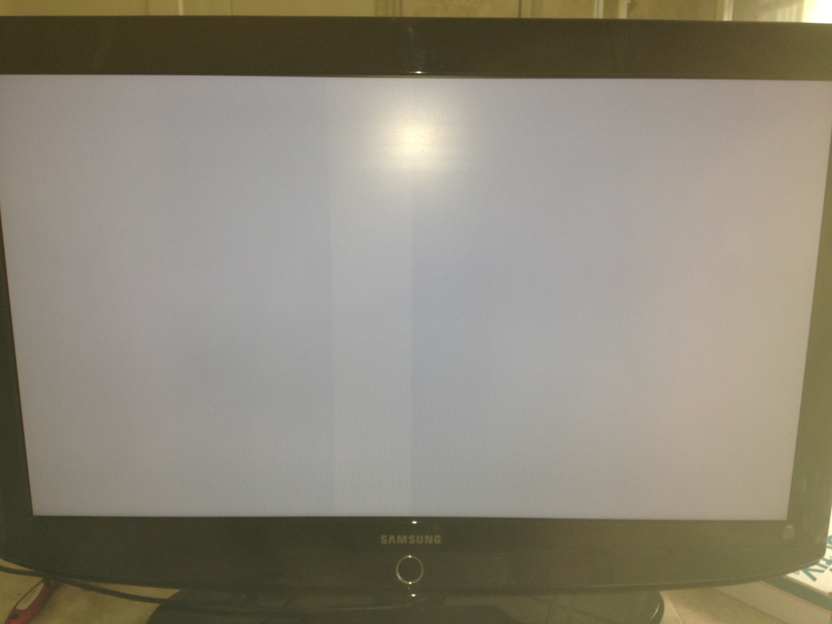

    Samsung LNT375HA possible purchase
    I could pick up this TV, but not sure what could be the problem, technician stated that the mainboard has to be replaced.
    It has that white vertical band also.
    Any help would be appreciated.
    Re: Samsung LNT375HA possible purchase
    That looks like bad T-CON not getting the power to it. How much is this? less than $50?

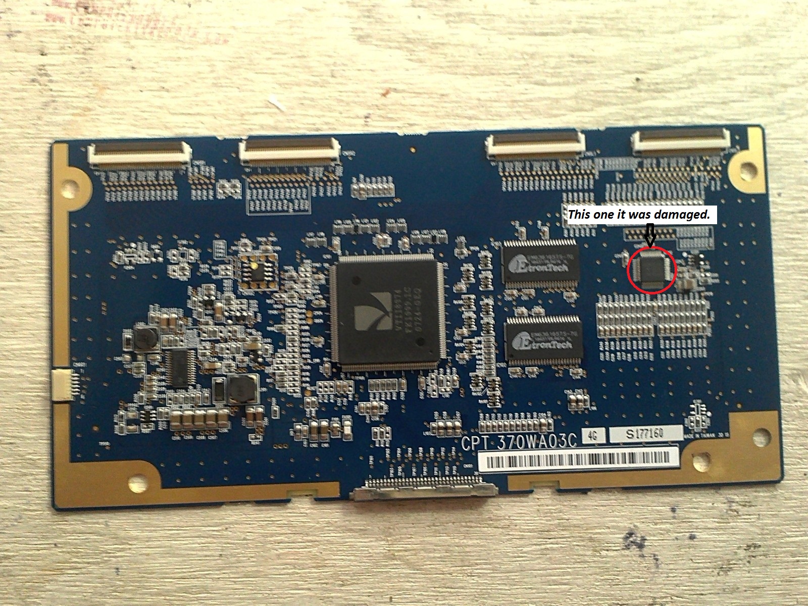

            Found a blown chip on the T-con board. Ordered another one from Ebay.

              Got the T-con board and there is an issue and I believe that it's a bad board.
              If I connect all four ribbon cables from the panel, the TV won't power up, it will power cycle.
              I have found out that if I remove the far right ribbon cable(looking from the back) it will power up and there is a half image on the screen.
              Something else I'm missing here or the board from Ebay it's bad?
              On the old board there was a blown chip, it could have maybe damaged something on the panel's PCB?
                That is the gamma reference IC, if it went wrong the panel might be bad.

                      Do you really think that the panel is bad, or maybe some other component went out on the panel's PCB?
                      It's not likely that the T-con is bad?
                        All four ribbon cables should be the same, look at the number of pins of the connectors on the board, they should all be the same. There are also ICs (small rectangular chips about 0.20"W x 3/4" L) on the tab bonding that interface with the output of the T-CON to drive the TFT rows and columns that may have shorted out.
