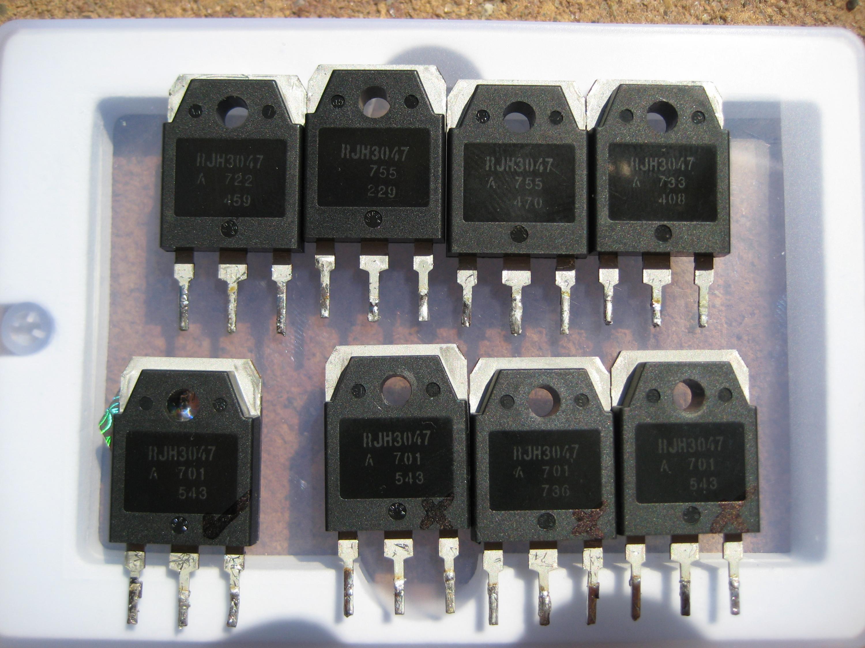

    Do they show as shorted? Wow. Those IGBTs should be <£5 each... if you can source them!!
    • laszlo31
      • Aug 2012
      • 25
      • Hungary
      Re: LG 50PC55-ZB stays in stand-by
      Yes, 3 out of 4 show shorted Collector-Emitter, only 1 is properly insulated and can be opened or closed with applied Gate voltage.
      Would you recommend me checking the remaining 2 IGBTs under the other heatsink?
        If you can. Though usually only the FETs in one group will go at once.
          I got lucky as a guy is selling RJH3047 IGBTs at 1€/piece in my city so I can pick them up tomorrow. I hope the TV will get out of protection mode and the replacement transistors will not go blown right away. Keep your fingers crossed.
          If fuses are OK on the boards, would you say that the IGBTs just got too old or would you recommend some extra precaution before I solder the new components and switch the set on?
            One probably failed and took out the other three. These TVs run hot, accelerating failures.
              I got the replacement IGBTs, replaced them but unfortunately the TV still clicks back to stand-by as the Z0_SUS_UP pin doesn't go up to 5V as (I guess) it should.
              The chirping sound became louder from around the upper heatsink. Being afraid of shorting another set of transistors I tried only few times powering up but I got no luck. Desoldered the components again and checked. At least the transistors and the rectifiers are still OK.

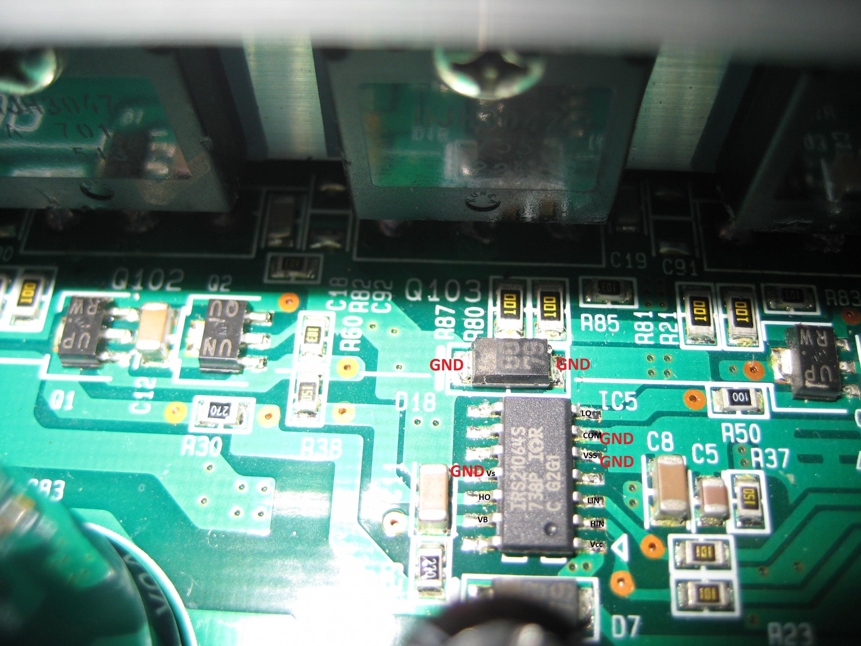

                            #33
                            Checking all components on the Z-SUS I came across a shorted diode next to the IGBTs that were previously replaced due to short. Desoldering the diode, it tested OK but both empty pads were measured shorted to the GND of the Z-SUS. See attached picture. Following the printed wires it turned out that 3 pins of a IRS21064S driver IC cause the short. See attached data sheet. Having limited experience in IC testing could you please advise whether this IC seems faulty.
                              #34
                              The IC shouldn't be able to short from Vs to Ground but I suppose it's plausible. In theory, the high voltage and low voltage sides are separate. The shorted IGBT could zap the driver, potentially.

                                #35
                                Hi All,
                                After several evenings on component level troubleshooting and isolating the issue at a faulty 14 pin IRS21064S driver IC I decided to order a new Z-SUS that arrived today. After replacing the board TV works as a charm. Family happy. I learned a lot about plasmas. Thanks for the support and advice.
                                László from Hungary
