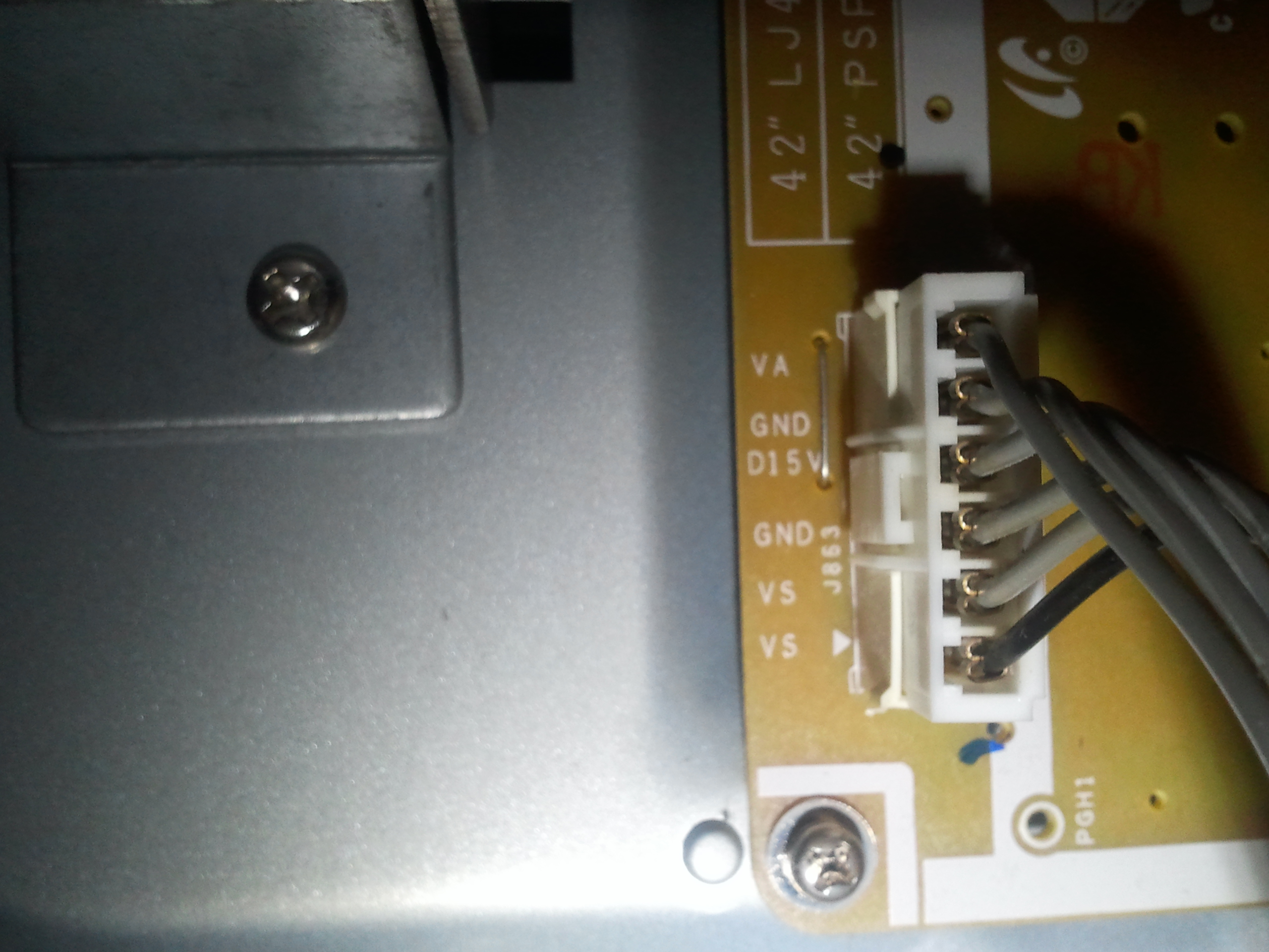

    I checked for operating voltages at connector(cn804, to the y-main board) but no voltage present except the 15 volt.
    I can pull this plug and it goes back to one click from the power relay, not sure if this means anything or not was going by the troubleshooting guide.

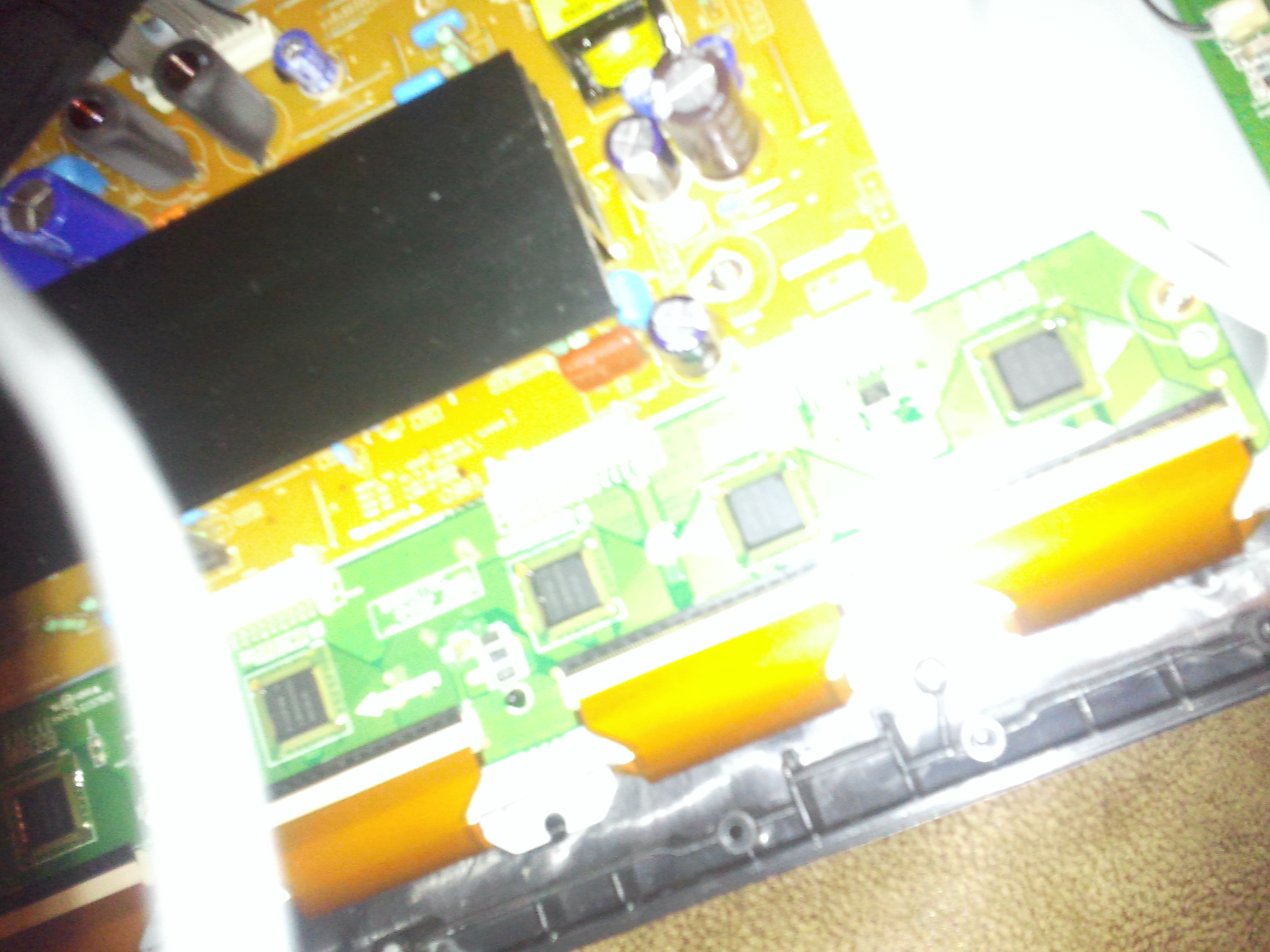

    I did manage to find a component on the y-buffer board that appeared to be burnt,
    im at a stand still now any help would be appriciated.

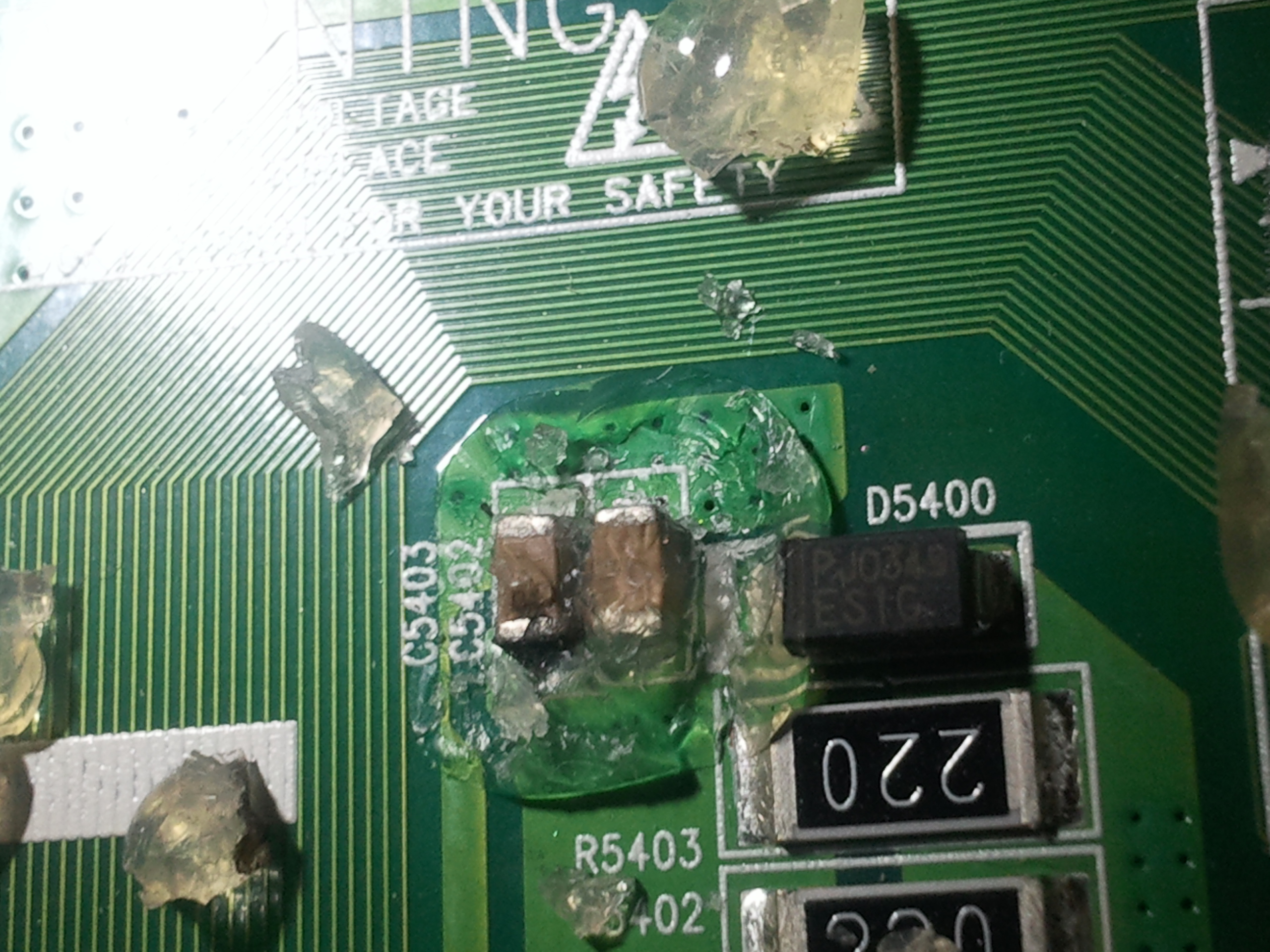

    Can you show a picture of the burnt component? This plasma is essentially a Samsung re-badge.

      here is a pic of the component, it was under some silicon so i noticed the black spot and cut away the silicon to inpect it. its on the y buffer board.
      thanks
        Re: 42" rca 42pa30rq no picture but sounds working
        Test across those caps, deos it appear short circuit on ohms? (With power off.)
          it wasnt a dead short but did read about 10 ohms,
            I would advise replacement of the buffers - they are generally quite cheap because this model is ubiquitous, I believe they are also used in PS42B450 and PN42B450 if that helps.
              I was thinking about replacing the buffer board and the y main board but ill try the buffer board first, I believe i can get it for about 15 bucks, shouldnt be too bad
                i replaced the y-buffer board (along with the logic board & the x-main sus board, got them for a good price)
                still has the same problem black (dead) screen no picture, but sounds still working.
                What im noticing is i cant read any voltages when i first power the tv and when i hit the power button, it the relays on the power supply board will click a couple times normally it was one click when tv was working. It does go to 15 volts dc but once the clicking stops it steadily goes down to 0. no other voltages present at any time.
                Could it be a y-sus or power supply problem?
                i can pull the power plug to the y-main board and the relays act normal just one click.
                  Sounds to me like the buffers damaged the Y-main; do you want to board swap or try and find the failed component?

                      Unplug Y-main and check Vs voltage; if it's stable around 190-210V, PSU is probably good.
                      • sfdskins
                        • Jul 2012
                        • 8
                        • usa
                        Tom,
                        i upluged the y-main power plug and checked the voltages, The excess clicking from the relay stops when unplug it by the way ,sonds like normal operation, When i cut the switch on, Vs voltage goes to a steady 207vdc and Va goes to 54vdc also steady, but after about 5 seconds the voltage starts to drop out or dissapate slowly to 0, this maybe be normal because where it doesnt see the y-main board? not sure.
                          Thanks for your help tom,
                          I got the y-main board in tonight, and that was the problem. My thinking on it is the y buffer board cap that was burnt, shorted out and took out something on the main board. what do you think? i had to reseat some connections to the ribbon cable on the buffer board because when the screen first came up had some black bars in line with the connections, was able to get that out and picture looks great now.
                          Might would like to look into it more and find the bad coponent on that board at some point but not ready to do that just yet,
