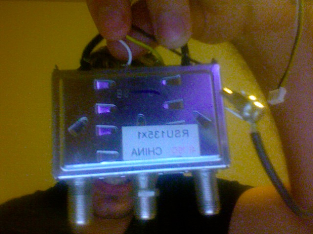

              Re: 32" toshiba tuner
              I did the same thing on my toshiba, i found my replacement part on ebay, i noticed that toshiba seems to update the part numbers for later tuners but should still fit the set, i bought the same p/n as my old tuner, just don't want crt shock. heres a pic of my part if that helps.

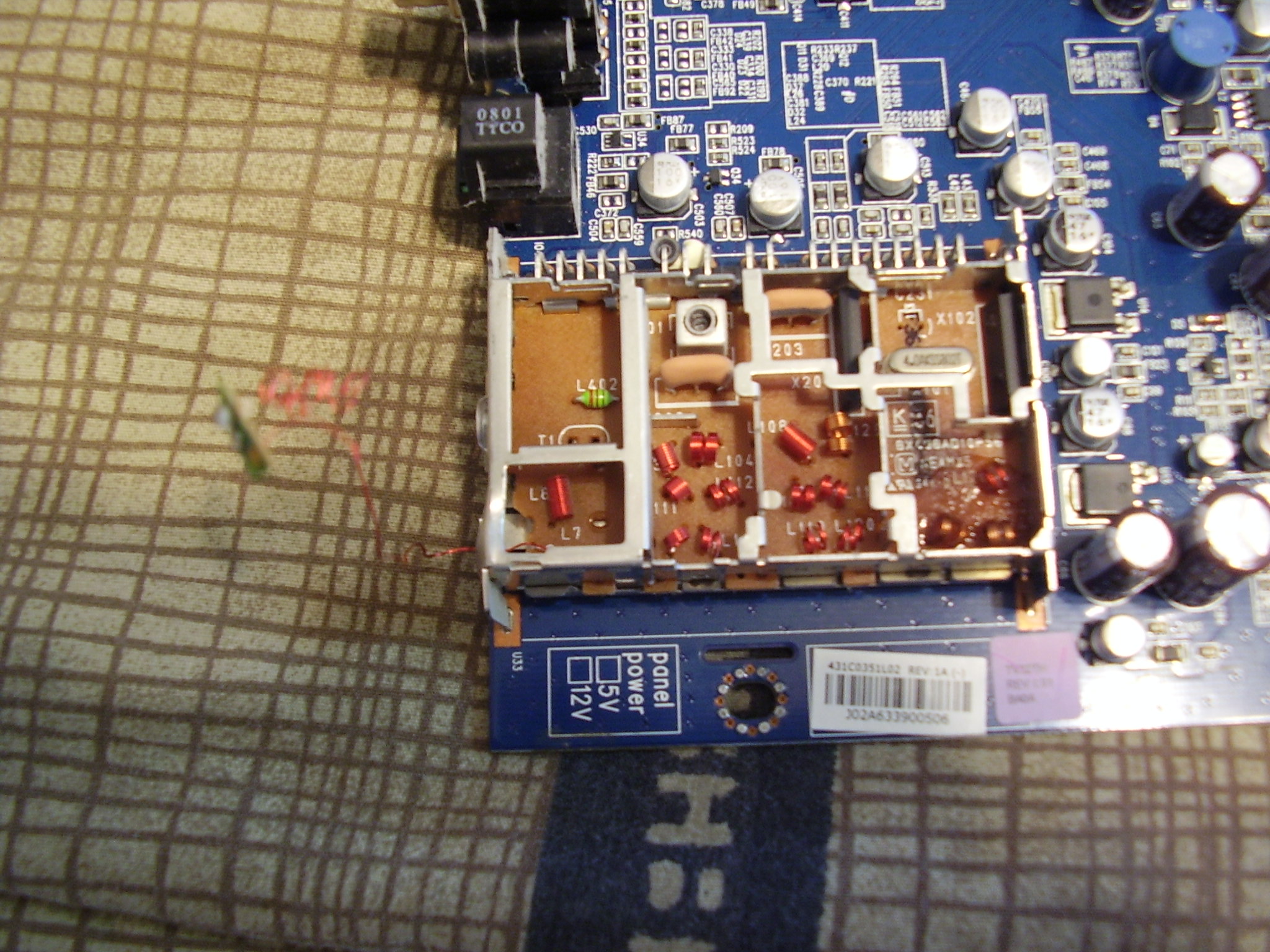

                Here is a pic of the tuner, Notice the small piece of the board on the end of the wire.
                  You may be able to re-wrap the coil using a small rod to wrap it on, it looks fixable, I fixed them with worst condition than this. You will have to remove the tuner off the board if that small broken piece has traces on it that you need to jump them on the main tuner board. It is already broken, what do you have to lose?
