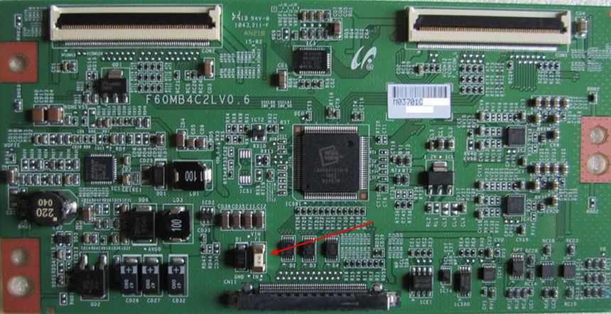

    My Samsung LE40580C went black the other night while watching TV. It's less than two years old, but out of warranty.
    Here is the issue:
    Audio Works
    Backlight is on - its still black, but in a dark room you can see it's on.
    No video
    All capacitors look okay
    When i lightly tap the screen, it goes white for a bit then fades back to black - so back light is def on.
    Any thoughts? I opened the back up and everything looks fine, nothing burnt or leaking.
    T-Con?
    Av Board?
    Powerboard?
    Any help narrowing it down?
    If the speakers are working and the backlight is working, surely it cant be the power supply?
    If the AV board is picking up a signal that should be okay as well?
    Does that mean it's likely the T-Con?
    I got a quote from the Samsung TV repair people, gave the symptons over the phone and they seems to think its the power supply? But want £250 to fix, where i can buy a power supply board and swap it out for £35...
    Many thanks all, i trust you will be more helpful than Samsung Support.

    T-con most likely - these boards have a fuse on them which can blow with or without an actual failure on the T-con. It is a fairly common issue with Samsung LCD TVs.
    What a load of bollocks (excuse my language) - £250 to fix a 40" LCD TV? You can get a new one for £300! Besides, it is unlikely to be the PSU as you said, you have backlights and sound.

        You can replace the fuse on the T-con. Let me know if it is blown (you can check with a DMM if you have one, if not Maplins sell one for £5 which will work fine.) If it is, I have some 4 amp SMD fuses here, which are the most common fuses on these T-cons, and you can have one for the price of postage...

          I have attached a pic of what i have read is the t-con. The bit pointed out in red is the SMD yeah? Can i just pop it off?
            Re: Samsung LE40C580 - Audio working, backlight working, no picture. Help diagnose fa
            That's the fuse. You will need to desolder it.
            I do it by applying a bit of solder to each end of the fuse, then slowly pushing on one end with the soldering iron. The fuse will come off easily.
            If you don't have a soldering iron Maplin sells those too (you'll need some solder too (lead-free is fine)) I think it was about £10 last time I got one in an emergency, but if you're looking at £15 for tools, when you could just replace a £25 board it might not be worth it. Unless you start getting into the hobby of repairing them, like I did.

              I DMM'd the fuse and i had current running through it so it was fine, so i guess it wasnt the fuse.
              I managed to get the T-con from ebay for £12 posted. Hopefully it works!
              I'll keep you posted and thanks heaps for the help so far.
                How did you check the fuse - did you use the ohms range of your meter?

                  Yep, dropped the ohms to the min value, then tested. The dmm went from 1 down to .000, so i'm guessing that means resistance is zero (which means that the fuse is still intact?)
                    Yep, fuse is good. Try the new T-con and if that doesn't work more detailed troubleshooting can be done. But I think it will work.

                      Hey hey hey, all fixed. I got the replacement tcon in and its working again!!!! And Samsung wanted a few hundred quid...
                      Cheers Tom, much appreciate your help.
