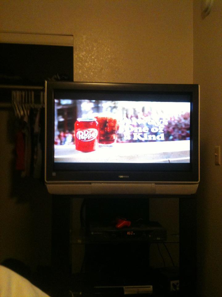

    Hi i have a nice 34hfx84 toshiba tube tv, recently i broke off a rf input and bought a new switch box, my question would be does this tv automatically discharge the tube if you leave it off a day and since the small rf box is not near the tube would it be a big deal to try and repair myself, so far i have replaced caps on a few psus and never got shocked.

    oh heres a pic of this beauty i heard this is one of the last toshiba american made tvs before they went to orion
