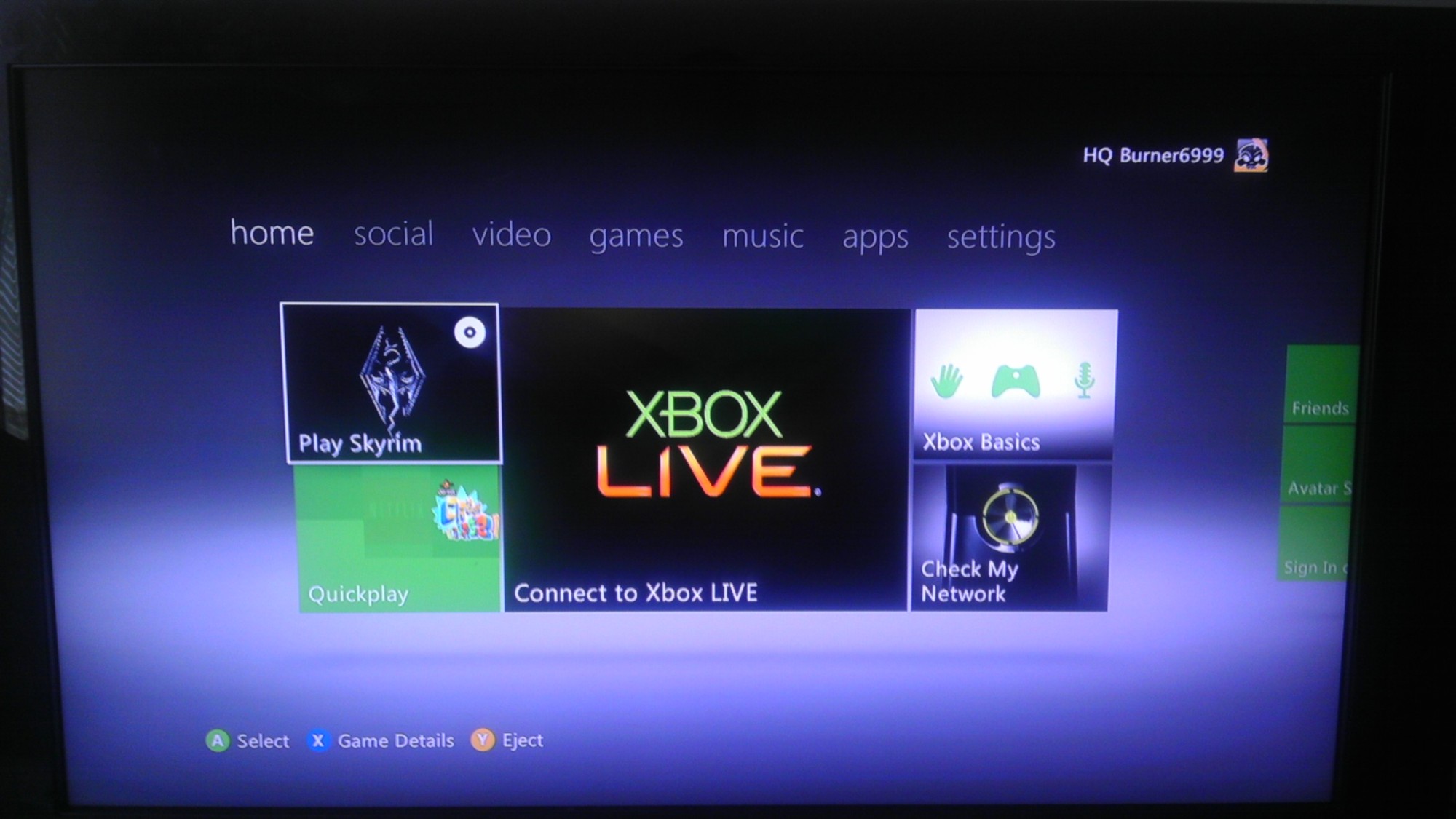

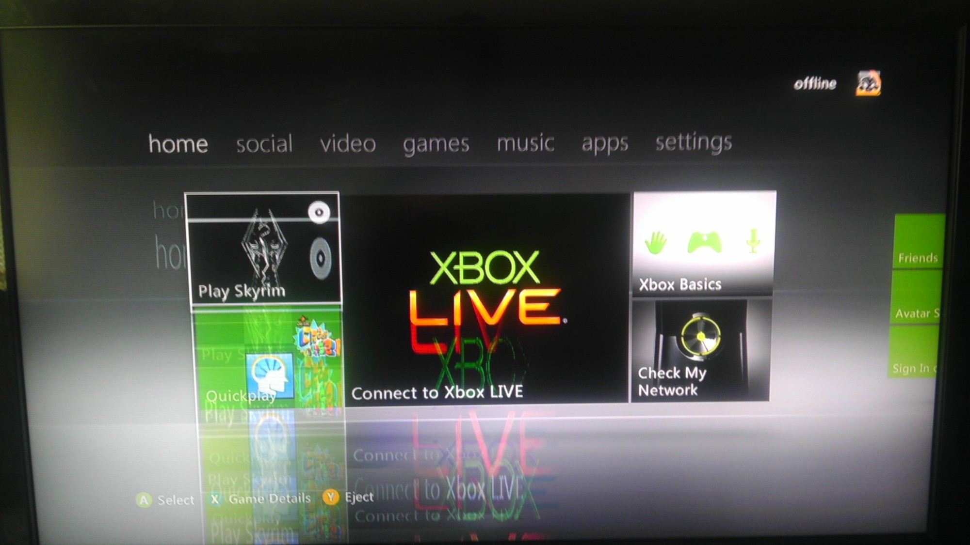

    Image ghosting on Sony 52"
    When the tv is turned on it has ghosting. If you push on the top left corner it goes away. If you push on the bottom left corner it comes back. I have attached some pics of it with and without ghosting. What could be causing it to do this. When the ghosting isnt there it looks perfect. I found this video and was wondering if this may be the problem? VIDEO

    Re: Image ghosting on Sony 52"
    Tab bonding failure, yep - just like in the video. I'd estimate 80-90% of the time it's fixable but I'm not sure if it's permanent.
