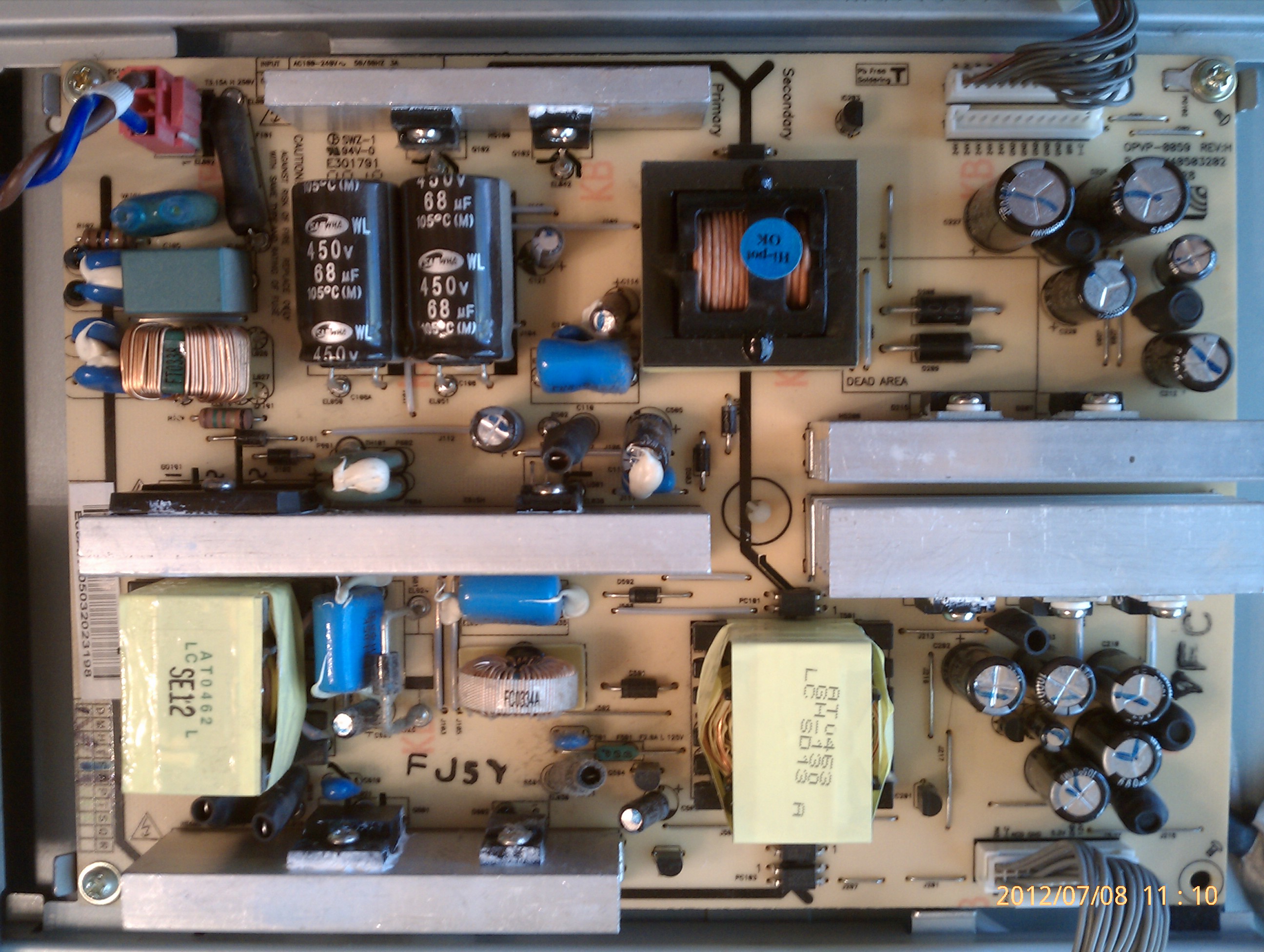

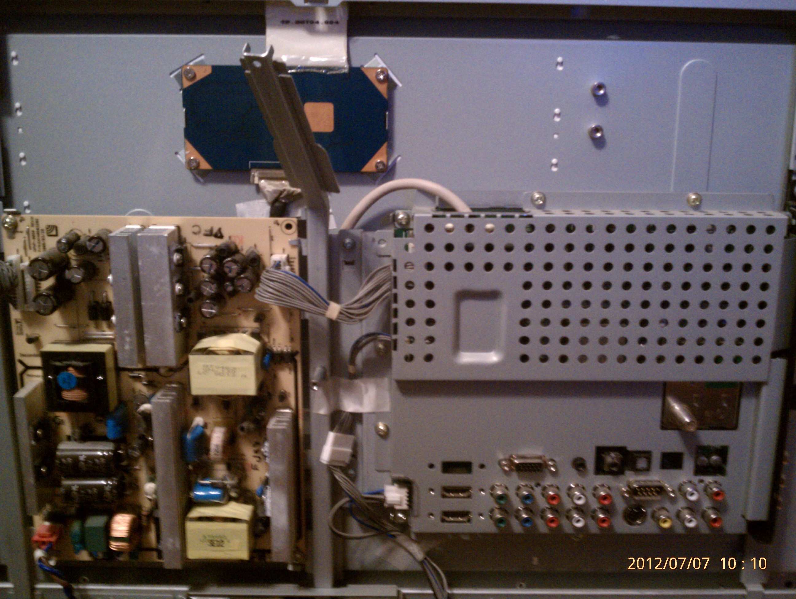

    When I first turn the TV on I get a normal pic for about 10 seconds, then starting at the bottom, the pic freezes the bottom 1/3 horizontally, then followed by the 2/3rd, then the top 3rd. It stays frozen for 10-15 mins and then pic comes back and stays normal.
    I played around with a hair dryer and freeze spray and it seemed like the T-Con board was the culprit, so I replaced it but have the same problem.
    Any ideas?

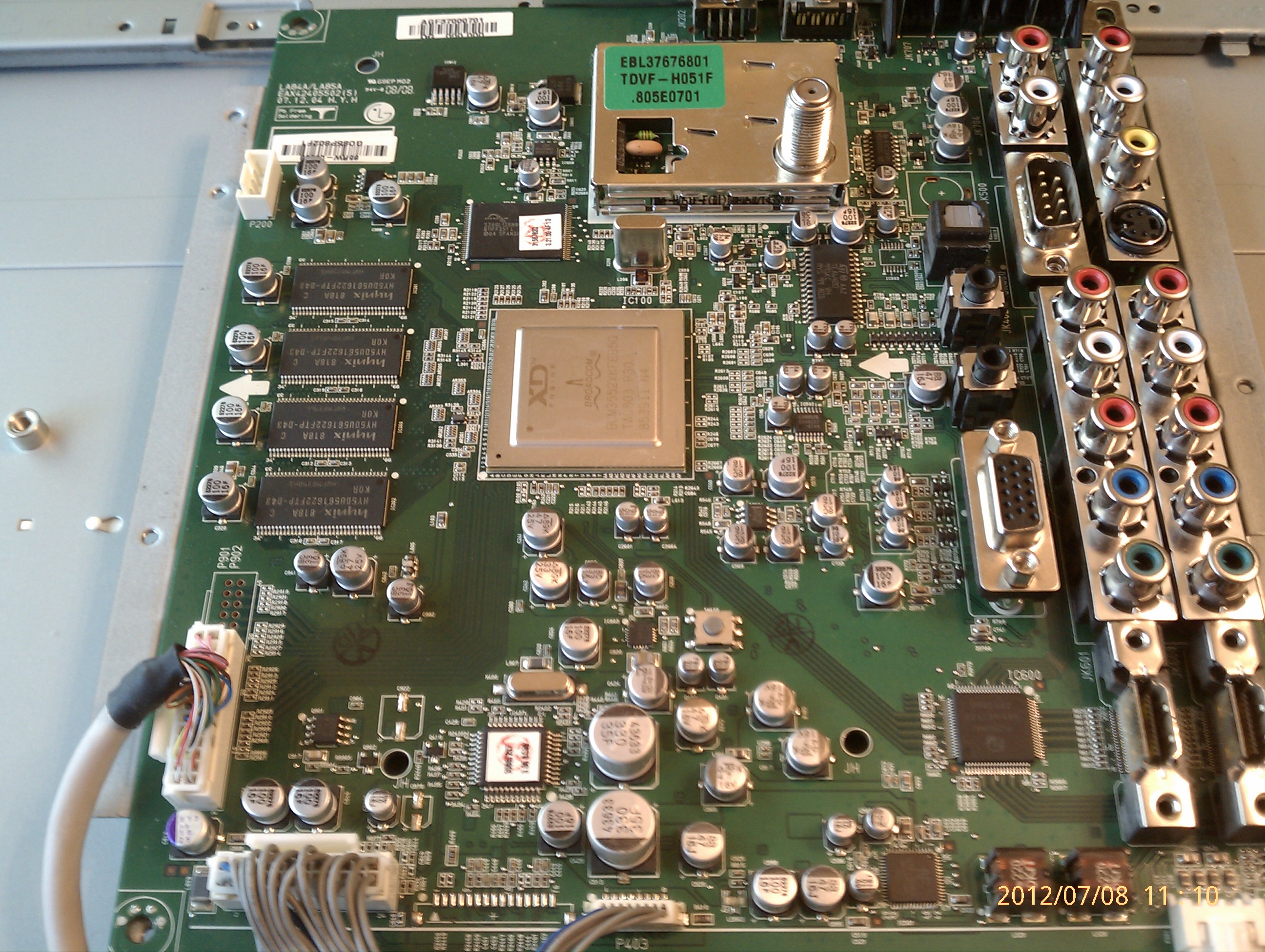

    You will have to take the cover off the main board so we can see what it looks like. In addition, your pictures will have to be a lot more clear, focused and brighter for us to help. Focused enough so we can read the pcb designations on the boards. When remote troubleshooting, garbage in means garbage out.

        Here's a couple pics, so any ideas if not TCon board, could it be the panel itself?

            It looks like its freezing on all inputs, which seems (at least to me) to point to main chip BCM3552X. I don't have an oscilloscope to test waveform as SM says.
