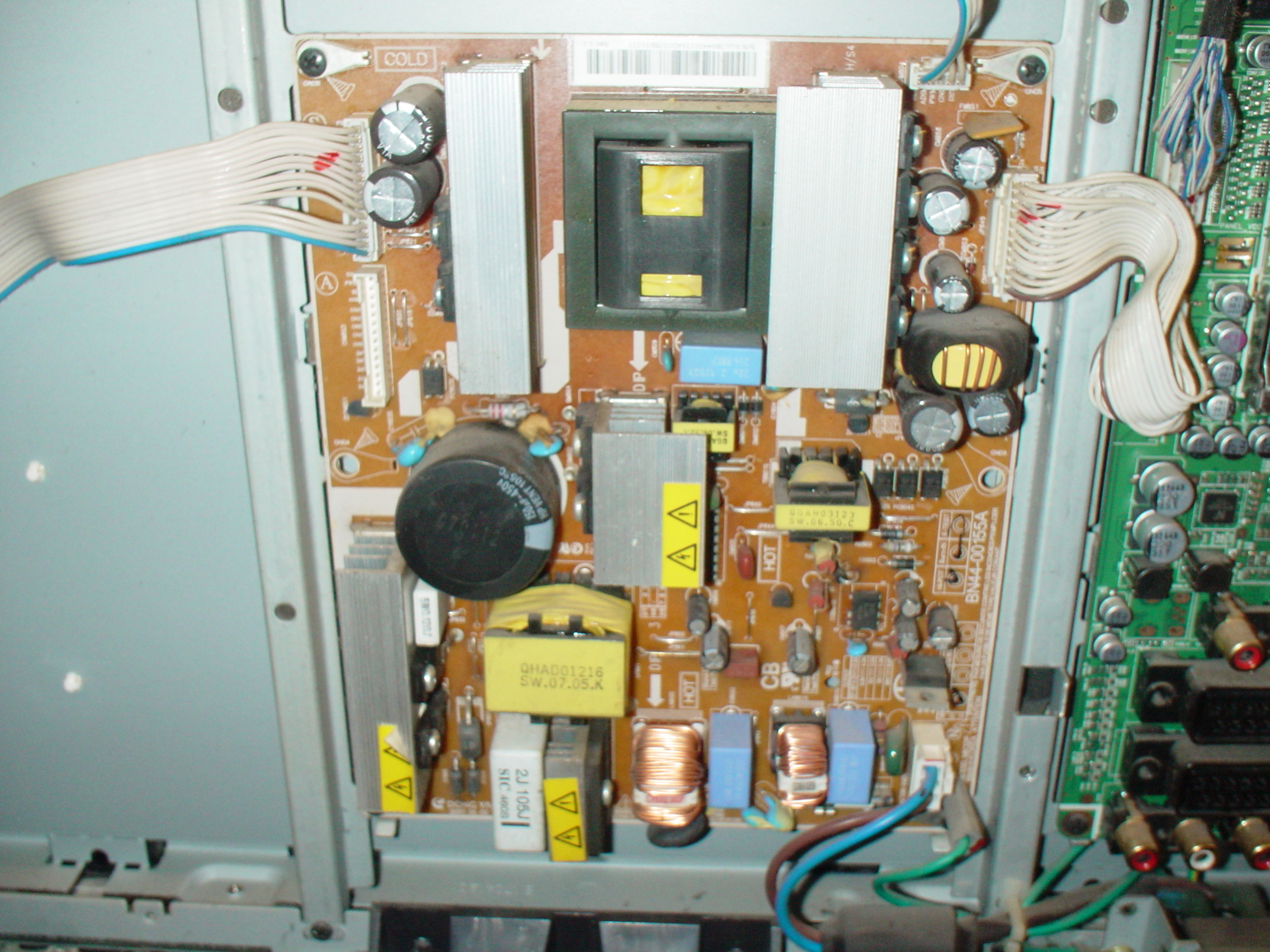

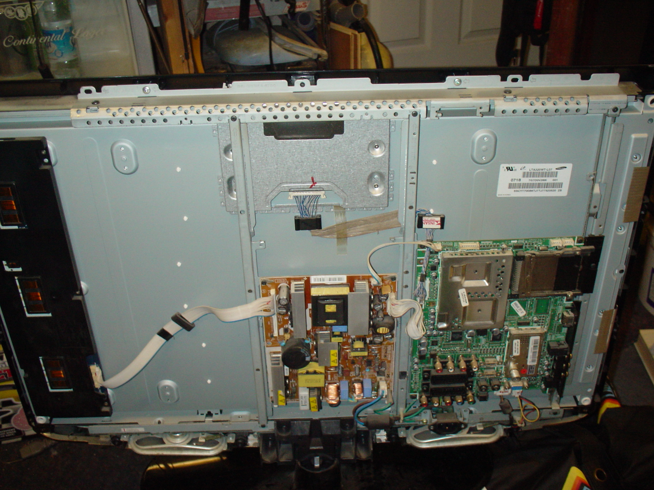

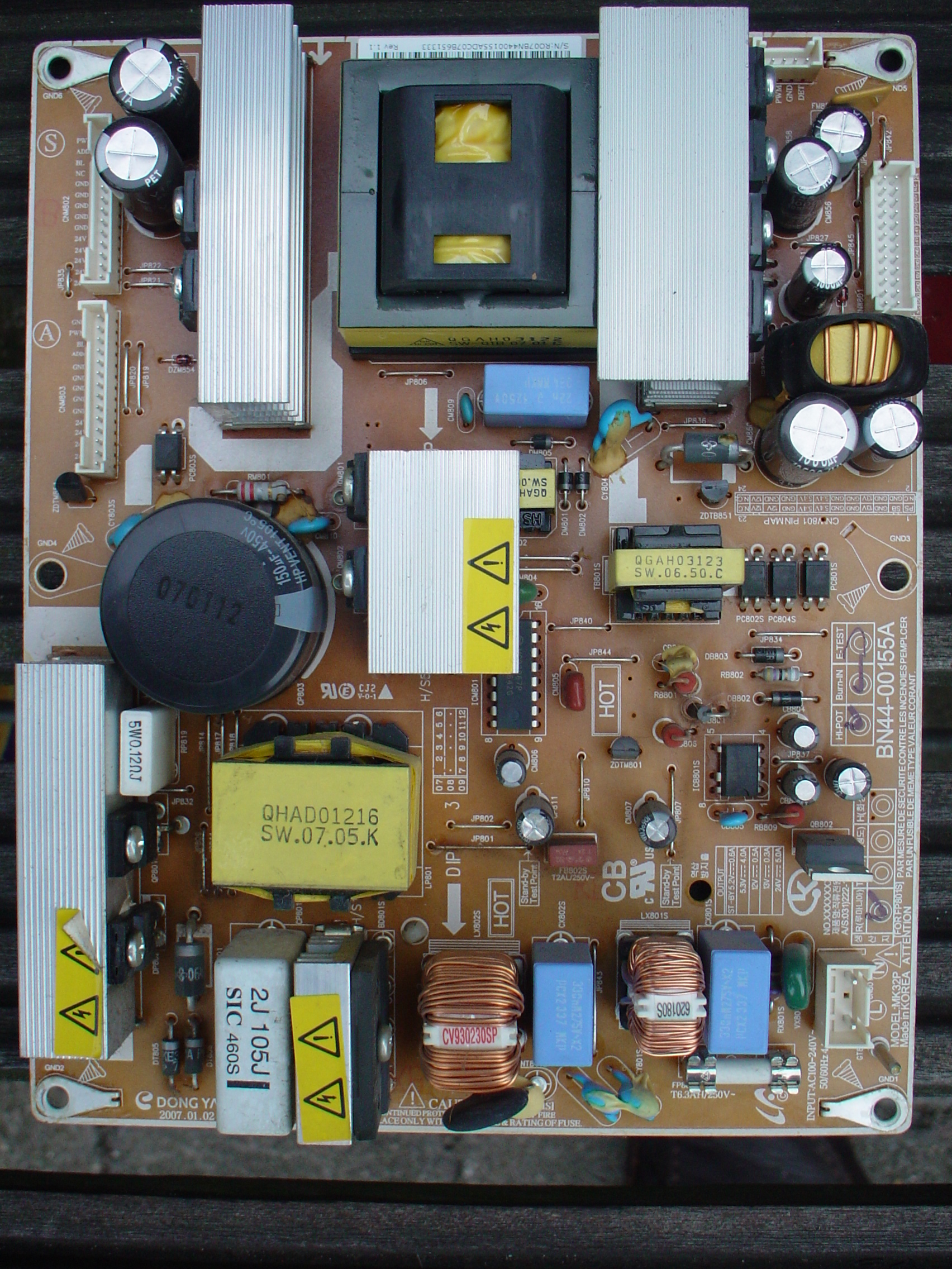

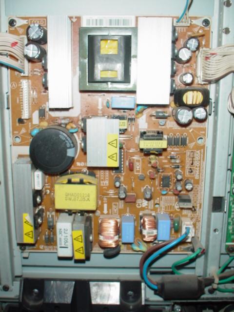

            Re: Samsung LE32R87BD in standby, red led, can it be switched on without the remote?

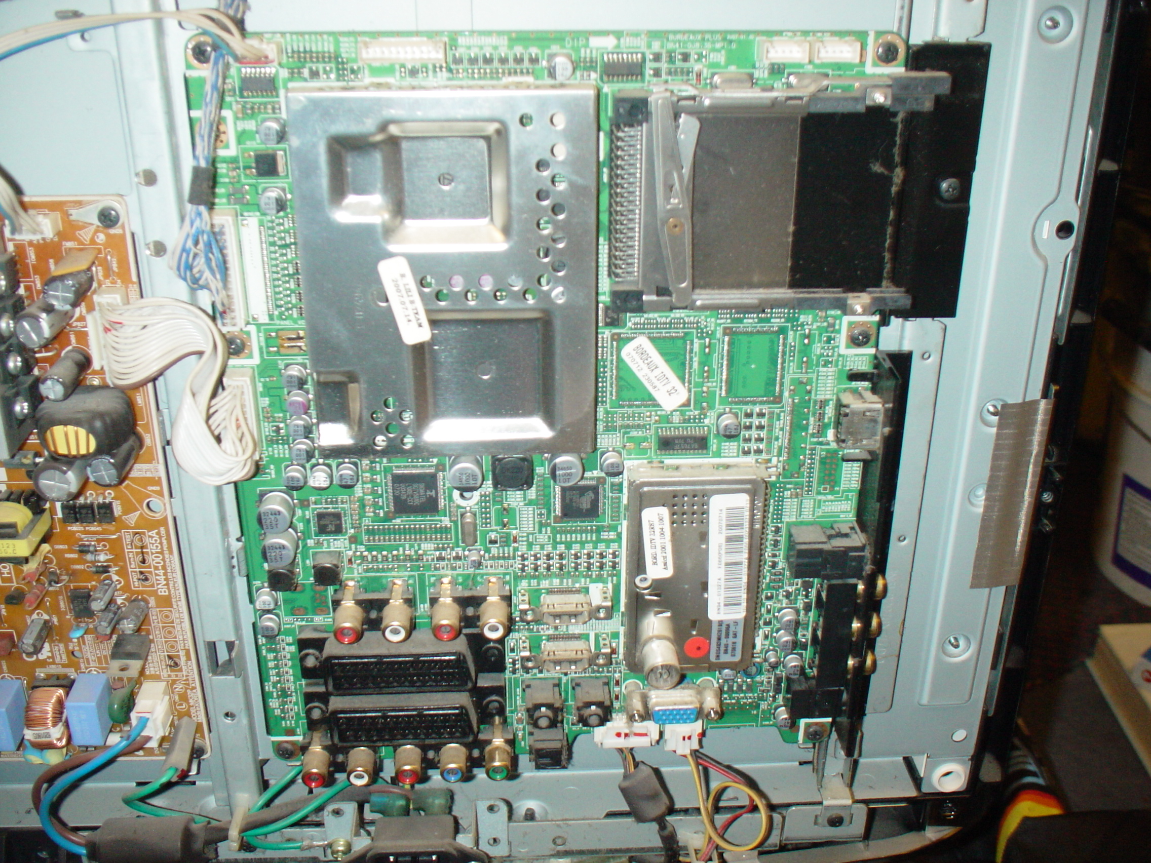

            Sorry i did not get the pics up yesterday, looking after the little one and had know time.
            There are two sockets on the PSB one the top right. The top one has a plug in it going to the left of the panel. the one below does not have anything connected to it.
            The top one, from the top going down the pins are
            PWM
            AdM
            NC
            5 x Grd pins
            5 x 24v pins
            The one below is
            Grd
            PWM
            BL
            ADM
            5 X Grd
            5 X 24v
            The last two pics are of the same board, just one might be clearer than the other. I dont have great light in the garage, so might have to set something up if they are not good.
            Cheers
                                Not sure if it will help, but here's the service manual
                                http://tgohome.com/ServiceManuals/?d...&Search=Submit
                                Assuming pin 1 is labelled as pin 3 in the main board schematic (here) that suggests the main board uses this to control the power on/off. As there are no other pins.
                                This suggests the main board is trying to turn the TV on, but the power supply is not responding - possible a power supply issue then.
                                Check all the diodes as I indicated.

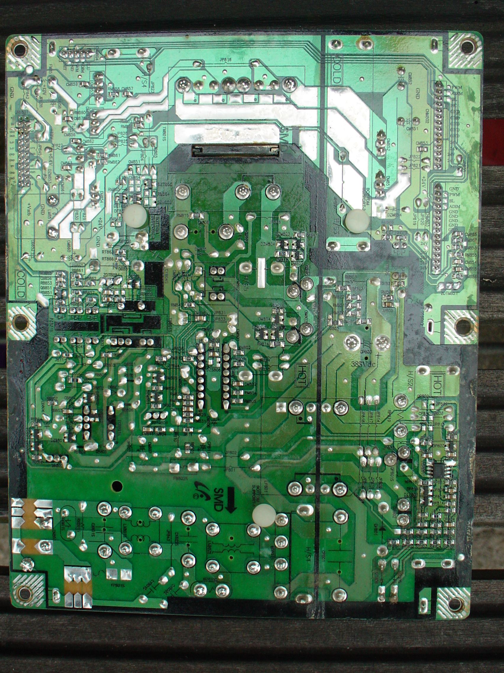

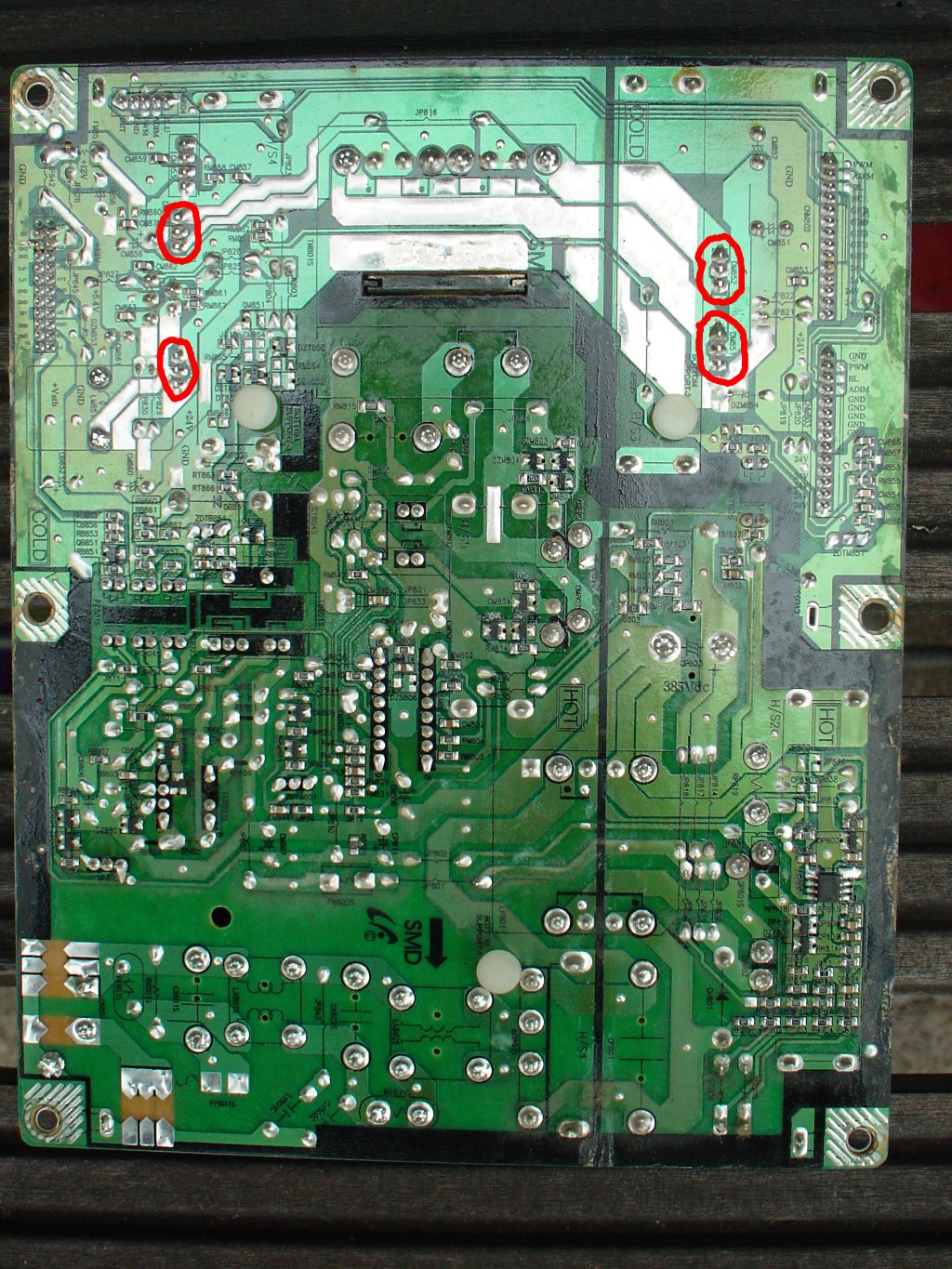

                                    Here are your secondary diodes.
                                    To test:
                                    - Remove and disconnect board from everything.
                                    - Mentally number pins 1 thru 3. Order isn't crucial but be consistent.
                                    - Set your multimeter to DIODE test mode. It looks a bit like this: ->|-
                                    - For each device:
                                    - Place red probe on pin 1, black on pin 2.
                                    - Place red probe on pin 2, black on pin 3.
                                    - Place red probe on pin 3, black on pin 1.
                                    - Repeat these measurements with red and black reversed.
                                    - Report back with readings with the diode reference, e.g. DM805, in the post. If possible, note the part# written on the diode.
                                      ok, so from the back of the board.
                                      no:1 top left
                                      N6J
                                      FCH10A06
                                      170
                                      Test 1
                                      .204
                                      2
                                      1.424
                                      3
                                      0.00 dead short.
                                      no2: bottom left
                                      N6G
                                      C010A04
                                      6074K
                                      Test 1
                                      .163
                                      2
                                      1.246
                                      3
                                      0.00 dead short
                                      no:3 top right
                                      EN2104
                                      69173B
                                      test 1
                                      .189
                                      2
                                      1.520
                                      3
                                      0.00 dead short
                                      no:4 bottom right
                                      Test 1
                                      .189
                                      2
                                      1.521
                                      3
                                      0.00 dead short
                                        Diodes are all okay.
                                        Next step - unplug inverters and main board. Use 1kohm resistor to pull PS high or low. Do rails 13V, etc come up?
