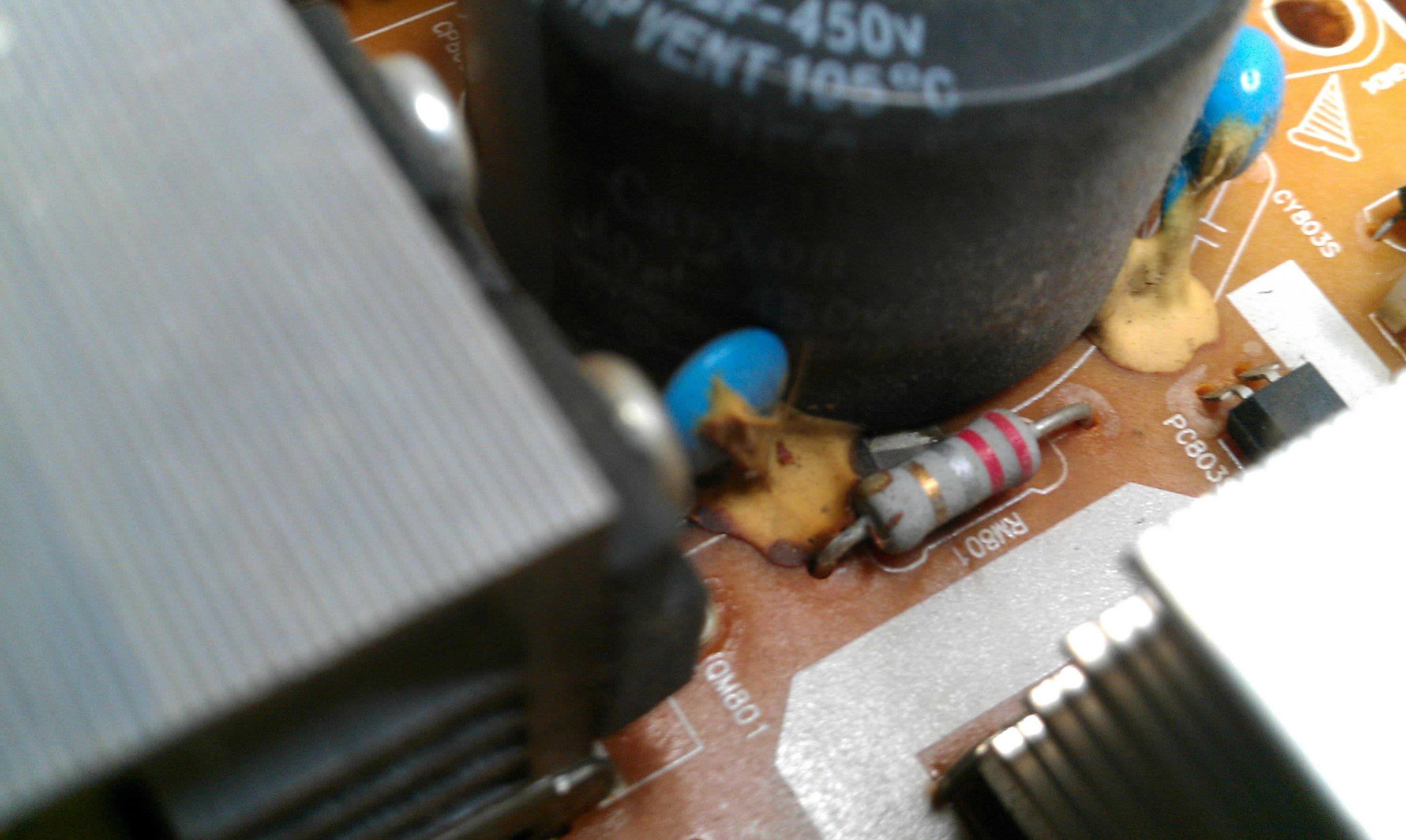

            Looking at this thread here
            https://www.badcaps.net/forum/showthread.php?t=17044
            My board don't look to cleaver around this area
            Not a great pic because it was on my phone in the garage.
            Can get a better pic if needed.
            Can i test these two components on the board or should i just change them?
              Re: Samsung LE32R87BD in standby, red led, can it be switched on without the remote?
              Clean the glue completely (chip it all off) and carbonisation. However, I thought this fault blew the fuse. I'm not certain though. Definitely clean if off though because it could cause a problem later.
