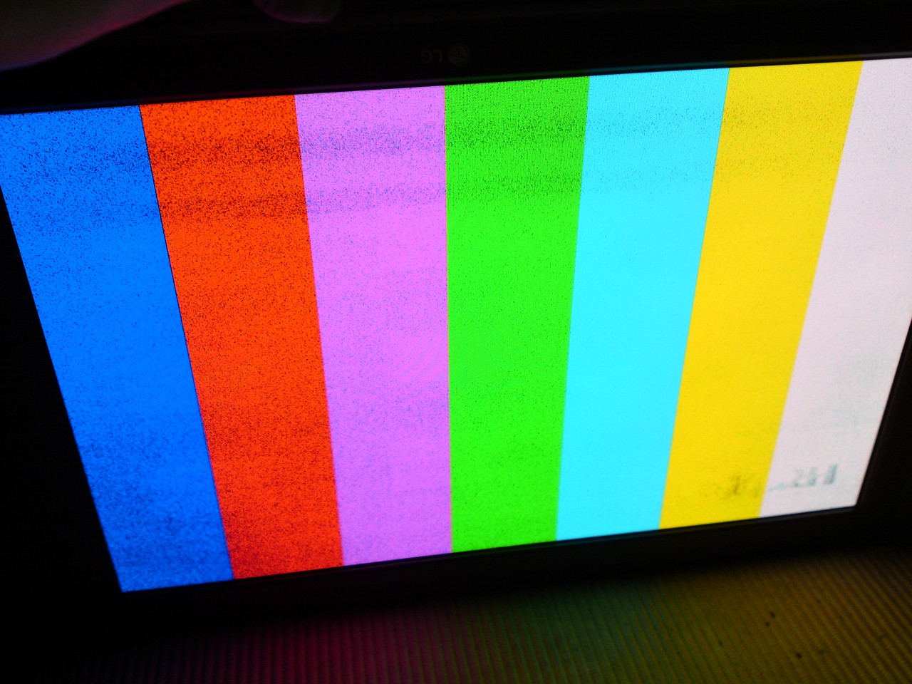

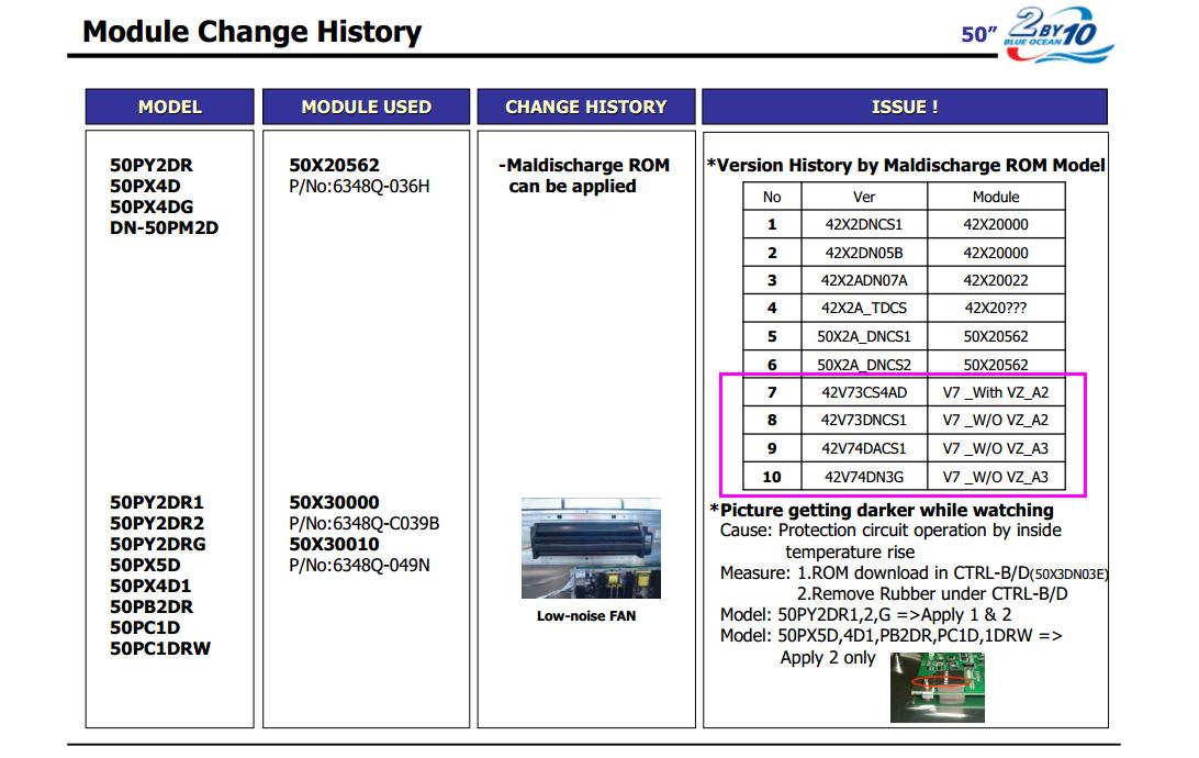

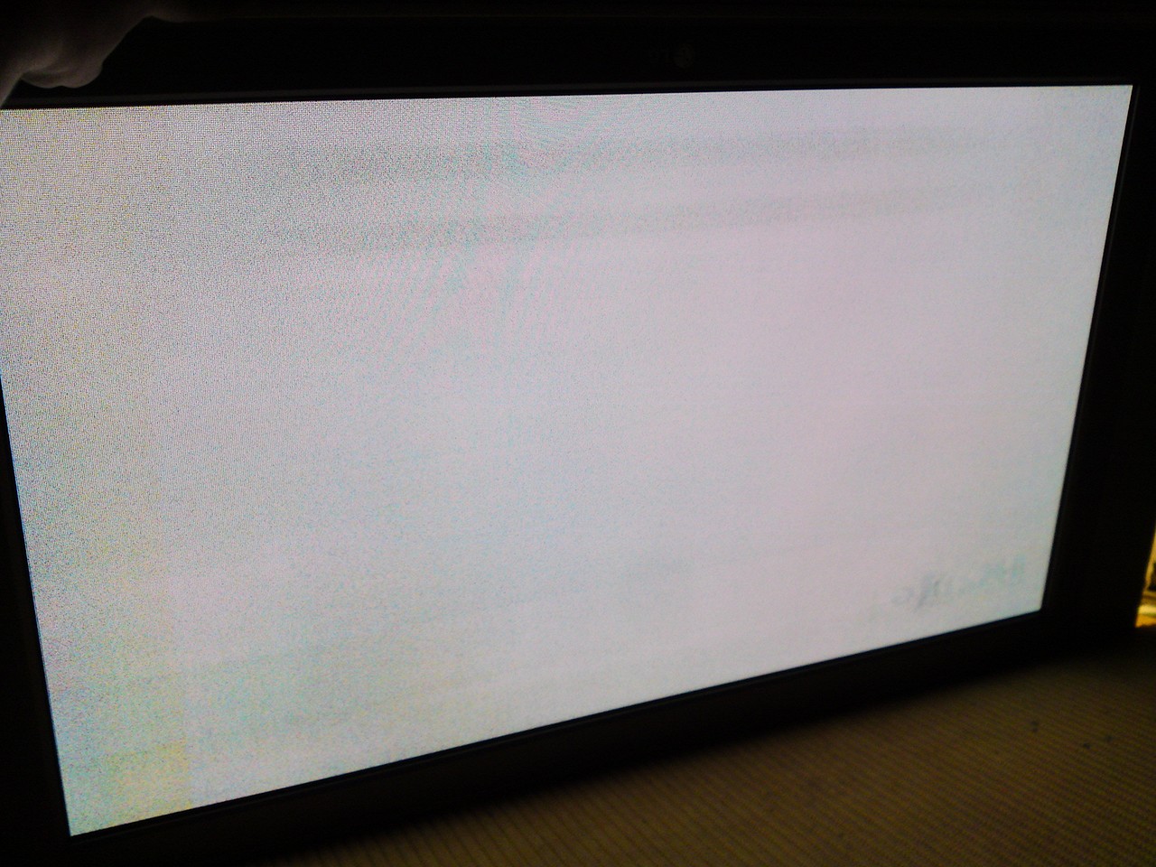

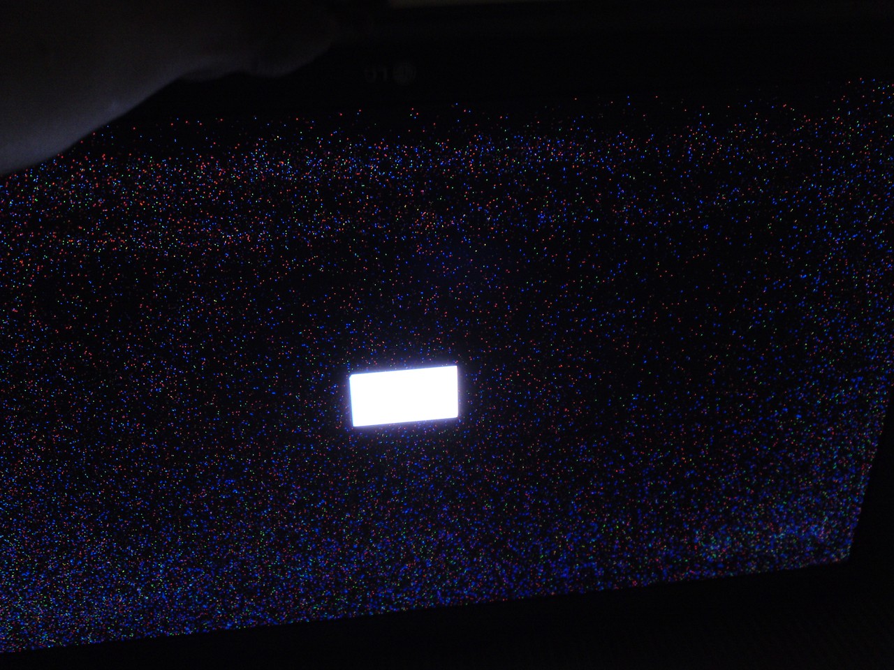

      Well Tom I'm affraid you're probably right. I did some testing today, I have some interesting results. I adjusted Vs, Vsc and -Vy plus/minus 5 volts, I didn't make it much better. Acctually it make it worse when decreased Vs for 5 volts. I tweaked VsetUP and VsetDN and couldn't get it 100% ok but it's now as good as it can possibly be in this condition. There are random sparkles all over the screen noticeable mostly on black areas or light to dark transitions. Most of the time picture is vivid and bright, but when it comes to full white picture there is some lack of brightness, screen burns are visible from subtitles and channel logos in the corner as well as bars left and right from usage of 4:3 conversion. When full white screen is displayed IPM's and/or other parts inside produce more buzzing noise which is I suppose normal.
      In menus I found "White Wash" option and tried it few times for few minutes. I don't see any difference and acctually I don't see why and how should full white screen "wash" screen burns?! Eh?
      I also found and turned on "Eco mode" which decrease brightness little bit while conserves energy. Important thing is that TV still has lot of brightness (acctually for me it's too bright in normal mode), BUT I noticed IPM modules run lot cooler in "Eco mode", especially Y-SUS IPM. I believe it can prolong life of TV a lot.
      One thing is peculiar, if there is full white screen, screen burns are visible and there is some lack of brightnes like there is lack of power, BUT, if there is only full white part of the screen, screen burns are not visible and there is no lack of brightness, even on areas with severe burns it's 100% white and uniform.
      TV is obviously well used. It looks very clean inside, I suppose it was used in a clean, non smoking place.

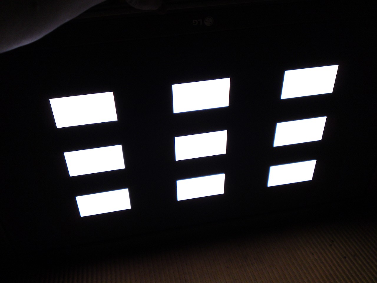

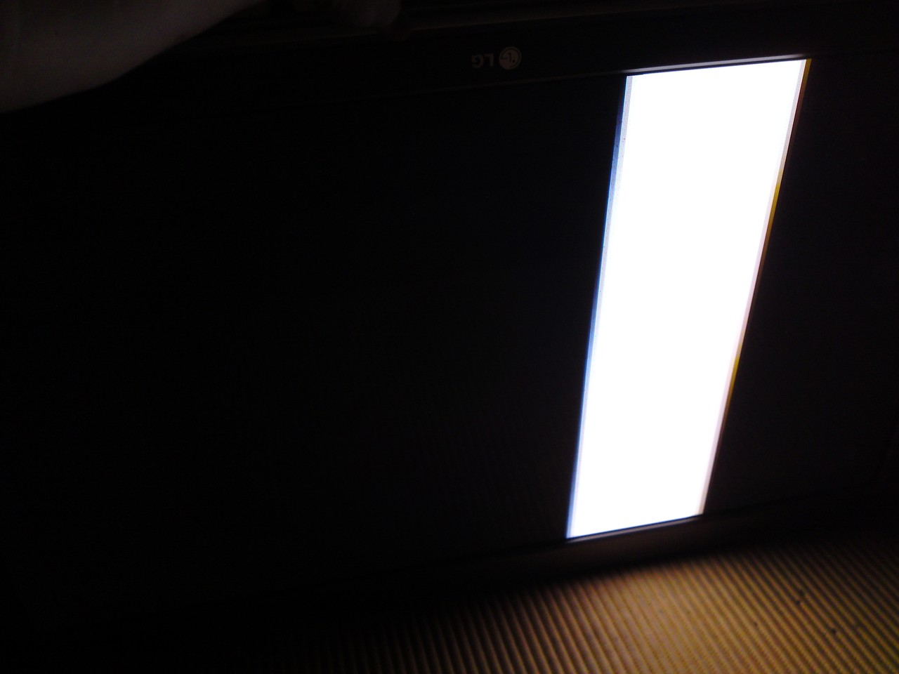

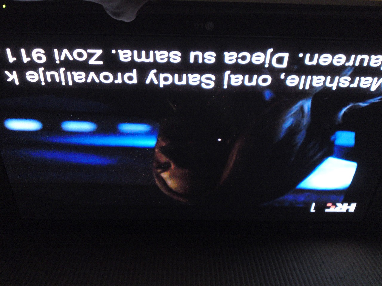

      Finally, I got automatic test patterns from CTRL board. The CTRL board is capable of generating its own video test patterns. There are two possibilities, both based on jumper positions R406 and R407. Problem is that patterns change every second and I don't know how to stop it or choose which pattern to display. Pressing buttons on TV make no difference, and I don't have remote control. Test signals just confirmed screen burns like with "white wash" and lot of sparkles on full white to full black transitions. There are some patterns with thick full white bar going across screen and no burns were visible.
      About the firmware upgrade, I don't know where to find ROM image, and I don't have JIG to program the CTRL board flash. I only can desolder flash IC and try to program it on a PC with proper programmer.
      And finally, I believe it could still be a capacitor issue. There are some post about people fix random sparkles with Y-SUS recap. There are several 10u/350V and 150uF/250V Samwha caps near IPM heatsink that get quite hot. It's obvious when TV displays full white image there is lack of power. ..or could it be because I used Sanyo STK IPM and not original LG IPM?!
      Guys, what do you think?? Please, I really need some suggestions.
      Take look at the pics...

      This post describes it well:
      http://www.electronicspoint.com/re-l...e-t243746.html

        I think it's fairly normal for the older plasma TVs to struggle with full white, because that means drawing close to 400W, and the power supply is starting to struggle because it is made very cheap. You will sometimes see Vs drop by a couple of volts when on full white.
        I had an LG with the same issue as yours and in normal content the sparklies were essentially invisible from a 10 foot distance. It was 720p, so the dots were less visible, but it was still annoying.

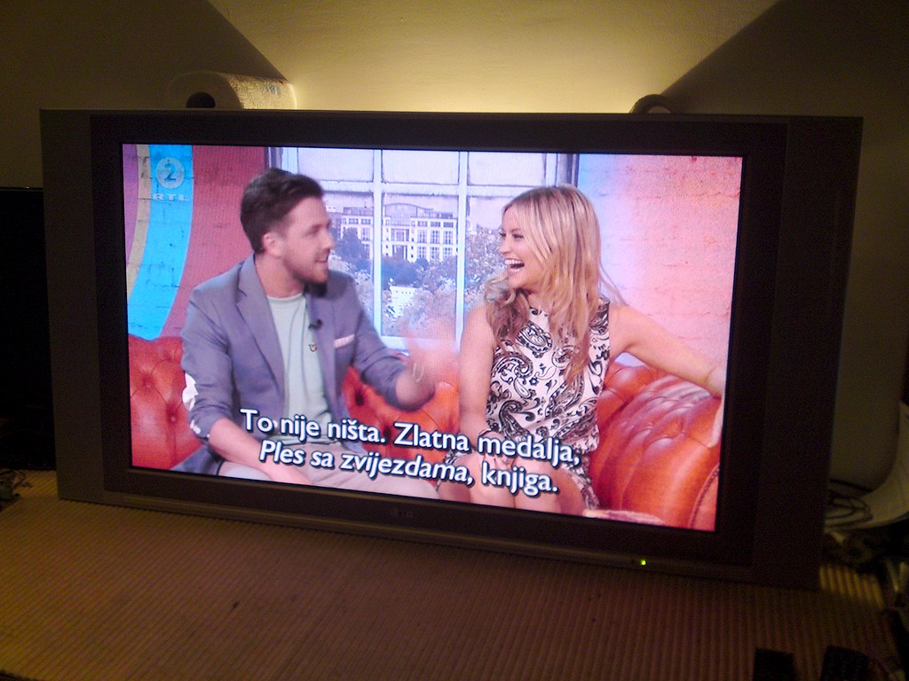

          Well, this set is obviously well used. I'll check some caps when I get ESR meter. Actually, it's watchable even with dots/sparkles and slow white-to-black transitions. I can live with that, but if possible I would like to make it better.
          What about the firmware update? Do you think it will solve my problem and TV will get rid of sparkles and visible burns on full white screen?! Service manual says ti should.

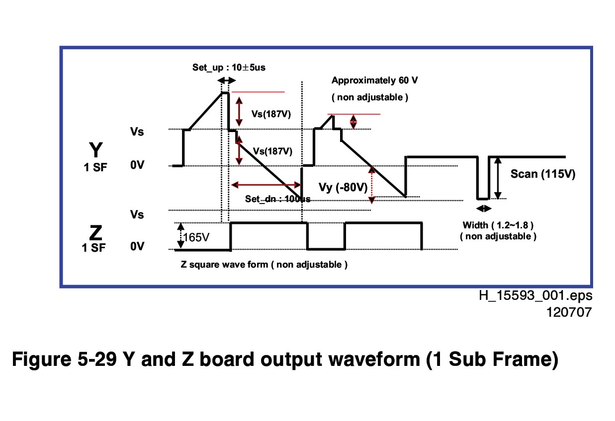

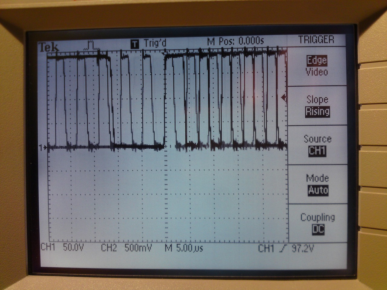

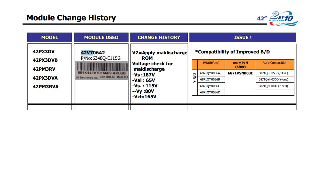

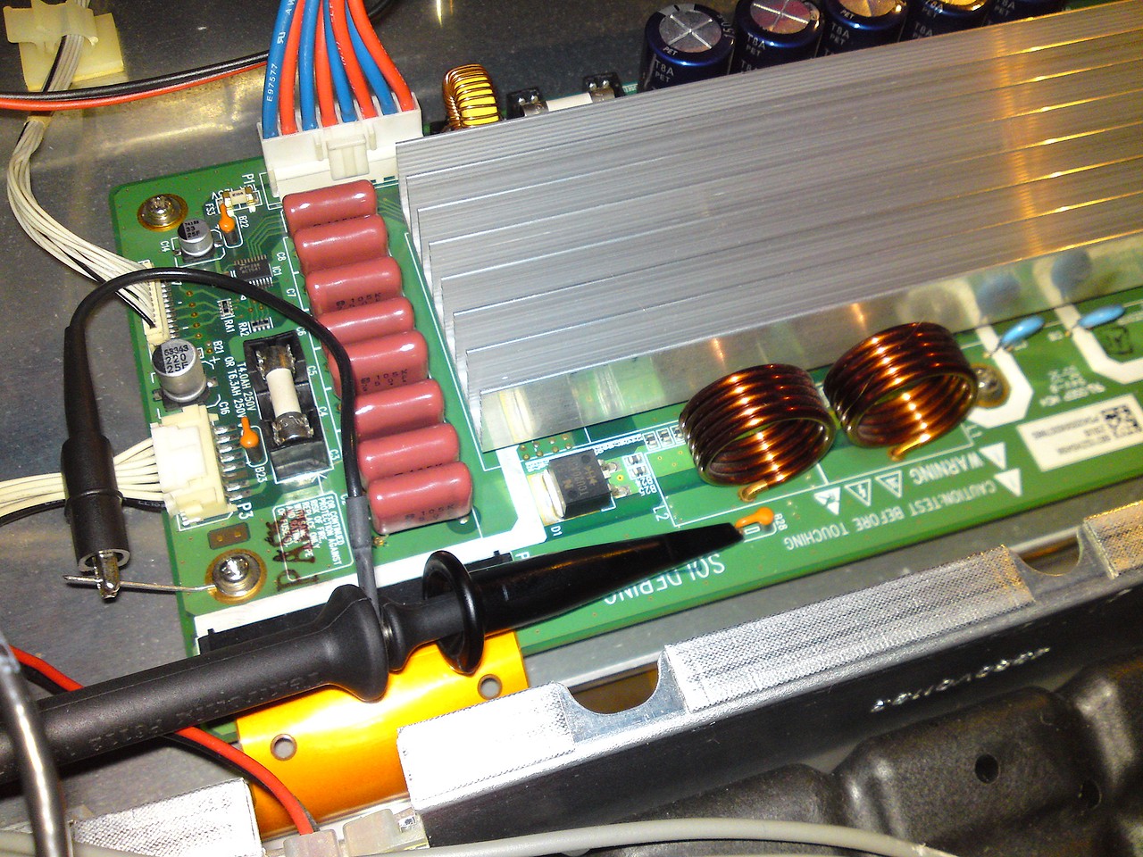

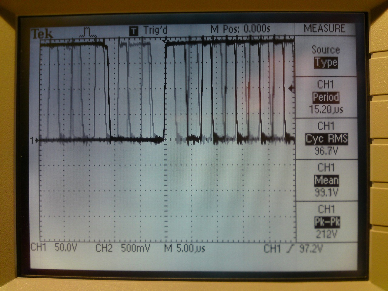

          Btw, I tested Z-SUS output with oscilloscope. Wave looks ok, but it is around 200V peak-peak?! Service manual says it should be 165V and it's non adjustable. Did I do something wrong oscilloscope settings or readings? See pics.

            Remember your scope and probe probably have a combined 5% error.
            The Z sus only drives between Vs and Ground and handles the energy recovery portion of the sustain cycle ("stealing" energy from the panel's integral capacitance, the energy of which would otherwise be dissipated as heat.) So if Vs is around 200V, getting a peak-to-peak of 212V is about right...

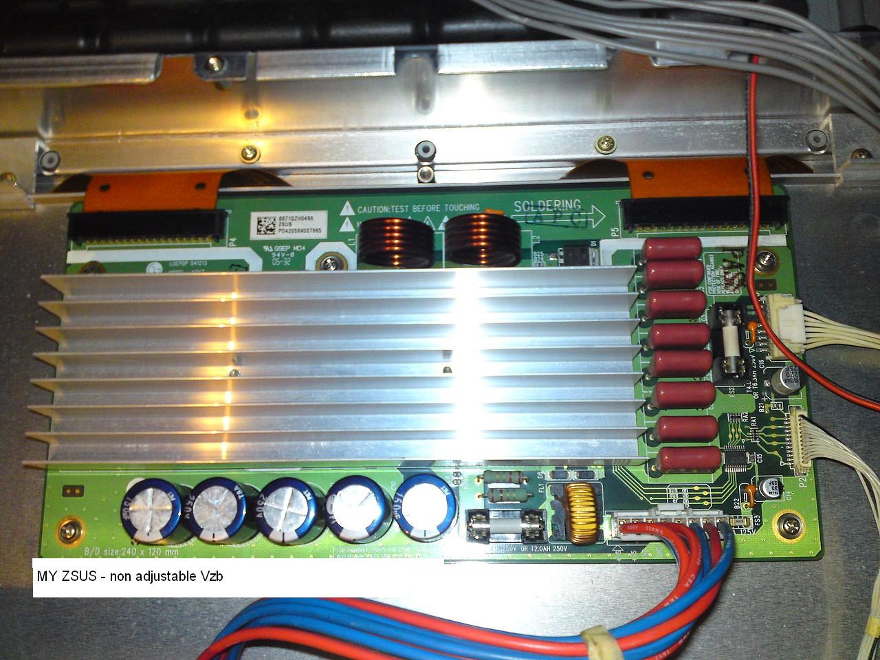

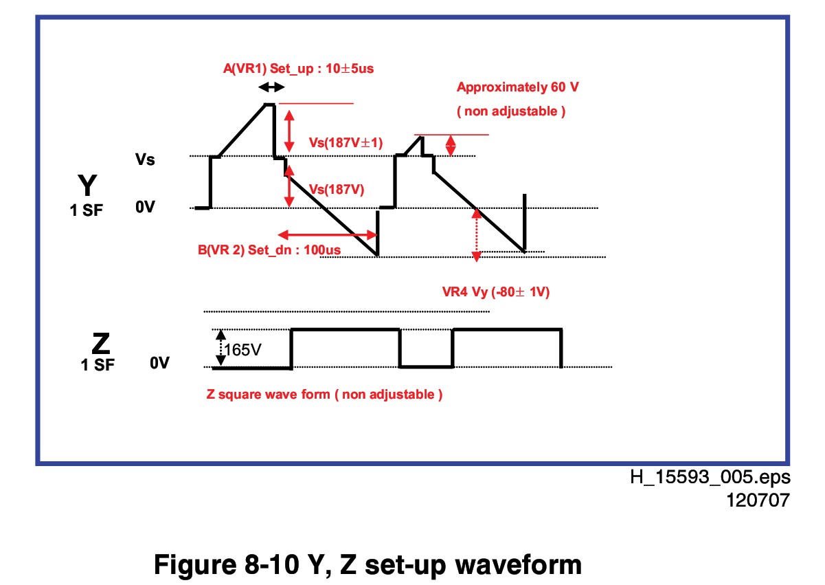

                So what does mean this 165V on this picture of Z waveform form service manual?

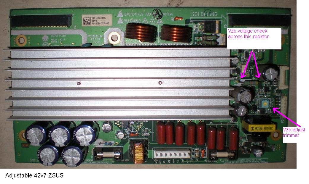

                I noticed there are to possibilities on 42V7 regarding ZSUS board. One has adjustable trimmer for Vzb and other does not have it and Vzb is non adjustable. I also noticed there are two versions of maldischarge ROM. One is "With VZ" and other is "W/O VZ". I suppose it maybe refer to which ZSUS board is installed and proper CTRL board and/or maldischarge ROM have to be used in conjuction with type of ZSUS board. What do you think, am I right?!? There are also new voltage settings for Vsc and -Vy after maldischarge ROM installation...

                  As far as I know, Vzb on the older boards is just for getting the gate drive waveform correct to the IPM's internal MOSFETs; so it shouldn't matter if you can't adjust it, because it is probably automatically set on the newer boards. Strange though, LG would usually release a whole new panel e.g. 42V8 (which I don't think exists) if they were to make a change like that.
                  I think 165V is a mistake. Also consider that your scope is probably including the ringing on the waveform, try and measure it using the cursors feature.

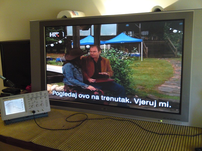

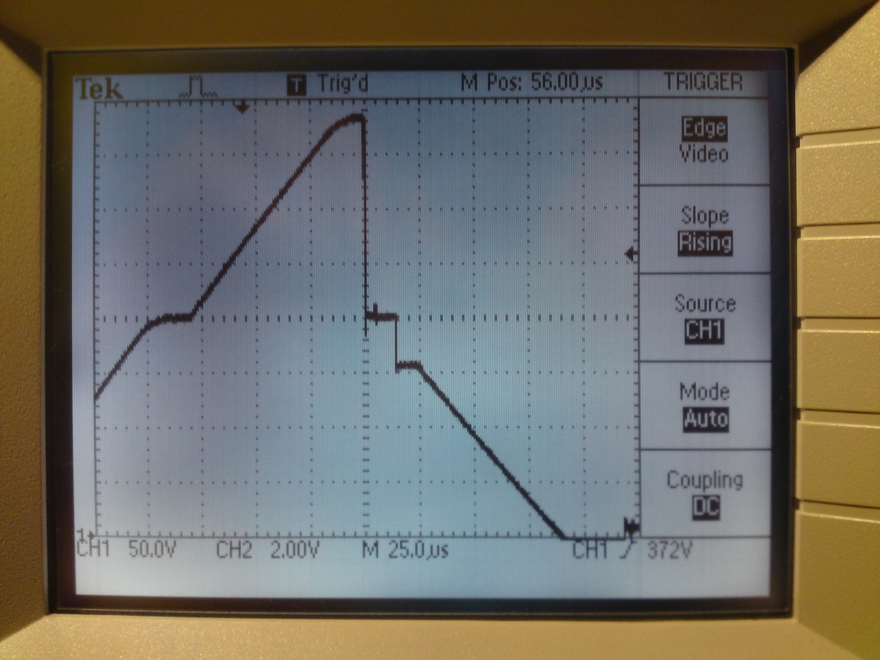

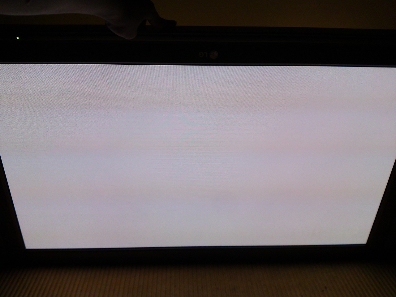

                    I did some testing and "tweaking" of SetUP and SetDN controls on YSUS, this time just looking at the screen, without oscilloscope ;-)
                    Well, finally I got very nice full white screen. It's white, uniform, without visible screen burns. There is no drop in brightness, PSU bears it very well.
                    However, there are still sparkles mostly on bright-to-black transitions and there is very noticeable "memory effect" or ghosting when something bright stays for some time and then disappear. Eg. when subtitles disappear, there are subtle sparkles slowly disappear on it's place for a second or two. ..or on credit roll at the end of a movie, black background with scrolling white text, text leaves ghosting trail with some sparkles...
                    I noticed some caps get very hot on YSUS and ZSUS. One even electrified me little bit when I touched it's top!! I can't wait my ESR meter to arrive so I can test caps.
                    If I tweak SetUP and SetDN to have less sparkles, then full white screen look little bit worn with visible screen burns.
                    If I tweak SetUP and SetDN to update faster so there is less ghosting, I get sparkles all over the screen no matter what is displayed.

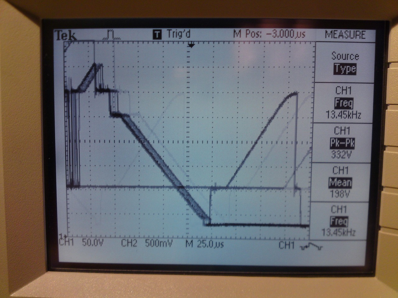

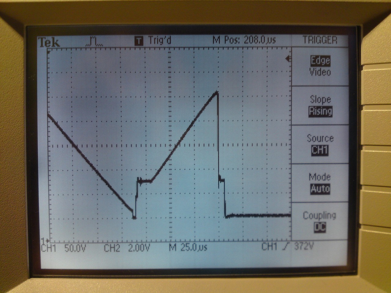

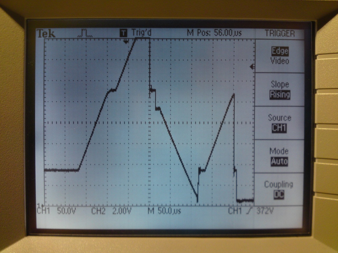

                      Look at my Y-SUS output wave. Isn't right part of the wave incomplete?! It doesn't look like on picture from service manual. What do you think?!

                        I noticed the same thing on my 42" LG, but I never quite figured it out - maybe the new ROM adds those timings to minimise the sparkling?

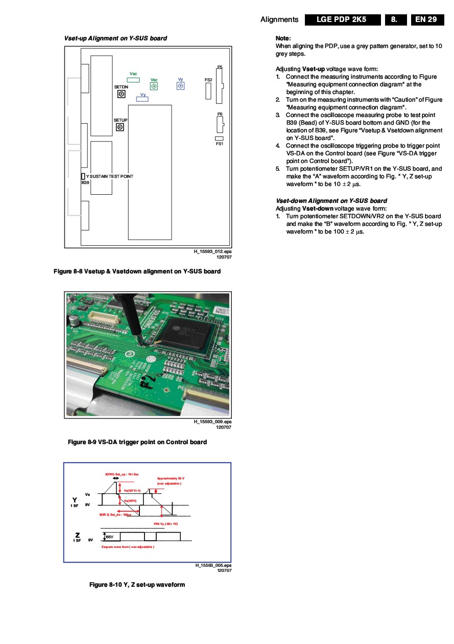

                          Next thing I don't understand is why I need to connect the oscilloscope triggering probe to trigger point VS-DA on the Control board as they say in service manual?? What it is for and how to adjust oscilloscope to use this extra signal? I connected second probe to ext. trig. input of my oscilloscope and I tried several options but can't find any benefit of the triggering probe. Perhaps I'm doing something wrong...
                          When I measure Y-SUS output wave I connect a probe to B39 test point and then manually adjust all knobs and trigger level to display a clean steady wave.

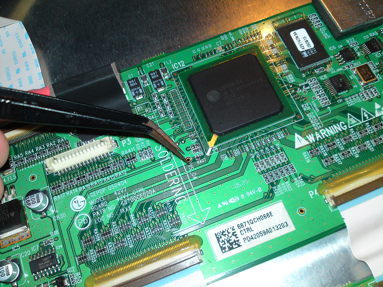

                          About the ROM upgrade, I got all ROM files from Barry :-) Now I have to figure out how to flash the EPROM without a JIG. I had in mind to buy new flash chip (cheap) and to put it (or solder) in TSOP 48pin adapter and than program it with standard programer (which I don't have), desolder it out and finally solder new programmed chip on it's place on control board.
                            My guess would be VS-DA is one of the signals going to the IPM. However, if the video signal has large variations in brightness across the screen, it may cause issues with a normal edge trigger - you really need a delay trigger for this. Have you played around with the hold-off control?

                            Looks fun. Never done it myself, be careful not to damage the board as it will be very difficult to repair.
