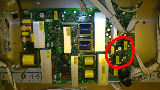

                    Re: Myrica p42-2H green shadows
                    Originally posted by nostrike
                    Unplugged left panel driver board. Set Vset at normal position. 195 Stable (like sticker) so something is wrong with left driver board ?
                    More likely a problem with the power supply, being unable to supply the required current. Can you post a closer picture of around here?

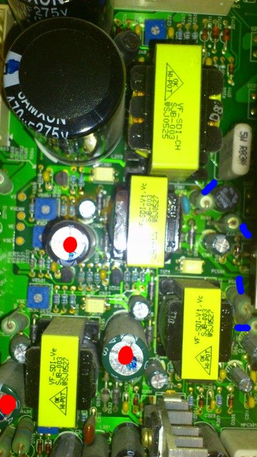

                      Close up picture you asked for:
                        #31
                        So this shows that no particular board is causing the problem, but it is the power draw from the plasma panel that is causing it. In which case, it is very likely a power supply problem. My first bet would be the caps for the Vset which could fail without bulging.
                            I would say replace these RED highlighted capacitors if you can. Do you have an ESR meter? A capacitance meter may suffice for a basic check, but an ESR meter is best.
                            Can you check the BLUE highlighted resistors - what is the colour code and what do they measure? (You might need to remove the board to do this. If you do so, leave the board unplugged for 5 minutes from the mains (but leave other boards plugged in) before pulling it.)
                                  colour code is :
                                  number 1 : from the top : black, black, yellow, gold - measure - 99,4 ohm
                                  number 2 : from the top : black,blue, yellow, gold - measure - cant measure - counts down from 1000 ohm to -ohm :S
                                  number 3 : from the top black, black, yellow, gold - measure - 98 ohm
                                  number 4 : from the top : black,blue, yellow, gold - measure - cant measure - counts down from 1000 ohm to -ohm :S
                                  Think my digital multimeter is a little funny or I made an error
