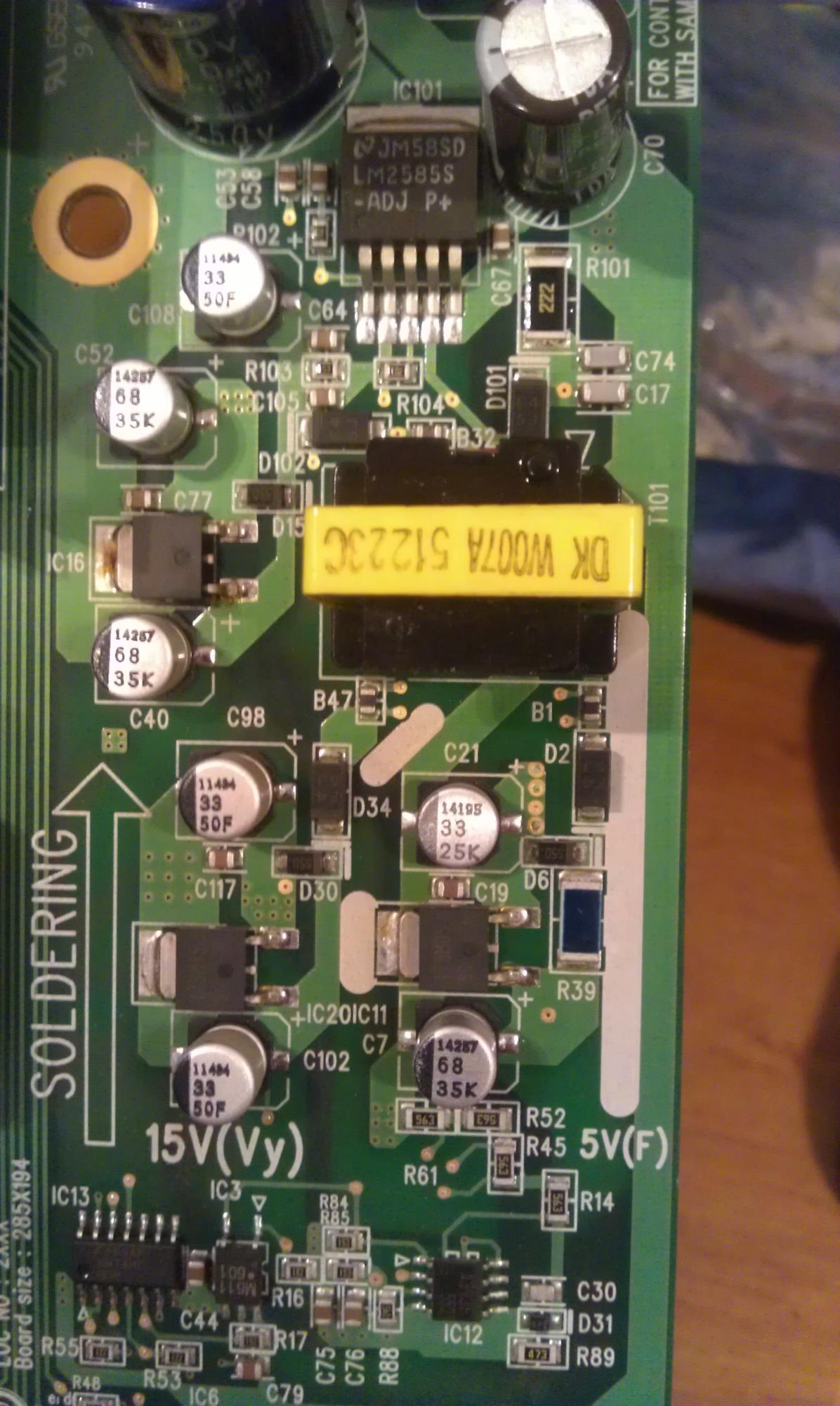

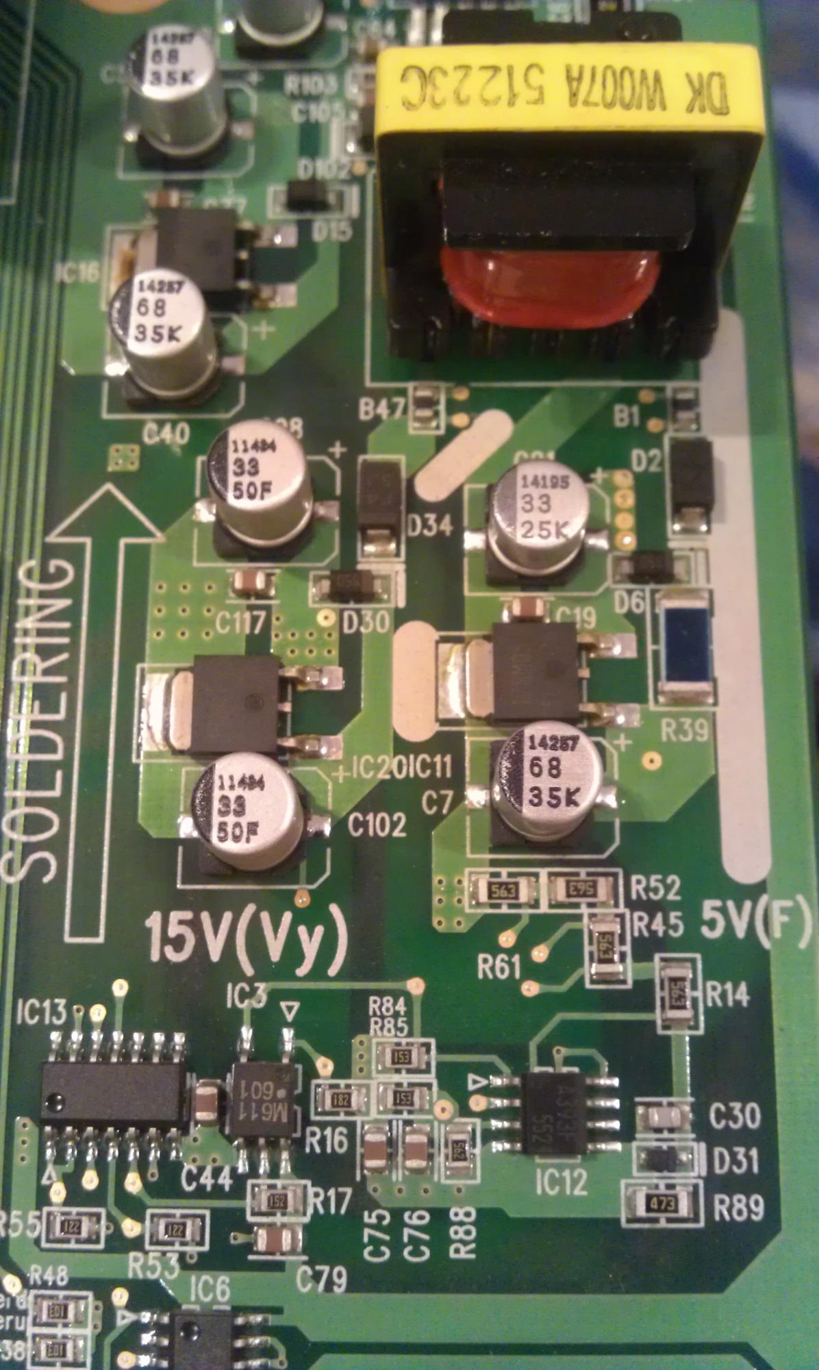

    Hi Lads,
    Back again with a short lived repair. Got the TV back, no picture but sound was still on, and it was not powering itself off, pulled of the back to see if the the fuse was blown as before on the Y-sus board which would lead me to maybe a failed Hybrid module, fuse was fine . Anyway checked across the the pins on the hybrid and it is shown a short between ground and 15v pins (2). is this telling me that the new part is shot already, think it's only in 4-6 weeks!!

    15V and ground is a rare short; possibly something else on the Y sus instead. For these LG chassis, they use a flyback converter on the Y sus to provide 15V power - if the diode for this shorted it would appear like a dead short across 15V and ground.

      Re: Hybrid failure already? LG42PC1D
      Tom can you locate the fly back on the picture for me and I can then check that for a short?
      Cheers
        It's the yellow transformer on the board (not the ones on the daughter cards for -Vy and Vscn.)
              Where do i check for 15v outputs?
                Can't remember exactly, near the yellow transformer usually.
                  I'll stick up a photo, do you think it's the flyback or a resistor feeding into the flyback?
                  • caspermccormack
                    • Mar 2012
                    • 112
                    • Ireland
                    I can see a small pad just above the 15v, i imagine that's the one. Will ineed it connected to the buffer board to test or will i get a reading from the psu to the ysus only?
                      You should be good without the buffers connected. That test pad just above the "Vy" looks okay. I suspect the output may be relative to -Vy, so if it fails to give a sensible reading try testing between 15V and -Vy.
                        Hooked it up with all boards connected, -Vy to the 15v pad is shown 21v.
                          Seems a bit high may be the reason the hybrid died. Is there an adjust point for it?

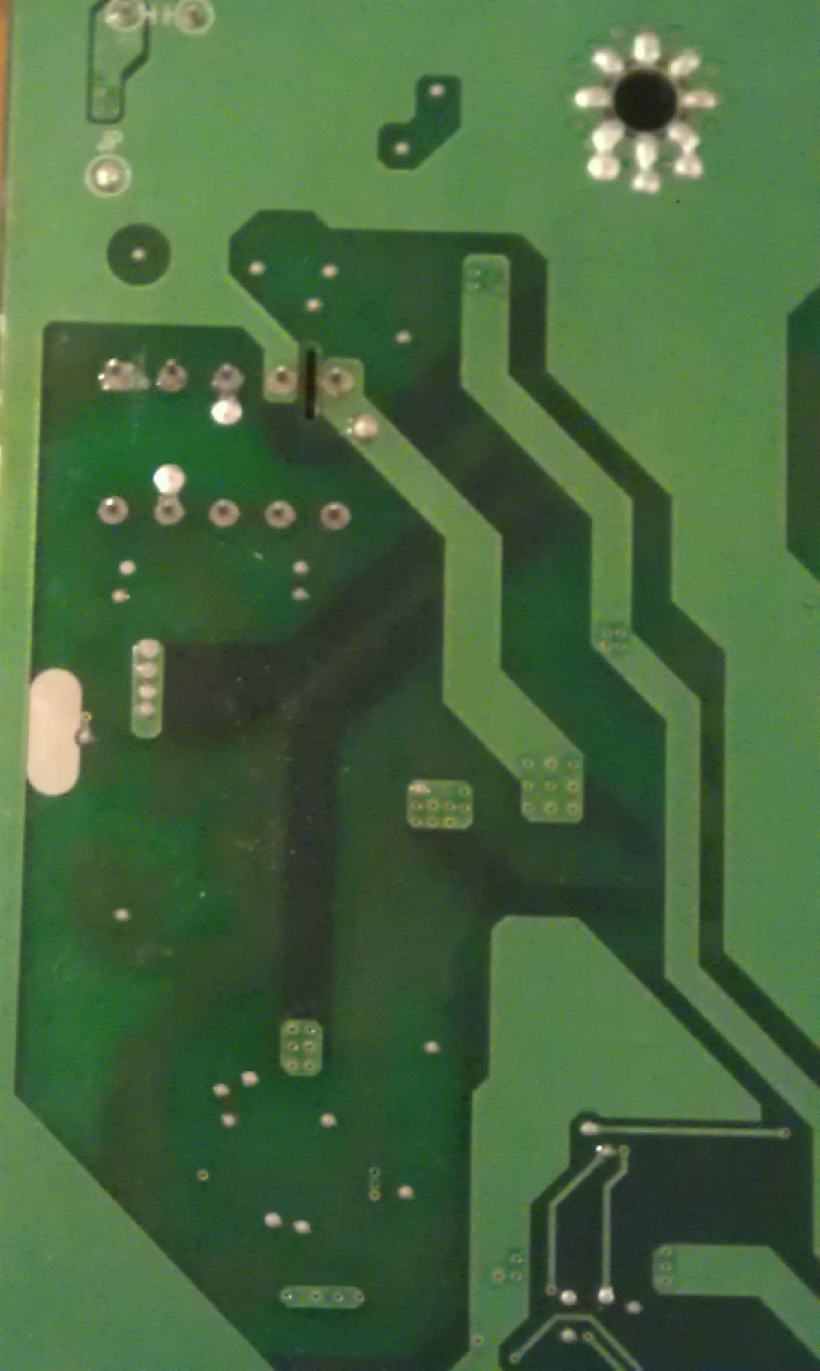

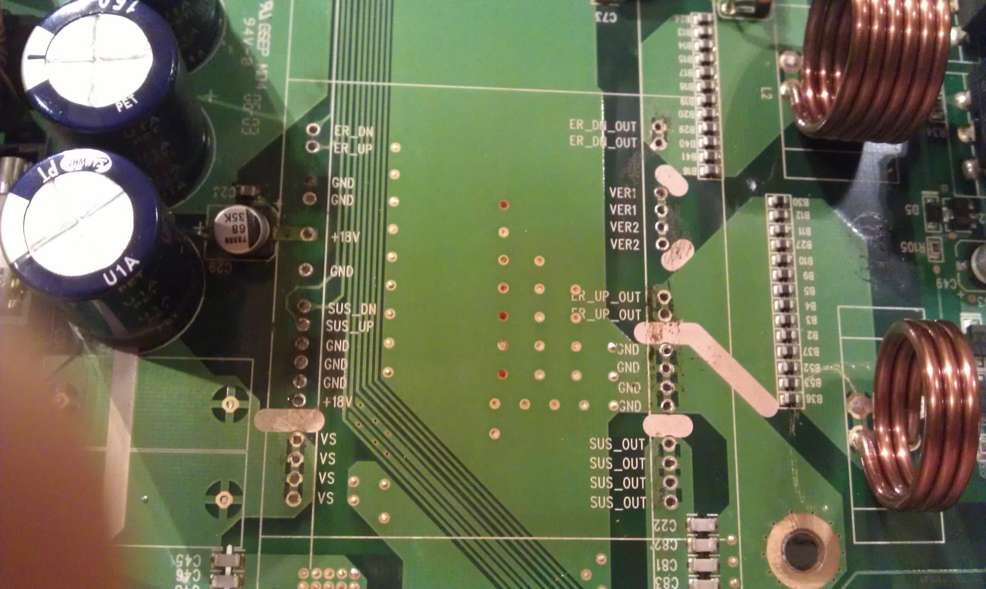

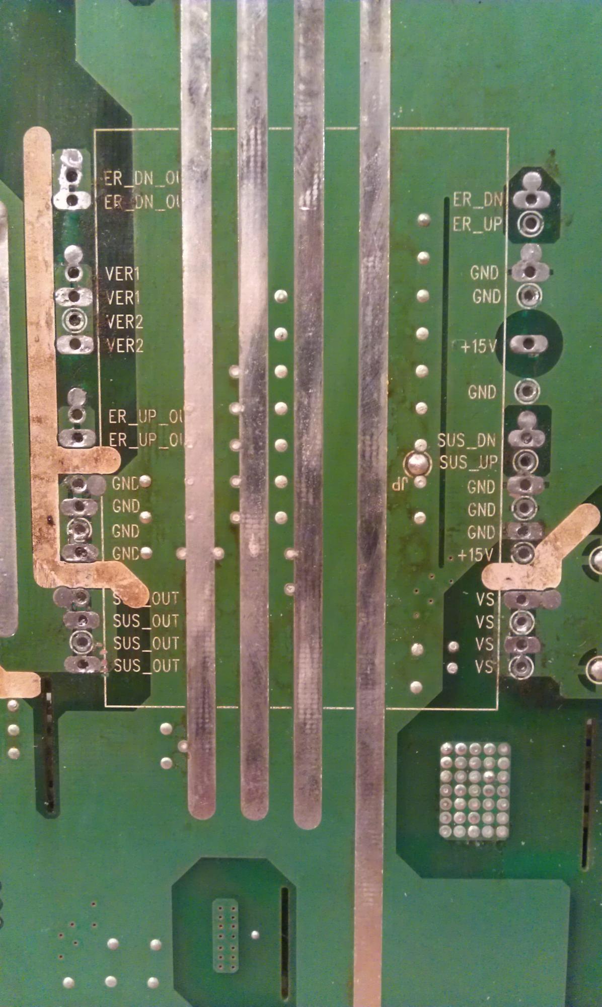

                              No pot for trimming, removed the hybrid and the short seems to be on the board, on the component side it is printed 18v and on the reverse side it has 15v.
                                a post in your old thread might help by adding a extra cap?
                                One word of caution; be sure to check that supply voltage to the IPM is stable +15V (or +18V) and of correct level. A bad supply could cause the new IPM to blow. This is because the supply is used for all gate drive circuits in the IPM and a too low gate drive voltage could cause too high power dissipation in the IPM power FET's.
                                Sometimes I use to add a 47uF cap directly between +15V supply and GND to improve ripple rejection close to the IPM.
                                  If i throw up a photo, can you show me where I need to add the cap??
                                  Thanks for your help vinceroger!!

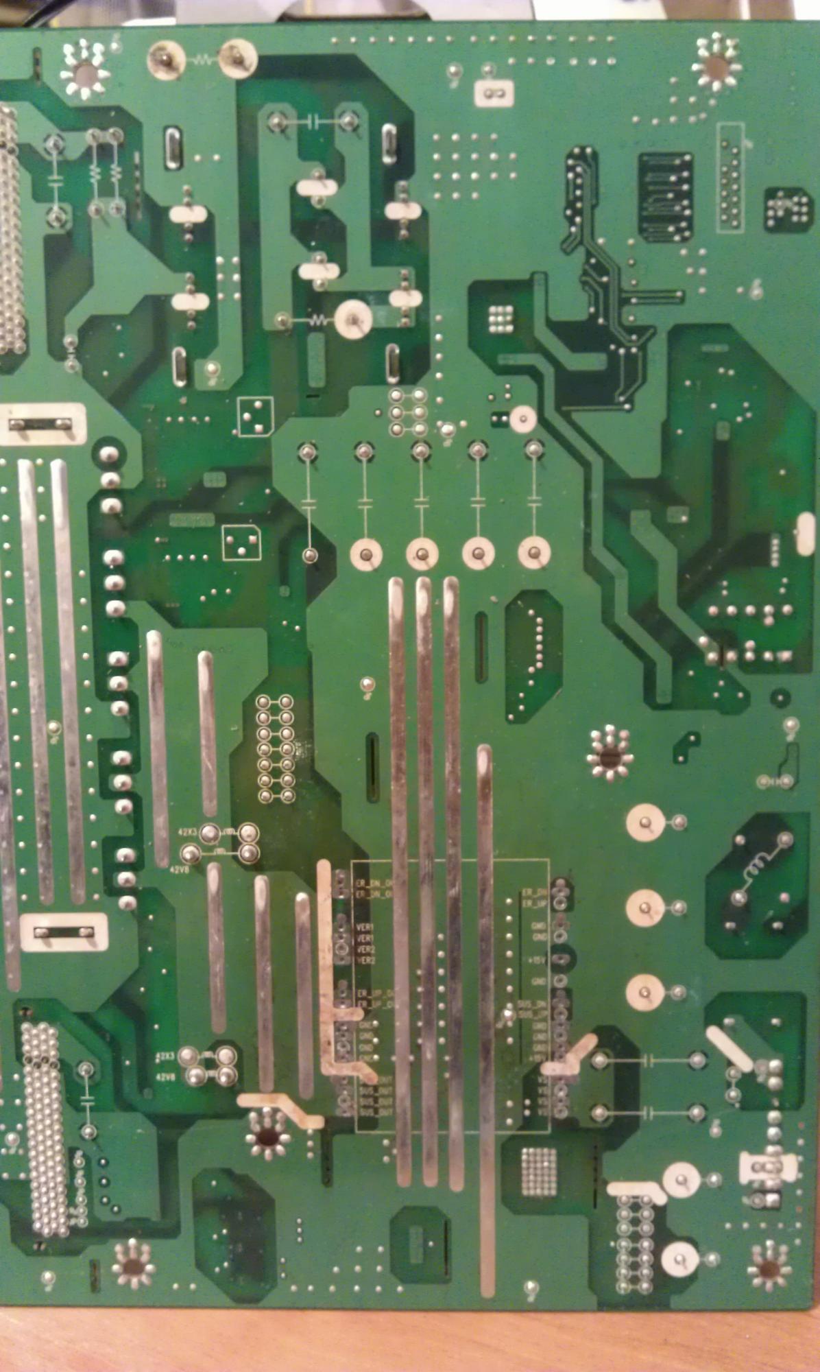

                                      Post a picture of the board on the underside - I'll highlight a potential candidate location.
                                      • caspermccormack
                                        • Mar 2012
                                        • 112
                                        • Ireland
                                        Hope these are ok?
                                        I take it that I should not have a short between 15v and ground with the board removed?
