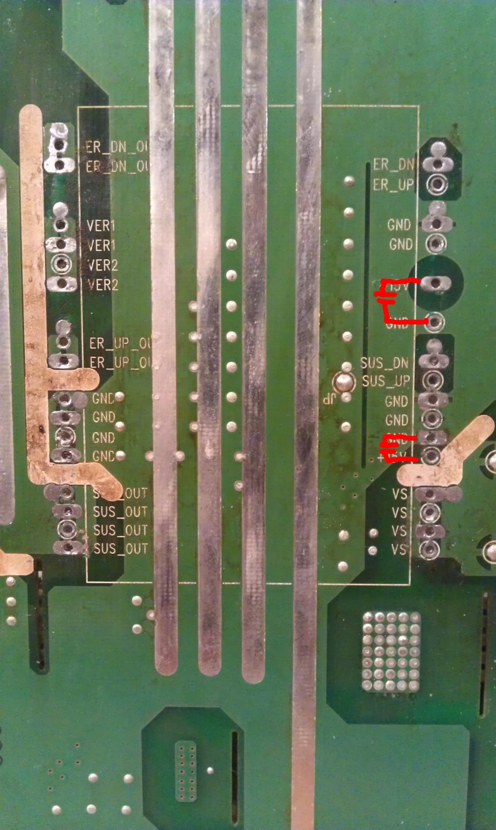

    First, check between 15V and ground, what do you measure?
    No short should be present after removal.
    Potential locations for caps are indicated in the image attached. Install both with ~47uF 35V devices (Panasonic FM is good here) - but ONLY if +15V and ground measures about 15V.

      Re: Hybrid failure already? LG42PC1D
      Sorry if its a silly question, do you mean measure it on the bench, out of the tv?
      With the board installed it was output 21.3v.

        Installed in the TV. You were measuring relative to -Vy. Try and measure between the hybrid ground (check if this is the same as the ground across the rest of the TV, if it is, you can use that for convenience, and there might be multiple 15V supplies on this board(!))

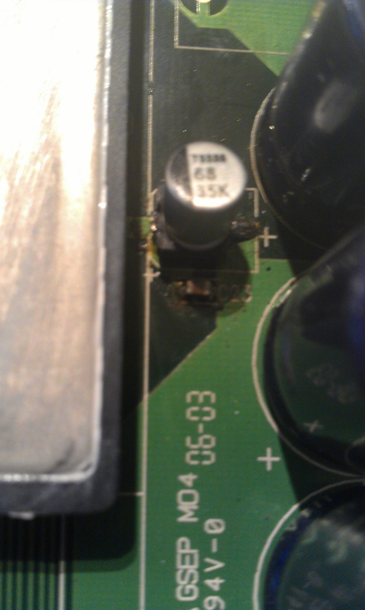

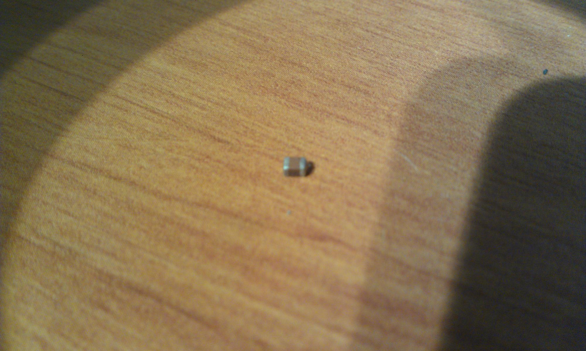

                  Think i may have found a short in a small diode/resistor? It's placed between the ground and the 15/18v trace, it has a small capacitor above it, once I removed the part there is no short. But i have no idea what to replace it with. Here is a photo of it.

                    #29
                    It's a 65 35k cap.
                      #30
                      Looks like 68uF, 35V. Should work fine...

                        #31
                        With out the surfacemount resistor?
                          #32
                          Not sure... that little thing would probably vaporise if it were shorted...

                            #33
                            with the DMM it's shown continuity arcoss it.

                                #35
                                4.6 ohms ?
                                  #36
                                  4.6 ohms ?
                                  P = V^2/R = 225 / 4.6 = 48.9W dissipated
                                  That 1/10W resistor would be history!

                                    #37
                                    I wish I knew what that means! So do I need to replace that part? And if so how do I know with what to replace it with?

                                      #38
                                      Got it working this morning, I have a spare ysus and found 65 if cap with the small resistor below it, put it on as a replacement and she's firing on all four now. However I am taking Tom's advice and going to put on the two caps to the 15v pins.
                                        What I am saying is that resistor is probably fine, you are possibly measuring another short circuit somewhere, as otherwise it would be melted very quickly. Like within 100ms.

                                          #40
                                          I had the old one out and with the Beeber on (multimeter) it beebed across it, didn't on the replacement and now it's working. Delighted!
