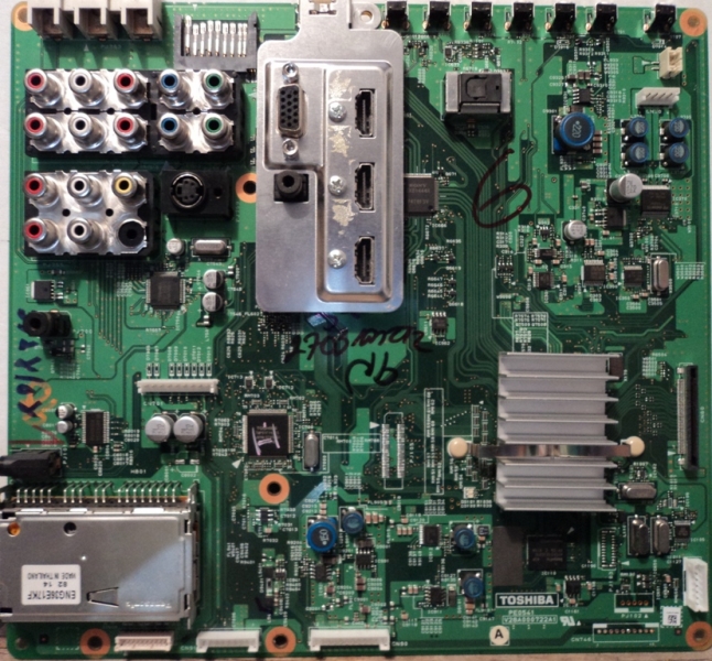

      When I was in the service mode I may have accidently changed a setting. Now the tv will Not show a picture. Is there a away to reset to factory specs? Thanks!
        Re: Toshiba 42rv530u firmware
        You can usually do it by connecting two pins on the EEPROM together. This will require you disassemble the TV though.
          Can you be more specific on the eeprom location, I'm assuming its on the main board? Which two pins? THANKS! Board is PE0541
            Yes, it's on the main board. If you get the TV apart take pictures of the main board. It's an 8 legged SMD chip.
              Here is the picture of main board
                Do you have a higher resolution picture... it's difficult to make out anything.
                  Is there a particular part of the board you would a better picture of?
                    Looks like this: http://www.mouser.com/ProductDetail/...tVWTs8nCsEyBPI

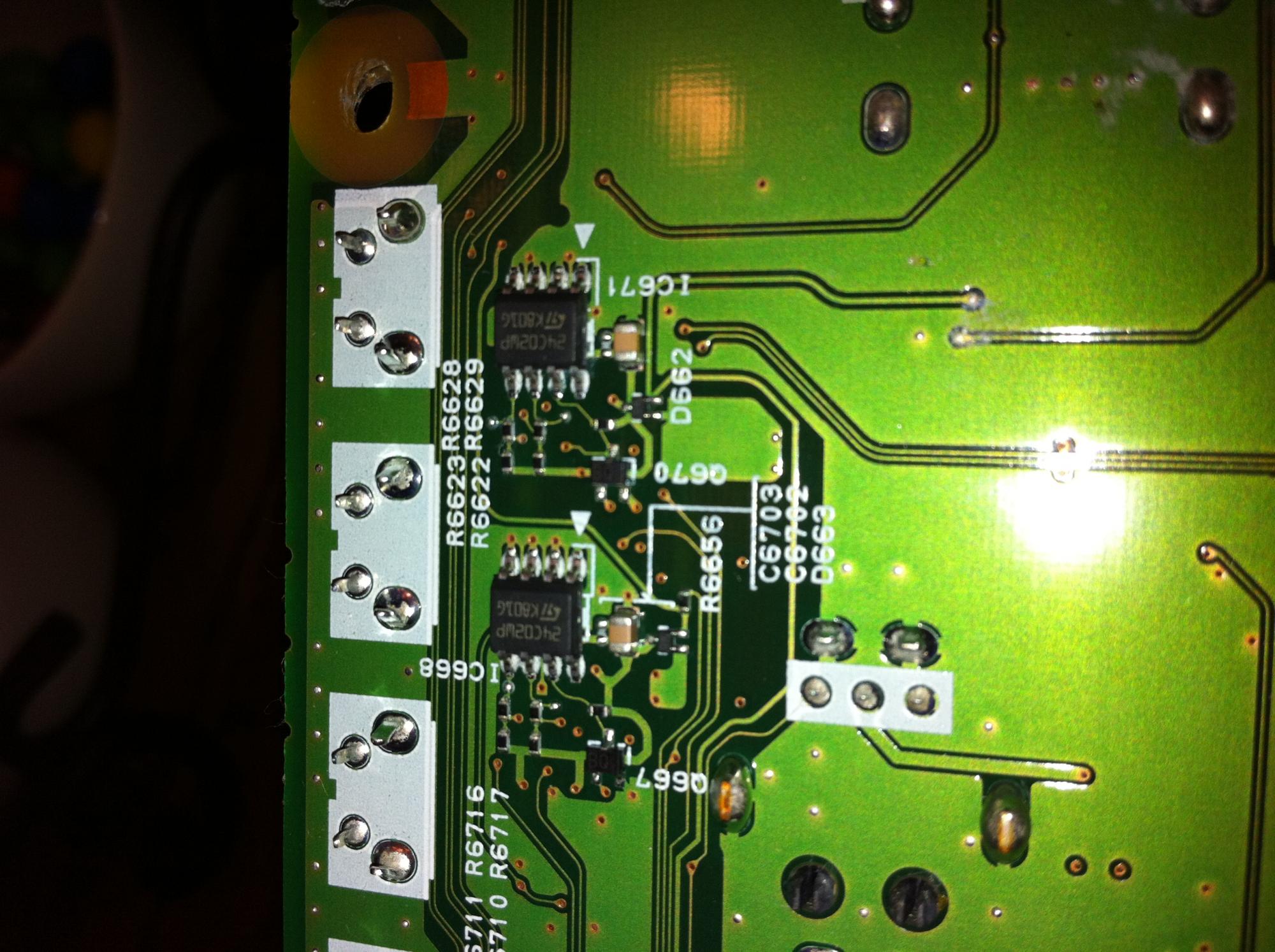

                          There four of them on the main board. Which one and how? Thanks
                            here's pics
                            • selldoor
                              Slow Learner
                              • Dec 2010
                              • 7870
                              Sorry your pictures are not much use. Too small.
                              Please try and get them as near to but not bigger than 2mb 2000*2000
                              and a better one of the whole board please.
                              If you click on them as soon as uploaded you can tell if they are any good then you can delete and re upload as an edit.
                                Trying to get pics to work
                                • kueberco
                                  • Mar 2012
                                  • 66
                                  • usa
                                  • kueberco
                                    • Mar 2012
                                    • 66
                                    • usa
                                    pic 2 to large
