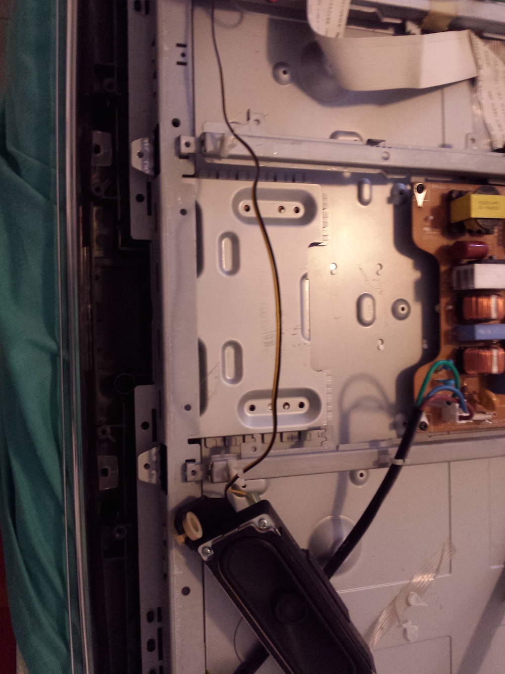

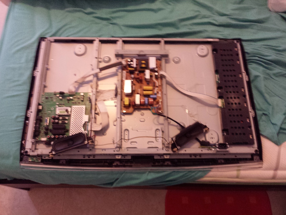

                    I know this has been a while, but I'm having a very similar issue; white fog like very high gamma, only for me it starts with normal colors and then in a period of few minutes gradually shifts to higher gamma until it's all white like you described.
                    My TV is also similar at least in the name Samsung LE37A450C2 ...
                    Now I know this might mean completely different placements and parts but I thought I'd give it a try and ask you this:
                    Did you have trouble reaching the t-con board?
                    Mine seems to be hidden behind a metal shield which I cannot lift out of the way (it seems to have a metal lip behind the 2 t-con connectors at the bottom.
                    I've attached a photo so maybe if anyone knows how to deal with this, chime in?
                    Best Regards,
                    Pavel

                      Ok! I've finally done it, got the t-con off and it seems the model is the same like yours; a "37t03-c01" .. Now I'm not sure what my main board is, or if that really matter but searching for the part got me all parts with the name "T370XW02 VC 37T03-C01" .. so I guess this has to be it.
                      I currently live in Malta, so I don't think have the privilege of finding it locally (if anyone knows of a shop over here or italy that does it please let me know!).. but I did find a lot of options on AliExpress.com some of which do DHL delivery (3-8 days) and the price sound reasonable (€ 44,37 including the DSL shipping).
                      Thanks for sharing your info, you helped me a lot!

                        A BN81-01911A will also work in your set and with the T370W02 VC the part number shown on the white bar code sticker can be 5537T03C01 or 5537T03C08 both of these will also work in your set, but as you say now hard to find ,you could also change the Gamma chip on your board Flocko
