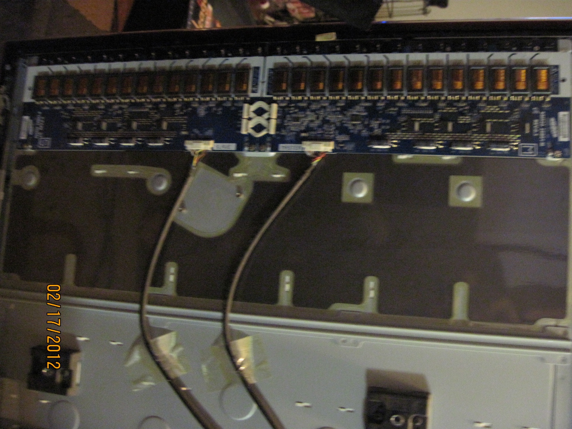

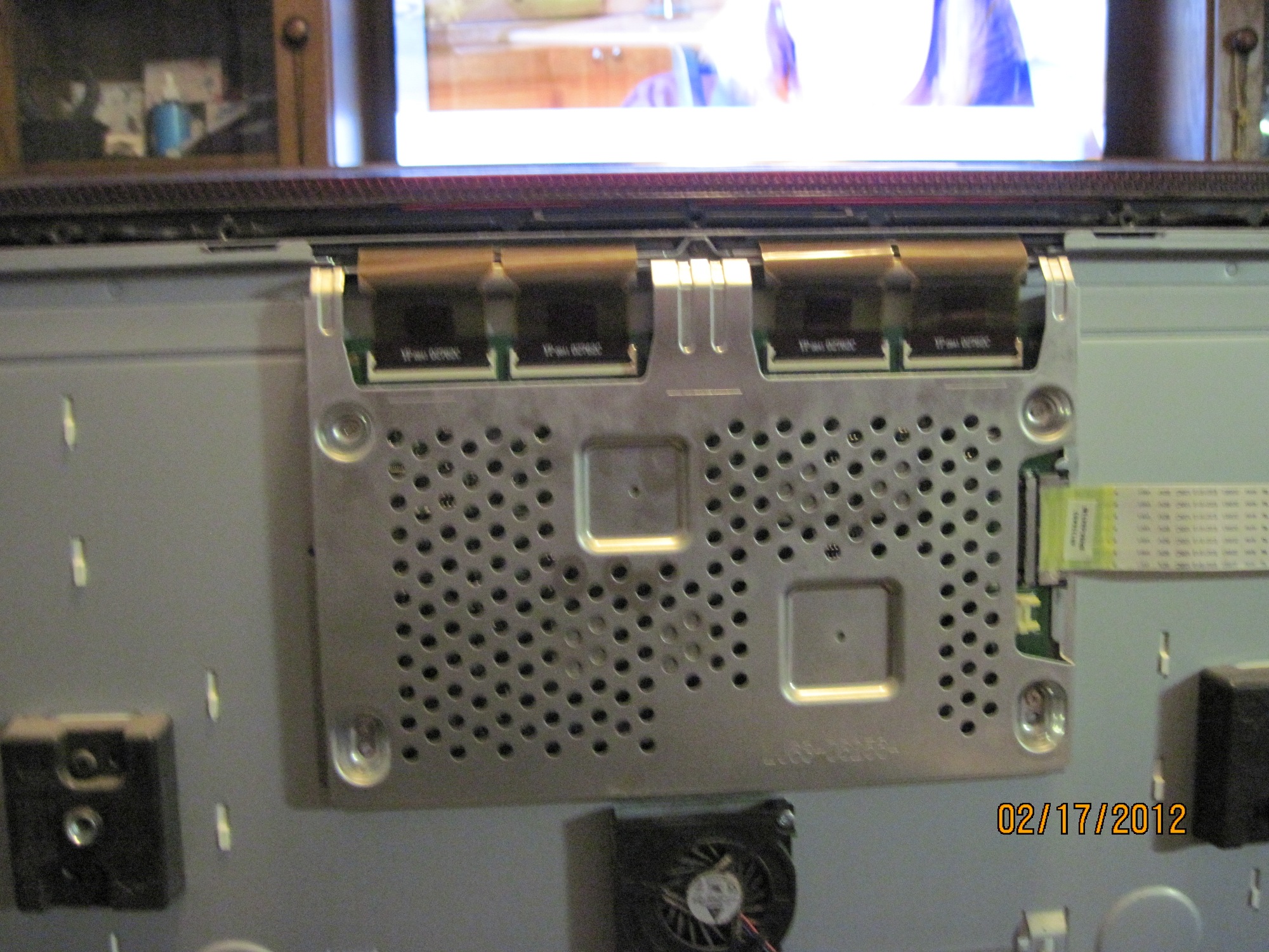

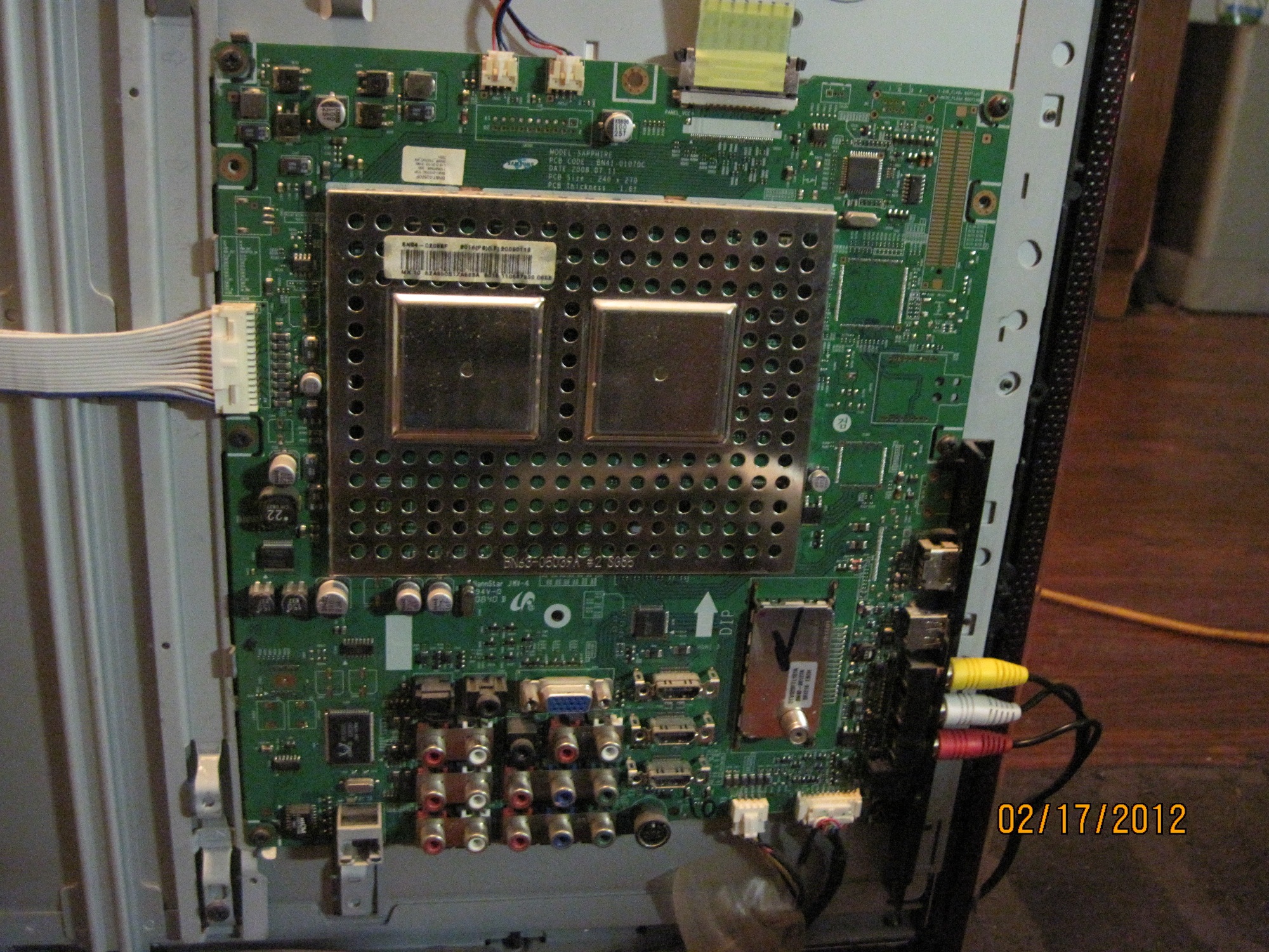

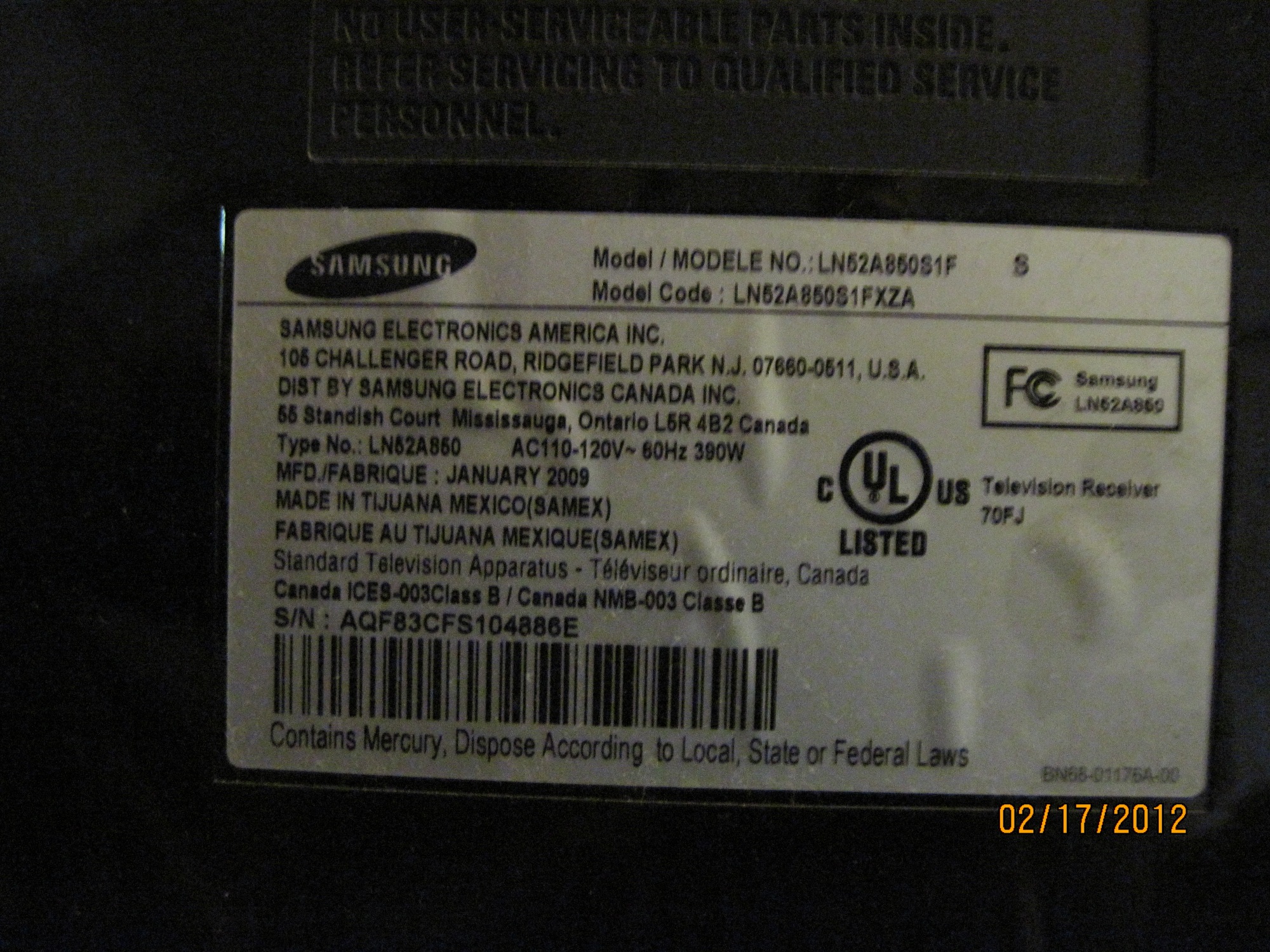

    All the help here been great I have a 52” Samsung touch of color, the problem is a line down middle of screen.
    After 5-10 minutes line fade away and won't come back until its off for a while. I'm hoping it's not the panel.
    Here are some pictures of the model and boards. Looking for a starting point maybe the t-con boards?
    Thanks, Tom

    Sadly, it sounds like a panel problem - especially if it fades away. However, it may be repairable, if you are prepared to strip the panel down to the ribbons.

      Re: Samsung 52" line down middle of lcd.
      If there a possibility of fixing it yes I will strip the panel down to the ribbons.
