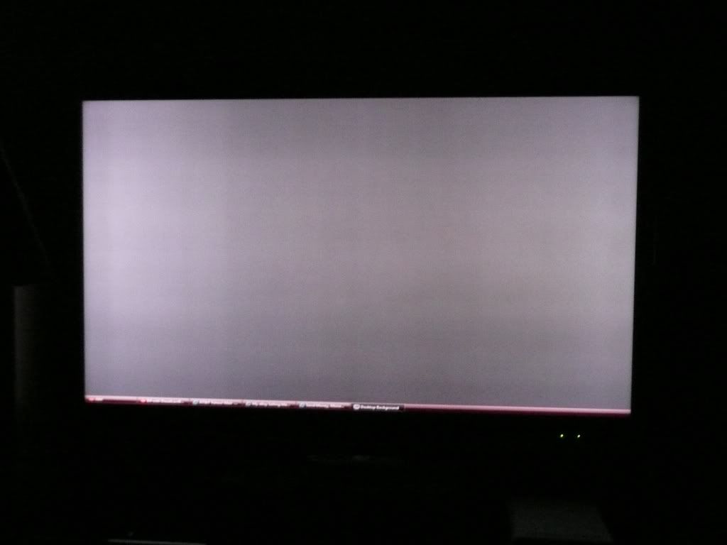

    I know mura isn't usually repairable but I've got a strange one:
    Bought it off these guys for £50 and that included a glass AV stand, the remote control and a manual. So, not bad - the stand alone sells for around £150.
    The black levels have a slight amount of unevenness, the grey is a bit worse, and normal watching is perfectly fine, barely noticeable.
    It's an older LCD but full HD. Motion is a bit blurry here and there - pretty typical for older LCD panels. Colour was set way oversaturated, so I tweaked that and it looks better now.

    Interesting... I'm not sure if it's just me, but I laid down the TV for a couple days and the mura is mostly gone?! There's a tiny bit just about visible if you look at the screen at just the right angle (both horizontal and vertical.) Placebo effect?!

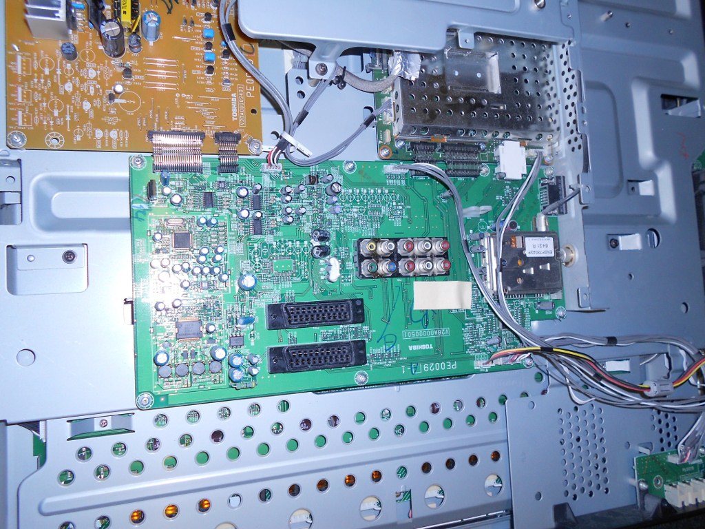

    Anyway, teardown analysis:

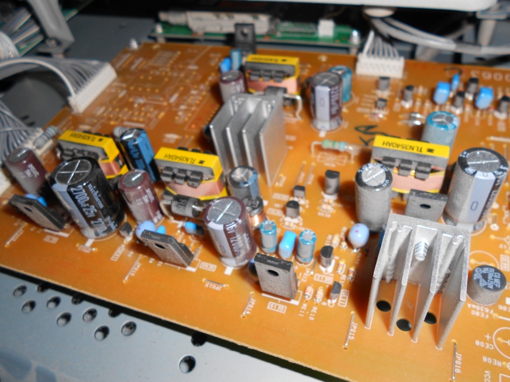

    - Design uses good caps in most places except parts of the secondary DC-DC board, which uses a few Jamicon, but otherwise fine. And Jamicon are probably okay general purpose caps.

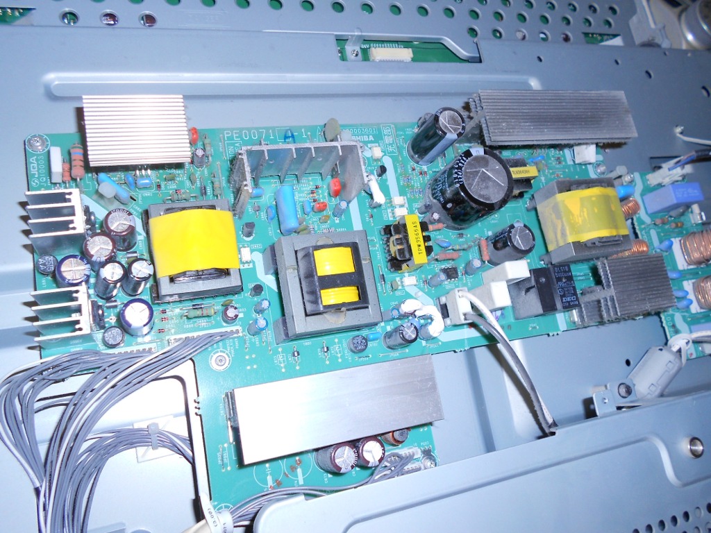

    - Three supplies: One for 24V, one for main voltages and one for standby. Huge primary capacitance of 270uF.
    - Use of a hybrid module for the 24V instead of discrete devices. Repair will be difficult if this part fails.
    - Main board has some crappy caps on it and a bodge or two in places.

        Re: Toshiba 42WLT66 - Mura on screen
        Originally posted by Scenic
        What do you mean with "mura"?
        Moiré (the wavy stuff like here and here) ?!
        This is a bad case of mura: http://guide2lcdtv.com/wp-content/up...ngsharpsv7.jpg
        Mine was worse than that and it was more dark than lighter patches.
        This a good case of mura (pretty typical for most budget LCDs): http://i30.photobucket.com/albums/c3...14/mura002.jpg
        Some info on the problem regarding Sony (who manufacture LCD panels with Samsung): http://www.hdtvtest.co.uk/news/sony-...2007033142.htm
        Mura: Japanese for unevenness.
        A lot of people on forums suggest loosening case screws may fix the problem... well I did disassemble it and reassemble it... which may have been the fix. That's lucky , I didn't even think about that being a fix.
