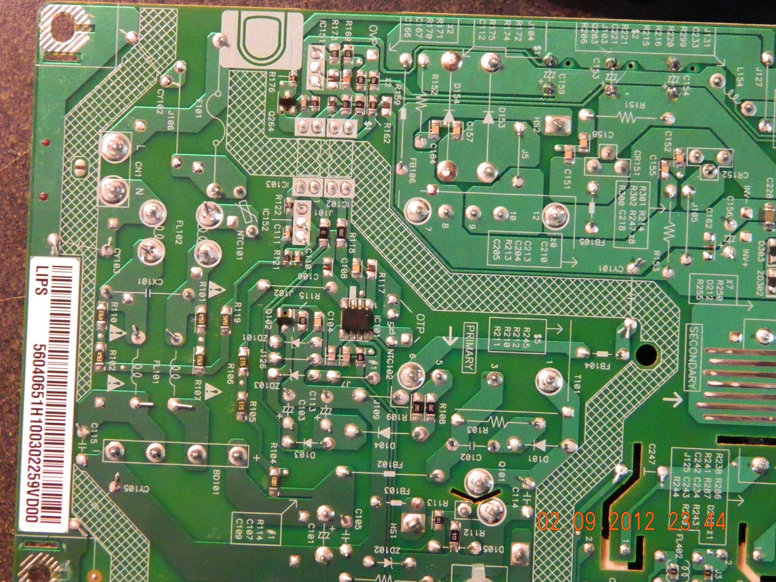

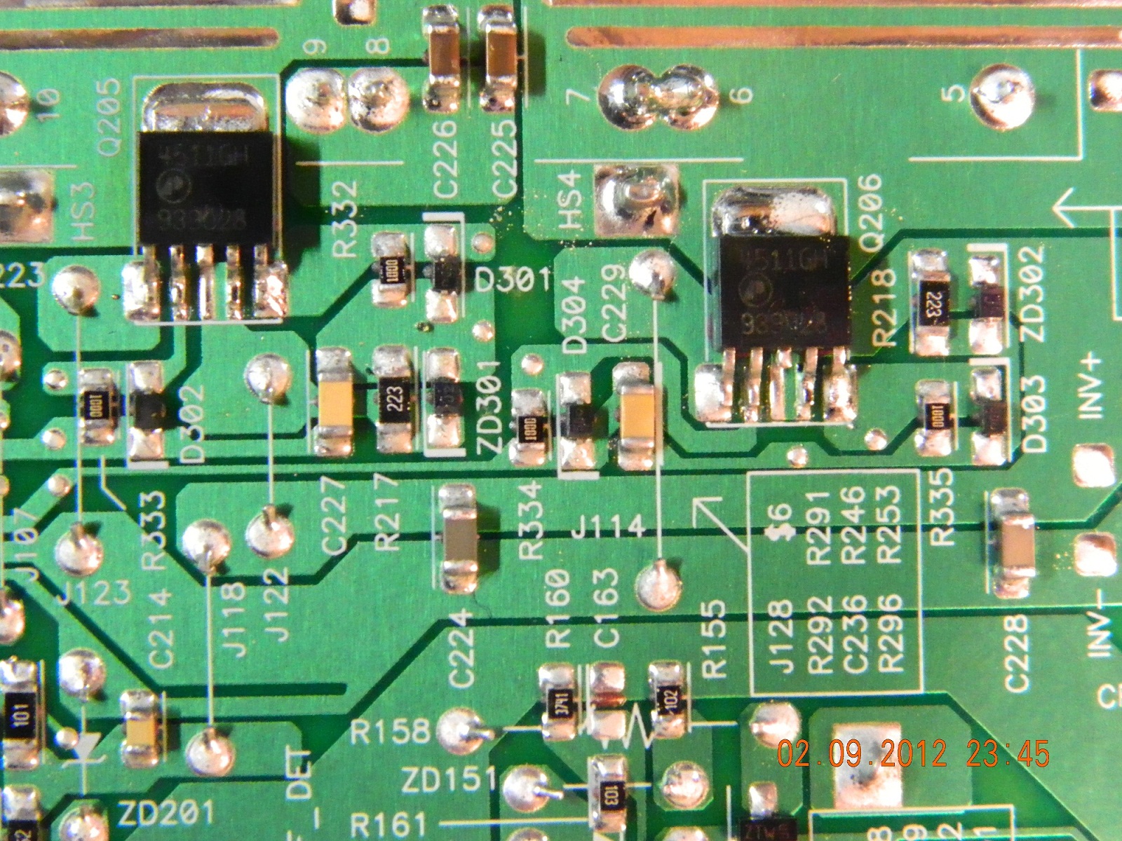

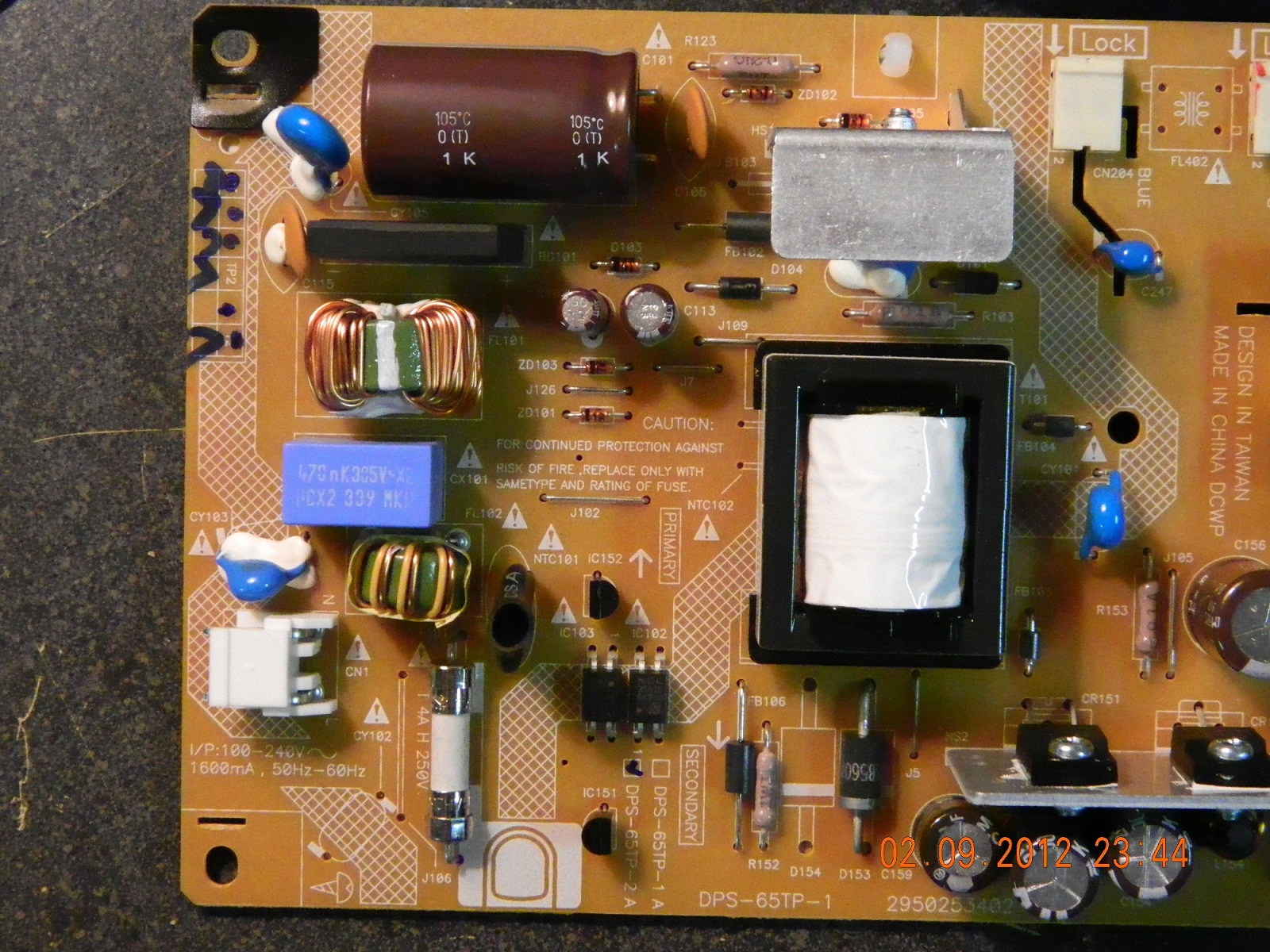

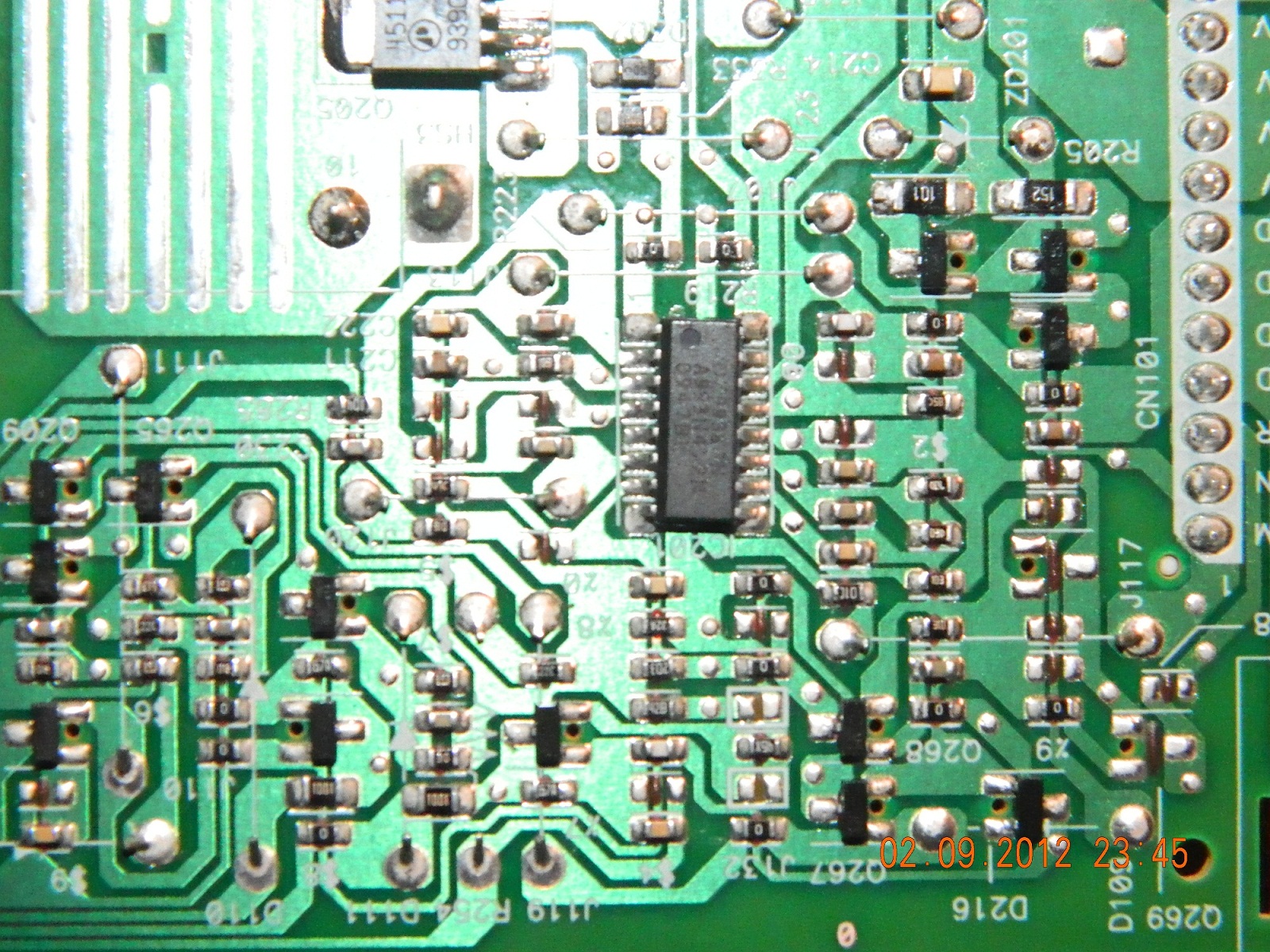

My 22" Dynex LCD TV has the famous 2 seconds to black problem. When the tv is plugged in and powered on, one pair of lamps light briefly. The other pair of lamps get just a little glow to them. After a few seconds, it repeats this and then nothing until it is powered off/on again.
I have tried swapping the lamps and tried a second set of known good working ccfls in both positions and get the same result. So the problem lies only on one side of the inverter circuit but not the other. (The lamps closest to the outside edge are the ones with the problem)

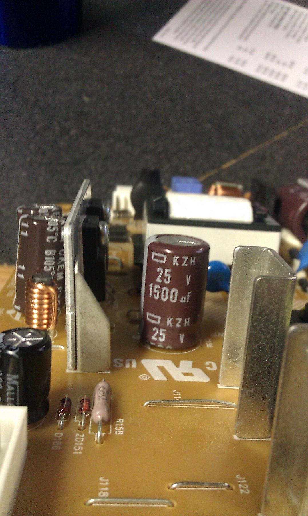

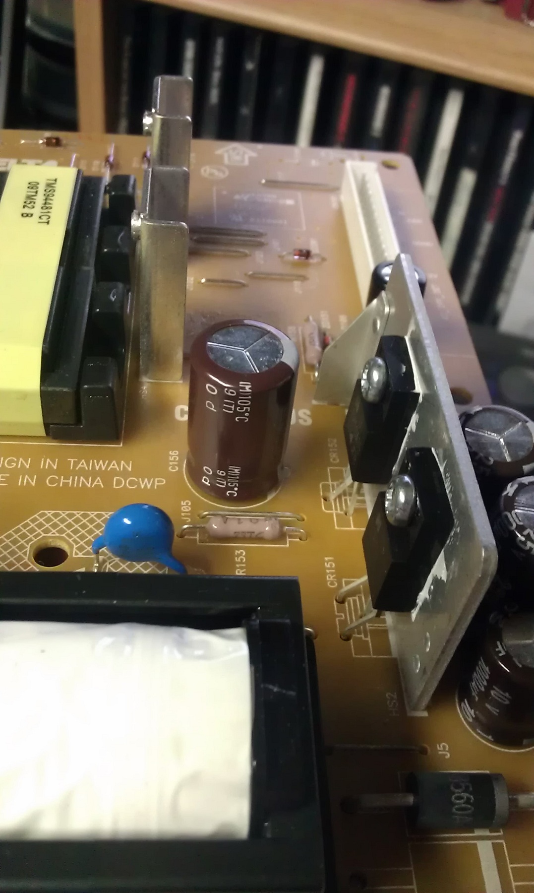

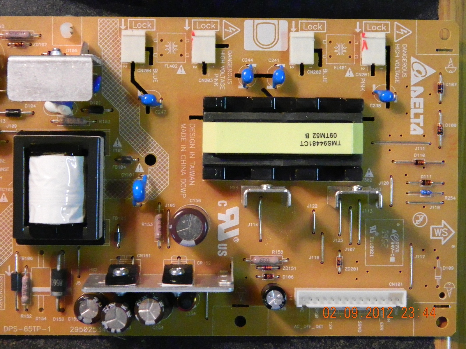

I have replaced most of the caps on the secondary side of the board with the exception of C156 (I just dont have one to replace it with at the moment). I have tested C156 with an ESR meter and the reading is about .03 and it is a 1500uf 25v cap. I dont know the brand, there is just a K printed on the side along with the rating.

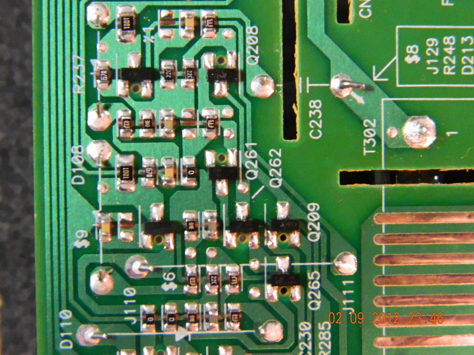

I have also checked the voltages on Q205 and Q206 and they have identical readings.

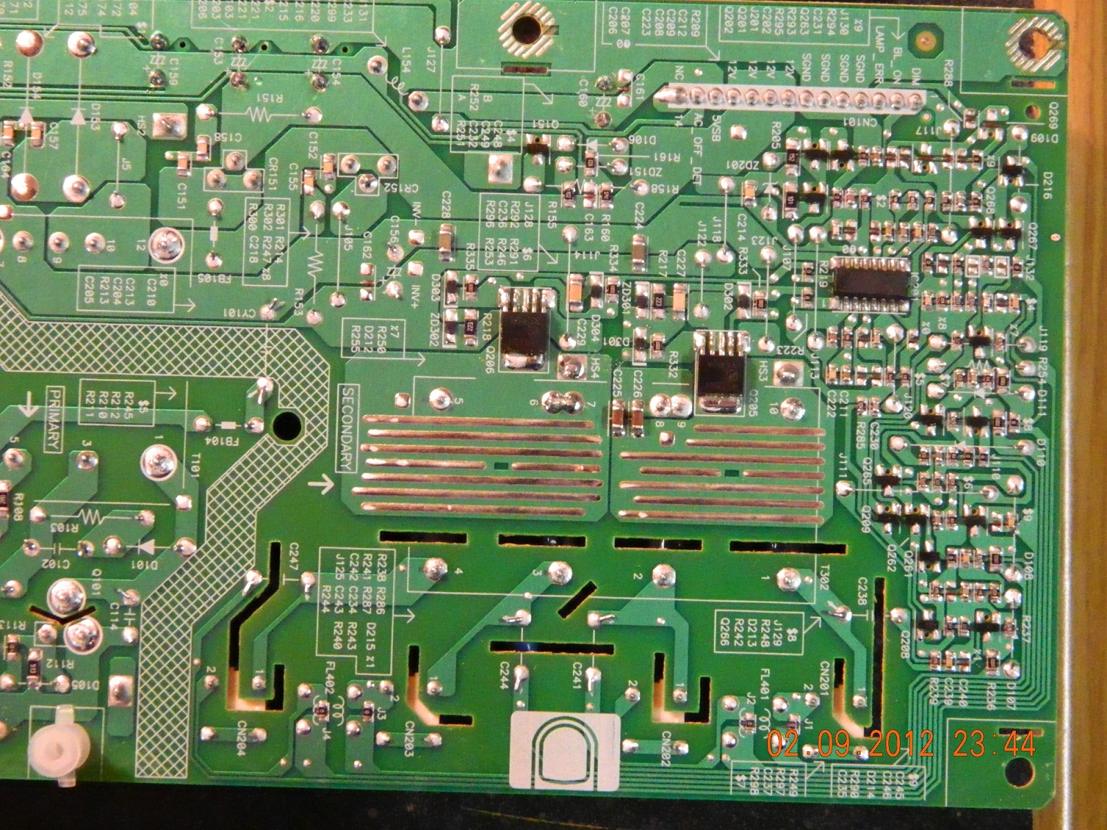

The transformer measures .2ohms on the primary and both secondaries measure around 963ohms.
Can somebody help point me in the right direction please?
Thank you.

Now it is measuring higher on the one secondary.
