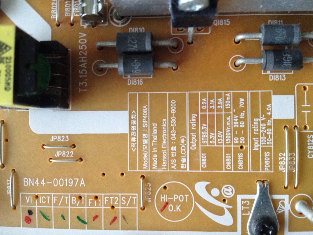

    As many of you, I started having issues with my Samsung LCD 40".
    The TV set has been working fine for the past 2 years, but since I came back from abroad after 15 days off, I am not able to turn it on anymore.
    Upon pressing the on/off switch, the TV makes the clicking noise and the intro song, the screen kinda turns on (but is still black) and no image appears. The on/off led then starts blinking at a rate of 5 blinks/sec and the sound works fine. http://youtu.be/mtYxzxAXroE
    I tried to open the TV set to check for popped resistors but apparently everything was fine; anyways, I replaced all (but the small one) capacitors shown in the picture with new ones, to no avail.
    Is there something else I can do to bring this TV from the dead? I'm in Australia and Samsung will not fix it because it's an overseas model.
    If you guys have any ideas I would really appreciate.

    Re: SAMSUNG LCD 40" does not turn on
    Forgot the pictures, there it goes...
      You might need to do an EEPROM reset. Post a picture of the main board.

            Yeah, the main board has the inputs. You might need to remove the metal shield if it has one.
            You do not need to upgrade the firmware. Resetting the EEPROM is done by connecting two pins with your screwdriver while trying to turn the TV on; this causes the TV to re-program the EEPROM from scratch. You will lose any settings you have changed - it will go back to the default factory configuration. When the caps go bad, sometimes it corrupts the EEPROM.

                  The SDA/SCL pins. There are many chips on the board and one of them starts with "24C" which indicates an EEPROM.
                  http://www.tv.quuq.org/forum/index.p...e;topic=1744.0
                  According to that source it's near the common interface slot. Look for IC 1803 (24C256). Pin 5/6 should be shorted while relay is clicking. Then unplug TV and plug it in again. On the remote press info, menu, mute, one after another, go to Factory Reset on the menu and you should be back to a TV that behaves new out of the box, you will need to retune it and tweak it as desired of course.
                              Guys,
                              Just wanted to thank you all for the tips. The TV is working again.
                              All I did was to reseat all cables and leads, and once I plugged it in it was all good!
