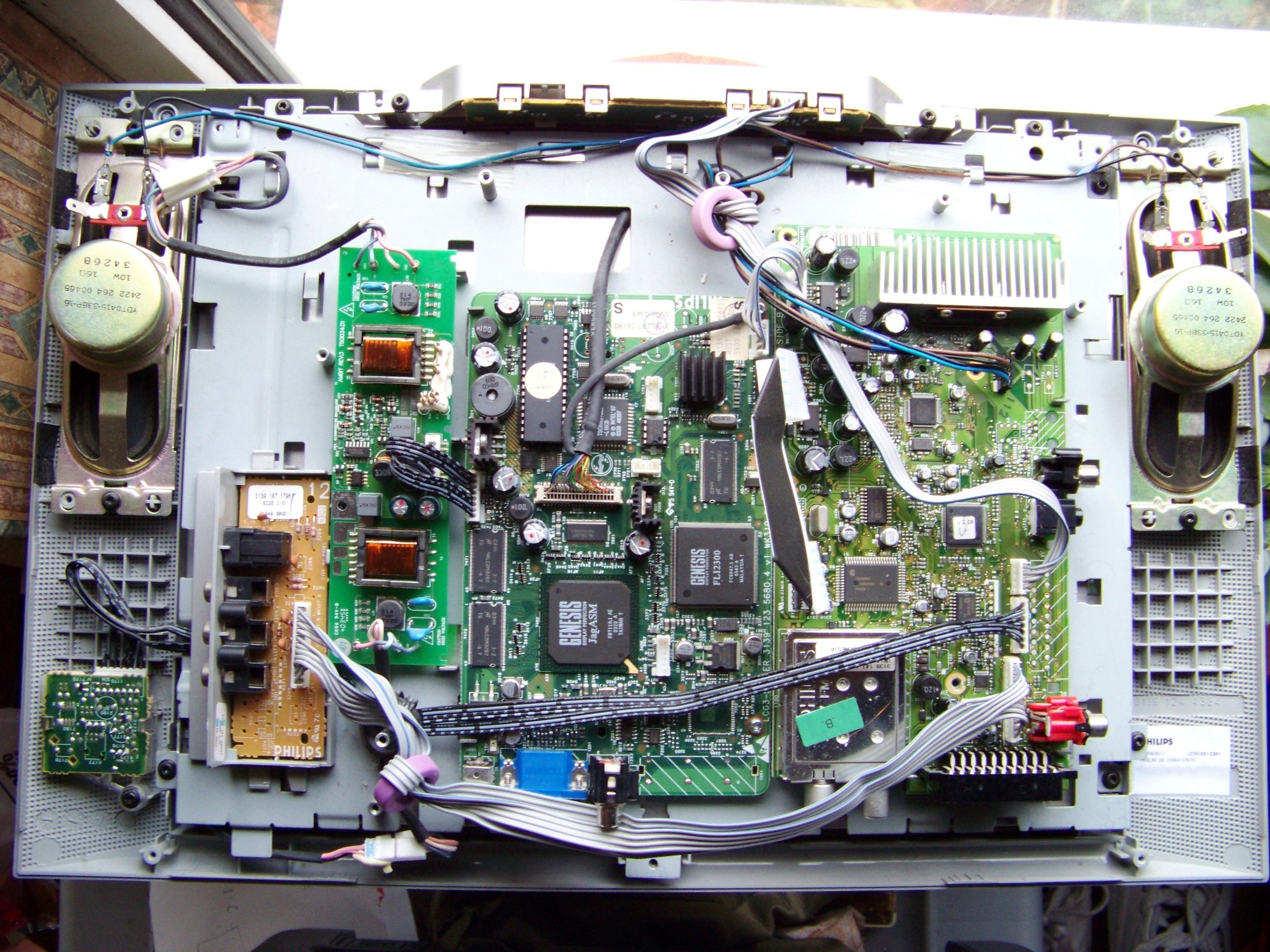

    I recently bought a small philips lcd tv for 99p described as "the tv light does show on the television however doesnt seem to turn on" I hoped it would be simple recap job as I only have a very basic multimeter and soldering iron but being retired - time.
    Imagine my disappointment when I opened it up to find it stuffed with Rubycon Caps. No bulging or discolouration and no burn marks anywhere. There was even very little dust and the only visible "problem" I could see was that some of the insulation was cracking off one of the wires in the connector cable from the main board to the panel (at the main board end).

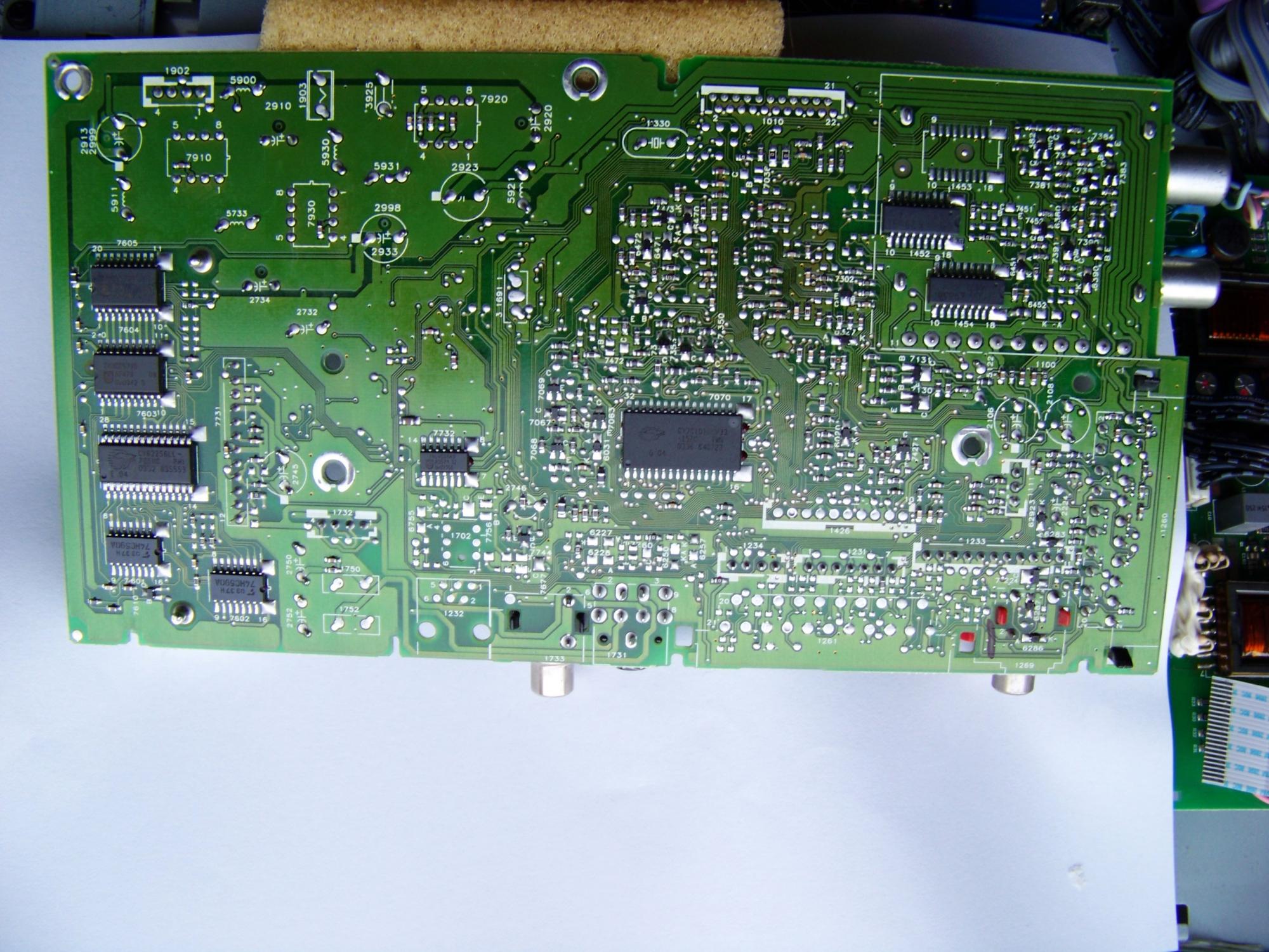

    No clicks or hum from speakers(that I could hear). Pressing Volume+ on remote causes red light to flash. Listening to it later I found that there is a "tick" in the region of 7910 34063AP1. I have not been able to pin it down to a particular component. It ticks nine times when the green light is on then stops.

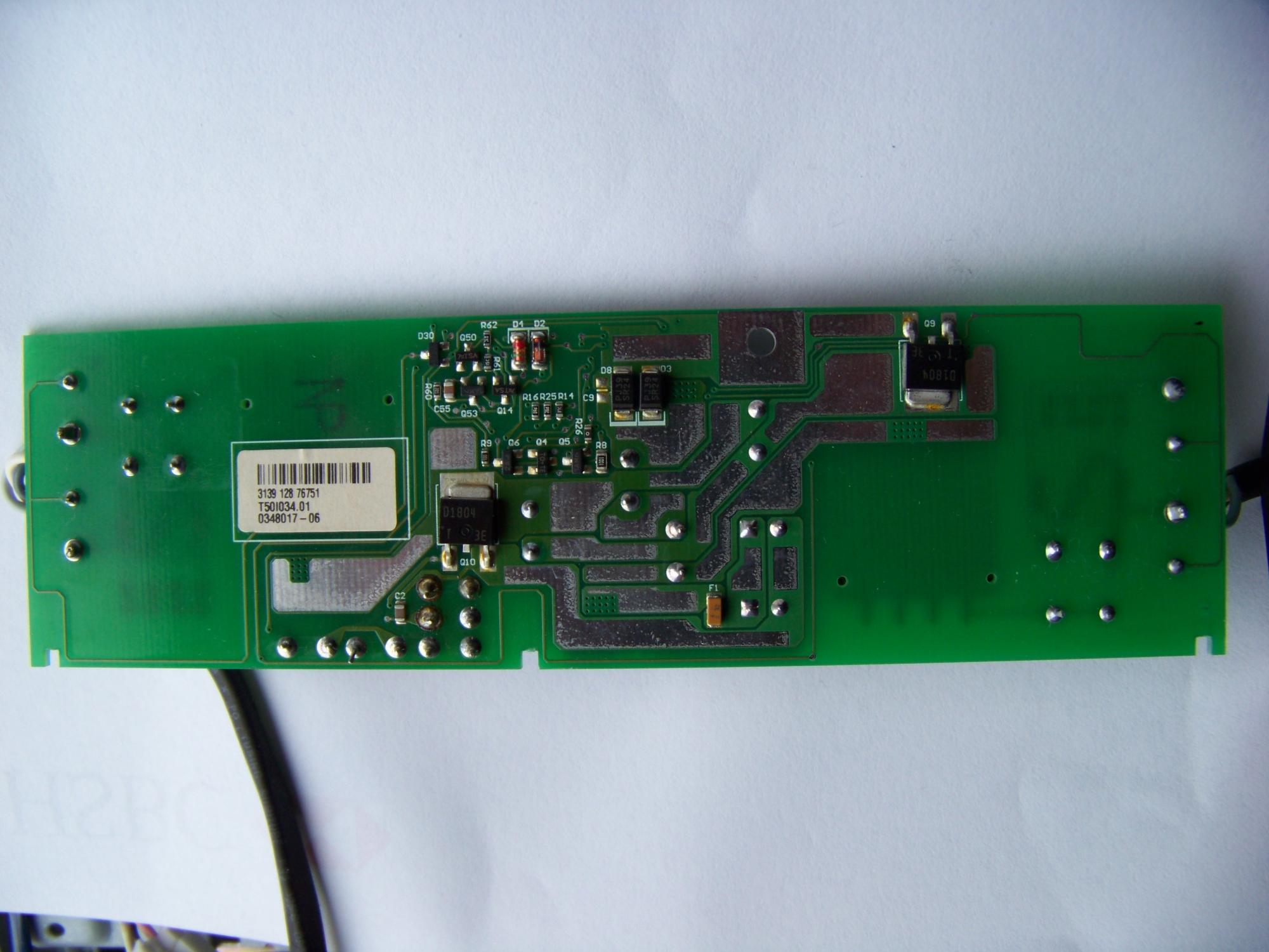

    Only 2 fuses and one on the inverter board all ok.

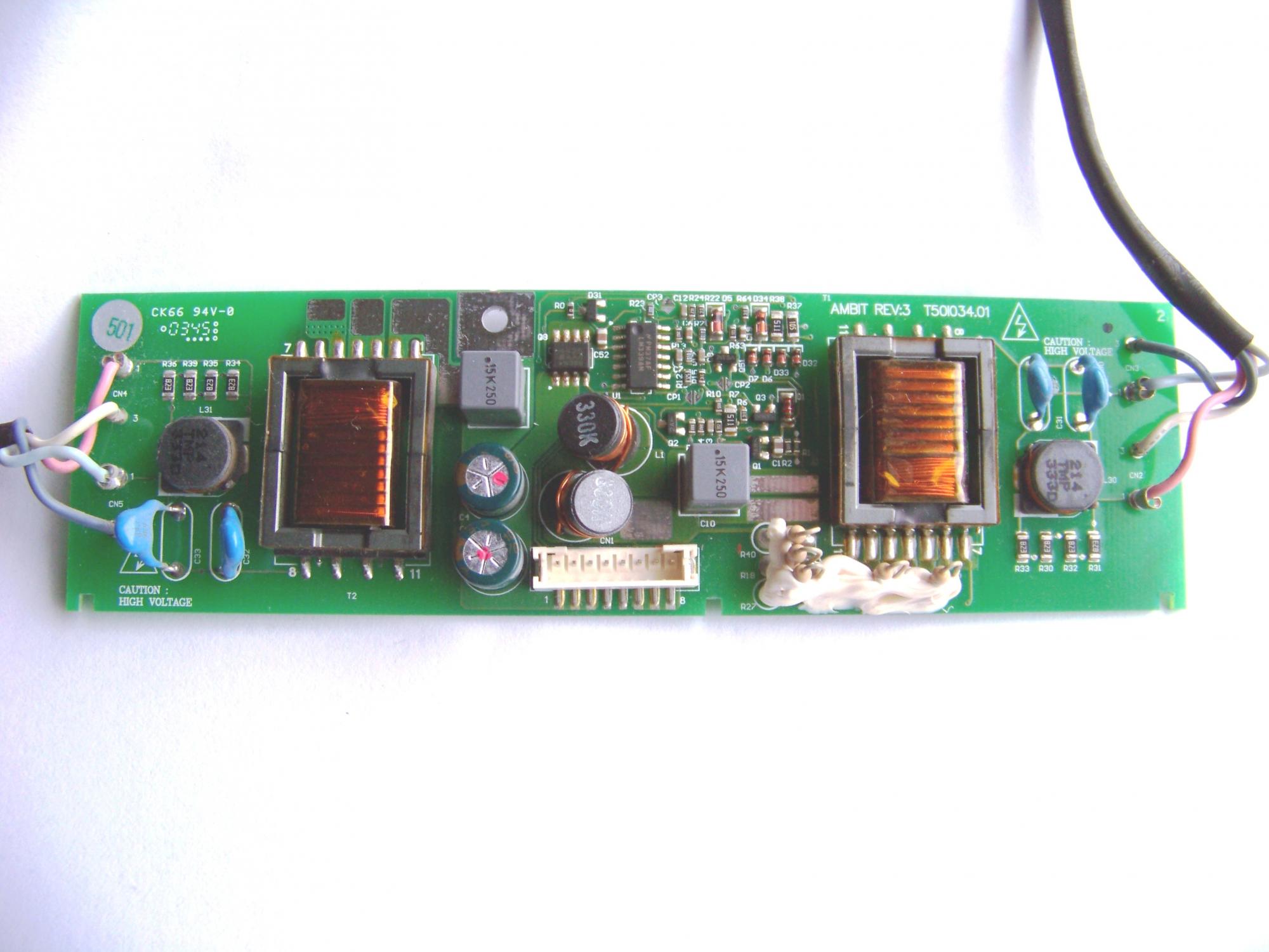

    Aha! Whilst I initially thought (oh dear) ALL the caps were rubycon the two 25v220 s on the inverter are Teapo. As these are/were not highly regarded I dashed out bought and fitted 2 Rubycons thinking great this will fix it. Alas it did not - same problems persist.

    Have tested each ccfl using an old laptop inverter all lit well, only a short test but enough to know they work.
    Just preparing this and getting the pictures together and decided to google the inverter board as I was only getting 12v and had recently read that LCD Tv inverters need 24v.

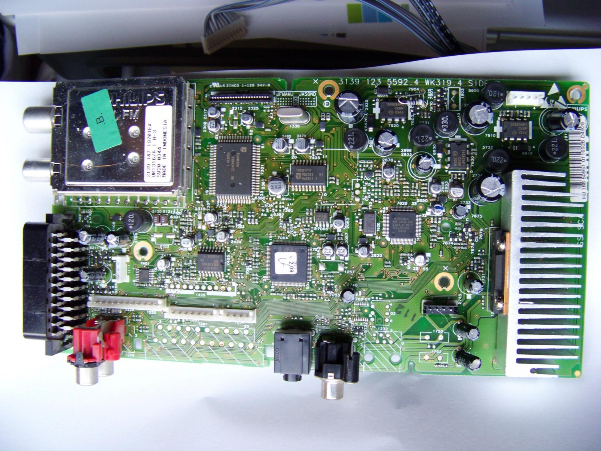

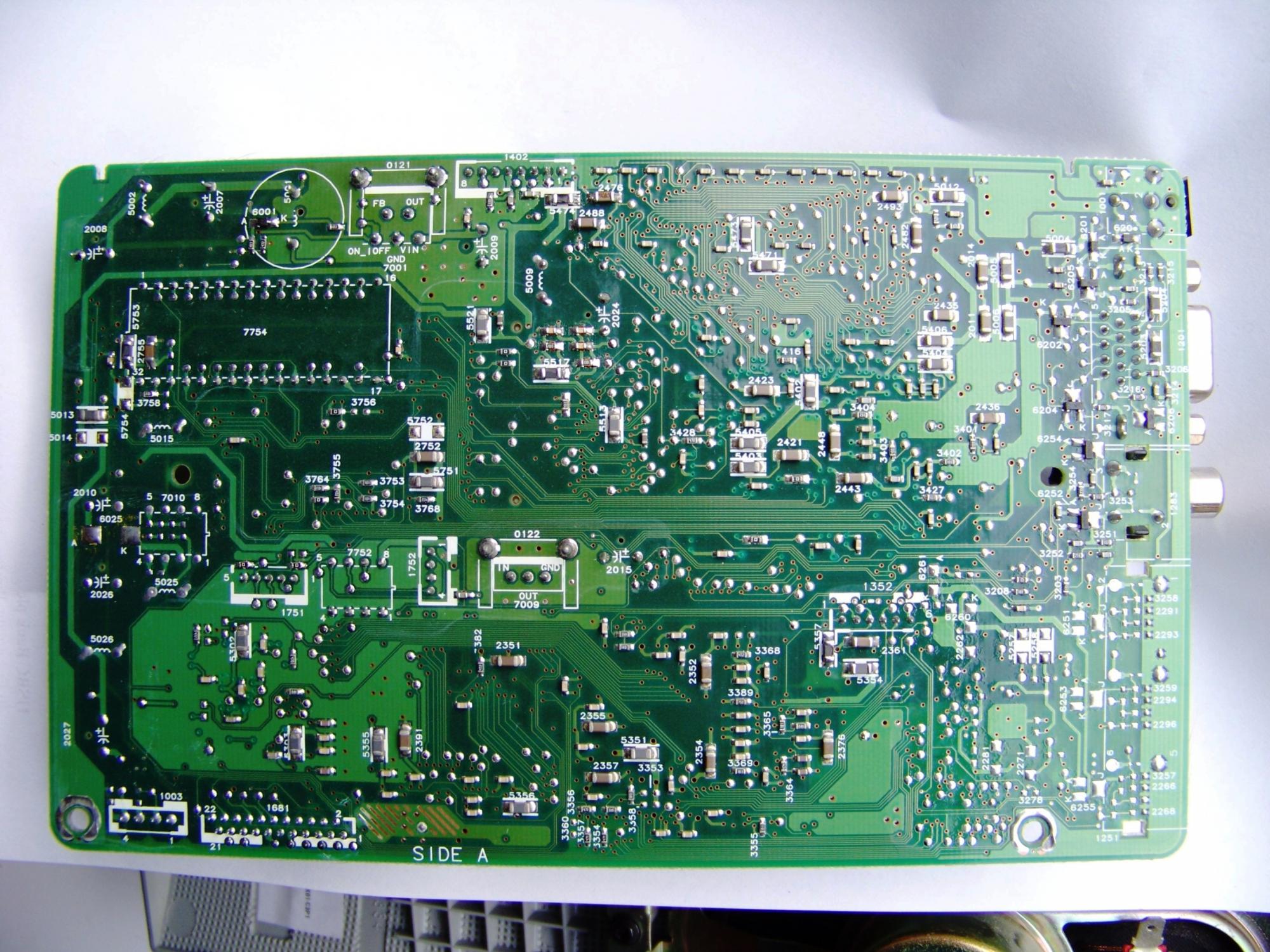

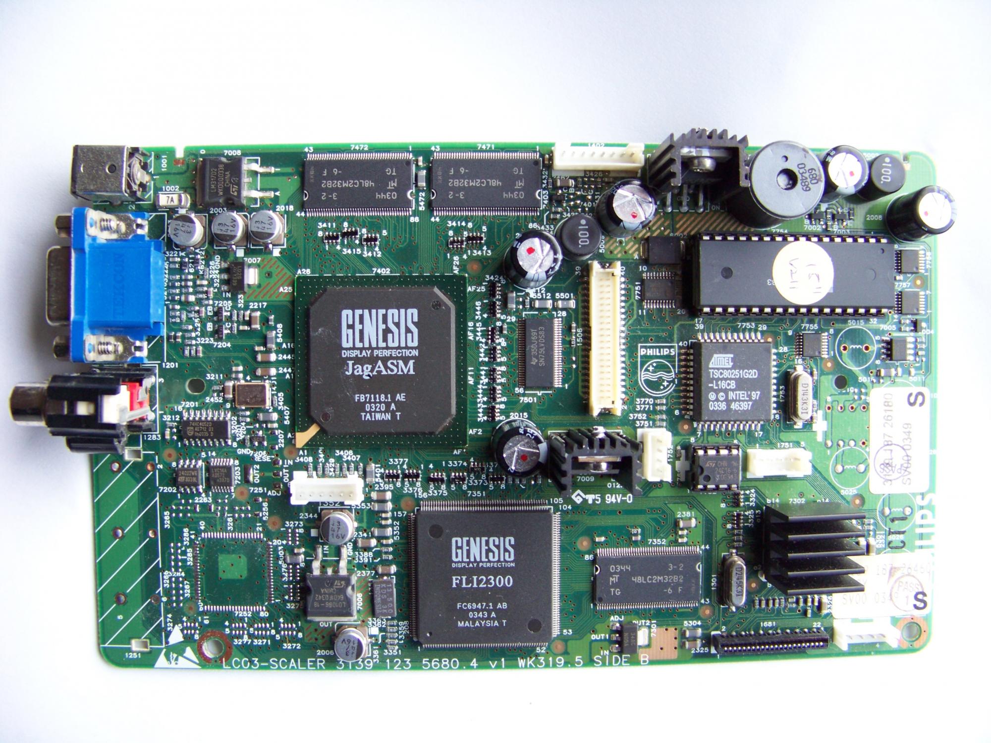

    I now know that some smaller tvs (including this one) are 12v. Anyway one site which came up had someone with the 17 inch version f his tv with the same symptoms as mine and they appear to have fixed it replacing some of the 25v 470 caps on the main board, so now I am going to try that, even though they are Rubycons!

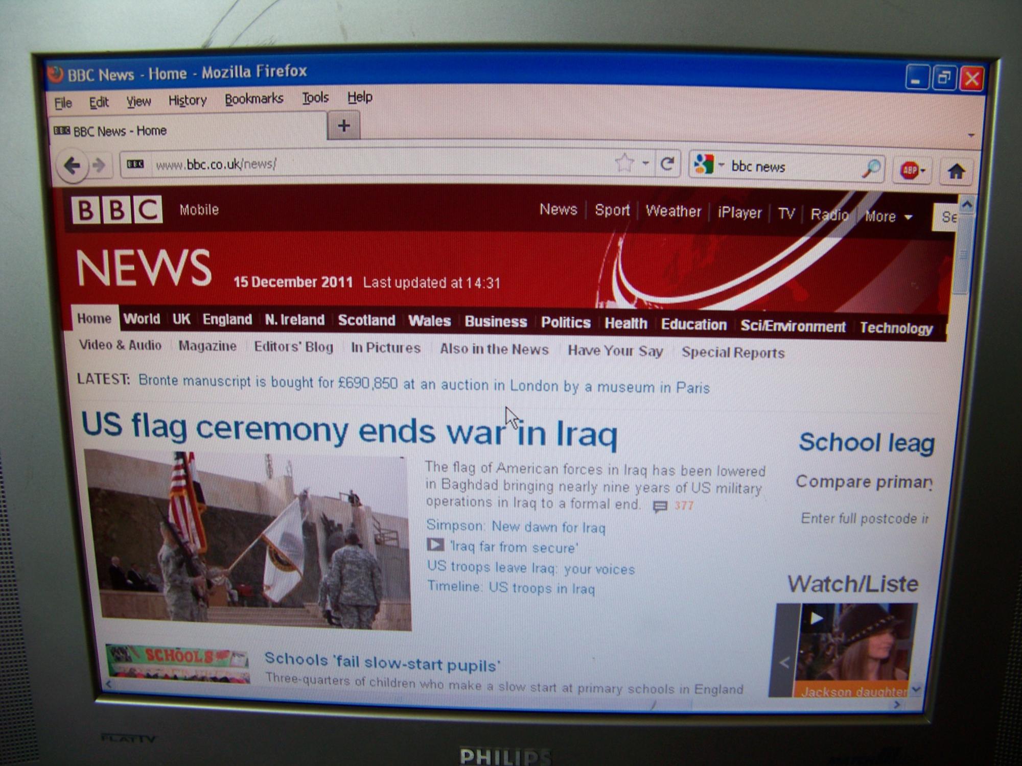

    Hurrah! partial success - fitted new caps to the main board( justleft them on long legs in case it never gets fixed) and voila - the back lights came on. Checked and rechecked the vga cable to the laptop source then decided to press on with replacing the caps on the Tuner board.
    When I took it off I spotted that I had not re connected the cable to the panel - while I was plugging and unplugging the panel to see what happened having read "Acer V193W No display/Light, odd ticking from boards..."post by InixPc.
    Plugged it in -put the Tuner Board back reconnected everything switched on and my windows desktop is there. Even got sound when I eventually spotted Audio in and Audio in (Pc) are not interchangable.

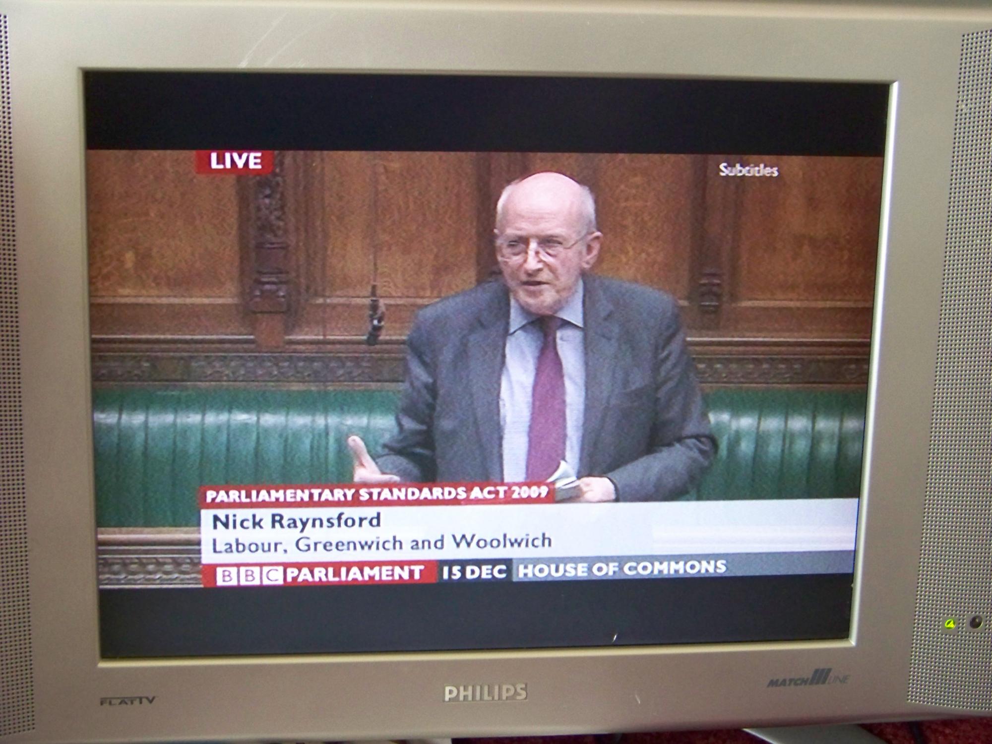

    Great ran upstairs with it to test with DVD and Digital STB and..... failed ! picture is green!!! I know that this is sometimes down to the scart cable but this was separate inputs with separate cables. I am now googling like mad and will retry tomorrow -on the table -not wobbling about on the bed.
    Still green - tried scart, video in, s-video- still green but as a pc monitor it is spot on.
    Changed the 25v470 caps and tried again - still green.
    Changed a 16v 1000 and 16v470 and its gone back to black and ticking - wished Id quit whilst ahead - who needs tv. Going to back track 1 cap at a time. Done a few but no luck.
    Its been a bit chilly here so having read somewhere cold caps = high esr thought Id give it a blast with a hot air gun. Hah, it came on and more importantly, in my mind, wouldnt come back on when cooled. I now just need to narrow it down a bit - it seems its the tuner board perhaps caps near the TV tuner box. Cant find any that size so its back to the shop.
    Got replacements and fitted them and... its on but the tv section is still green but on PC it works fine???.
    I am now under pressure as its all got to be cleared away for Christmas. Just happened to wonder if there is a separate video chip for the pc and one for the tv- no doubt someone would have spotted this if id put it on the forum. When I press on the larger chip the picture is fine - whoops -if I press almost anywhere on the board it is fine - I guess it must be a cold joint somewhere.
    Cant just see where so I have resorted to putting it back together with a plastic post between the circuit board and the metal cover and some more packing between the metal cover and the set back.Measured it all so its not too much pressure just enough to get it
    working. Will try it again in the morning and post this as some of it may be of help to others.
    Well it works- pictures attached to prove it.
    After the new year I might have another go at getting it to be not green. If anyone has any good ideas on which area I should look in for poor joints which might directly affect the screen colours that would be a help. If the chips need reseating/reballing? that's something I wont be trying. In any case I have another small tv project that I can get started on as well as the hundreds of other things I am leaving till next year.
