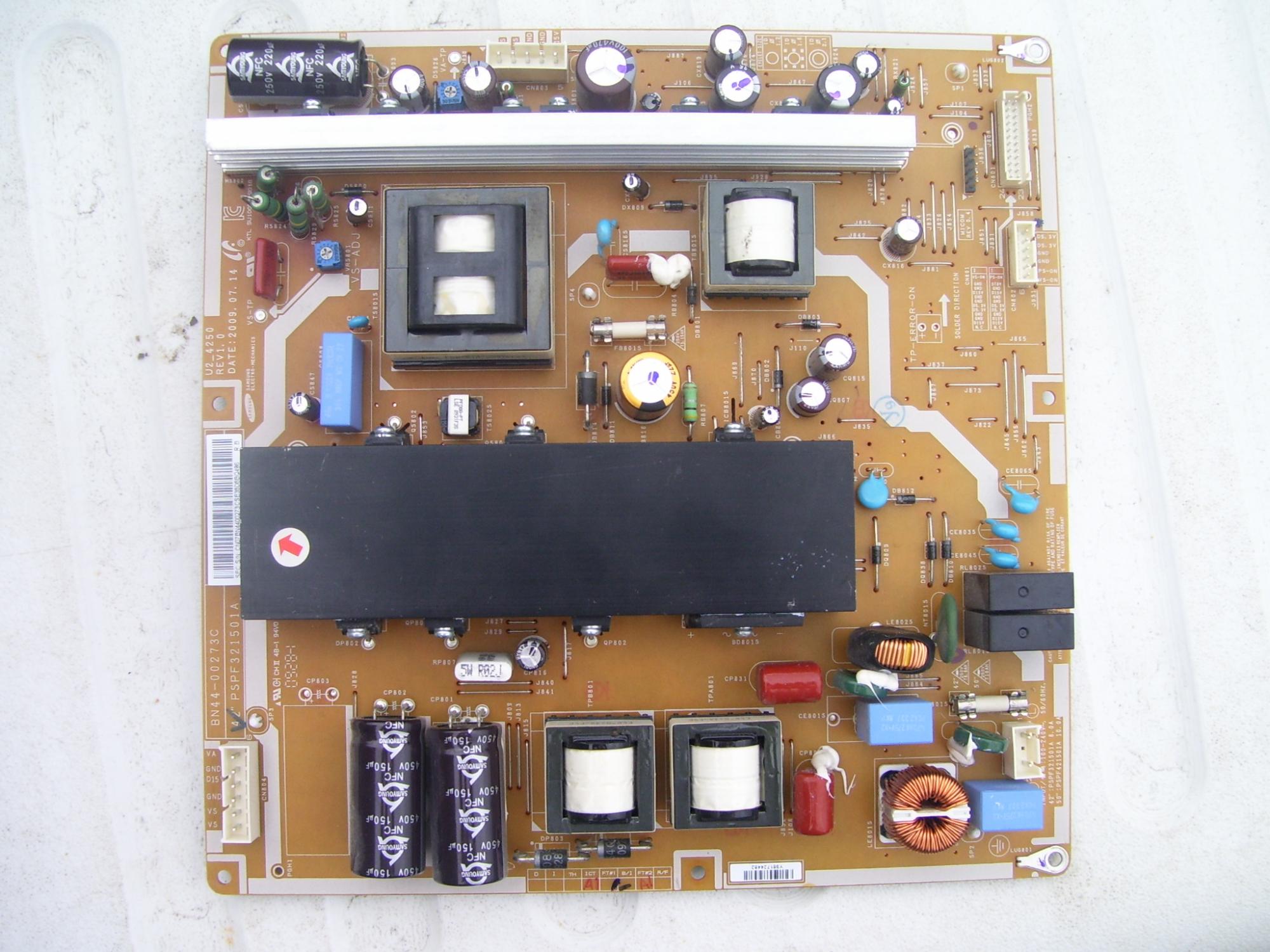

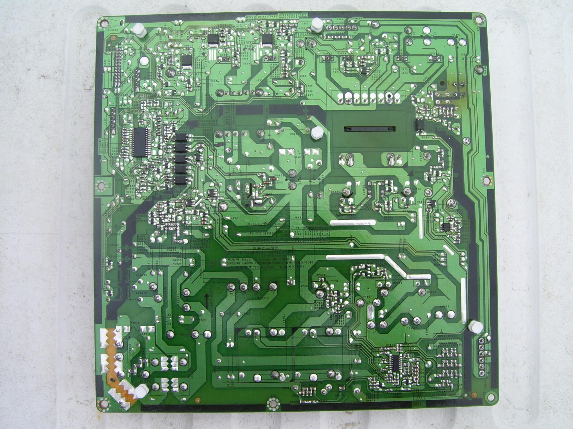

    no power on , just red light flash, and click. notice the browning around the 4 resistors left top on front , right top on back of board they are 100k and read 99. ohm , help!

      1) I can't tell the color code, but please list it.
      2) If you suspect the resistors are bad, desolder them and re-measure them out of circuit to verify. In circuit readings can be deceptive with other surrounding components and if the resistors are in parallel or series.
      3) Do you have a manual or auto ranging multimeter?

        Re: Emerson PL-P42W-10A red light, no sb
        brown
        black
        yellow
        gold
        = 100k ?
        will remove all 4 and test now

            1 reads 99.1
            1 reads 98.7
            1 reads 99.2
            1 reads 99.0
              Originally posted by mcross View Post
              1 reads 99.1
              1 reads 98.7
              1 reads 99.2
              1 reads 99.0
              Wow, if the correct value is 100K Ohms and you are getting 99 Ohms for each reading, that is way off.
              I'm not suggesting you are making a mistake, but we have a lot of new multimeter users in the last 72 hours, what is the scale setting when you are taking these readings? 200? 2000? 20k, 200k?
                200k
                  Those readings are fine.
                  They probably just discharge the high voltage capacitor so it's safe to work on.
                  Have you checked you are getting the right PSU voltages?

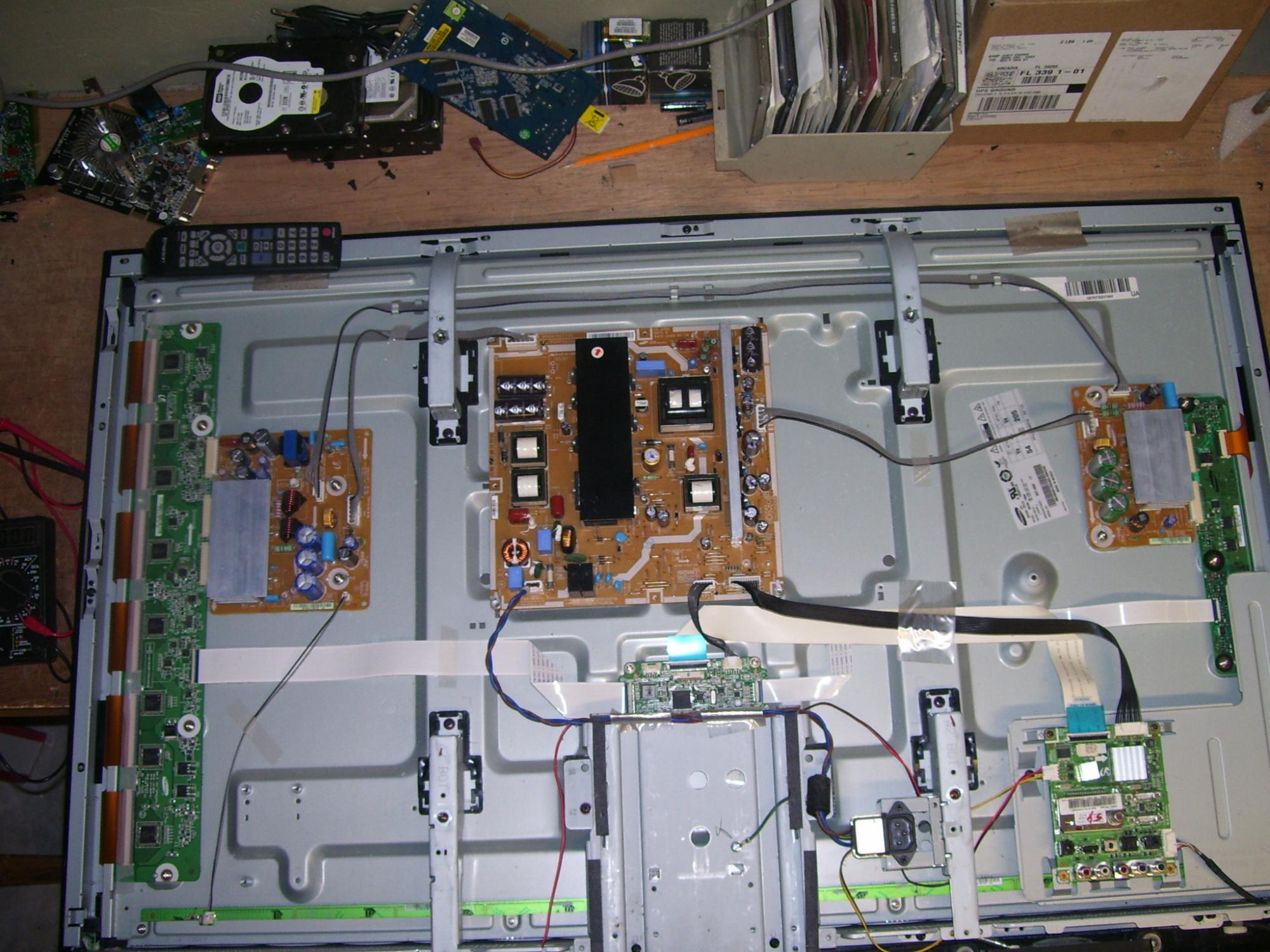

                        I get 15.3 v on both outputs to boards on left and right until it clicks off. also with both disconected , same thing , ps clicks, have the volts 5-8 sec later nothing . pic of whole tv back attached
                          It's essentially a Samsung TV but with the Emerson name on it. Never seen that before. And that must be the smallest main board I've seen yet. Suppose that's why they are budget TVs.
                          You should also measure ~200V on the Vs connector. Do you get this?

                            there are 2 and no i don't get any reading there
                              That is the rule rather than the exception. Samsung builds the plasma panel, which includes the buffers, sustains, and main control board. The TV manufacturer adds the video / input board, speakers, control panel, and the plastic case.

                                I get no vc , but have sb of 5.3v for about 10 sec.
                                  PlainBill
                                  This one is wholly Samsung, though - power supply and main board. Look at the LeadFree logo that you only see on Samsung boards. The remote control also looks the same as one from a Samsung plasma I fixed.
