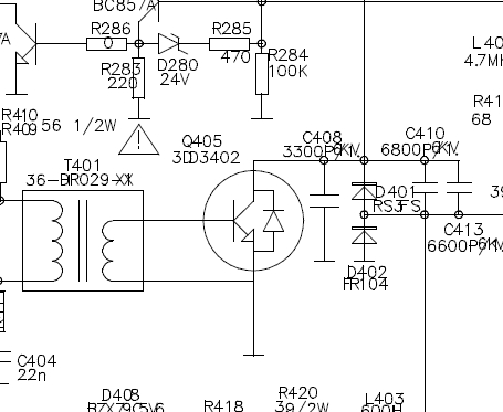

    Pulled the Horizontal output transistor Q405 out of circuit.
    D3402
    701II
    DMM diode test:
    B(+) C(-) .472
    B(-) C(+) .OL
    C(+) E(-) .OL
    C(-) E(+) .493
    B(+) E(-) .044
    B(-) E(+) .044
    Is the HOT good or bad?
    It appears to have a base-emitter short; if so, it's bad. What is the base-emitter resistance?

      Re: RCA 32V434T chassis ATC010A
      in circut b-e will be low due to drive transformer.modern hots also have b-e resistor internal.99.999% of bad hots are e-c short.
      btw lots of bad flybacks in these sets.
          [QUOTE=PlainBill;197410]It appears to have a base-emitter short; if so, it's bad. What is the base-emitter resistance?
          PlainBill[/QUOTE
          H.O.Transistors come in two flavors. This flavor has a low resistance e-b. The only important resistance check is C-E.
          More important, when the H.O.Transistor is removed is the B+ voltage. Does it return to normal? If it does the problem is downstream from the flyback transformer.

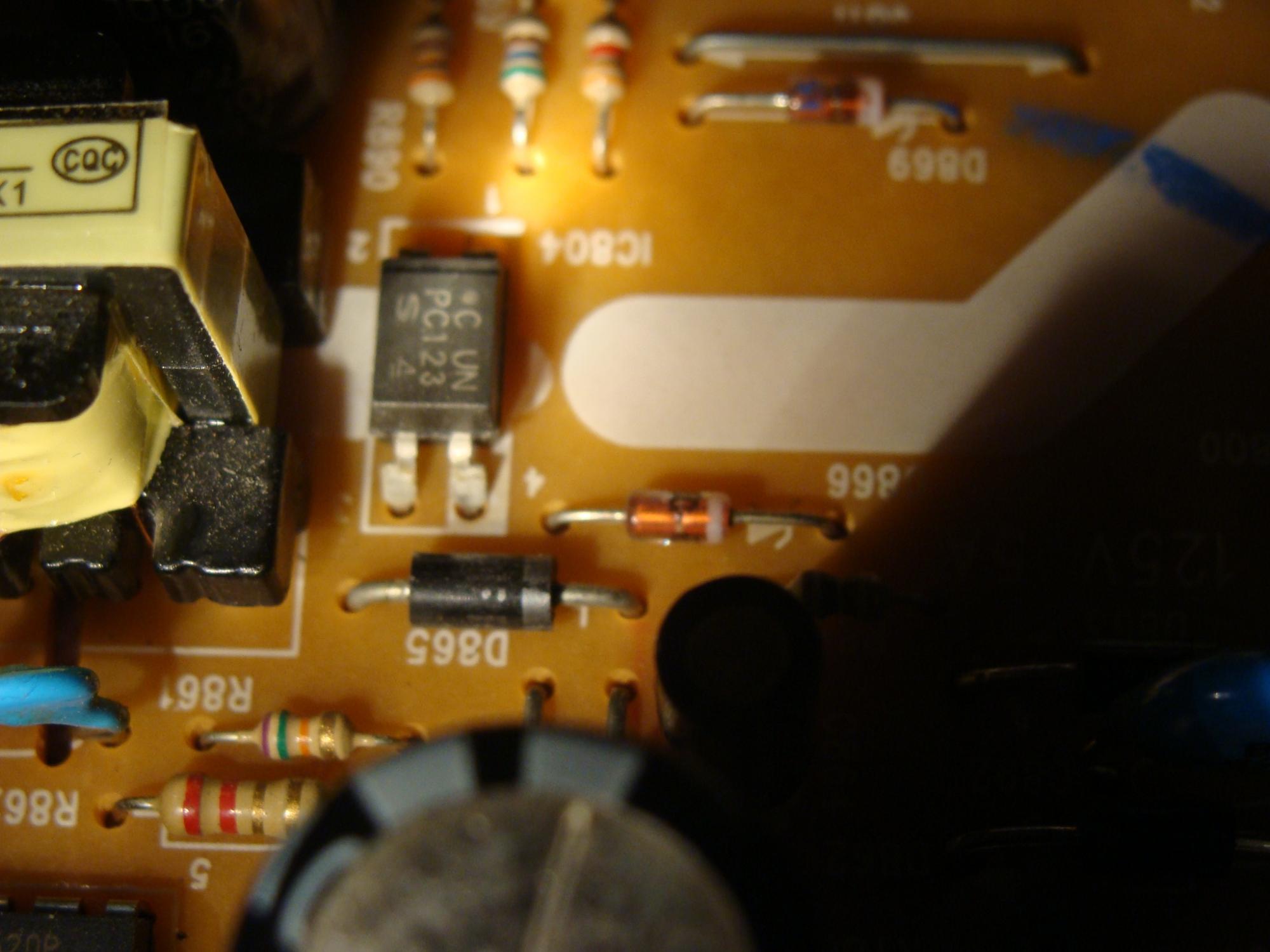

                Back to repair :
                I soldered Q405 back in (I'm still not sure if it's good) and reassembled to test the run power suppy.
                Set didn't turn on, lost 5V standby. Removed IC804 for testing.
                LED test fine but, the phototransistor is shorted.
                Would this one be a good replacement?
                http://search.digikey.com/us/en/prod...17-5-ND/457901
                  Originally posted by cmj21973
                  Back to repair :
                  I can't judge the dimensions, but electrically it looks like a match.

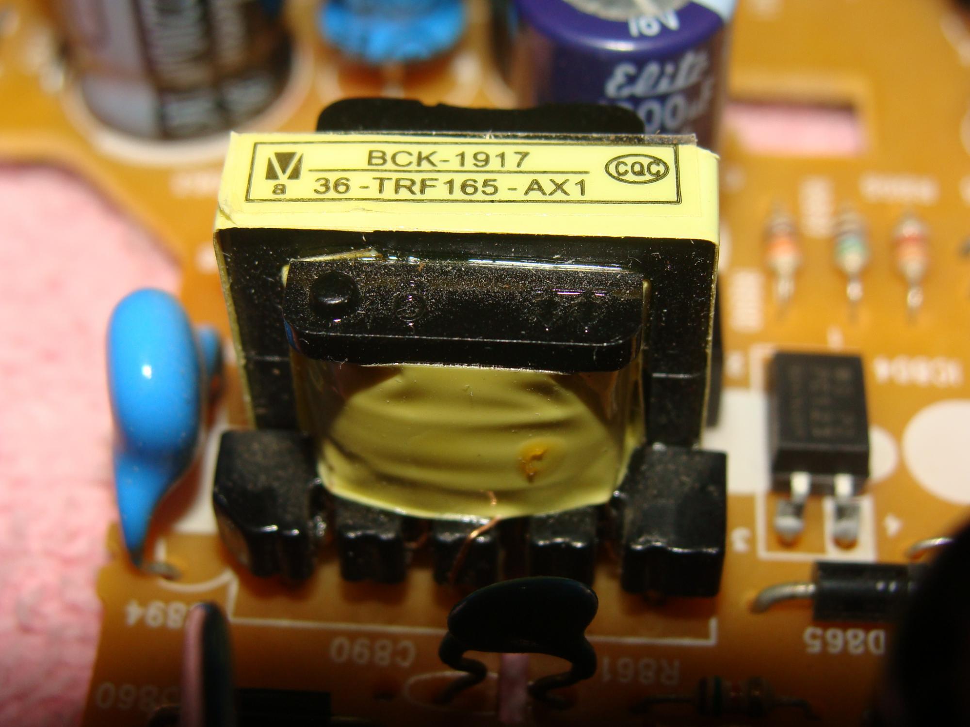

                          Replaced IC804
                          Applied power: no click from relay K802, no 5V STB
                          Following the guide on page 22 of RCA ATC010 Training Manual.pdf
                          1) IC860 pin(8) DC voltage 160.7
                          2) IC860 pin(1) DC voltage 9.54
                          4) IC860 pin(4) DC voltage 0.66
                          Since I've already replaced IC804, guess I have a problem with the feedback circuit off the 5V STB supply.
                          Since I don't have 5V STB on the Control Board (front panel buttons), I pulled T860 for testing.
                          Blue Ring tester: DMM Ohm's set to 200
                          pins 1&2 two steady red lights 00.8
                          pins 3&5 three steady green lights 2.9
                          pins 6&10 no lights at all 00.6
                          • cmj21973
                            • 267
                            #33
                            Well, tried to order mfg. p#274219 (T860) only to be informed that it's no longer available.
                            Guess I'm going to learn how to rewind a transfomer.
                            • cmj21973
                              • 267
                              #34
                              The "E" ferrite cores broke.
                              I'm guessing that if I super glue them back together, that they will still be useless to use.
                              End of tv set repair, if I can't order them with reasonable shipping price.

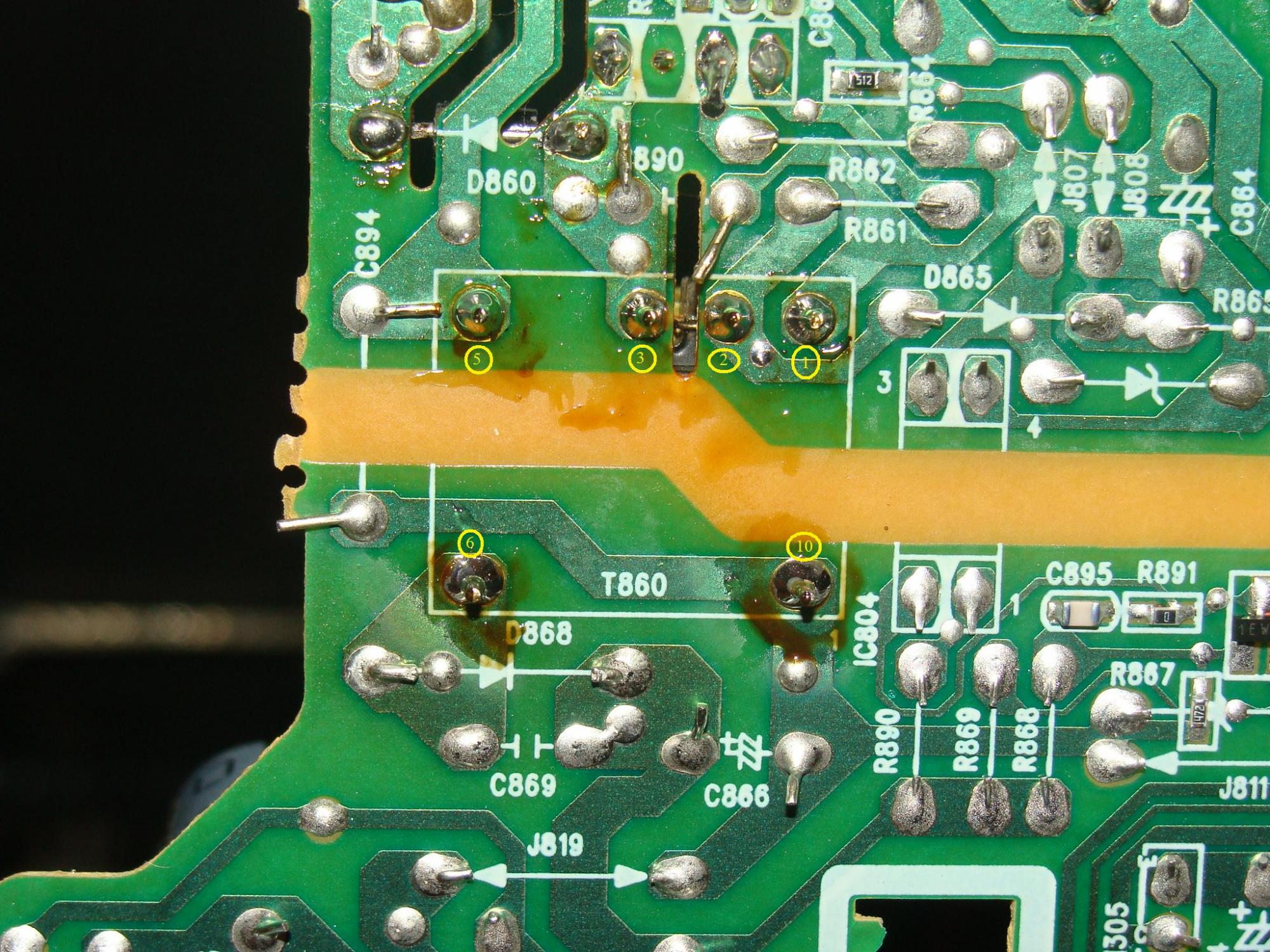

                                  Okay, I've finished rebuilding T860.
                                  Before: After:
                                  pins 1&2 two steady red lights; 00.8 pins 1&2 three steady green lights; 00.7
                                  pins 3&5 three steady green lights; 2.9 pins 3&5 three steady green lights; 2.5
                                  pins 6&10 no lights at all; 00.6 pins 6&10 one red steadylight; 00.6
                                  Next step is to test it out of circuit, to measure the secondary voltage ouputs.
                                  • cmj21973
                                    • 267
                                    #37
                                    I soldered the rebuilt T860 back in placed. Was only getting about 76VDC on pins 5&3 (primary coil).
                                    Found the negative solder pad for C861 had popped loose. Made a new pad, to bridge the solder traces, and solder it in place.
                                    5V STBY power restored.
