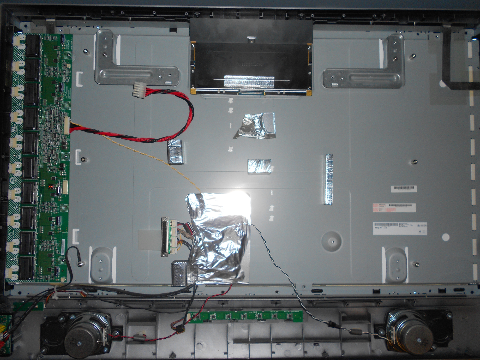

      I've pretty much torn the LCDTV apart right to the panel for testing. (I'm not great with a multimeter but I know a bit)

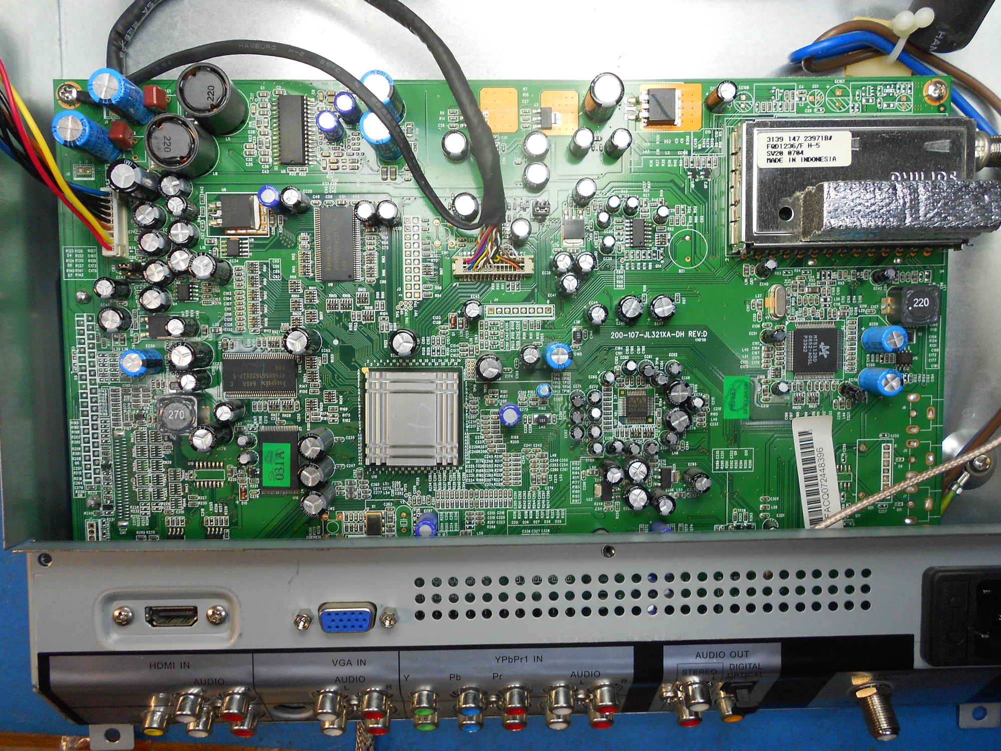

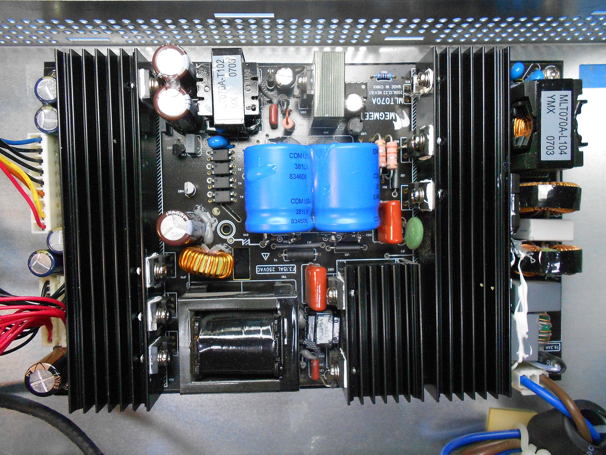

        Attached are.. well the frame.
        connectors that lead into a serial port of some sort which connects to the mainboard.
        the inverter and the mainboard.

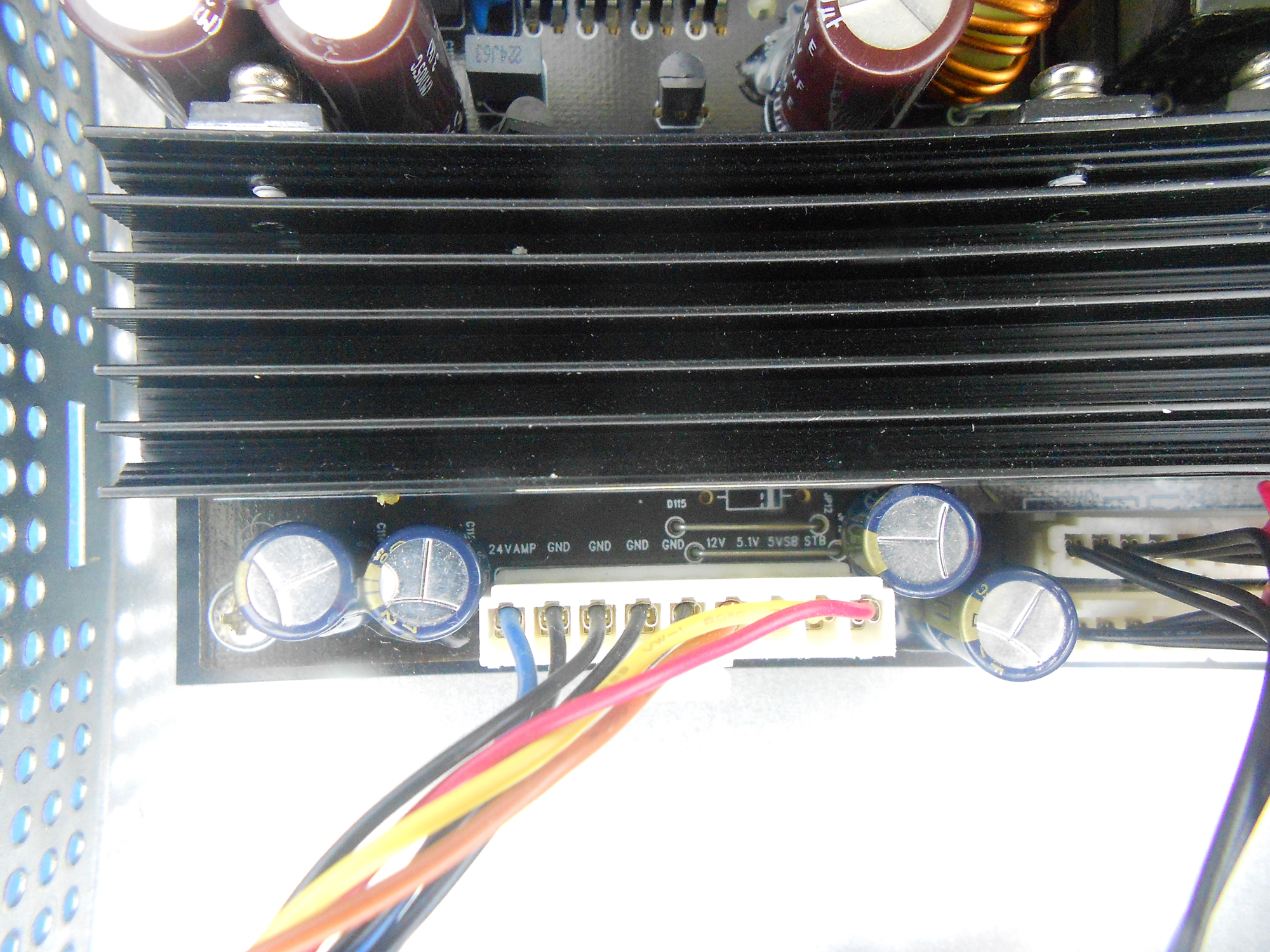

        I took a picture of the connector that leads to the mainboard from the power supply. I couldn't find PS_ON but would any of these be it? I took this picture through a lit magnifying lamp so if you need any close close ups feel free to direct me.
        this is all a learning experience for me.

          It looks as if that Panasonic cap just down from the main output connector is bulged.
          I've dealt with this supply before with the same problem. The fault was the uppermost two capacitors next to the grey transformer. But you have replaced them.
          Also something to check: While it is plugged in, try pressing down on the main board, near the input connectors, and seeing if the TV will then switch on.

            Usually at this point I'm complaining about the poor pictures; these are excellent. You deserve special recognition for the last one.
            5VSB should always be live (5 volts) when the power supply is plugged in; STB is the control line. Because they call it STB, it may turn the power supply off when high - I've encountered that a few times.

              This power supply is very odd. It seems to generate 5V, 12V etc. all while in standby. When turned on, the 24V rail starts up; that powers the inverters and audio output. Seems a bit of an odd way to do it.

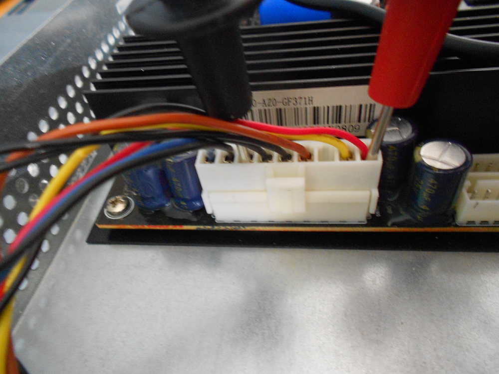

                So testing the voltages out of the connector leading to the mainboard.
                -5VSB was a steady 5.23V
                -STB was a steady 5.06V
                -Applied pressure to the mainboard near the input connector while attempting to turn it on (no dice).
                I figured the STB would show some fluctuation if I attempted to turn on the TV; am I to assume this is correct?
                I'm starting to think both the remote, and my key controller board are both broken but that's just crazy talk maybe. The remote is definitely sending out an IR signal (I have an IR receiver for my computer that lights up for any IR device pointed at it). As for the key controller board has no actual buttons on it and is pressure sensitive of some sort (200-700-KF371CH) so I can't physically tell if I'm actually hitting the button.
                Because I have installed a second control box and same issue occurs. Again leaves me baffled.

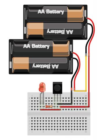

                  Do you have, or can you acquire a 1kohm resistor?
                    Re: Chimei DTC-37MK - solid red light
                    yup, got one here.. what should I do?
                      k so I was really unsure what to do with the 1kohm resistor so I went ahead and googled some testing via 1k ohm resisted and found this set up to test the IR Receiver via LED and 1K ohm resistor and went ahead and did it using well... a breadboard, LED and 4 AA batteries.
                      so... nothing wrong with the receiver that's for sure, but there is seriously something a bit squirrely about how this TV starts up. I'm definitely missing something.

                        Since STB does not change, there is a problem with the main board. At this point I usually suggest checking any fuses and LDO regulators on the main board.
                          I actually went ahead and did a reading on the connector afterwards and you're right.
                          24VAMP read 23.7V
                          12V read 10.9V
                          this is still in standby I guess :S
