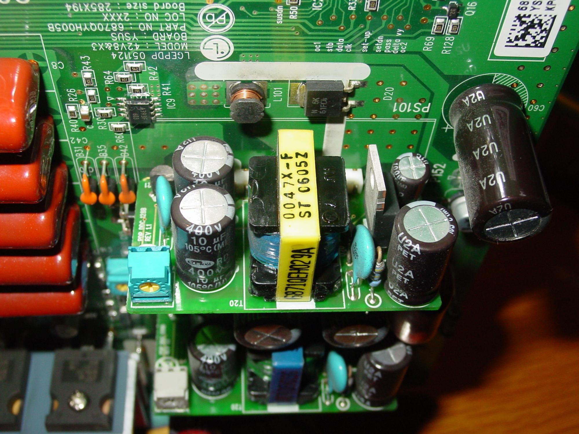

        since I don't have the exact schematics of this board ( the PS101 ), how can I discover what is wrong with it?
        • PlainBill
          • Feb 2009
          • 7034
          Re: LG 42PC1RR-ZL y sus problem
          You start by taking pictures of the power supply - one of the top and one of the bottom - and posting them HERE using 'Manage Attachments'. I've had enough problems with '.jpgs' posted offsite that wouldn't open or contained something extra. Don't post them inline.

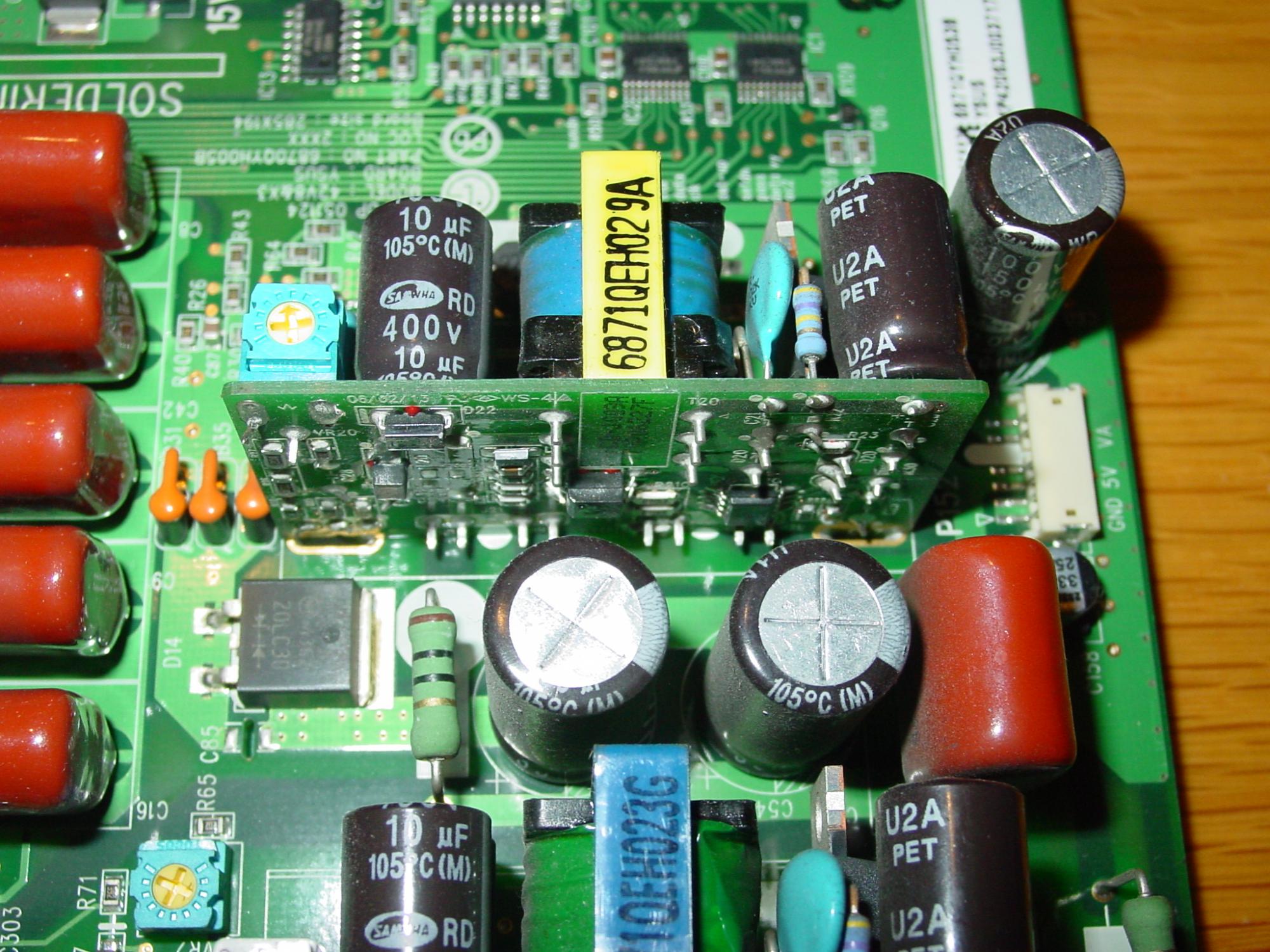

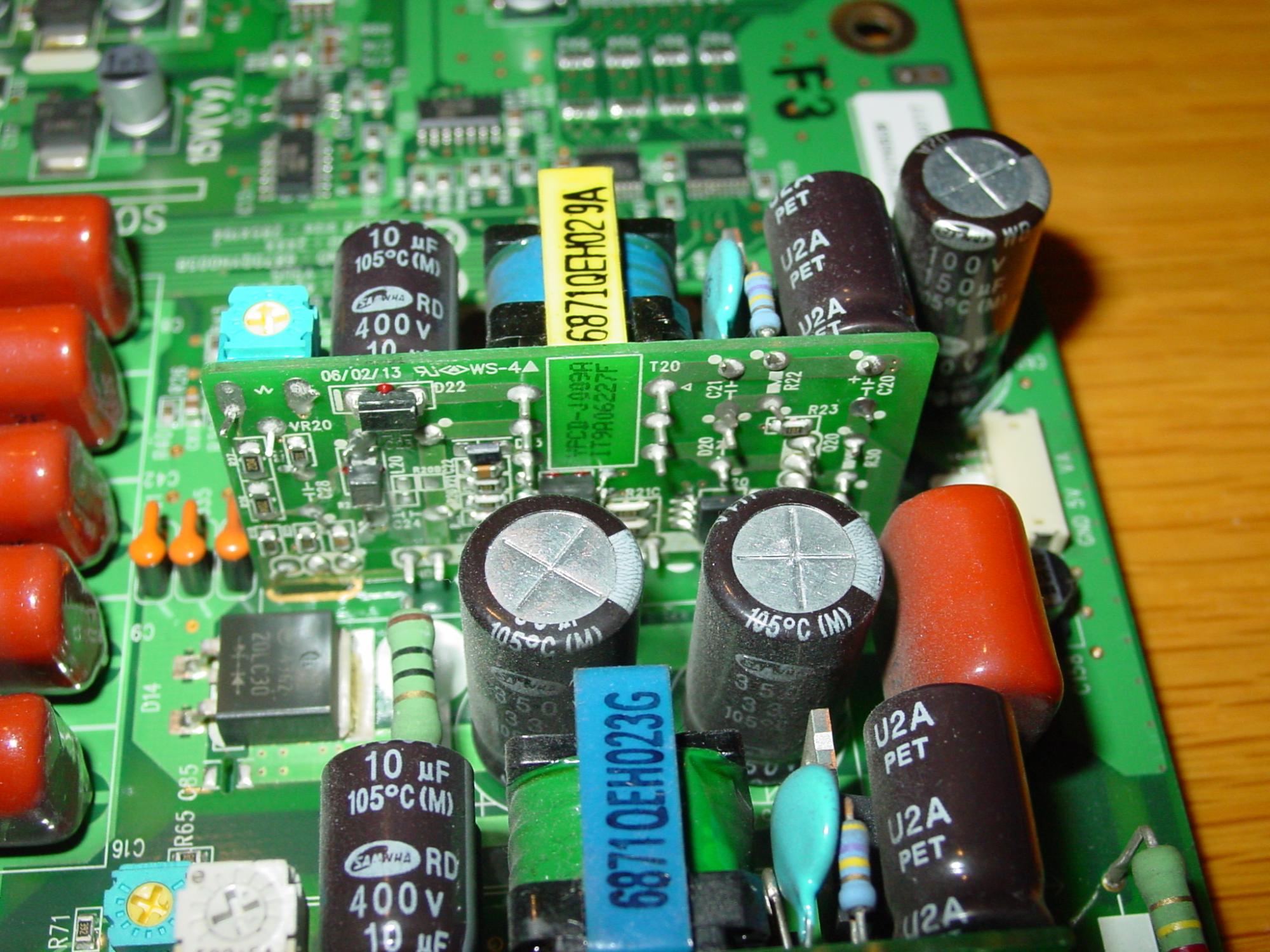

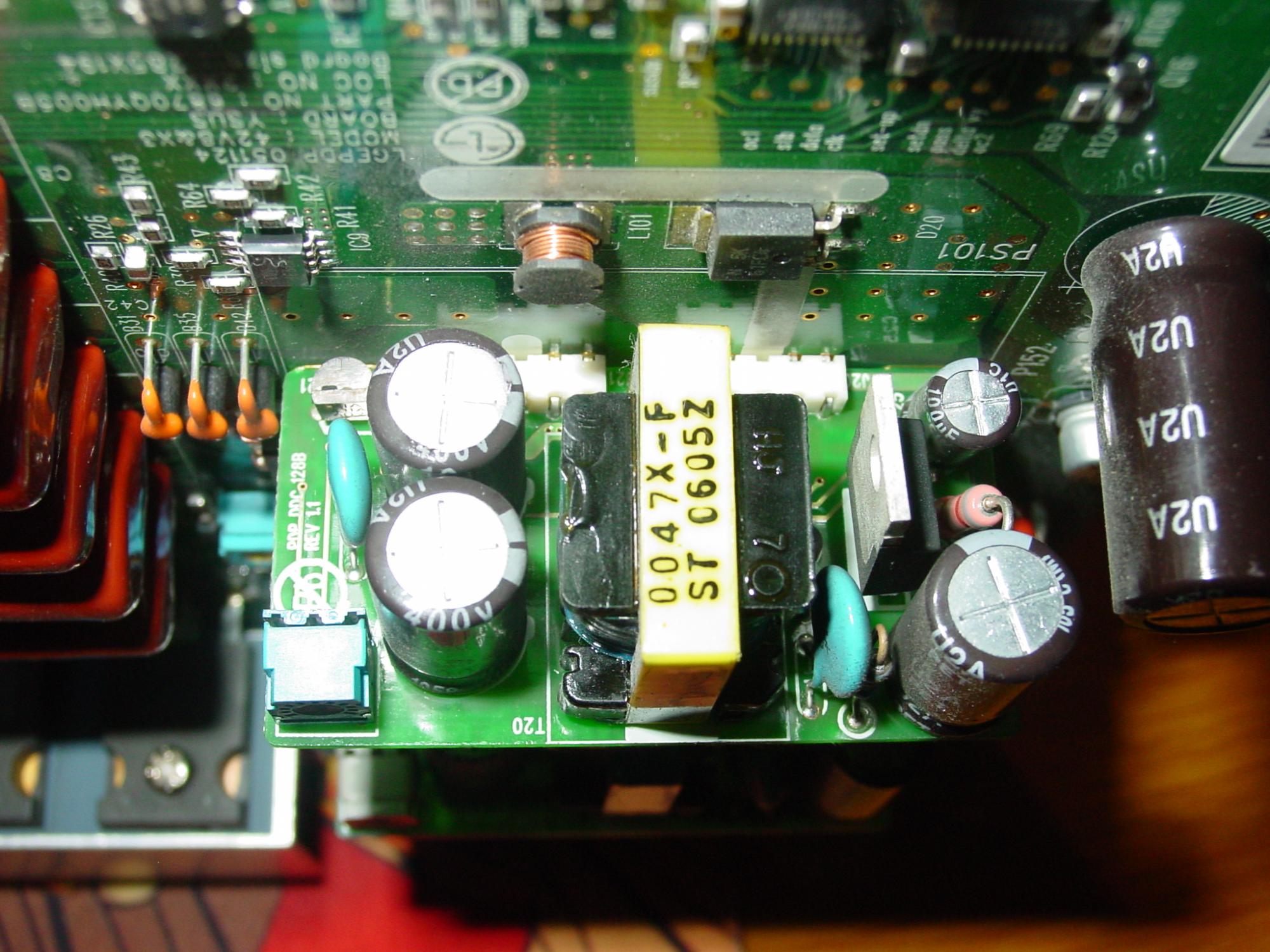

              Sorry, it was early and I wasn't paying attention. Yes, pictures of the top and bottom side of the PS101 would be helpful. It may be necessary to use wires to extend PS101 above the board so you can make measurements.
              Actually, let me make a suggestion. With PS101 still in place take pictures of the top and bottom showing as much as possible. I have a similar board here; if they match it will make things much easier. If they don't, well, it's little time lost.
                hey, you don't have to appologize!
                I am the one who's need help!
                here it is the pictures. if you can see what you want, please tell me and I take more.

                  It's built on the same board, but there are a few dash number (version) differences, almost certainly due to a different output voltage. Borrowing on other reports, I'd replace C25 - it's the smallest electrolytic cap - 100 uF, 35 volts on mine. If that is leaky it could affect the output voltage.
