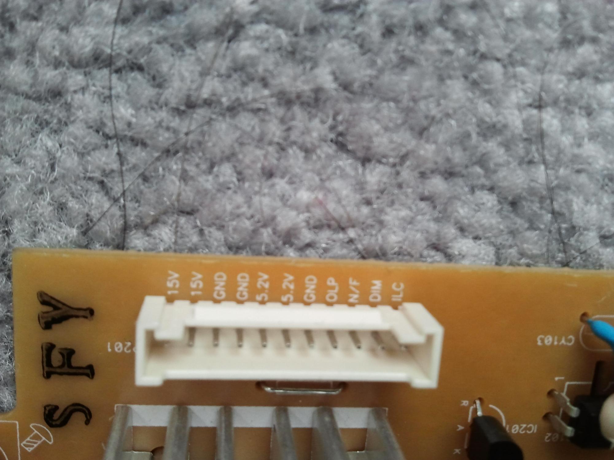

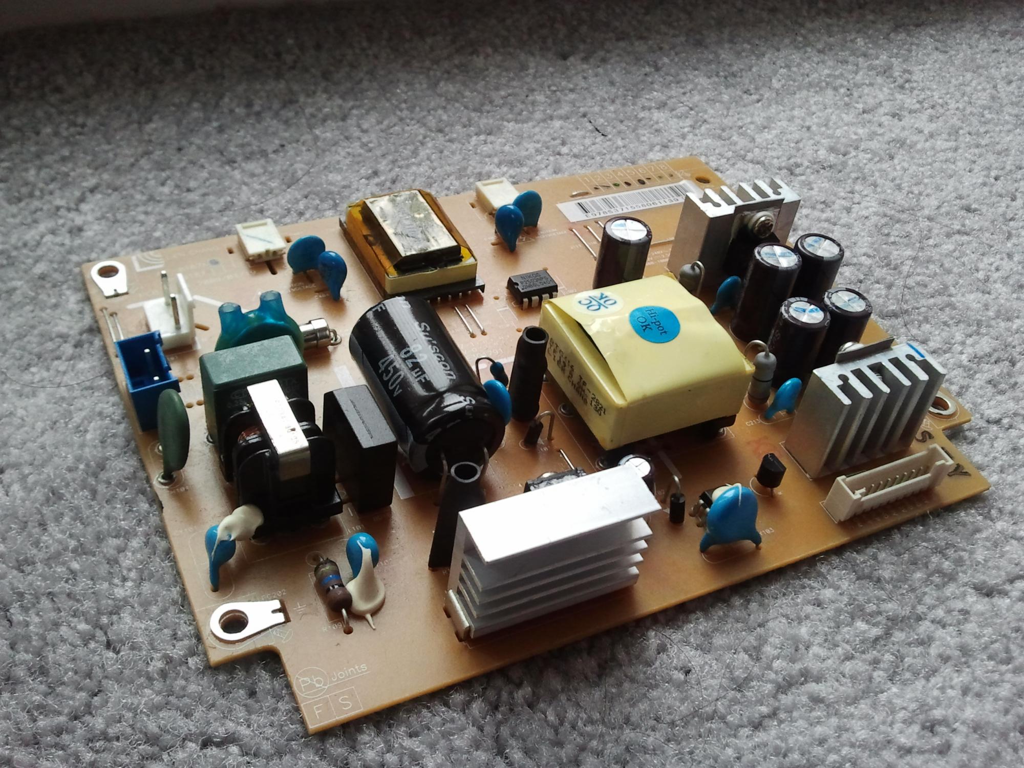

    Got an lg 19lh2000 here that will not power on, just flashing power led. all caps look fine. i have tested the output voltages here:
    They all seem low.
    I tested these with just the power plug connected to psu.
    15v - 0.8v
    15v - 0.7v
    gnd - 0.8v
    gnd - 0.7v
    5.2v - 0.8v
    5.2v - 0.8v
    gnd - 0.7v
    olp - 0.6v
    n/f - 0.6v
    dim - 0.6v
    ilc - 0.6v

    Re: Lg 19lh2000 lcd (flashing led)
    Retest holding the black probe on one of the Gnd pins.
      hi Bill,
      15v - 14.84v
      15v - 14.84v
      gnd -
      gnd -
      5.2v - 5.25v
      5.2v - 5.25v
      gnd -
      olp - 0v
      n/f - 0v
      dim - 0v
      ilc - 0v
        hope i tested it correct this time.
          Yes, those voltages are reasonable.

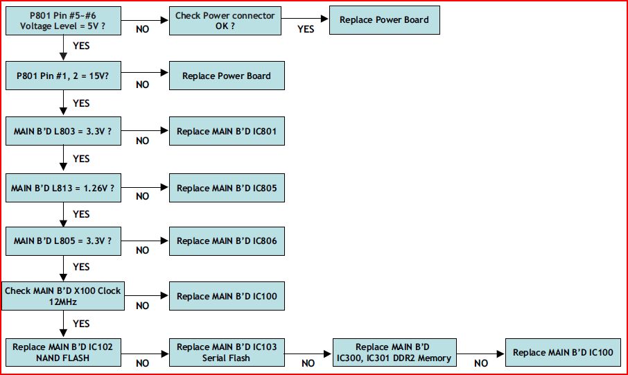

              Try this test.
              Unplug everything except the power supply and the main board. That would at least eliminate all other components.

                  That sounds more like an error code. Read the service manual.
                  PlainBill
                    THen it is the mainboard.
                    The mainboard is telling it to shutdown.
                    If all of your voltages are correct then the mainboard has a problem and needs to be replaced or repaired (if possible).
                      Yes you are correct, it is main board.
                      if both psu voltages are correct, then there is some voltages to check from main board, which i have not done yet. just deciding whether its easier to buy a used board or repair.

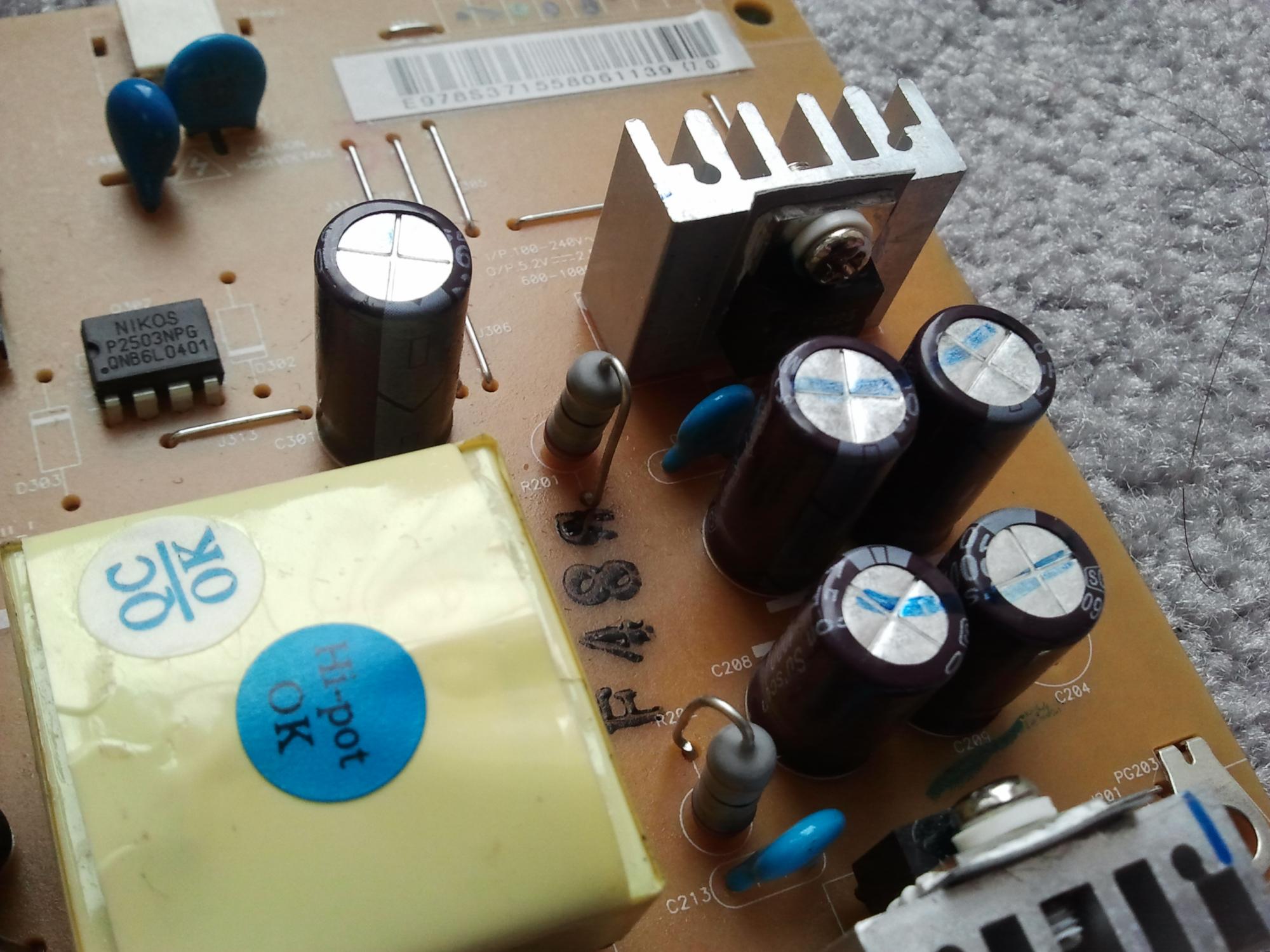

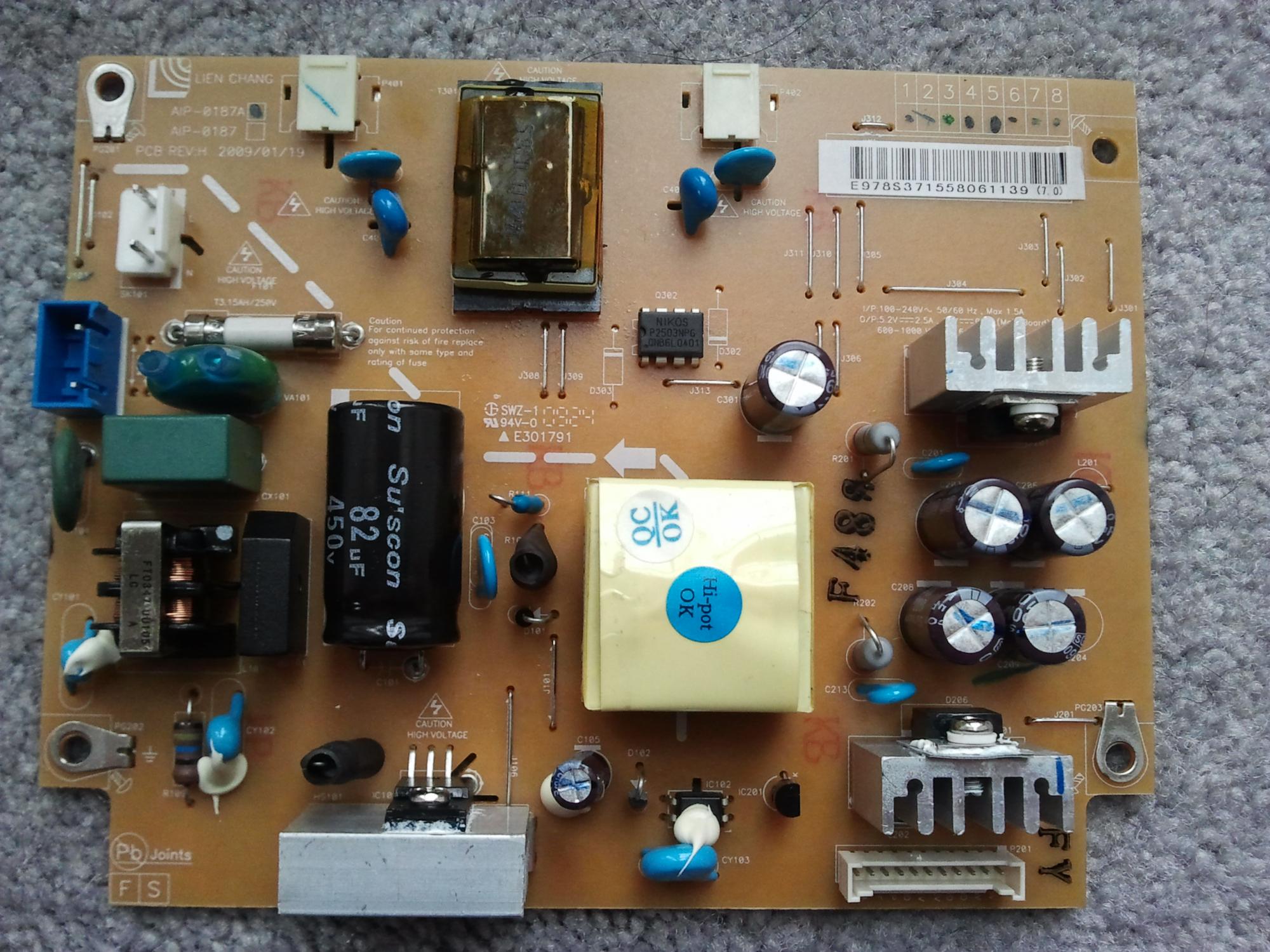

                            I've just been looking at one of these televisions with exactly the same fault, all voltages look much the same and the symptoms are the same.
                            I found a faulty FET Q302 on the power supply. There is a kit for sale on ebay that includes a 2.2k resistor with the new FET(P2503NPG). The resistor fits between 2 links marked J306 and J310.
                            I've replaced the FET and fitted the resistor and it's now working.
                            Perhaps worth checking your TV if you are still fault finding it.
