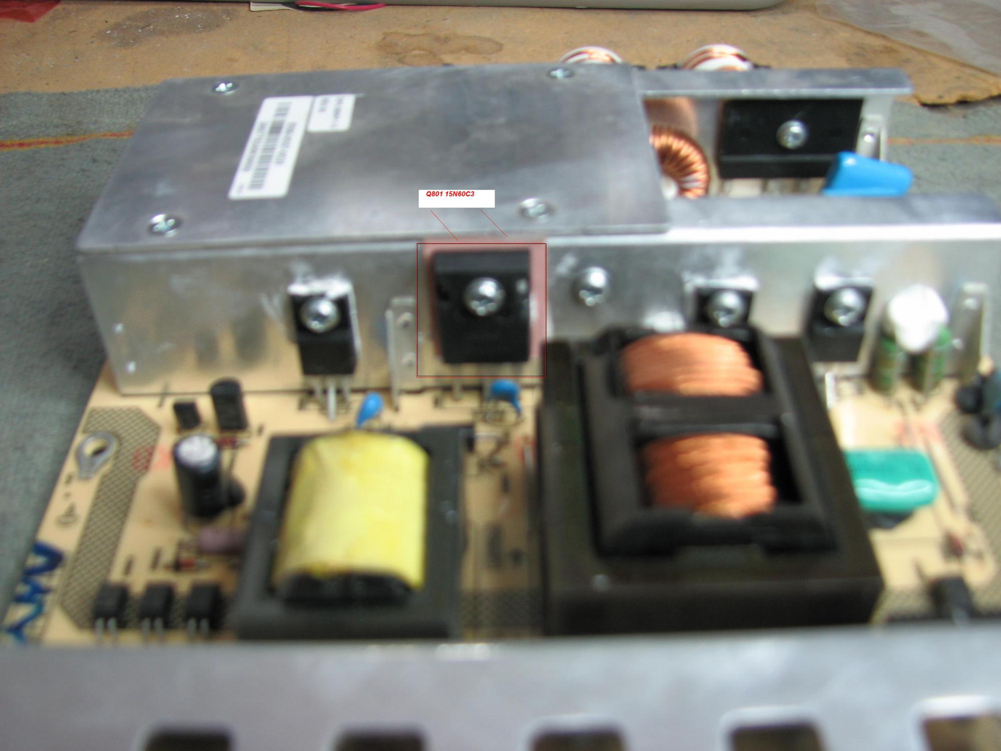

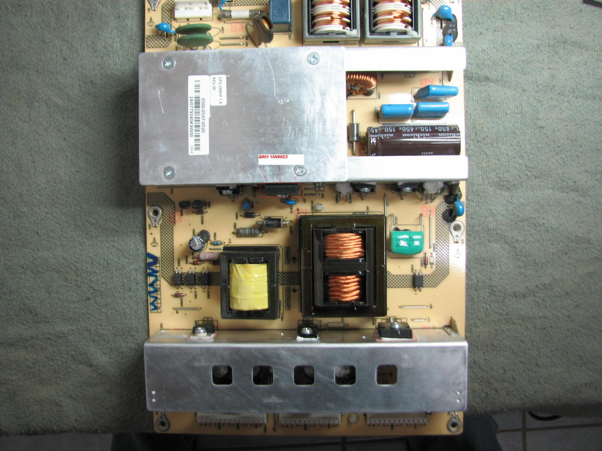

    I got this Vizio lcd tv model VIZIO VO42L FHDTV10A,that has no power at all,found a short transistor in the power board,anyone knows a substitute for it? the part number is,,15N60C3,main fuse is blown and obviusly ther's no power at all..thanks in advancefor your help..

    Why look for a substitute? Mouser has them in stock. Just make sure you get the right case style.
