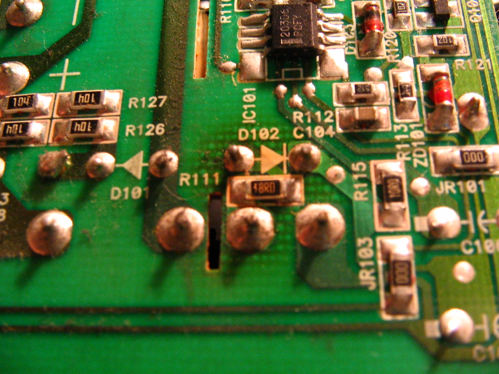

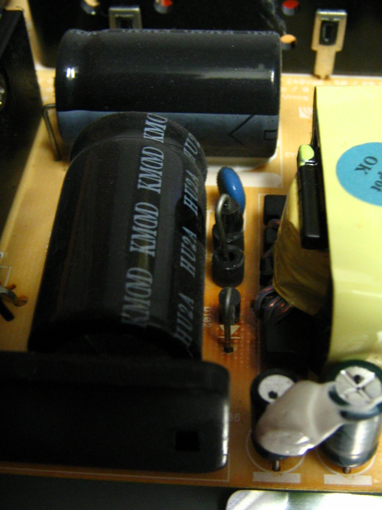

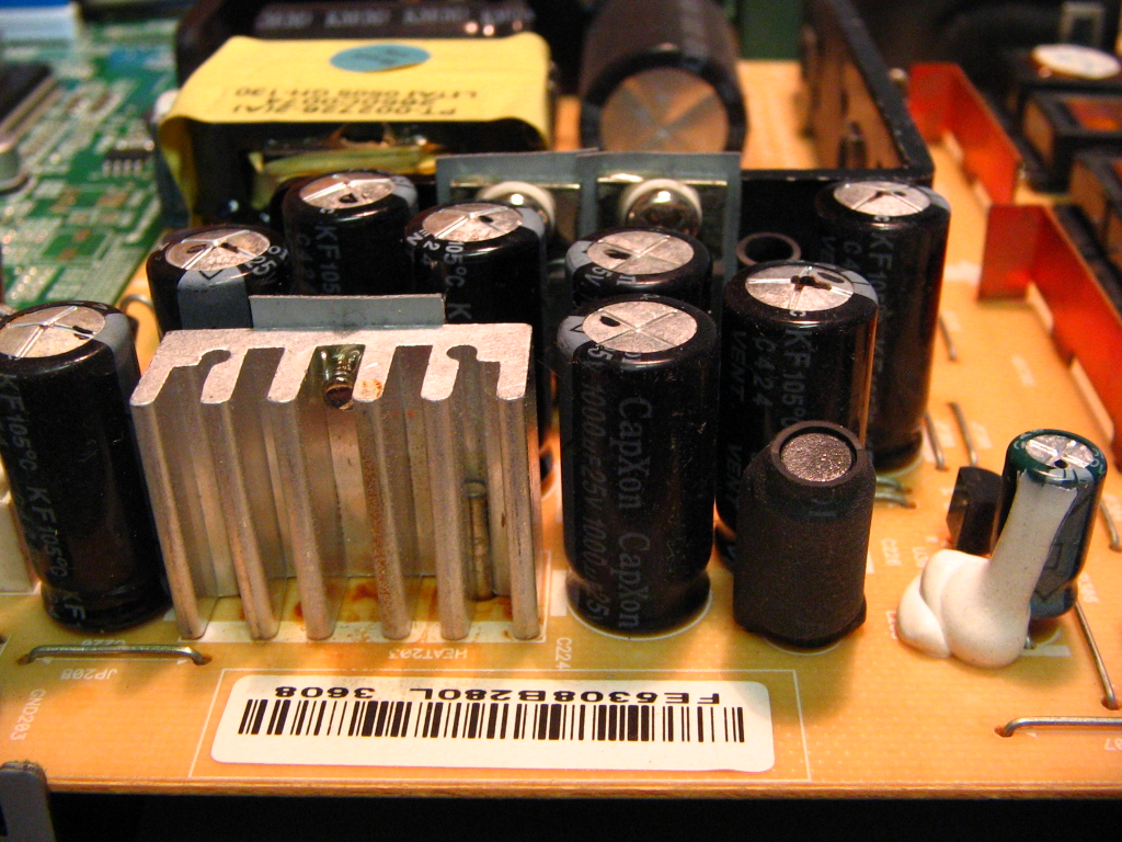

    Took this cute little TV/monitor apart today to find smoke residue inside over the area of the power caps. Clearly the caps are blown from these pics but I'm wondering if the previous owner kept the TV plugged in after realizing something was wrong and in turn causing more damage than just the caps.
    Next the one of the main large caps is a brown area near unidentified components. A suspected problem it looks bad. I wanted to get the qualified opinions before sarting my shotgun repair.

    Yeah that D102 got a little warm. You'll have to check it with a meter to see if it's still good. It may be ok. If you want, get a replacement whenever you order your caps, it wont hurt to change it. It's a cheap part.
    Diodes are easy to check. One direction should show high ohms, the other direction should show zero ohms.

            Ok, so I tested the 2 diodes in question and the D102 gave a high reading on both sides. The other one had a high and low side. The D102 is a lt400 1n4007 and I'm having a hard time locating a source for it.
            Also, I went a little too hot with my solder station and the PCB around one leg of the diode got a little flakey. Looks like it will settle down once I re-solder the new diode in, at least I'm hoping it will.

              1N4007?
              http://www.jameco.com/webapp/wcs/sto...de=WSF&CID=GMC
              You have to buy at least 10 of them, but they're REALLY cheap.

                And REALLY unsuitable for anything but the mains rectifier on a SMPS. You need a fast recovery or ultra fast recovery diode.

                  Thanks Bill. I was leaning towards getting a fast recovery because they looked more like the one I pulled but they all said 1000v and was wondering if thats too high? I'm hoping to keep this out of the landfill.

                    The voltage rating of a diode is the reverse voltage it can withstand (with a bunch of qualifiers). Good practice dictates the voltage rating is much higher than the output voltage. Off the top of my head, I'd specify a diode rated for at least 3 X the voltage I was rectifying, probably a lot higher; the cost difference is trivial.
                    As an example, for the 1N4000 series (which I believe are unsuitable for this application), the 400V version costs $.46, the 1000V version costs $.47.
