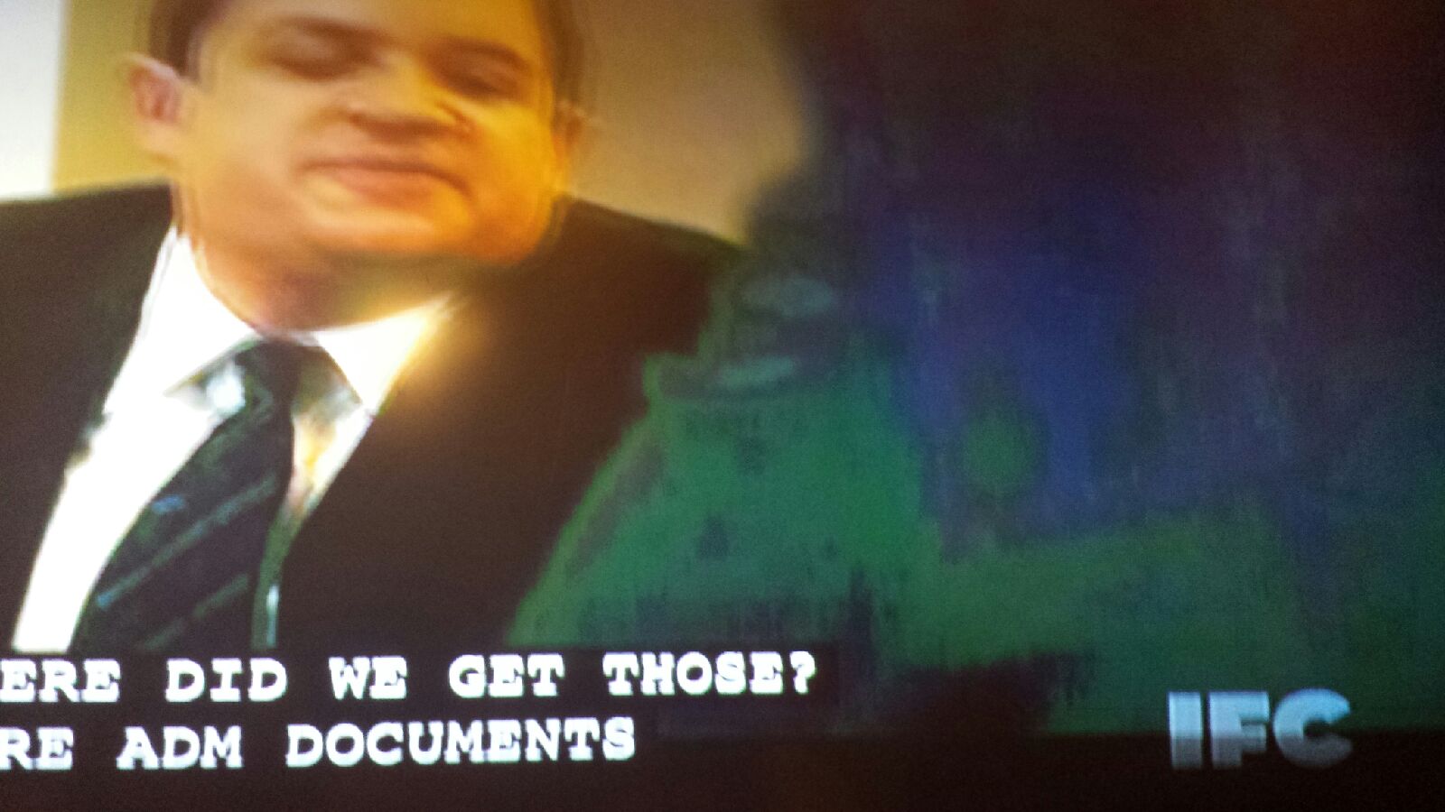

          Hi. I have problem with my Samsung HL-P5085W,after changing the color wheel,the picture look that the green color too much.Do i need to adjust something after color wheel changed?Please look at the pic attached
