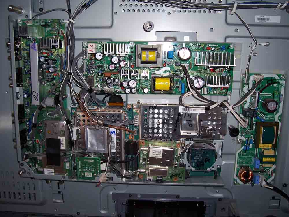

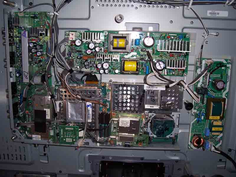

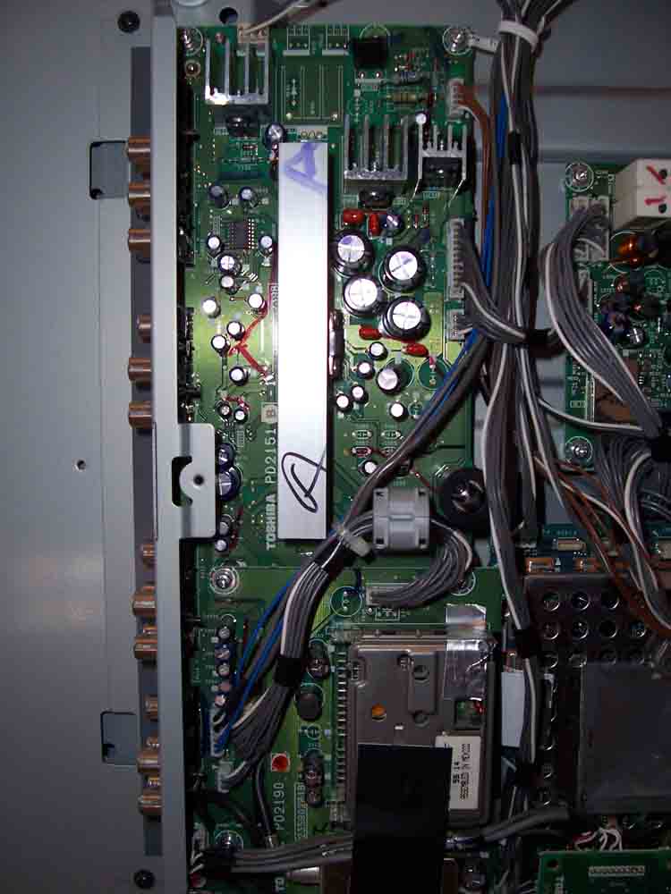

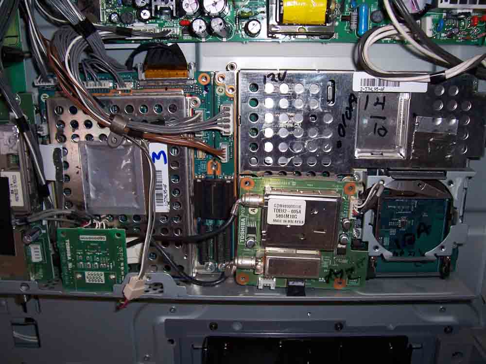

    i bought this tv to learn and because i opened it and it looks different from the other tvs i have seen the insides of. it turns out it is pretty old (2005) and i suspect it is why its so different inside.
    after taking apart what i can i realized someone else has been inside this already and has written numbers all over the boards and also marked which caps have been checked. i dont know if this is a good thing or a bad thing yet.
    i have a RMS fluke meter for voltage but my cap meter can only measure up to 100uF. i am hoping to atleast get started today and tmrw i hope do get a capacitor meter and a ESR meter.
    also cant see any burnt board or bloated caps, well none that are obvious anyway
    but for now i was hoping to find out if this is worth trying to fix or not

    looks like the resistor to the right of the top transformer has a chunk missing..
    just something i noticed while looking at those pics..
    there's also what looks to be a picofuse to the left of the transformer at the bottom. the green resistor-like looking thing..

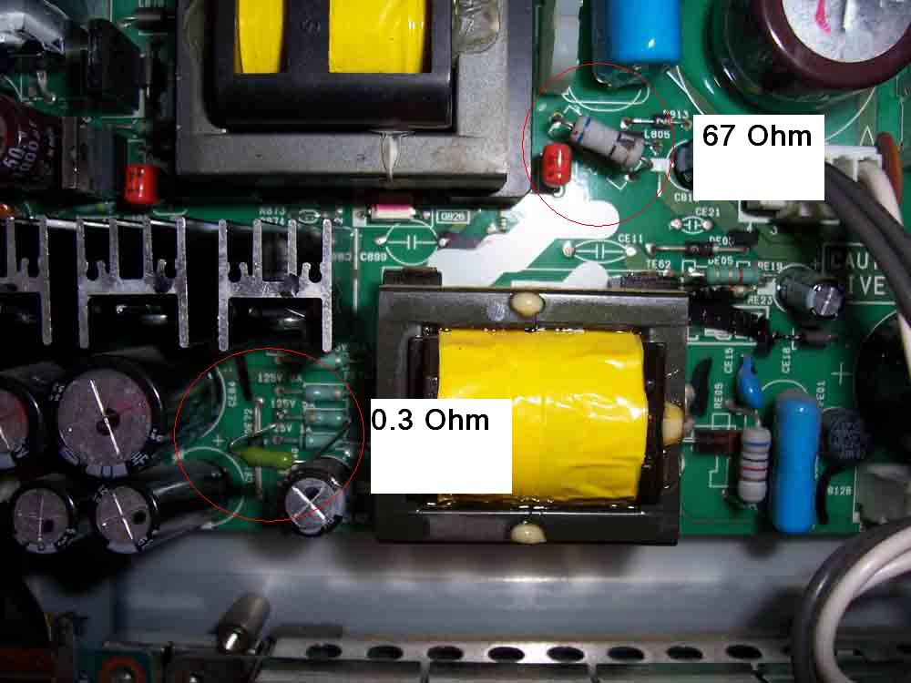

      sorry for all the bad pictures i was hoping i could take better pictures when i get closer to the problem
      i checked these 2 things (in the picture) and got those resistances. im not sure if it was what parts you were talking about or not
      the resistor that you said hada chunk missing has the black mark on it that everything on the board has. it seems the last guy who tried to fix this marked everything he checked with a felt pen.

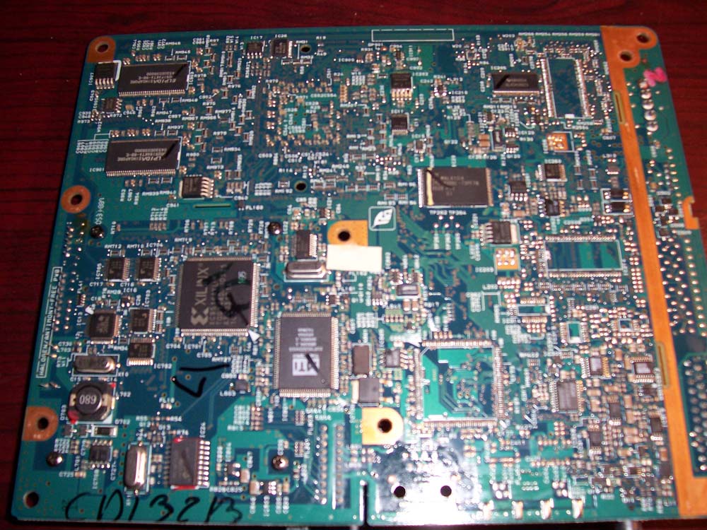

              The bad news here is that the 3 blink error code your tv is giving us denotes that what is called the seine board is failing.
              according to the service manual(s), the seine board is the one marked in red in the picture below. the board marked in yellow is the tuner board above it.
              so it seems like the power supply and everything else is OK, but this strange "seine board" (whatever "seine" is supposed to stand for in this case) is failing / has failed.
              as i don't know what the heck this is, pics of both sides of that board would help to find out what it's for..

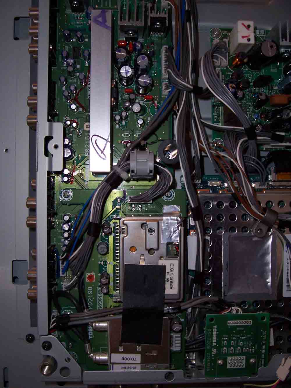

                hahahahah i got the service maunal (thanks bill) and i am flipping through the pages thinking "my god have i ever got a lot to learn about this stuff" then i actually started wondering if "seine" were german words because the website for the maunals was in german. im glad im not the only one confused by the lingo.
                ill pull that board straght away and try to get up pictures tonight

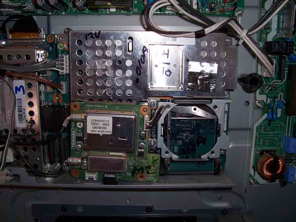

                    again after i got it all apart i can see the lest tech that had this part has checked off some of the digital processors, im assuming this means they are good or at least have been checked
                    i dont know if there is much i can fix on this board everything is pretty small.

                        the auction picture also hints at what the problem is, as it shows a seine board on a solder reflow station, pointing at the main Toshiba chip (!)
                        PS: on most of the other seine boards i found, the toshiba chip actually has a heatsink on it. looking at the pics of the 2nd auction above, there are actually holes in the PCB for the spring loaded mounting pins of that heatsink... did you remove it or did you already get it without one?!

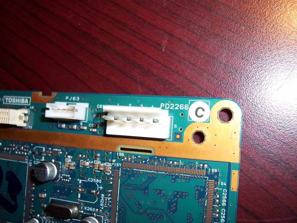

                          which is the PJ63 (20VDC SUPPLY)? i would like to try this. i suspect its the 4 prong plug in my picture but can you verify this before i try
                          also yes mine had an attempt at a heatsink which included a bit of that gummy stuff i have seen in car amplifiers sandwiched between the chip and the tin shroud but the cooling fan put right over top of this spot was missing.
                          although i have a red blinking light and it doesnt seem to stop blinking i also have that green light blinking the green light blinks 3 times quickly and this repeats 4 times like this "3333". is this something to be concerned or note worthy or is it something entirely different?
                          if im going to buy anything it will be the 50$ board so long as it is compatible. anything more then that ill just garbage this tv and try a different one.
                          • scampo77
                            • Dec 2010
                            • 233
                            Re: toshiba 37HL95 "no start"
                            never mind the PJ63 is a board location
                            i tried unplugging it and plugging everything else in and still the same symptoms

                                    well i got a response from the board rebuilder guy and he seems very nice this is his response
                                    Not the siene board .
                                    when you remove that connector you are ' unloading ' the 20 vdc supply. the tv will turn on just no digital .
                                    I would unplug the 24vdc to the inverter board first and see if the tv will stay with no picture first .
                                    The problem you have is a safty shutdown ( a supply voltage is missing or overloaded )
                                    You will need to use a mutlimeter and isolate the problem .
                                    -- JD

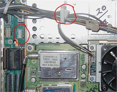

                                        Re: toshiba 37HL95 "no start"..unplug the seine fix
                                        I'm surprised no-one suggested the jelly bean fix...a failed seine module keeps TV from boot-up, but the module is unnecessary for all but rabbit ear antenna's, so unplug the module and try the TV...it may work just fine ! If you really miss the other special features wired into the seine board like PIP , then would you need do a board repair/replace.
                                        Unplug the lead at the left side in pic....
