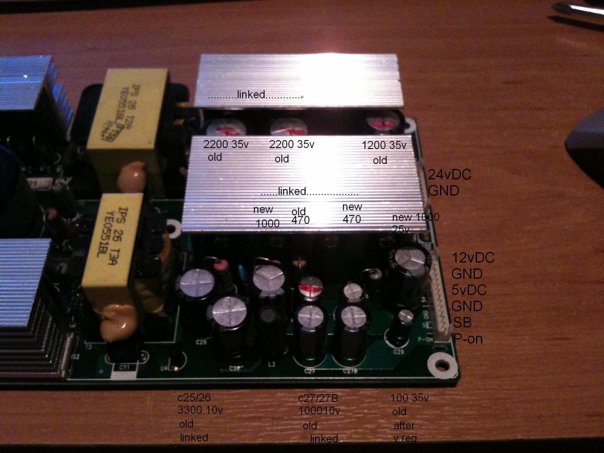

    Just got my hands on a jvc TV that was used in a haulage company office 24/7
    they've already sent it for repair inspection and decided the £180 for the power supply repair was too much for its age so they got a new one,
    so thanks to them diagnostics was made a lot easier lol
    I'v not powered it up as don't want to risk anything being damaged
    so i went strait to the psu and what a surprise!
    on the 24vdc side it has 2x capxon 2200uf 35v, and after a coil a 1x 1200uf 35v caps all buldged (no other caps on this supply)
    on the 12vd side it has 1x capxon 470uf 35v that is all so buldged
    (there are three caps that have been replace before on this side, 1x 1000uf 25v and a 470uf 25v, ether side of the bad 470uf 25v) and one 1000uf 25v just before the output power connector
    question is should i just get rid of all capxon capacitors fitted or just try the buldged ones first and go from there?
    heres a pic, the ones marked in red are buldged, ones marked "...linked..." are on same circiut and linked

    Re: Jvc lt-26a61sj
    on the 24vdc side it has 2x capxon 2200uf 35v, and 1x 1200uf 35v caps all buldged (no other caps on this supply)
    Seeing bulged Capxon is no surprise to anyone who frequents here.
    question is should i just get rid of any capxon capacitors fitted or just try the buldged ones first and go from there?
    The standard recommendation from members here is to replace all the caps, especially Capxon. The biggest one rarely, but not never, fails.
    If you are in the USA, follow PlainBill's instructions on how to order Panasonic FR or FM caps (use FC if the previous are out of stock) at
    https://www.badcaps.net/forum/showpo...33&postcount=2

      Re: Jvc lt-26a61sj
      i'm in the uk but digi-key cover it so no problem there, if not there's RS or Farnell, i'll put a list together n have a look,
      do you think the little blue disk style caps will be ok or shall i look for new ones aswell?
      Regs
      Rich
        Re: Jvc lt-26a61sj
        Those rarely, but not never, fail. You will know it if they fail.

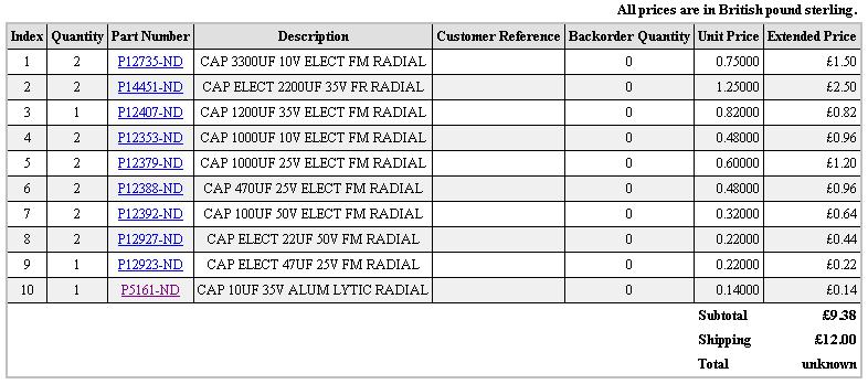

          Re: Jvc lt-26a61sj
          cheers RC
          found all of them so ordering from digi-key, RS and farnell prices are a joke
          all FM series except one (10uf 35v) that's an M.
          posted a pic of my order, do the part numbers look familiar if you'v ever ordered the same at some point?
          Regs
          Rich
            Re: Jvc lt-26a61sj
            As long as you verified all the uF, voltage, diameter, and height (important due to heatsink clearance), the order looks fine.
            You may want to consider ordering a spare cap or two or some other items given the high cost of shipping?
            --- begin sig file ---
            --- end sig file ---
