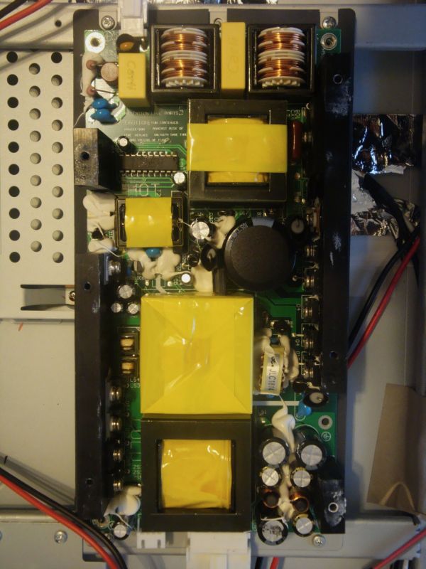

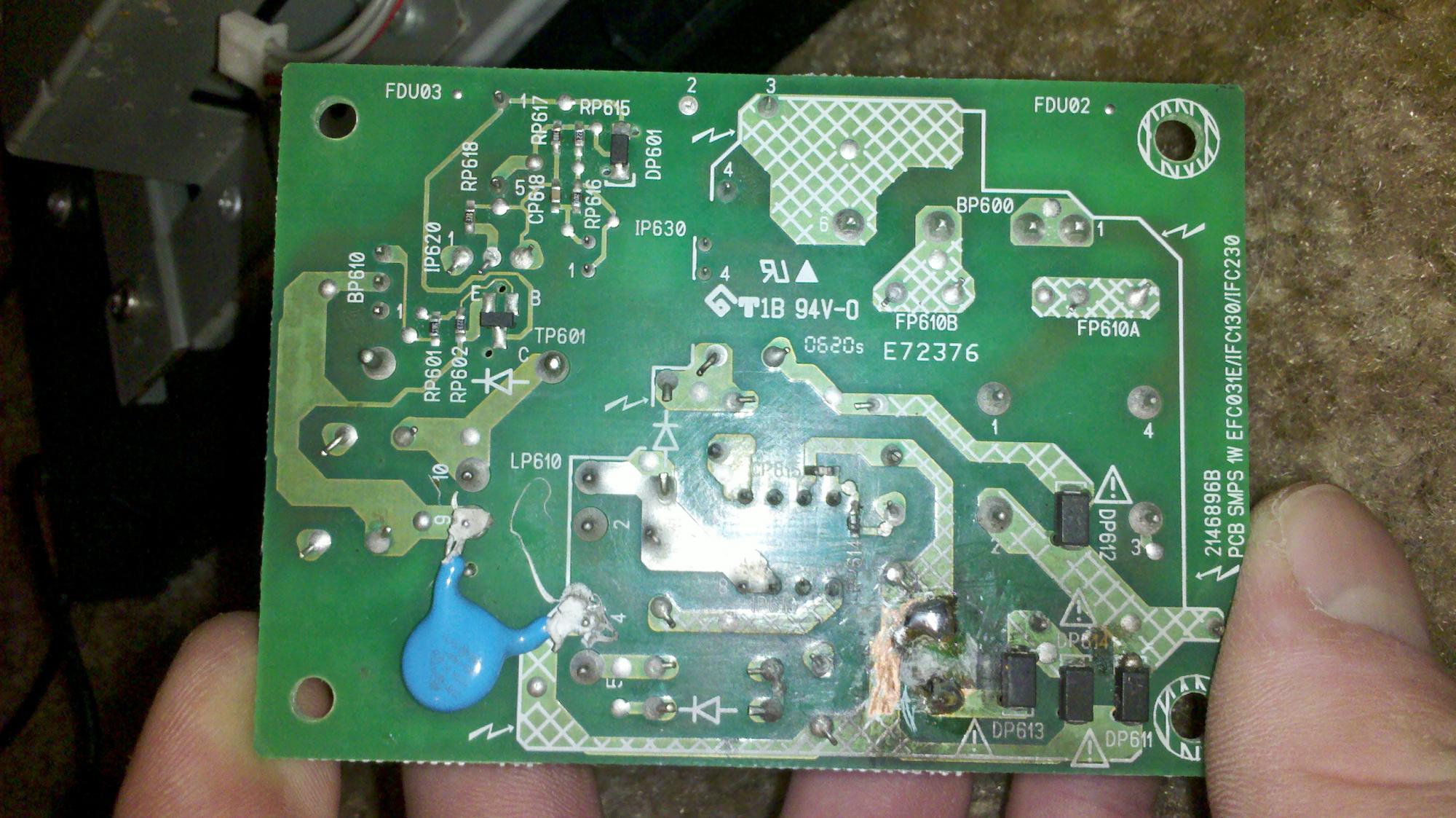

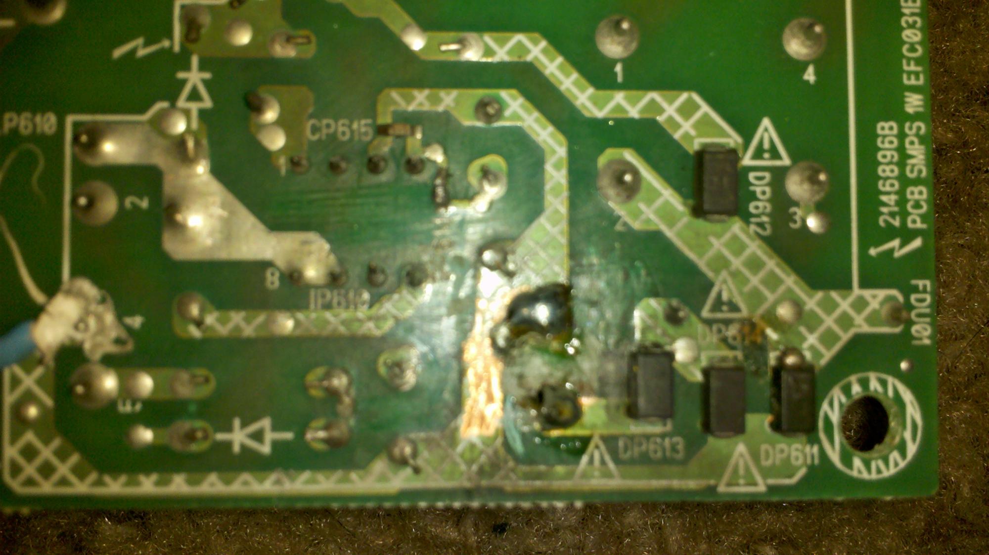

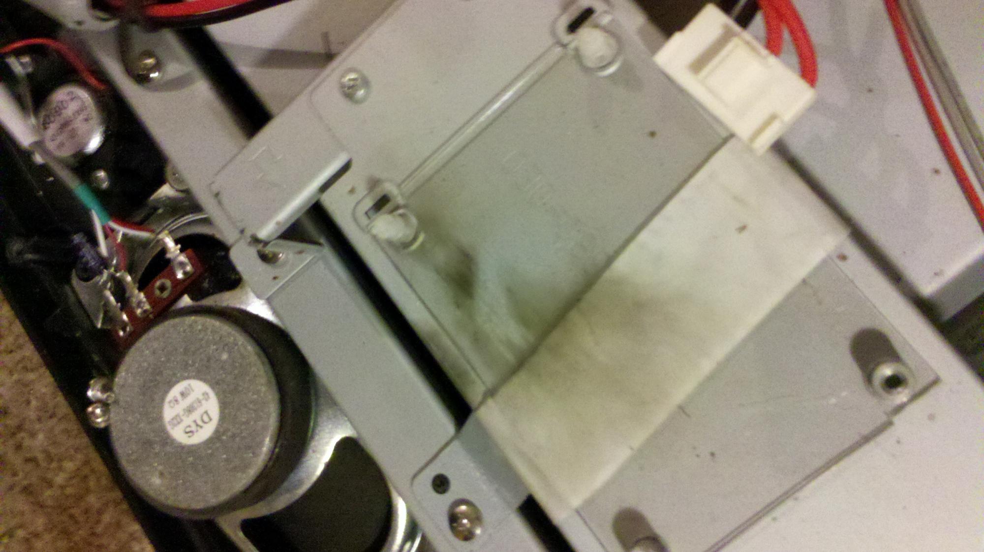

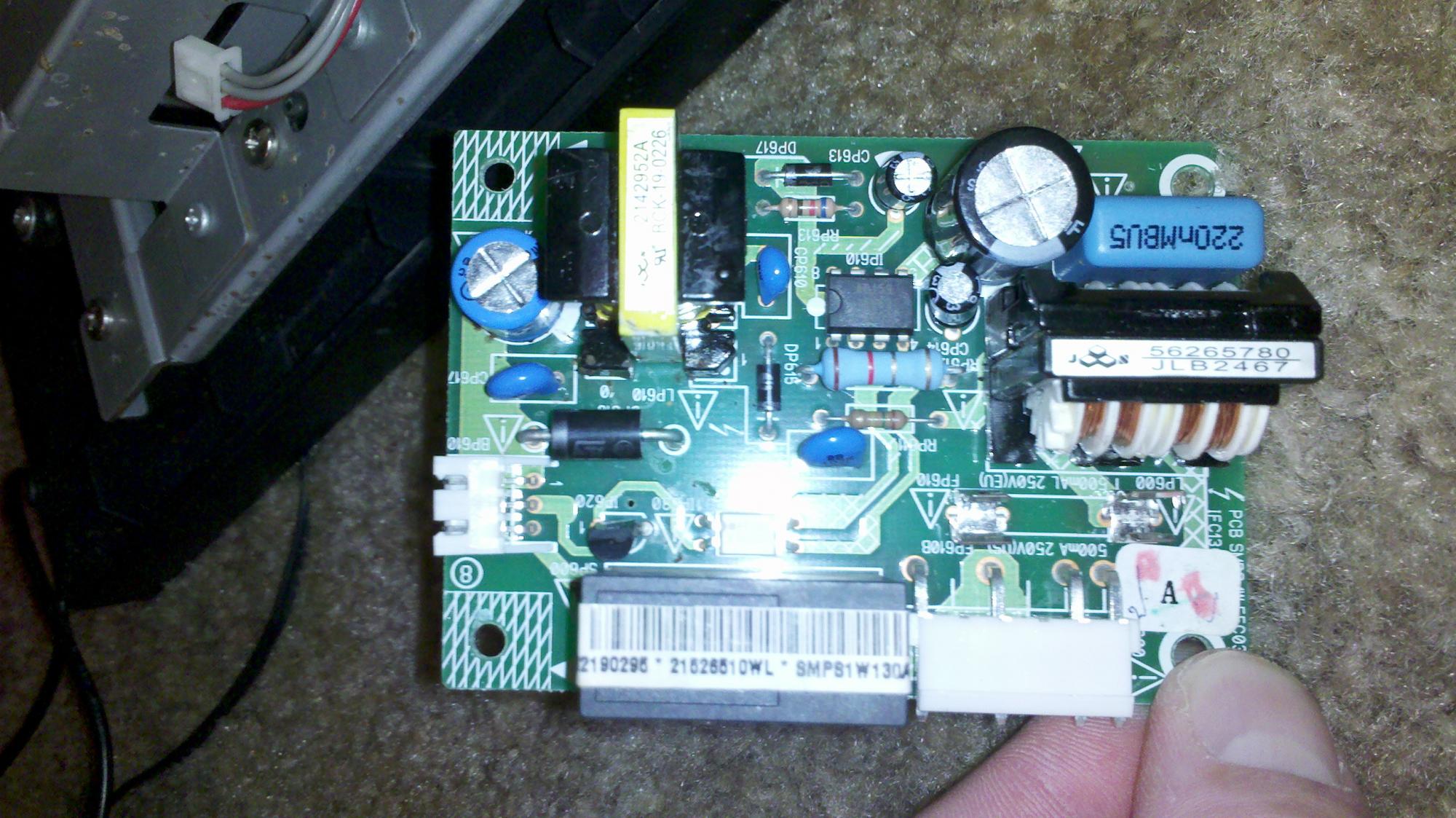

    So I got this tv thinking it would be an easy fix. Im wrong and don't have a clue, I have changed out all the caps on the main power board. It also has secondary power board that. someone else tried to fix but they did a really bad job and I almost wonder if they didn't fry it in the process or anything else for that matter.
    I did find a replacement part for it that I think will work for all the models but im not quite sure.
    http://www.shopjimmy.com/catalogsear...price&dir=desc
    The first picture is the bad soldering job,thrid should be were the board sits
    Think that's about it, thanks very much in advance for any advice.

    Wow!!! Almost more problems than I want to contemplate.
    First of all, the good news. One or two of those pictures were clear enough to be useful. And it should be possible to repair the power supply. Plus you did attach the pictures, rather than post inline. The third picture DID give an indication of something BAD happening.
    Now for the problems. Most of the pictures were so badly out of focus they were useless. The glare from the flash doesn't help either. That's not surprising; I consider myself fortunate if 1/3 of the pictures I take are useful. I just don't post the failures. One other clue - most boards have an orientation. I go by the major lettering. If you position it so most of the legends are right side up, it's easier to decipher.
    Bad news, no service manual available from my favorite site.
    Here's what would make it easiest to help you: Take new pictures. The first one should be an overall picture of the back of the set with all boards in place. (Don't bother putting in the screws, but cables should be at least near their connectors.) This gives me an idea of the power flow.
    Next, I would like to see two pictures of each of the boards. The first is of the top side of the board with the majority of legends oriented for easy reading. The second is of the bottom of the board, with it flipped from left to right. That way if I'm trying to identify a component in the upper right corner of the top picture I know the leads appear at the upper left corner of the bottom picture.
    After viewing those pictures I will be identifying points I wish you to measure. And of course, a brief description of the problem would help.

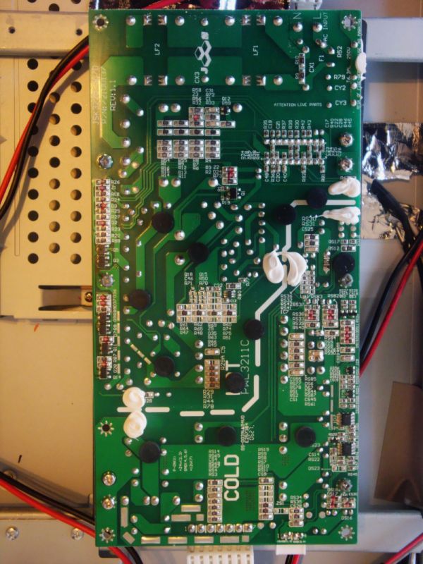

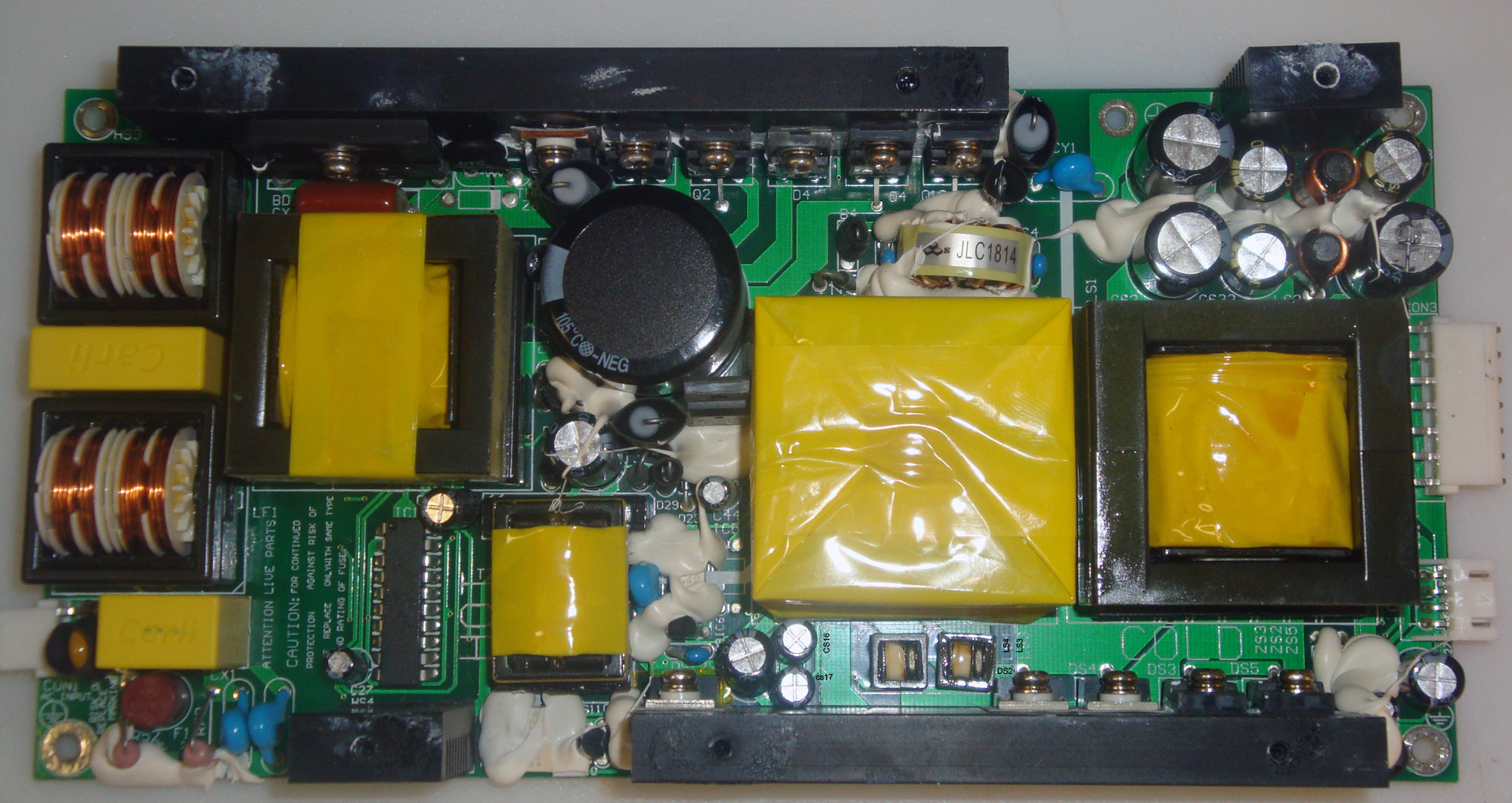

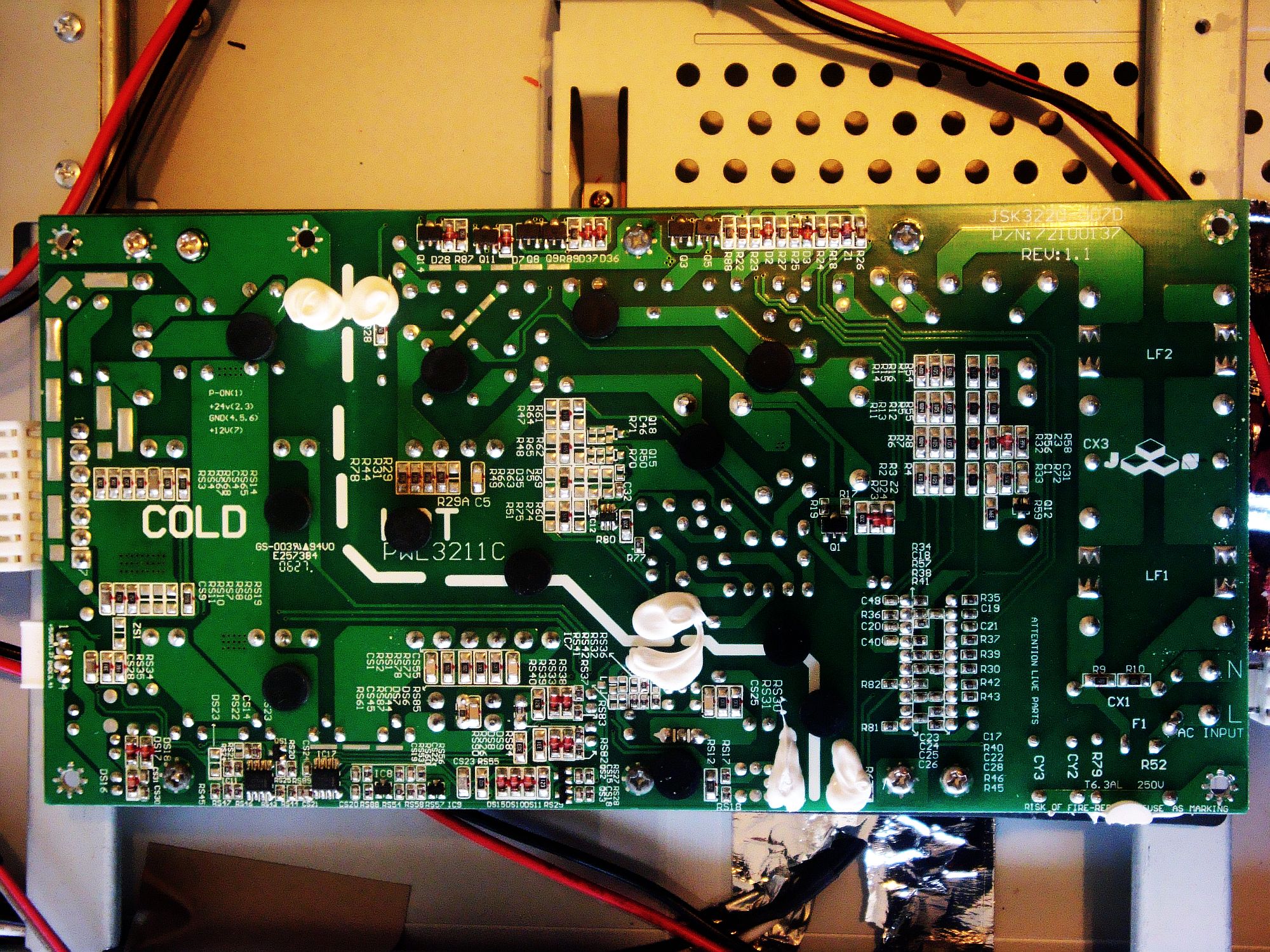

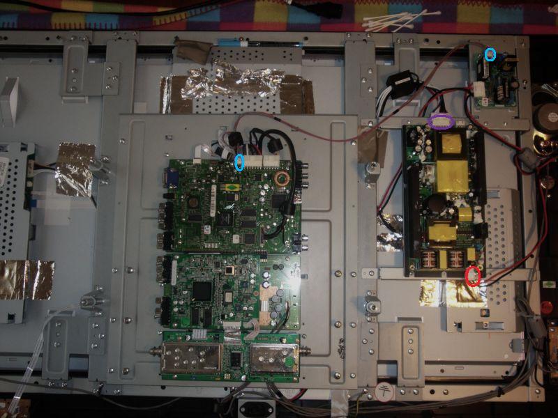

              This is the back:
              Front:
              And overall view:
              In the overall view the colors:
              Red - I measured 120V coming in.
              Cyan - Measured 5V
              Purple - Nothing.
              So that being said, the problem should be between the red and purple. Just can't figure out the flow. Thanks for the help. If you need bigger pics, let me know and I'll put bigger ones up.

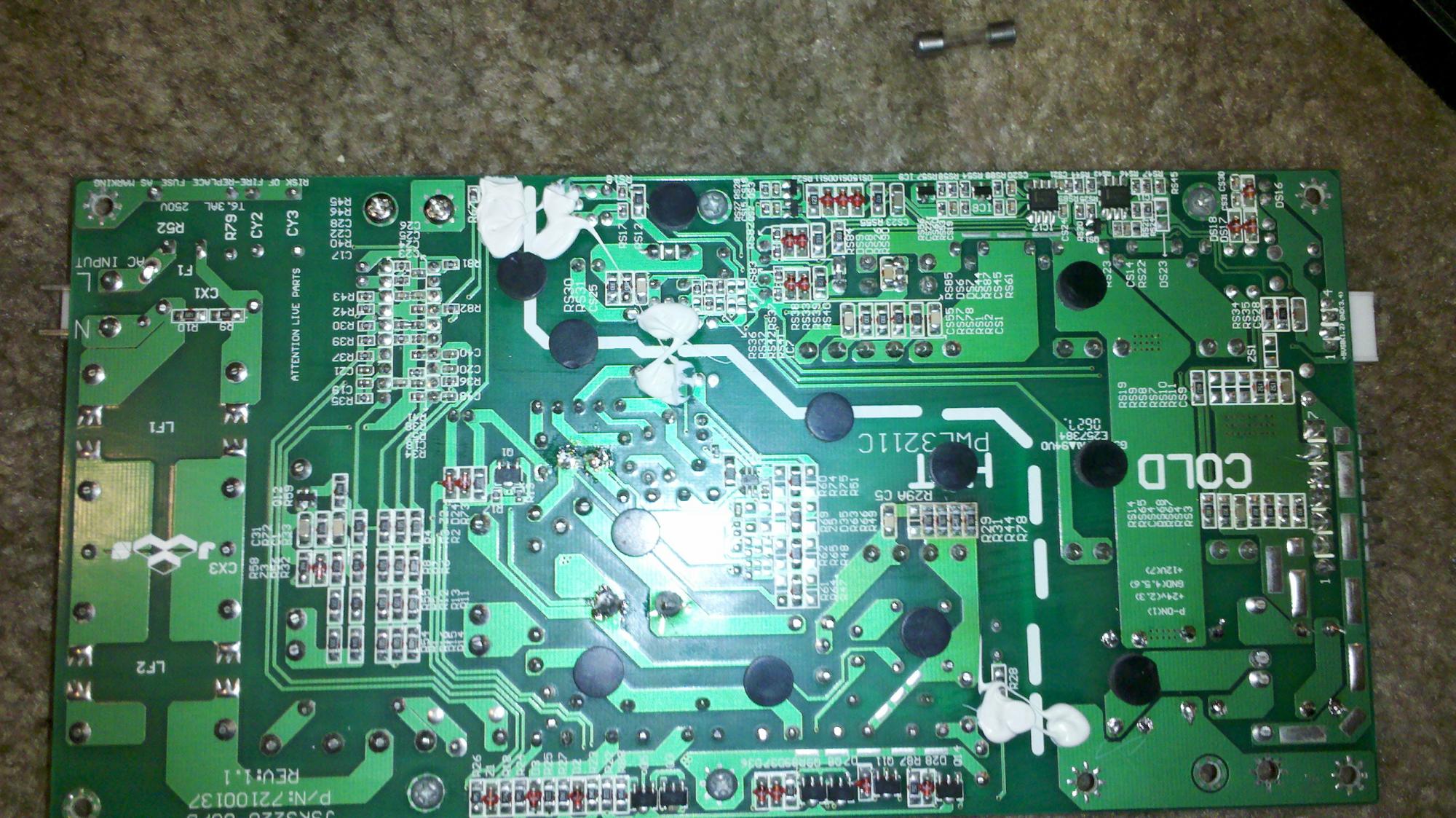

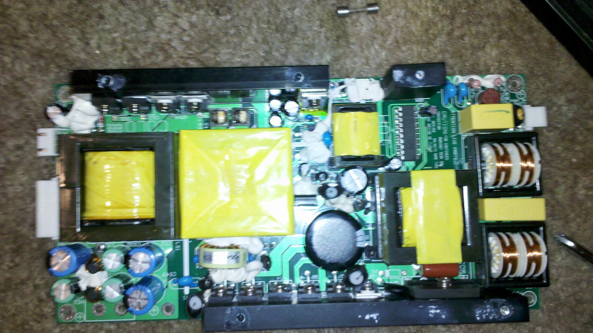

                  Hopefully these are better. Thanks
                  • PlainBill
                    • Feb 2009
                    • 7034
                    Re: rca model l37wd12yx1
                    The quality of those pictures is excellent, thank you. Unfortunately, what I thought was printing in the earlier pictures - isn't. These guys didn't give many clues to help.
                    Still, we will work with what we have. It appears the 4 pin connector on the output is the standby supply. The focus isn't sharp enough to enable me to read the legend, but I suspect it is 5V standby and Gnd. Please confirm that. CON3 is definitely the main power supply output, and it has both 12 and 24 volt outputs. And what is of more interest, pin 1 is the control input. Typically, pin 1 will be low (0V) when the TV is in standby, high (3-5V) to turn the main power supply on.
                    Your job is to verify voltages out of the standby output (and what the tiny printing says), and check the voltage at pin 1 of CON3. If it switches from low to high (and back again) as the power button is pressed repeatedly, but there is no change in the output of the supply, you have a power supply problem. If CON3, pin 1 never changes voltage, you have a problem on the main board.
                    If it does turn out to be a supply problem, what is the part number of IC1?

                        Oy vay!!!! This gets more confusing the further things go.
                        Reference the third picture on post 7 - the picture of the entire set. It appears to me the AC input connector for the set is at the bottom middle of the picture. Is that correct? The red and black wires may carry AC to the board in the upper right corner of the picture. Is that right?
                        If I was right about that, could I have a good picture of the board in the upper right corner?
                        You're reading the voltage at pin 2 of the TDA16888 using the wrong ground. For measurements on the hot side, use pin 7 of the TDA16888 (or points connected to it) as ground.
