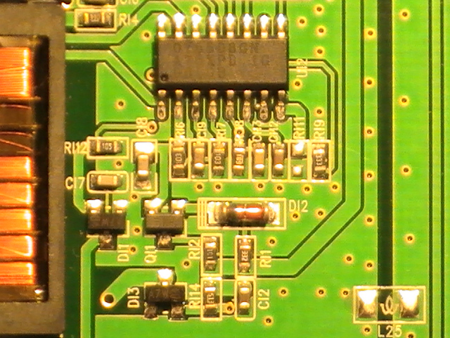

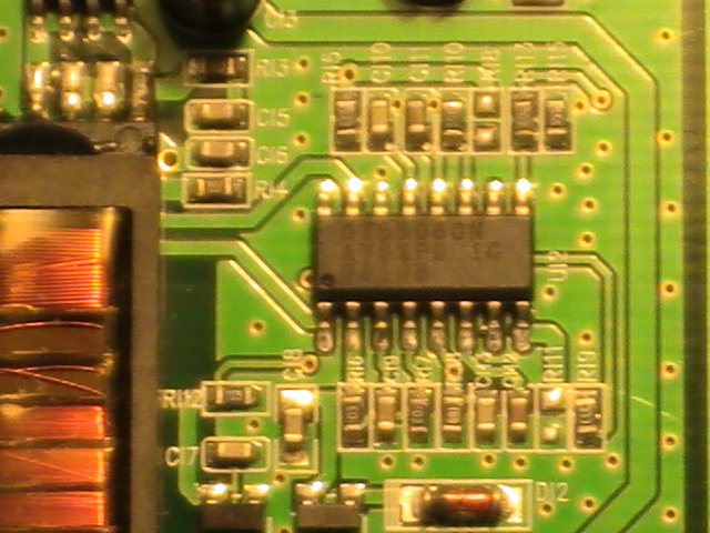

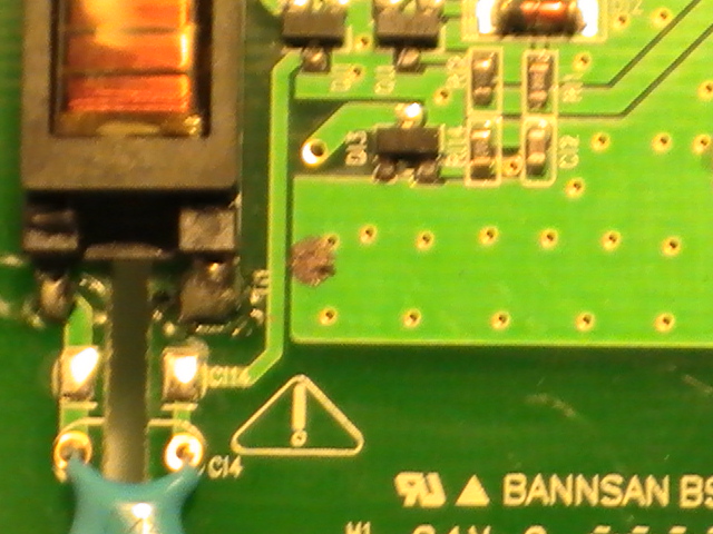

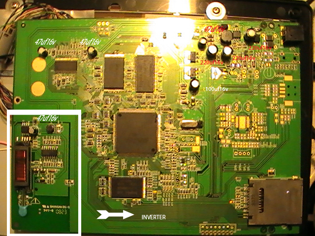

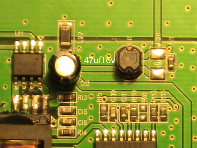

    Hi please I need help with a Polaroid frame10.2 MODEL-XSA-10169S when I turn on the frame the light turn off after a second I can see the picture dark and the pictures are changing.I change the cap 47uf 16v on the inverter and it works well for a day I turn on and off many time the frame, and It was working I test it the next day and the same problem was there. thank for your help

    Good pictures, and thanks for labeling the caps. I always wondered what was inside these picture frames, now I won't have to take one apart to find out.
    What brand and series of cap did you use as a replacement? It appears the main power supply is in the upper right corner. I would replace the three 220uF, 16V caps with Panasonic EEU-FC1C221 or equivalent low ESR caps.

      Thank you bill for answer my question I've chanced it for a radio shack cap 47uf 16v I think that's the problem,sometimes when I unplug the ribbon cable, that goes from the board to the screen that's make it work again but then the problem is back I,m going to chance the other caps with the Panasonic caps. bill if you are interesting for a frame just let me know and give me your address and I'll send you one They are like new. I would like to give you one working but I don't have any more thank bill.
