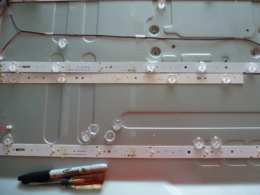

    Trying to fix a backlight problem with a Sceptre 48" TV.

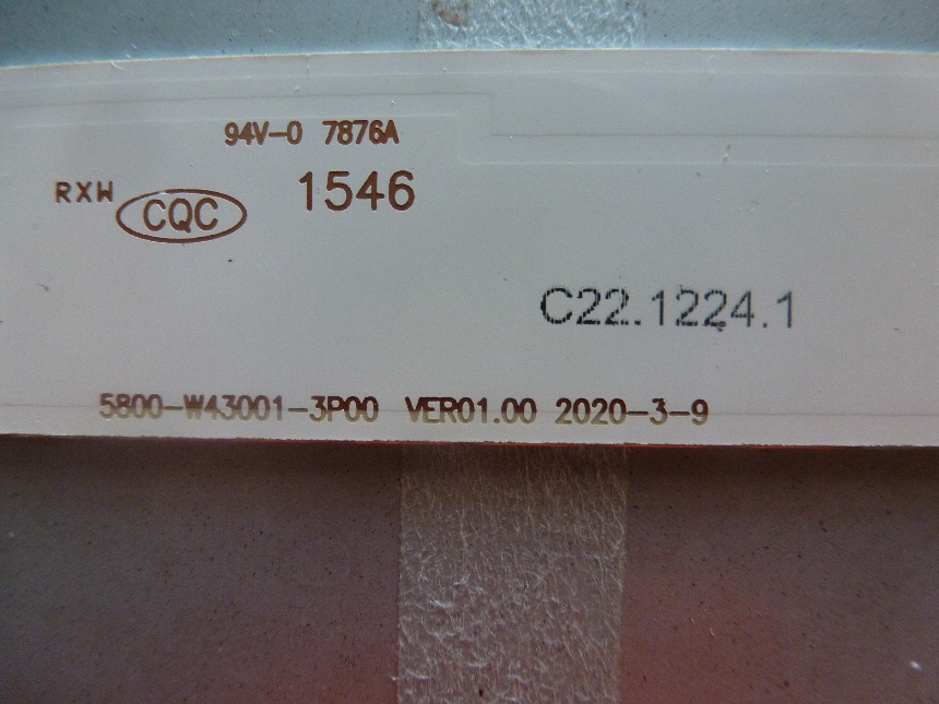

    I found replacement strips with the same part number as the strips in the Sceptre, but the new backlight strips have 5 leds per strip and the ones in the tv has 6.
    So I decided to replace the leds instead. I found 3 bad ones. I had no problem removing the bad ones with a heat gun, they came right out. However the leds on the replacement strip would not come out with heat. I use my solder iron as well, they will not come off.
    Anyone know how I can remove those leds without damaging them?

    Put soldering iron on table lay the strip onto the iron and keep the heat going until it comes off with the tweezers. It's really not easy to do. You can buy individual LEDs on ali express or eBay if you can't figure it out.

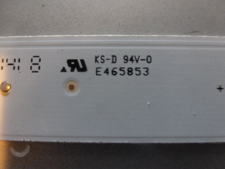

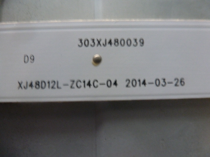

        Sceptre 48" E485BV-FMQR8BK AV93BA S/N E23B485CB0239
        Here are some photos of the strips. The part number from the old strips and the numbers that was on the replacement in the following photo.

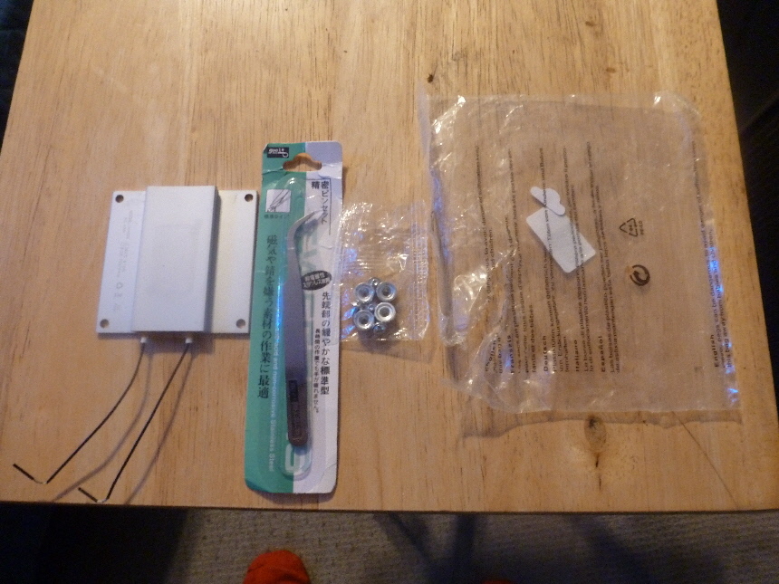

              Wellsir I got the Heating Soldering Plate but there are no instruction and I don't have a clue how to use it. This is all I got ...
                Click image for larger version Name:	P1050176(1).jpg Views:	0 Size:	260.0 KB ID:	3154618
                did you get the rite voltage plate for your country ie 110 or 240v all i did was connect the two leads to a wire and plug (heat shrinked the joins) the small bag is the stand offs fot the heat plate so it does not burn the surface your using it on. I just plug it in then place led strip with led you want too remove central on the plate, let it heat up then remove the led.https://www.youtube.com/watch?v=qxpAGFuKPmg

                    69 ... thanks for that link I would have never have figure it out. I don't see anything about voltage ... just amp <5 that's it. I'm hoping they sent the right voltage since it was coming to the states.

ID:	3155689 That is the number on the strips I bought as well as the original strips in the tv.

                              I just could not find a replacment strip with the 6 leds ... all just had 5 including the one with the same part number as the original.

                                did you try searching using the lcd part number off the white sticker this sometimes helps with locating correct led strips.
