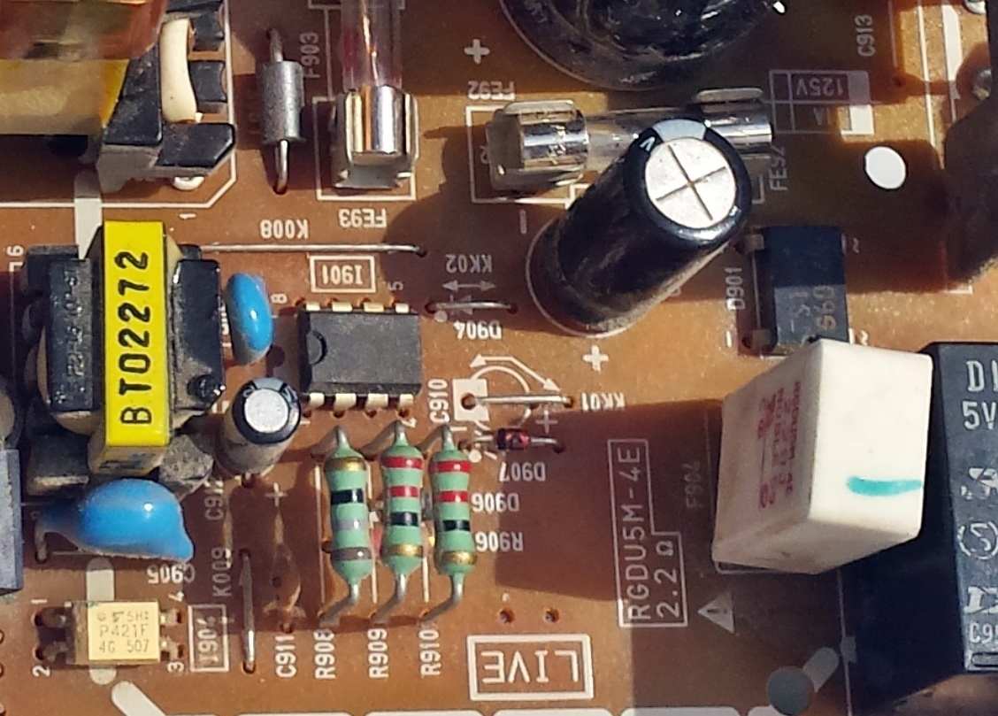

                      I took a few new readings and thought I would post them. There is approximately 108 to 115 volts DC coming off of the new rectifier, it's fluctuating real bad. If I remove the glass fuse inline right after the DC positive leg of the rectifier, I get a reading of 113.3 to 113.4 volts DC with very little fluctuation. There is approximately 120 volts AC going into the rectifier. Still no DC voltages on the secondary side of the board.
                      I assume there is something wrong after the rectifier. There is a larger capacitor after the fuse and I believe some kind of switching chip or IC offline switch flyback after that (I901) chip # A6159. And a few other caps, resistors, a diode, and a small transformer. Perhaps one of these components have failed?

                        I ordered some components from Digikey and my order came today, the first thing I did was install the regulator IC (I901). Unfortunately that didn't fix the problem. So the next thing I did was replace the filter capacitor (C908), after that I noticed that the DC voltage coming out of the bridge rectifier was now reading a stable 167 volts. But nothing else changed, still no DC voltage on the secondary side. I then changed out C912, C911, C909, C905, and I904. There was still no change. R908, R909, R910, R906, D106, and D907 test ok.
                        What could be left, perhaps the small transformer? There is a stable 167 volts DC going to pins 3 and 5 of the transformer.

                          I did make some progress today. First I removed the voltage regulator just off of the switching transformer on the secondary side and tested it, there was a a steady 5 volts DC coming off of the output leg, so I reinstalled it. Then I removed capacitor (C940) and replaced it with another capacitor I had of the same capacitance but a slightly higher voltage spec. and applied power to the board, I then had a voltage reading of approx. 7.75 volts DC coming off of C940 and a steady 5 volts DC coming off of the voltage regulator, however I didn't hear any of the relays click in.
                          I reinstalled the board in the TV in hopes the issue was resolved but unfortunately it wasn't. Still nothing.
